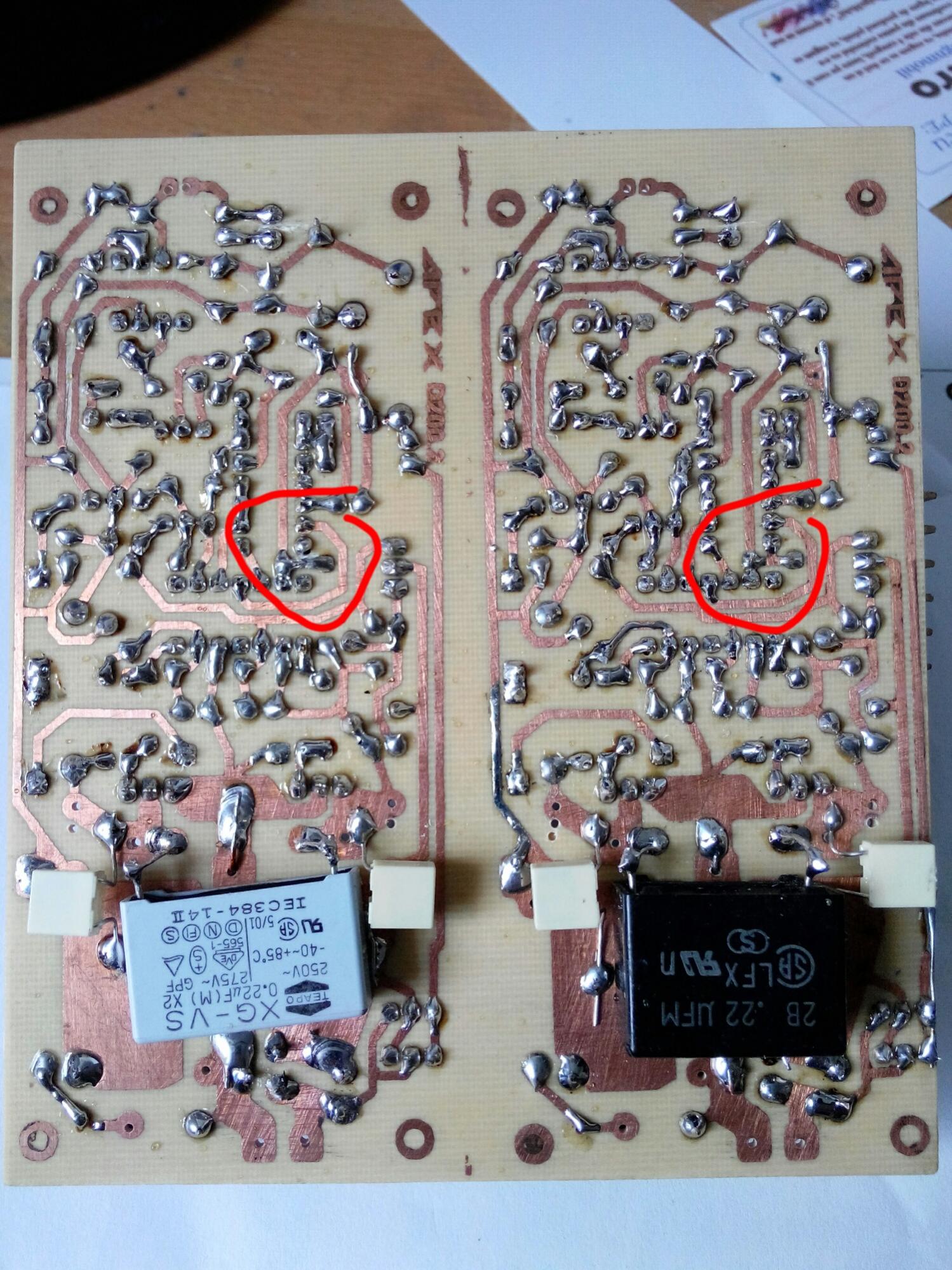

Please check maybe there some error on my pcb.
Regards

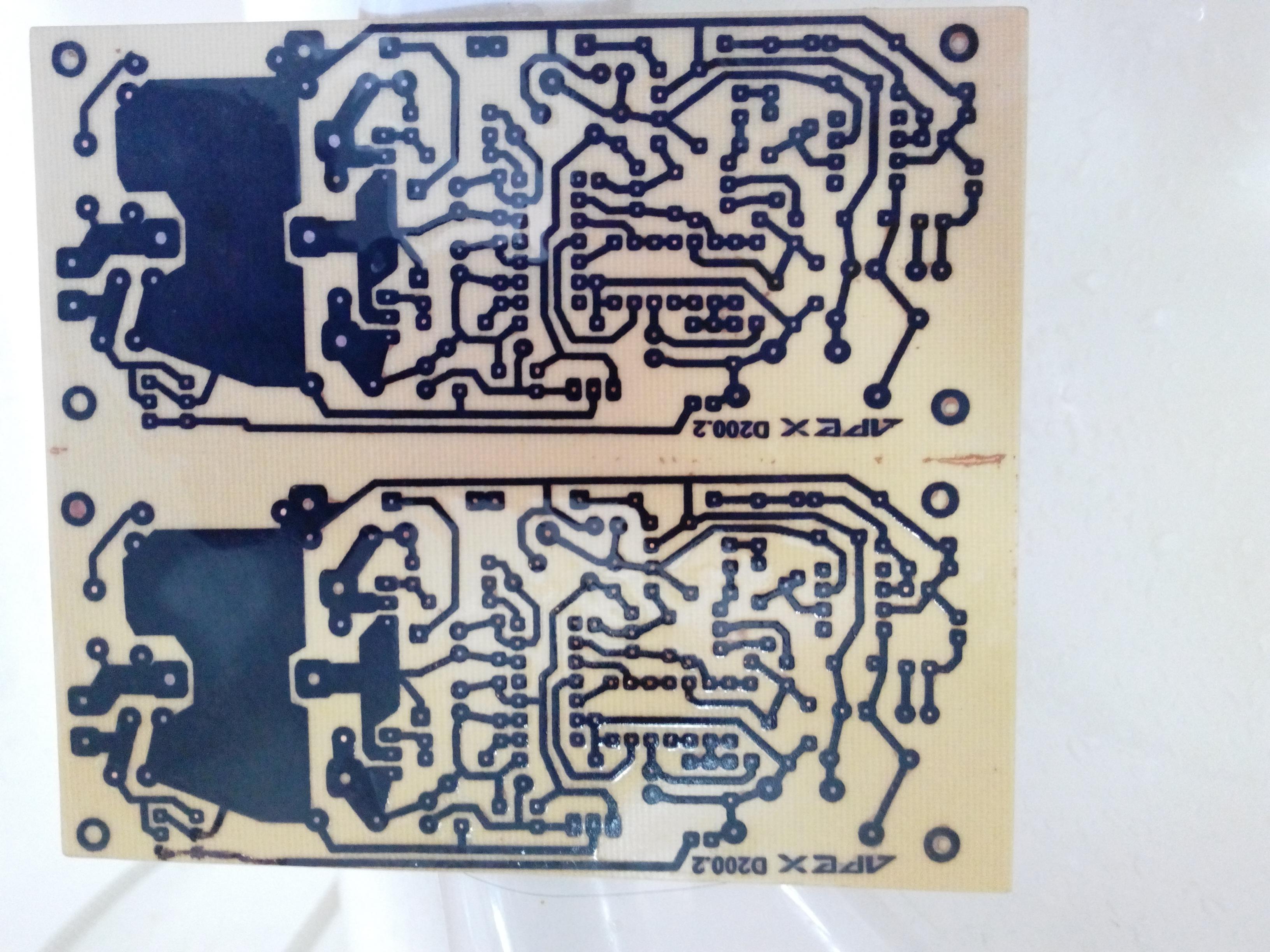

Can you tell me what is the size of the PCB?
I tried D200 pcb and couldn't match CI pins with pcb's holes. My pcb is 15/6,5 cm. There are two ways of facing 2n5401&78l05 ; Which one is ok?

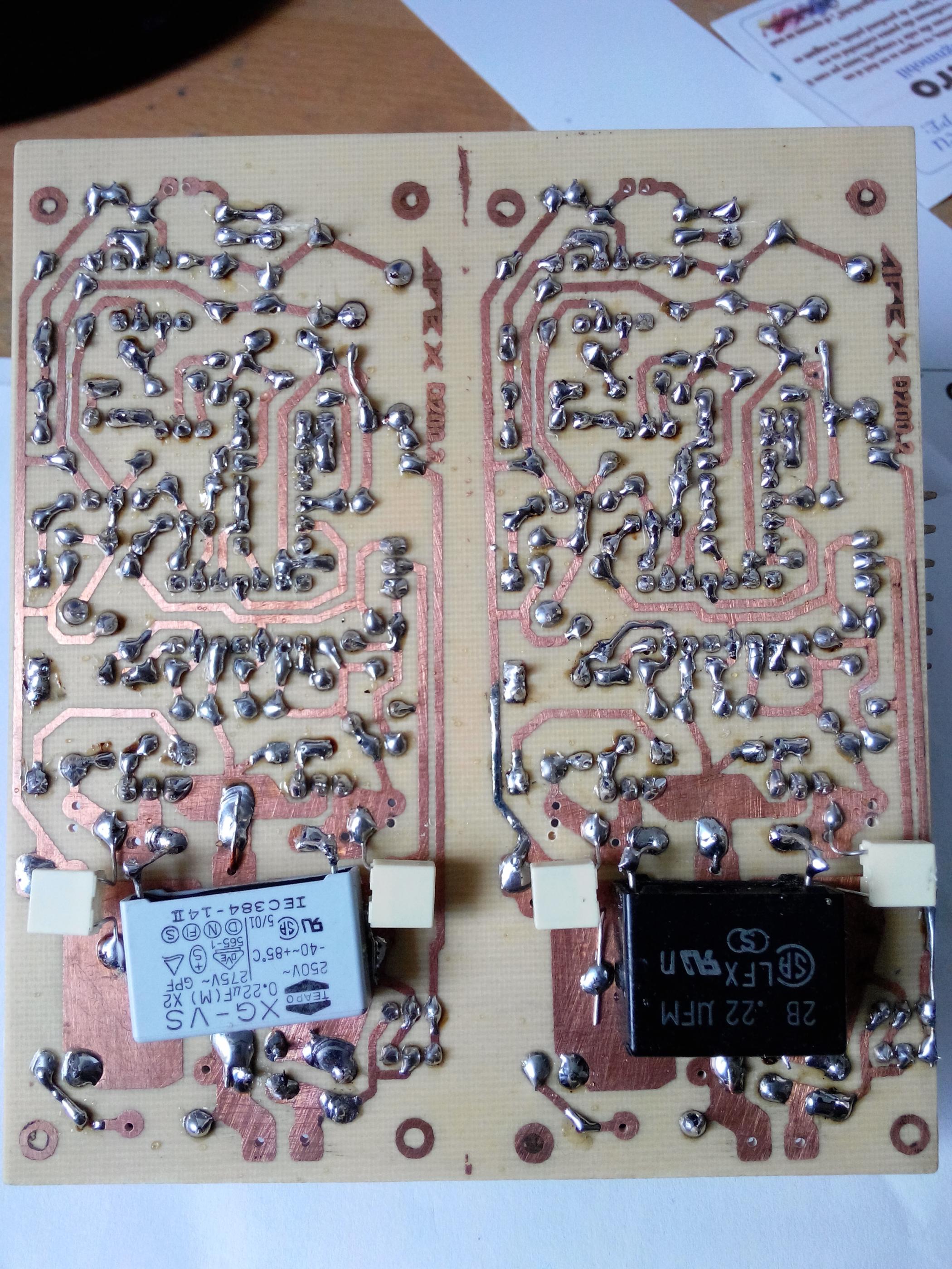

this is my progres till yesterday:
I'll do the test this evening.Still looking for mistakes...

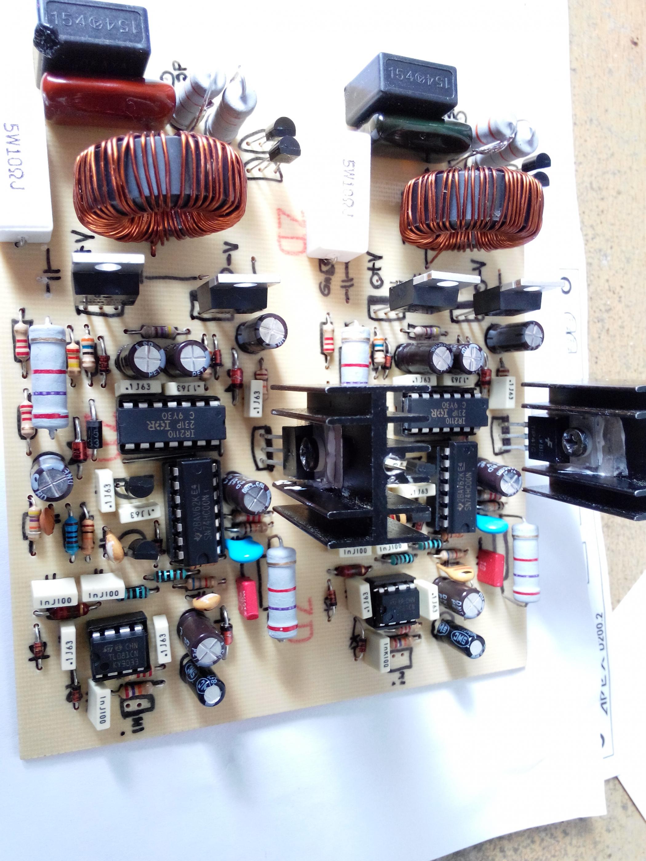

Sound at VERY low levels is ok. After that is very distorted---not sound any more... Only those resistors , (2k2/2w-mine is 2k7/3w)are hot. Every thing else is ice cold! (even tip41c--don't think is ok). I'll check for problems .... 78l05 could be gone bad???? Tomorrow is another day...
2k7/2W must be hot TIP41C also must be hot... can you post voltage measurements?

back to measurements.
supply -/+48V
All values are related to gnd(0.0V)
TIP41C C=0.0V
E=-46V
B=-45.5V
[That's not ok , cause it should be E=-36-37V ,B=-36V(12v less , refered to -48V)]
On 78l05 is only 2V😱 less that it stabized V...
After corrected mistake on PCB it(amp) is MUT ,nothing comes out..
Ok now! Working at high levels of output. For me problems came from those 12v zener.(10 pieces=>all faulty, bought them all together).At 10-20W output , fet are warm-hot(no heatsink on) , the same core of the inductor. Is that ok? this is my very first class D amp , so no previous experience..
quick q... i would like to use irf740 with this schematics? possible?
Use IRF740N with 8R load only.
That is ok, use IRF640N with some heatsink.
