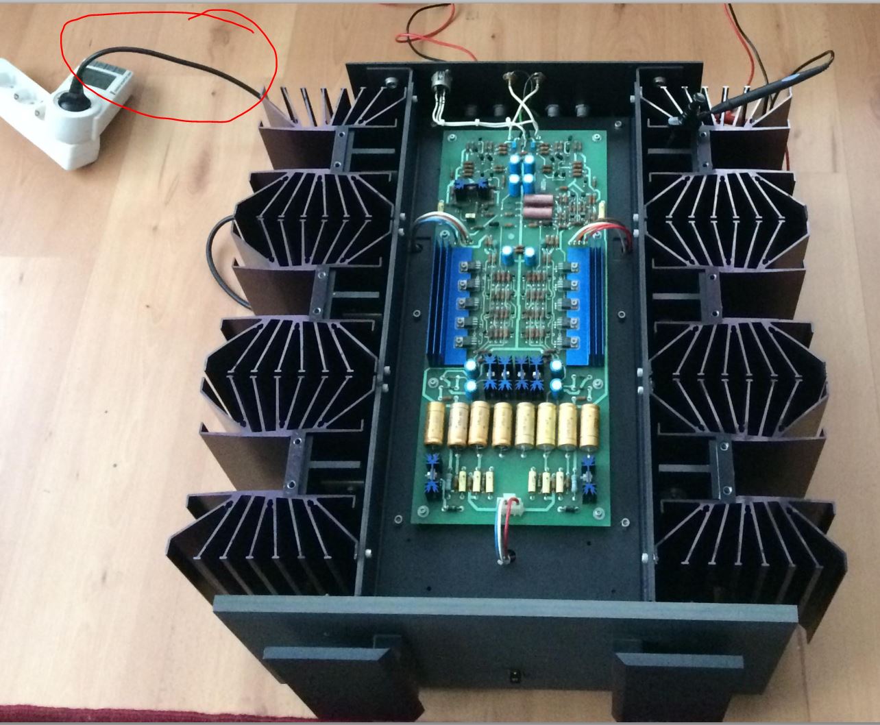

In these Pics above actually I tried to show some people how we can get CLASS A Quality Sound with less HEAT WASTE, and it was not me who had the Idea how it could be installed easy. Even, it may cost some more thinking, to make it happen. but it can be done, and I'm going to try it..
And the Answer which RobertS61 is searching for, is hidden in there. And its true More BIAS CURRENT less distortion this is more than true, at least for single end Class A.
No, it don't matter what brand you use, it's for most the same.
In the pictures you can see the one and same amplifier burning either only a lot of heat and little output or less heat and more, and now it comes, with the same Quality Sound the equal amount of Output Power. All what one has to do, is testing a bit forth and back.

In the past I was critical about the benefits of Class A in poweramplifiers mainly due to the vast resources of material (big powersupply, heatsinks..) and environmental footprint.
I saw Krell (plateau biasing) Jeff Rowland (Class D amps) moving away from too much Class A enrichment and believed Class A was something of the past.
After I had the opportunity to possess amplifiers like the Threshold SA/1 and Levinson ML-2, I realized that for me the benefits outweighed the "penalty's".
I recently acquired a pair of fixed bias Krell KRS-200 mono poweramplifiers that are biased for approx. 180 Watts Class A RMS @ 8 Ohms
(375mA with 18 outputdevices = 364 Watts peak Class A and 182 Watts RMS)
I've read the technical articles from the PassLabs website:
- Leaving Class A and the Sweet Spot both written by Nelson Pass on the Class A subject.
My question is if the conclusions in those articles are also true for my Krell KRS-100 an amplifier that consumes approx. 650 Watts when idling, has comparable heatsinking and PSU and Class A ratings comparable with a PassLabs XA-160.5.
I'm not implying I bought a PassLabs quality amplifier, I didn't of course, but I'm just curious if the reasoning in those articles are true for my amps and any amplifier that is a high (fixed) biased amplifier?

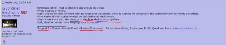

650Watts idling! That is obscene and should be illegal.
What a waste of enery.
Class D is up to 98% efficient with no crossover distortion (there is nothing to crossover) and extremely low harmonic distortion.
Why waste all that costly energy on old fashioned technology.
Class A went out with the demize of single ended valve amplifiers.
Still, ideal for winter time keeping your house warm
