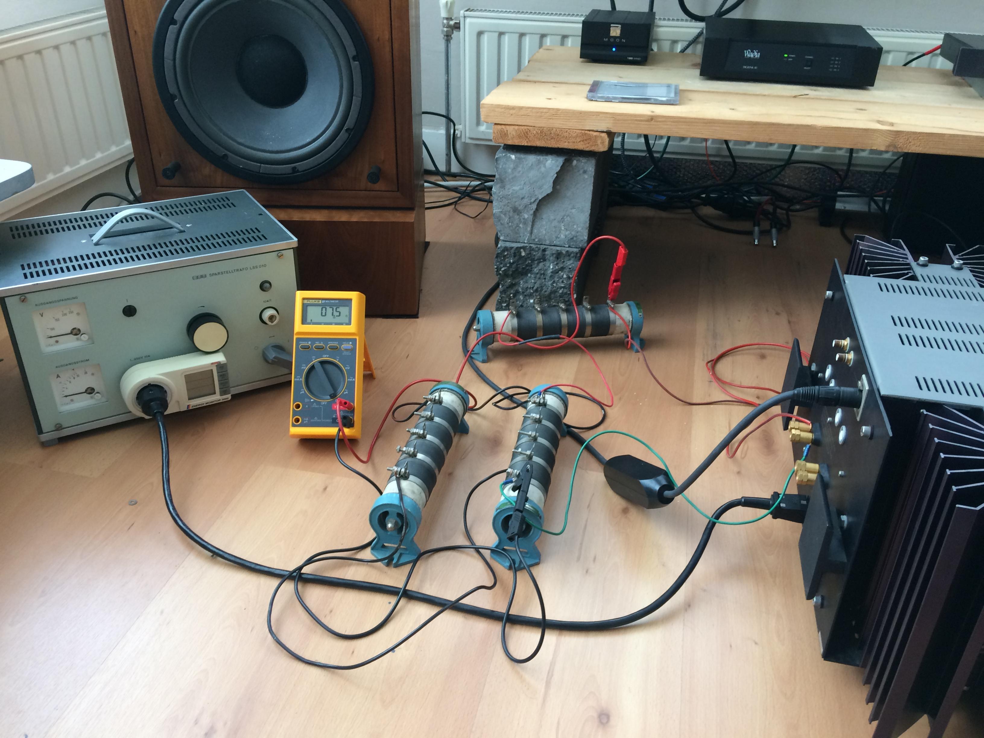

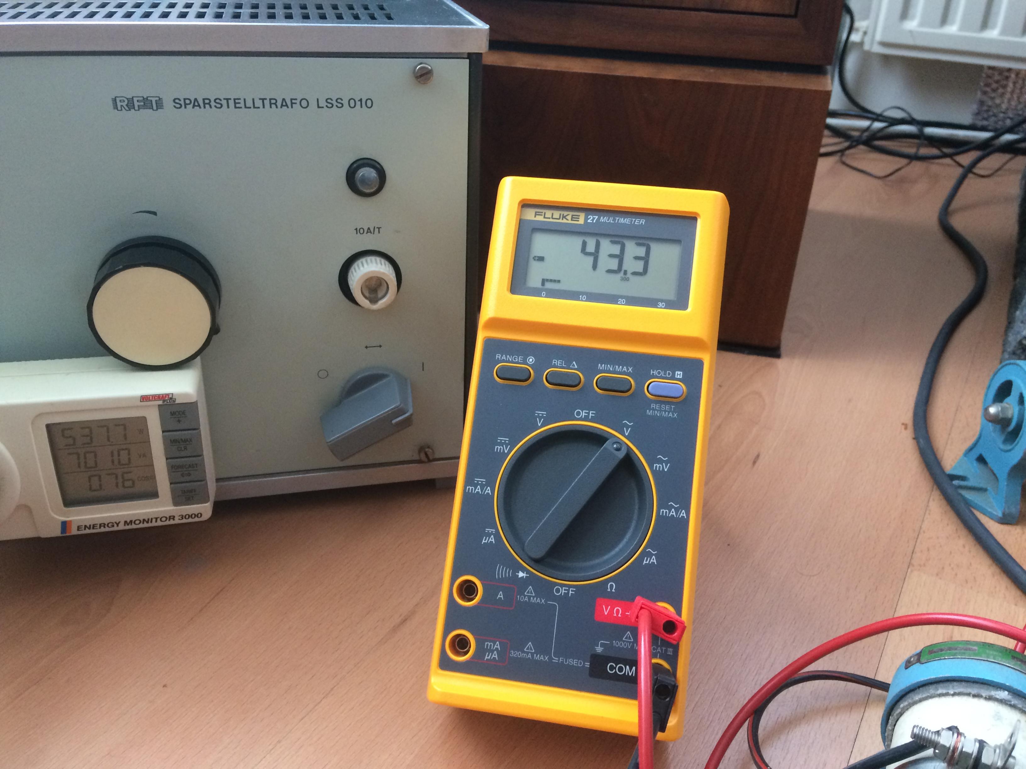

Just bought a IR Thermometer and the front measures 33 degrees Celcius, the heatsinks 50 degrees Celcius (30 degrees over roomtemp.)
Cos Phi is 0.80, I've had worse with a Levinson ML-3 (0.63)
https://www.diyaudio.com/forums/attachment.php?attachmentid=942654&stc=1&d=1618495148
https://www.diyaudio.com/forums/attachment.php?attachmentid=942655&stc=1&d=1618495148
