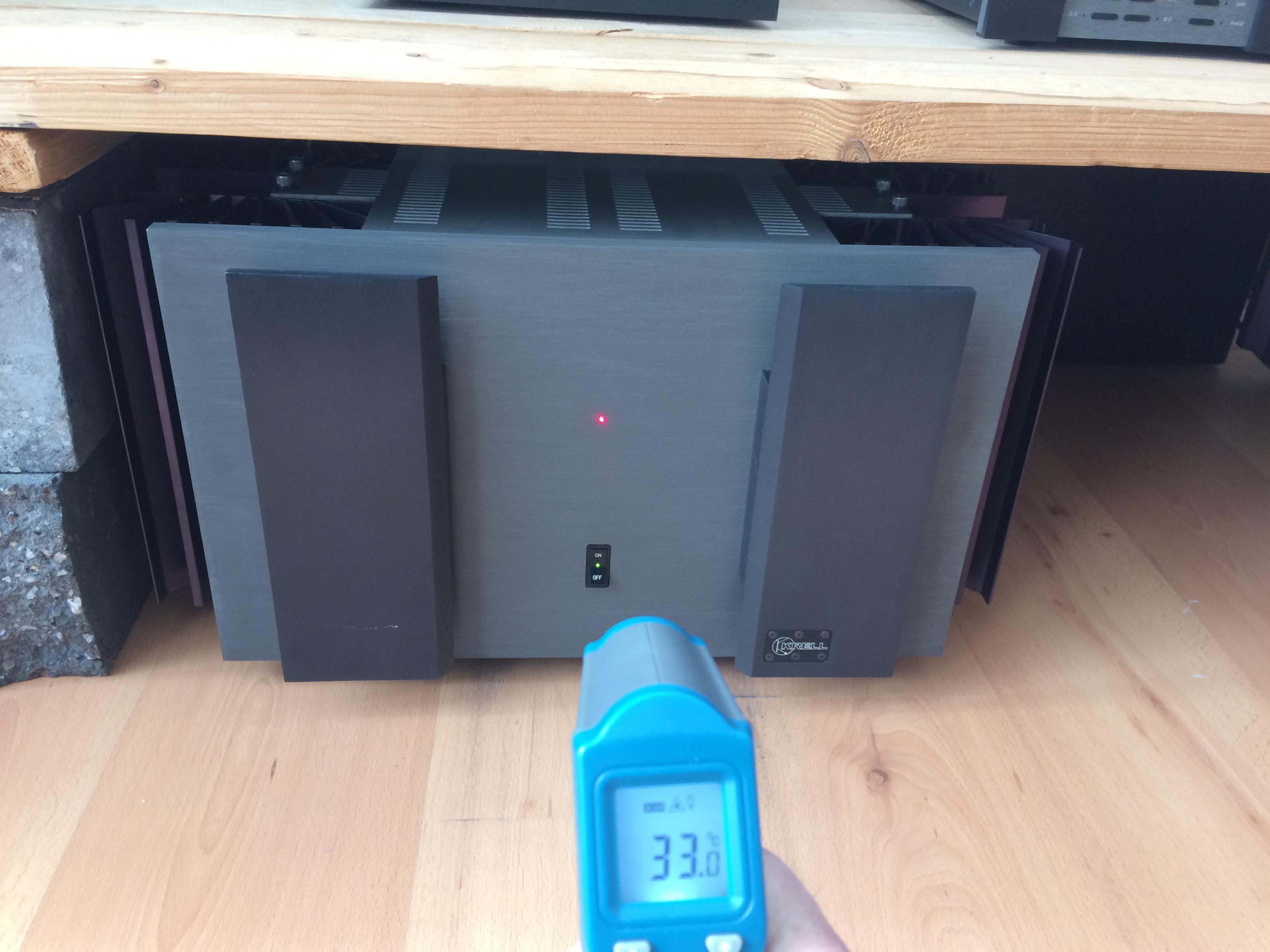

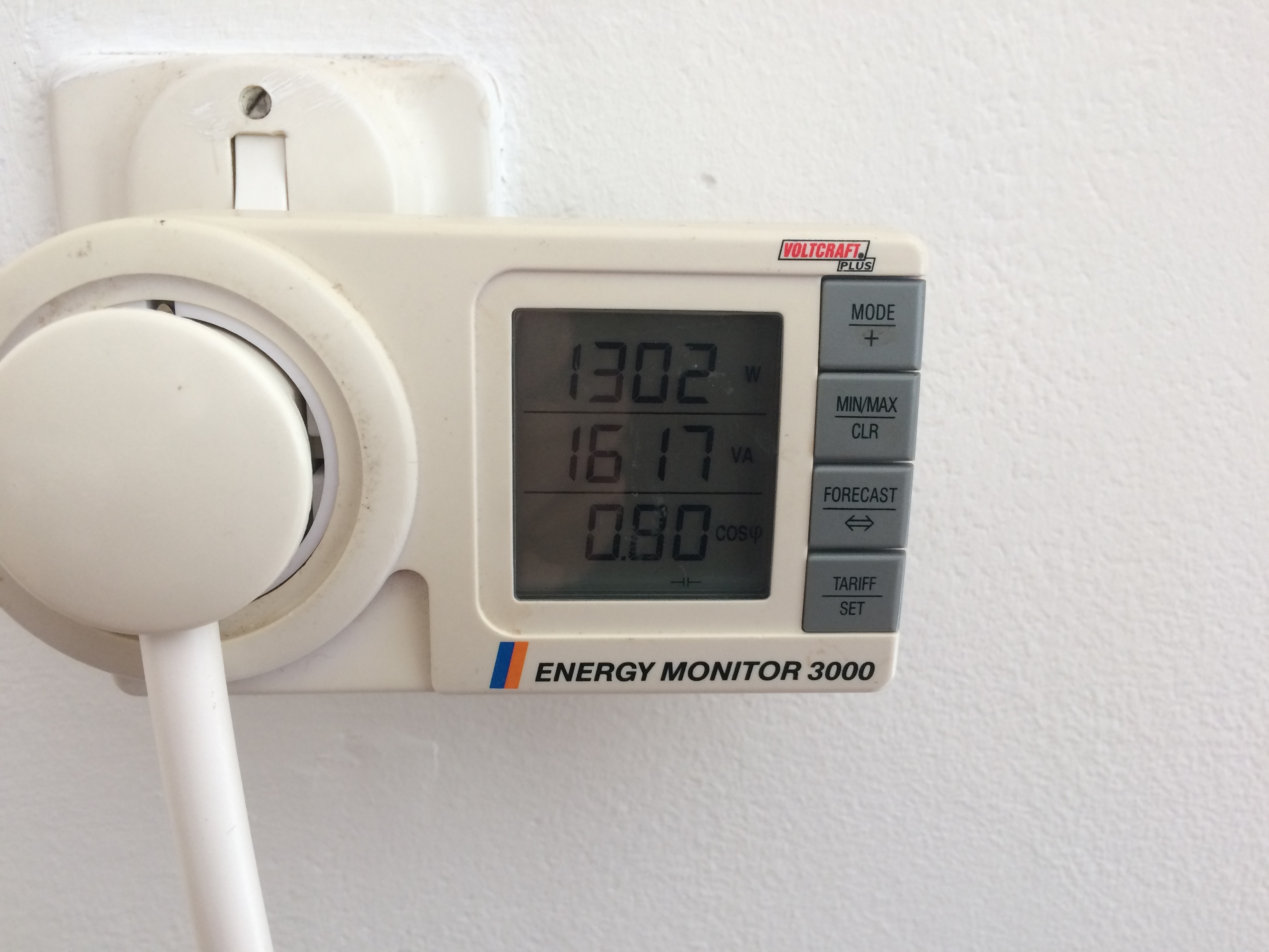

650Watts idling! That is obscene and should be illegal.
What a waste of enery.
Class D is up to 98% efficient with no crossover distortion (there is nothing to crossover) and extremely low harmonic distortion.
Why waste all that costly energy on old fashioned technology.
