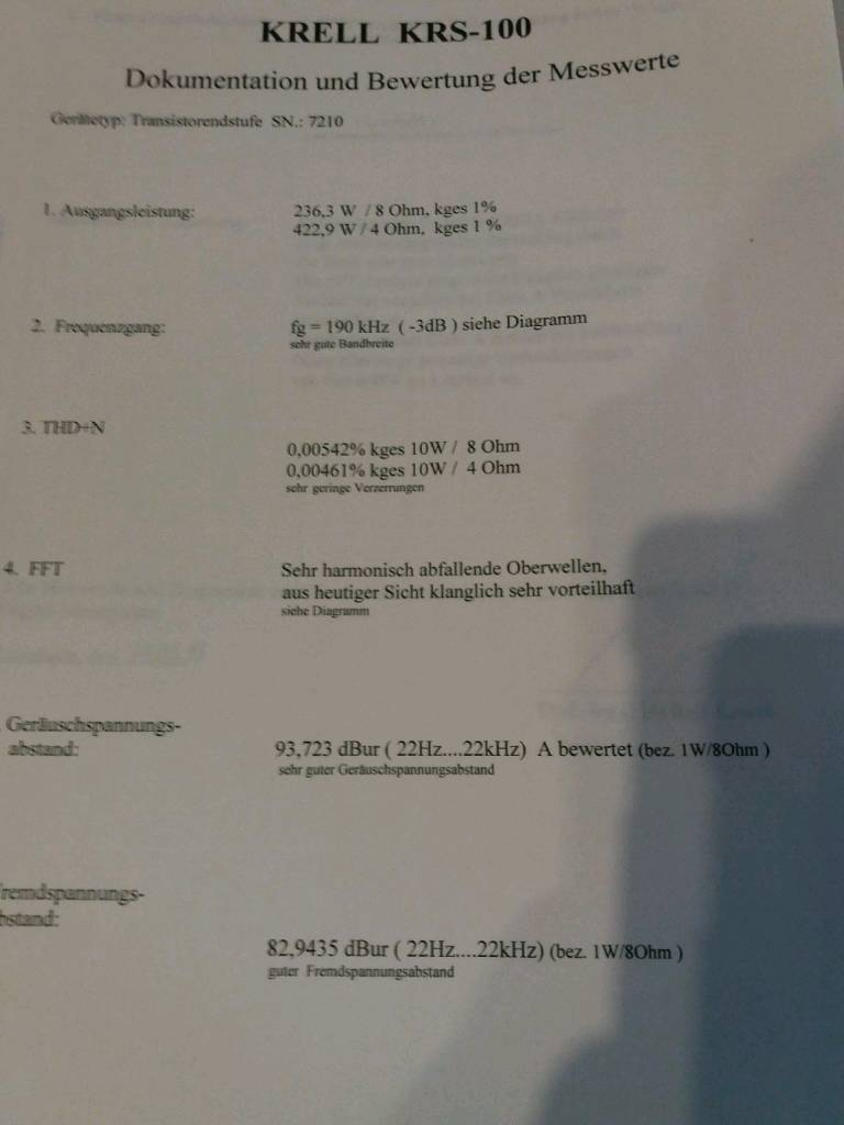

As is the case with my Krell KRS-100 which is rated for 100 Watts RMS @ 8 Ohms (hence its name KRS-100) but actually it delivers twice that power according to this rapport:
https://www.diyaudio.com/forums/attachment.php?attachmentid=936312&stc=1&d=1616858580
And the technician also states (translated from German)
"Very harmoniously falling harmonics, from today's point of view very advantageous in terms of sound."

That is probably two channels added up (a non technical view for a technical report).
No it's one serialnumber 7210 and their mono-amplifiers
