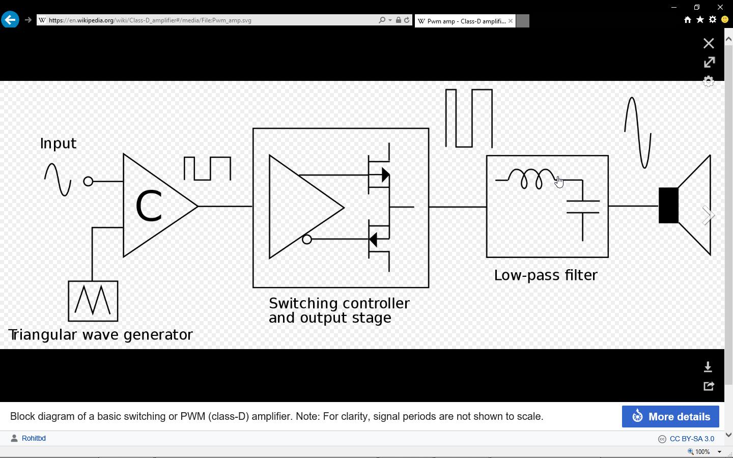

Class D is purely analog, nothing to do with digital... It is a common misconception. Read this.
Sorry My Friend I think you are mistaken. As soon a PWM is involved it's no more purely Analogue. PWM Pulse witdh modulator This is DIGITAL it is way go control whatever like, mostly to find in Switchings.
that's it.
The use of PWM isn't the criteria for digital. It's the digitization, which doesn't (necessarily) happen in a class D amp.

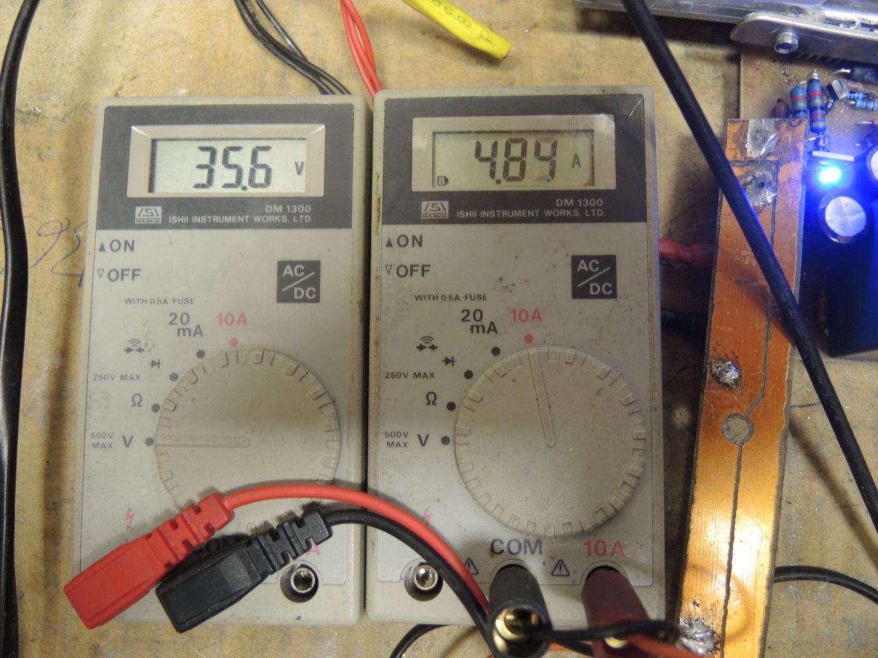

Check out this pics..

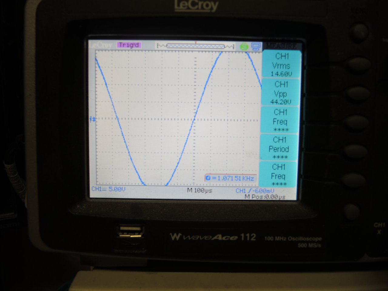

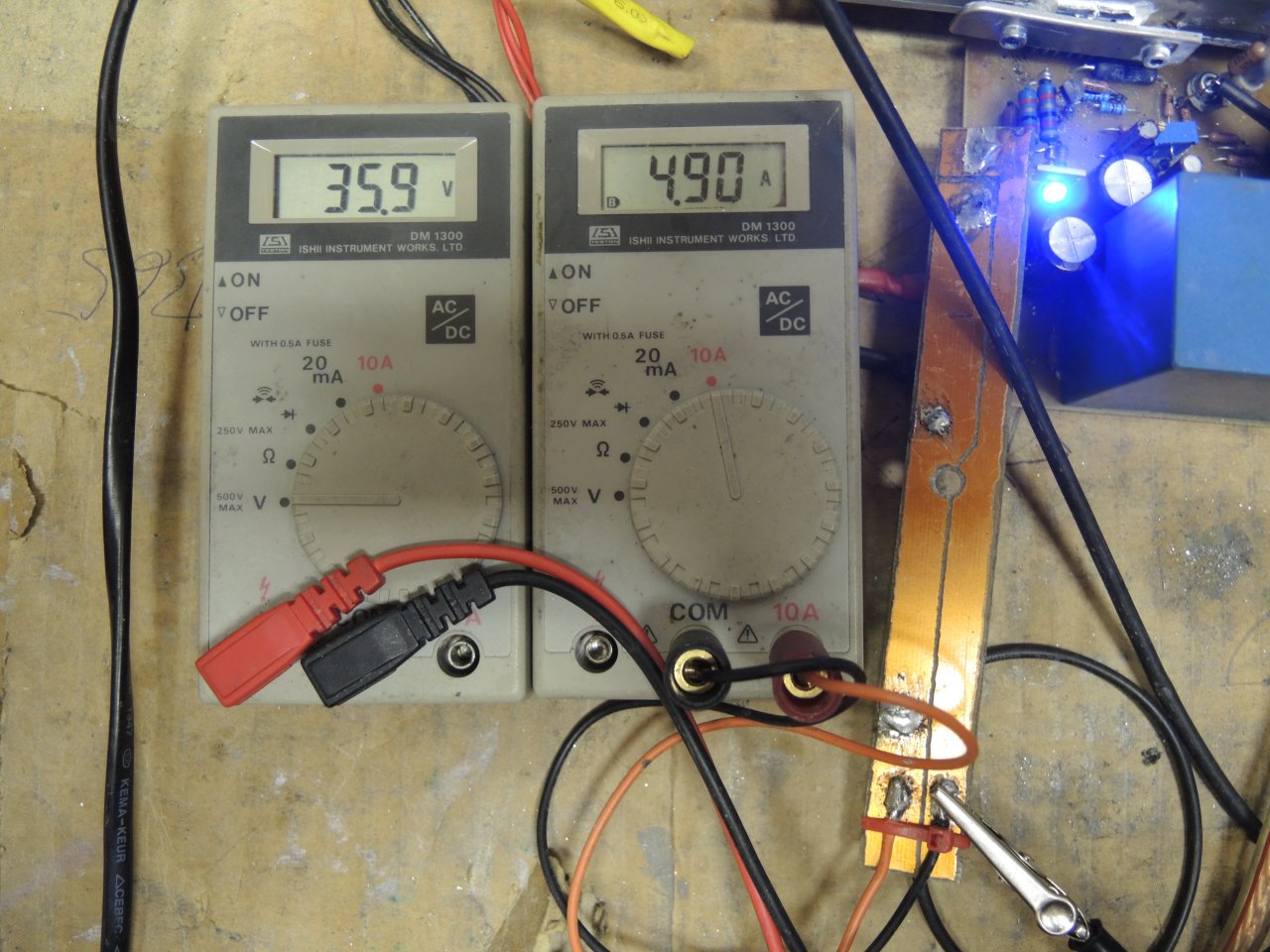

My Setup as you can see in the pictures is.

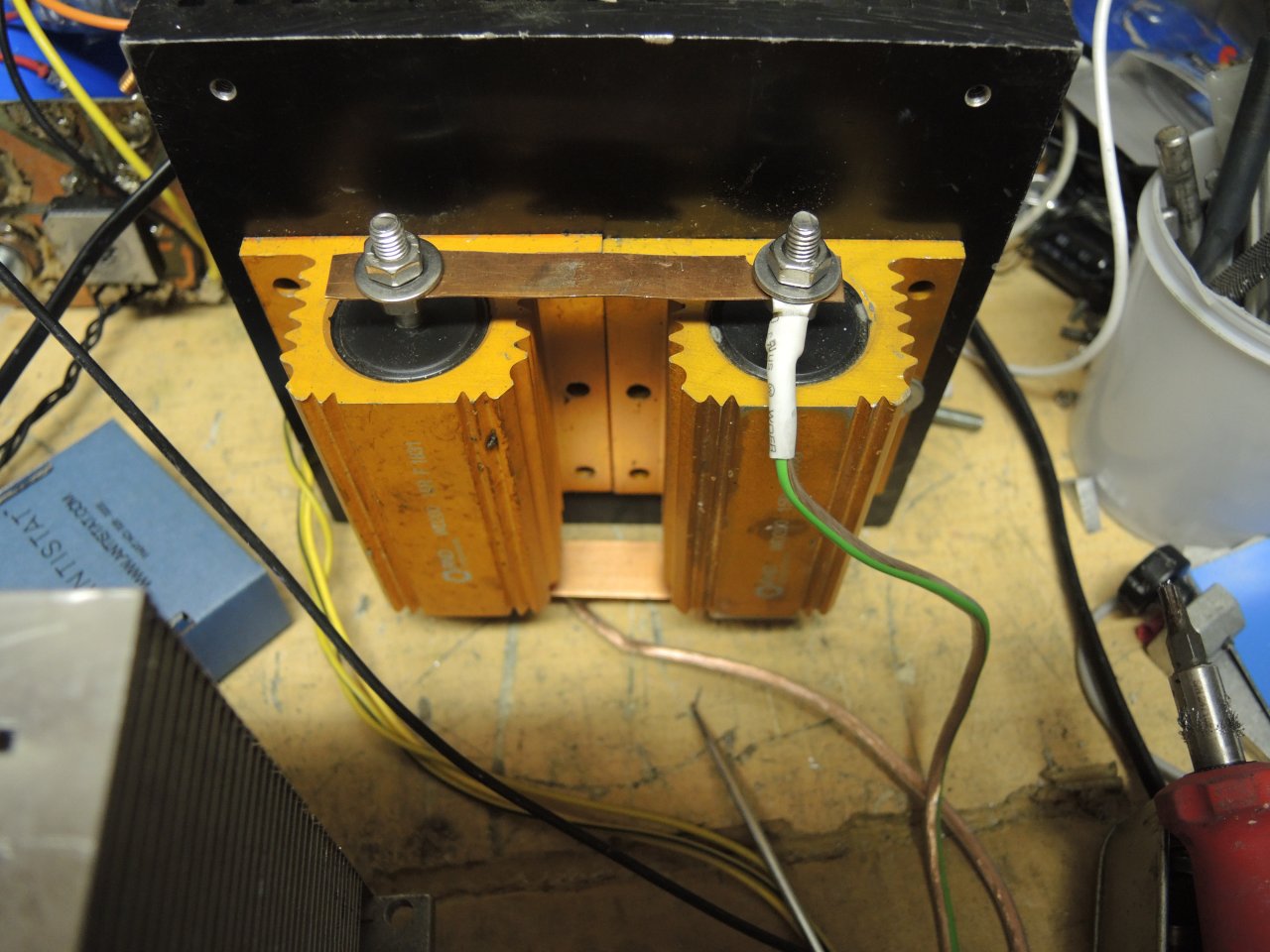

Single End Class A - Resistance Based, the bias is made by a 7.5 Ohm 400Watt Resistor.
To start with we have 35.9 Volts VDC+ and 35.9Volts VDC- first picture
We have 4.90 AMPERE IDLE CURRENT. first picture
This makes a Input Power of 35.9 * 4.9 ( taking the short way in calculations) = 175 Watts
We have at the same time 0 volts output, second Picture with a Load of
RE + LOAD = 7.5 * 8 : 7.5+8 = 3.87Ohms Output 0
Then we have full output 14.6 Volts @ 3.87Ohms LOAD + RE =
14.6 Volts * 14.6Volts : 3.87 Ohm = 55.08 WATT RMS Picture 3 - None Clipping
We read at the input Power Picture 4
35.6 Volts VDC+ @ 4.89 Ampere
This States that this AMP is CLASS A - if Current goes up then it's no more CLASS A.

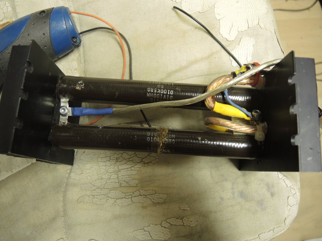

Rest pics are Dummy and RE
Check that out then you know if it is a REAL CLASS A or just a biased A but AB AMP.
hope this clears up the smoke..

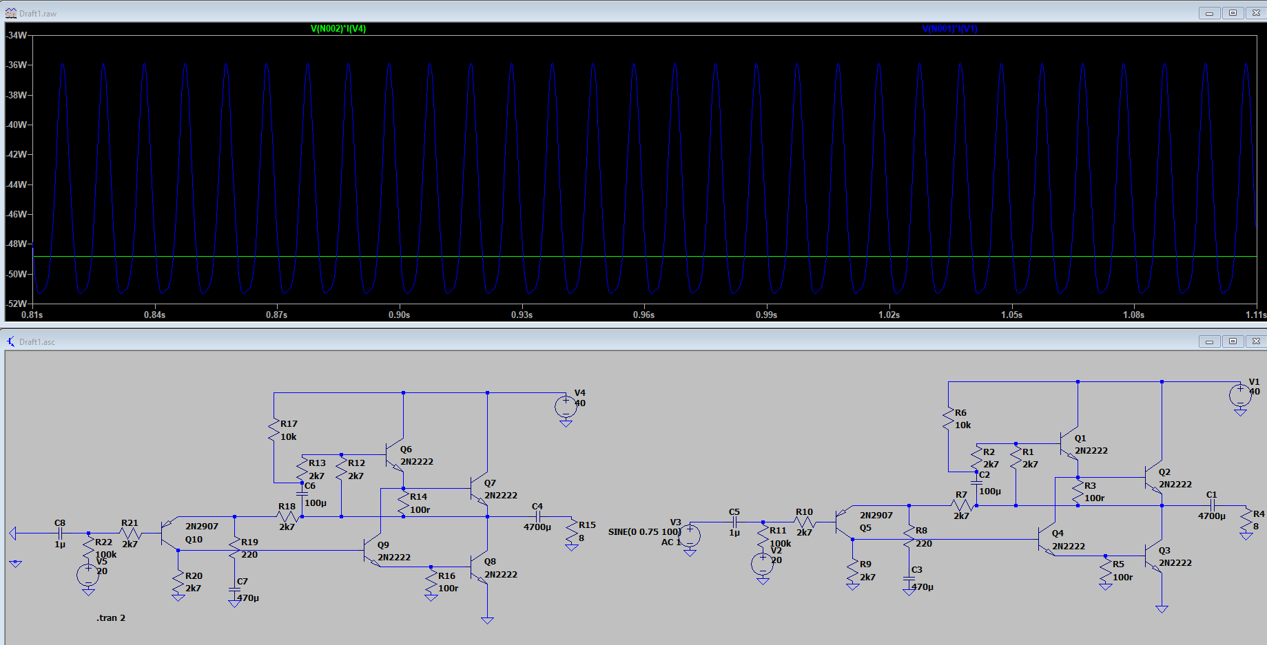

To make it more visual, I attach the simulation of two DOZ, one at iddle (no signal), one with an input signal. The green line is the power drawn from the supply at iddle. The blue line is the power drawn from the supply with a signal present. What conclusion do you make of it ?
