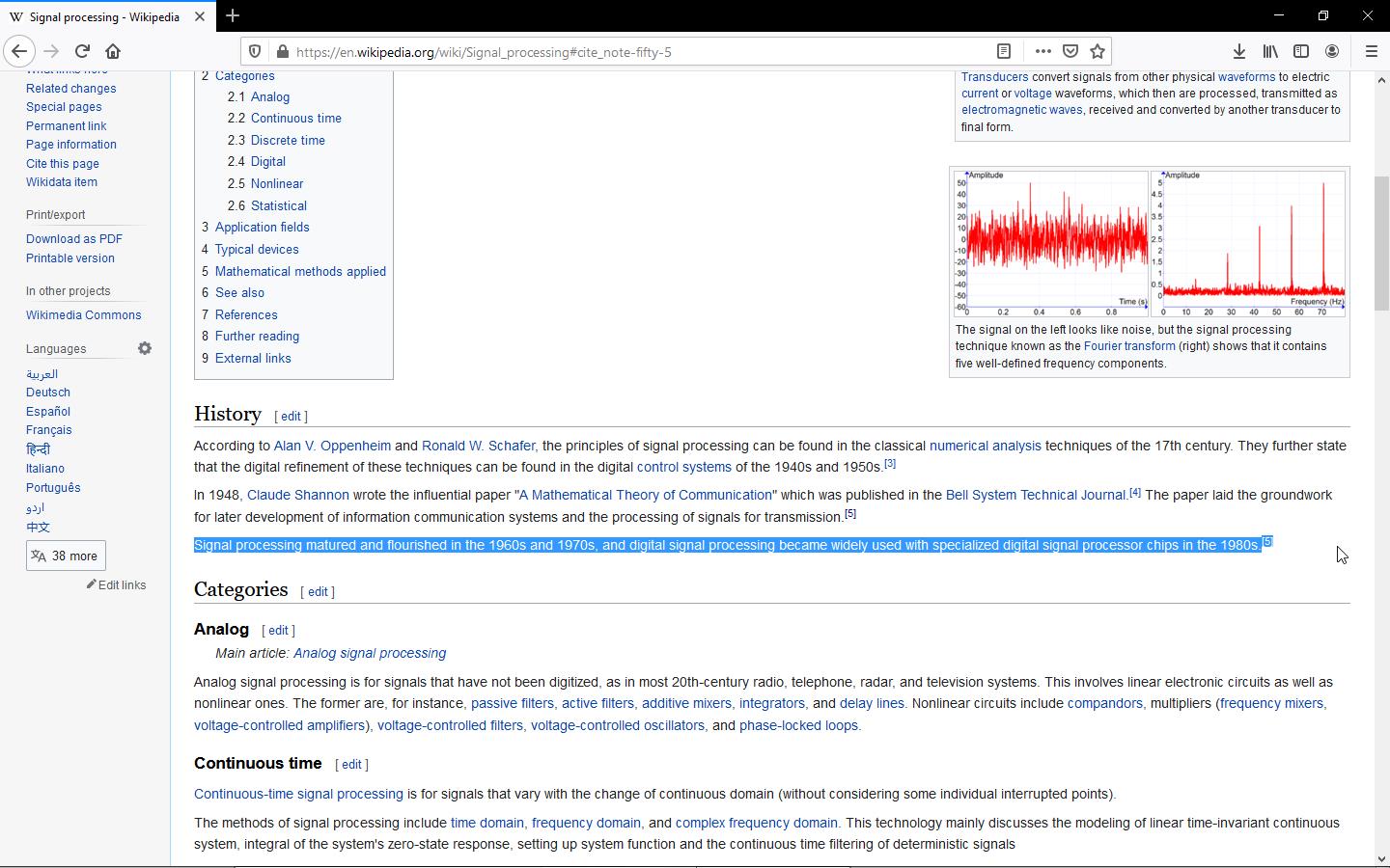

Sorry to question your knowledge? Have vou been around in the 80's? I was around 35 -36 must be 1986 - 88 or may it was almost end of the 80's. anyway it was fun to play with this stuff. and then afterwards in beginning and mid 90's one would find in almost any Keyboard, with a name these chips, but much better. But these were then no more only 8 Pins..Roland, Korg, Yamaha and many other
Check this out here this link will bring you there.
Signal processing matured and flourished in the 1960s and 1970s, and digital signal processing became widely used with specialized digital signal processor chips in the 1980s.[5]
Tell me one thing- Why should Lie to you?
What I would get in return, Nothing and BTW I already have everything I want and I need. That time we played with these IC's. 8Pin a 1 clock pin, 2 power pins, +- 1 Input 1output and 2 Caps and if I remember right 2 resistors. on the rest, and with this it was possible to create a Butterworth Second Order filter.
I have some documentation on that, but this is almost 40Years ago, and that time I lived in Asia, so I have to search for it, But I can assure you I will find it. But for the time being you can follow that link. And take an update to your knowledge. But that is up to you.
Regardshttps://en.wikipedia.org/wiki/Signal_processing#cite_note-fifty-5

A 1980 audio DSP in an 8-pin case controlled by resistors and capacitors? In which Bond movie?
You cannot see how ridiculous this is? Yes, there were DSP chips, only those were completely unsuitable for audio thanks to 8-9 bit ADC/DAC resolutions. And they had plenty of pins as the only way to make them do anything was by programming them and they all had parallel interfaces.
If you replace 1980 with 1990 or any other year nothing much changes. Programming still required, pins still numerous, RC control still impossible.
