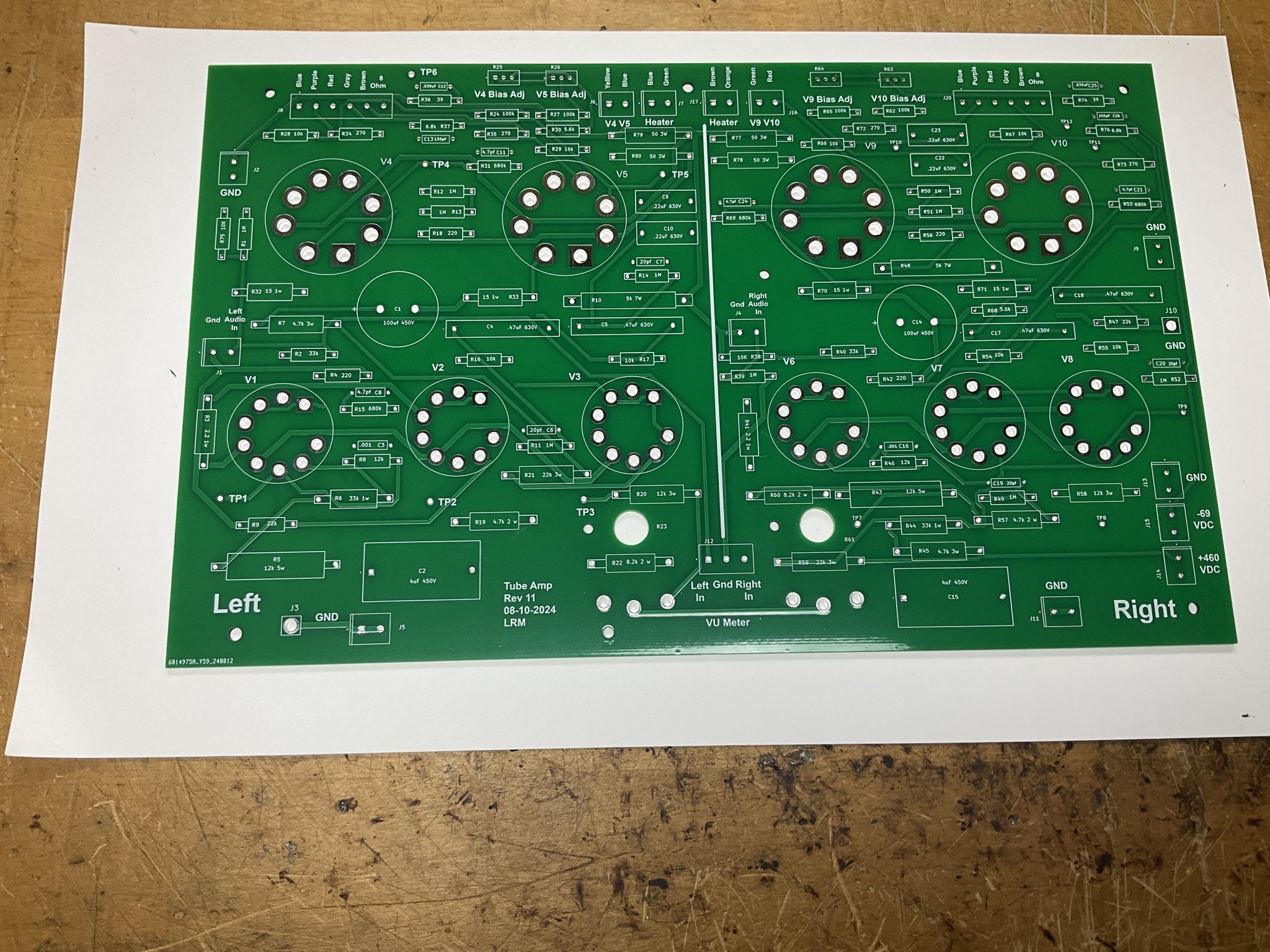

After 8 months, have my Citation 2024 amplifier is fully functional. Solved all the problems with turn on hum and noise.
New main pcb board layout, better power supply.
Added .1 uF caps a cross the two dc voltage supplies.
Added two 50 ohm resistors as a center tap on the 6.3 vdc lines.
Added a speaker turn on dethump circuit delay of 30 seconds or so.
More information coming after running for a few days . Schemtatics, signal pics, layout pics, new gerber files, New BOM.
I have a friend who will professionally test my unit in a few months.

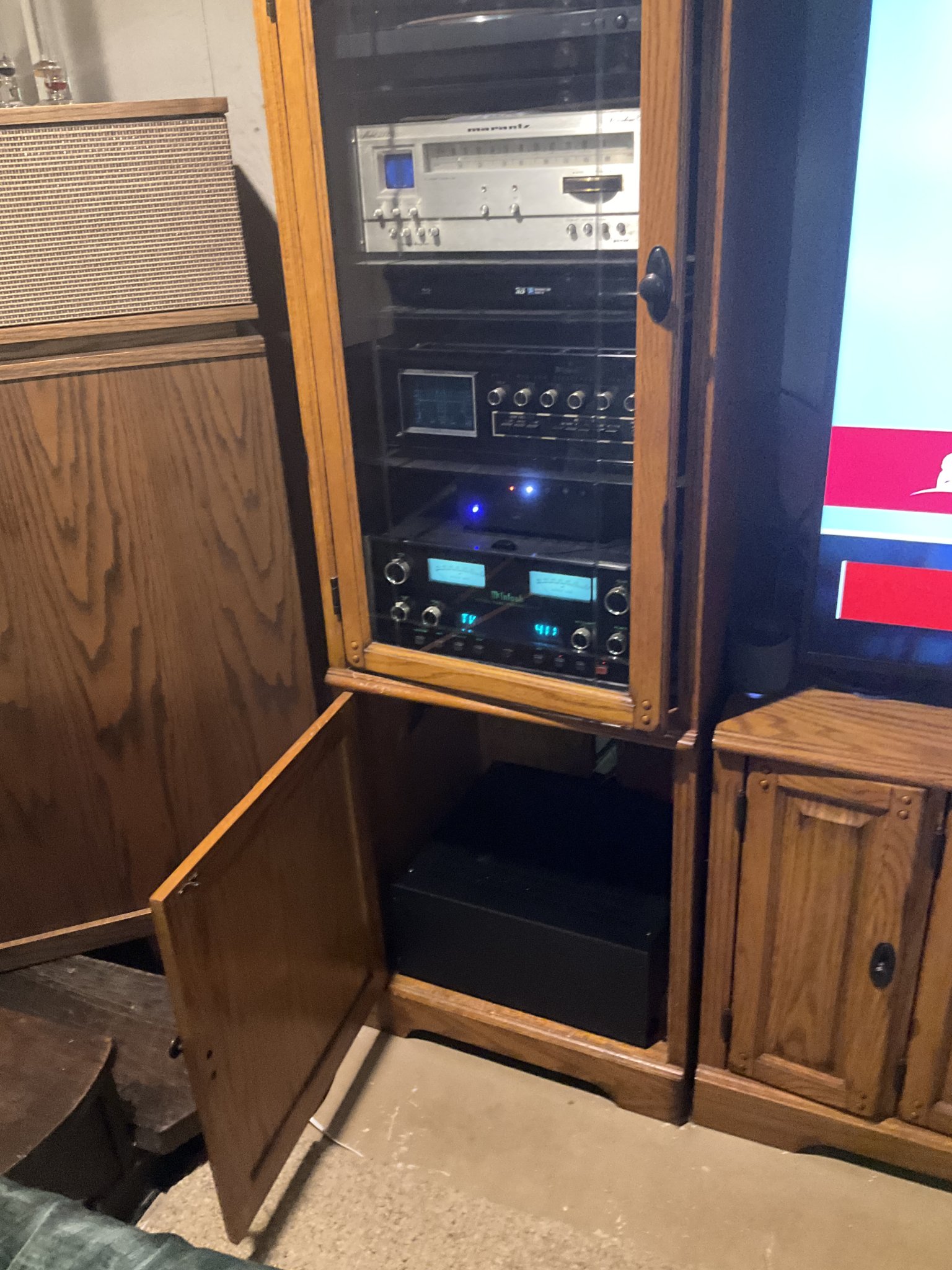

Pictures are of the main pcb and the amp at the bottom of system picture.
My preliminary testing, unit is flat from 20 to 20khz at full power.
Sounds great, nice and quiet.
Update info soon…..LMitchell
