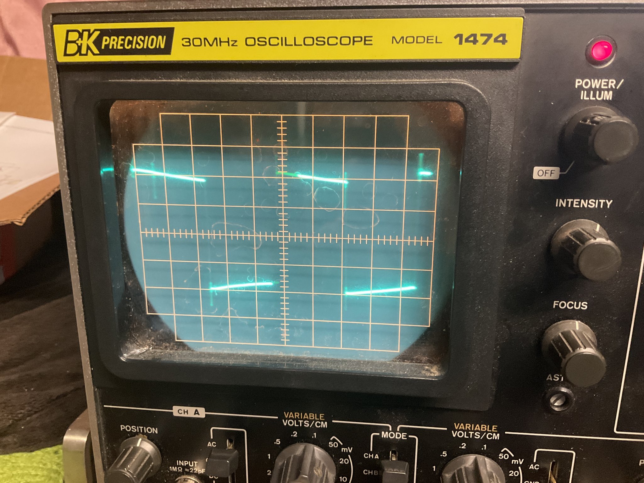

BK Precision Model 1474 30Mhz Scope

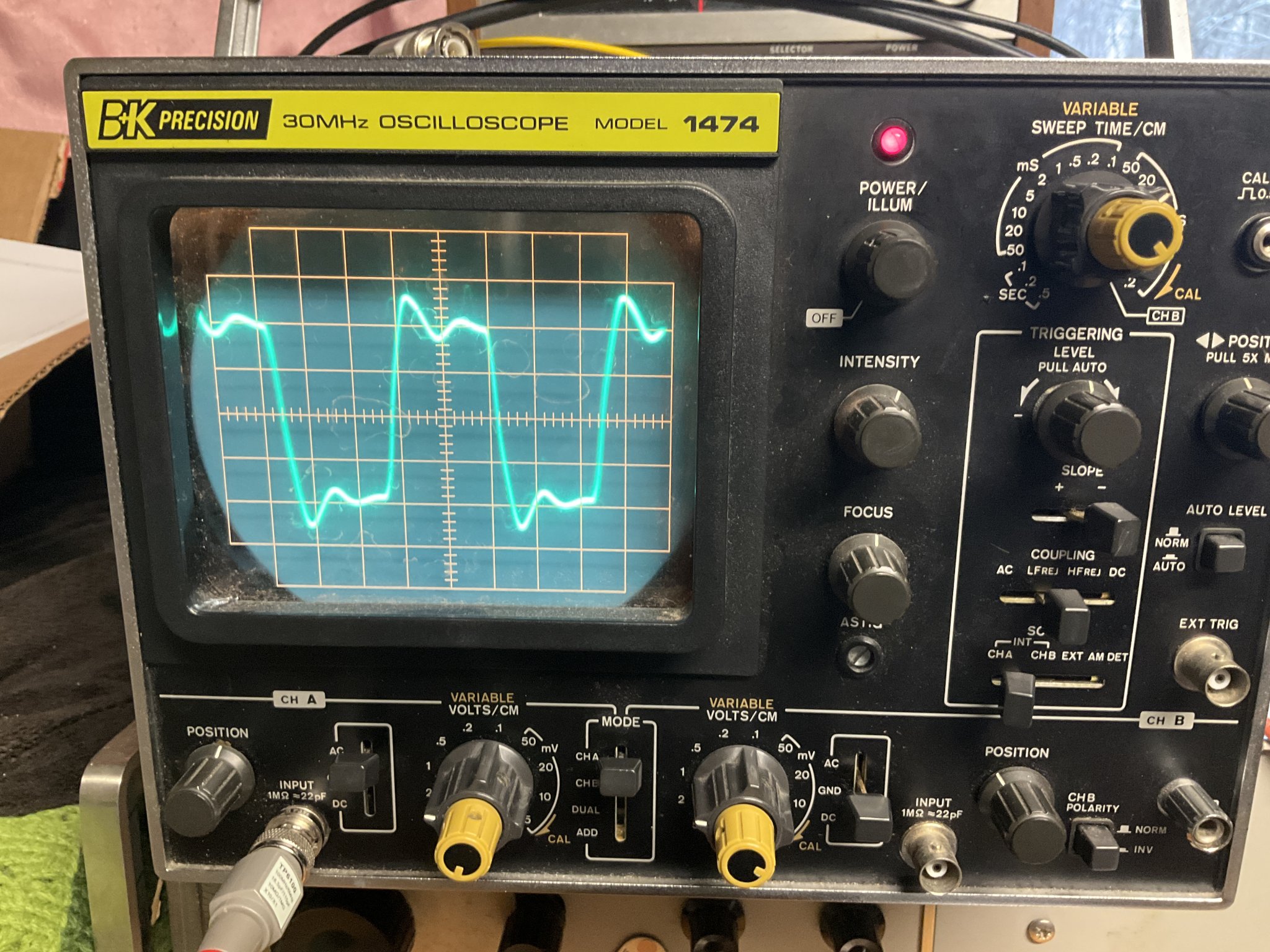

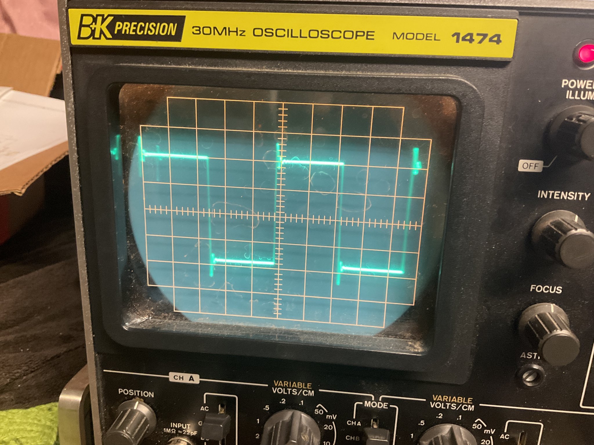

1st photo 10Hz square wave
2nd photo 100 Hz square wave
3rd photo 10k Hz square wave

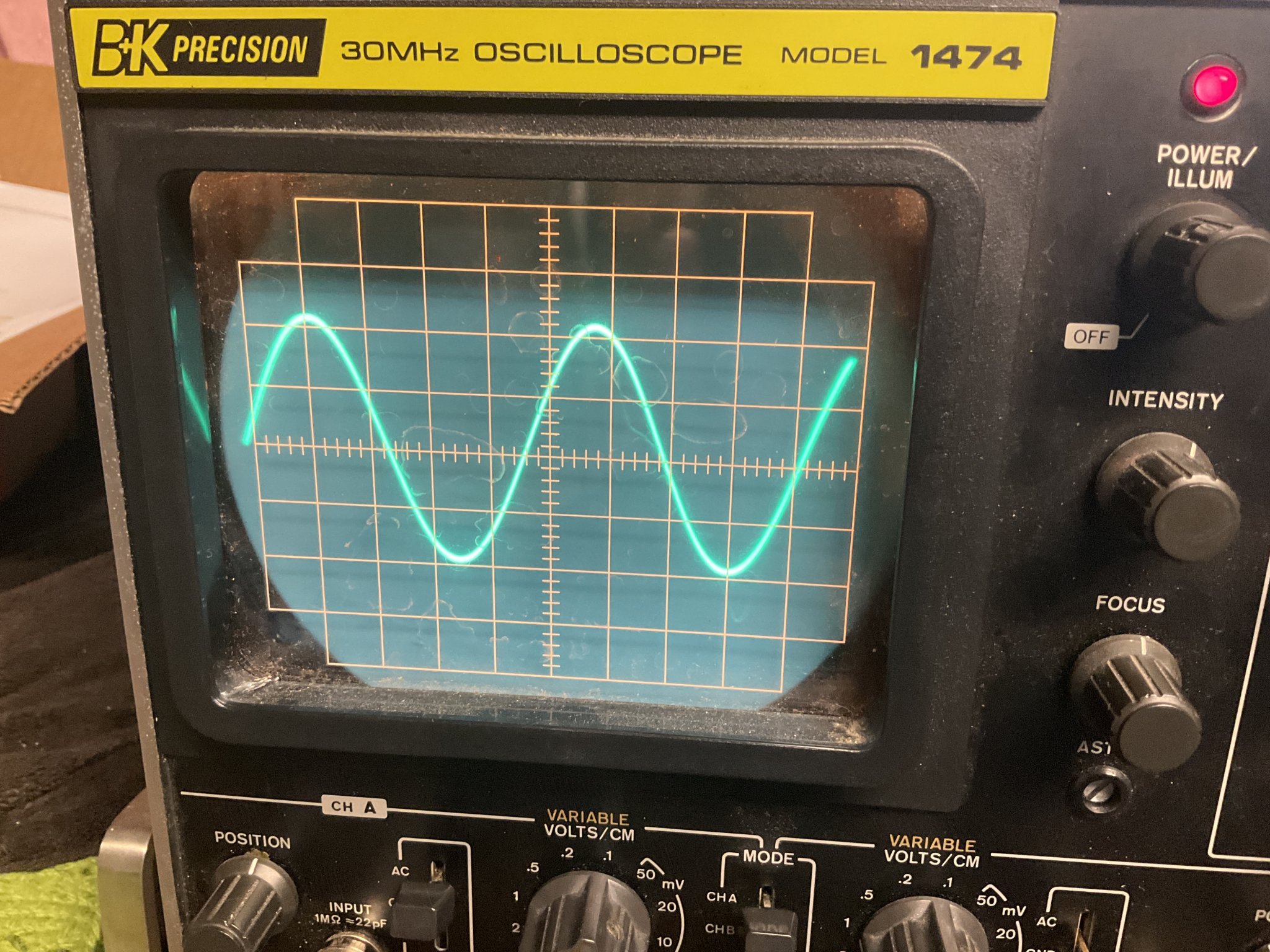

4th photo 20k Hz signal

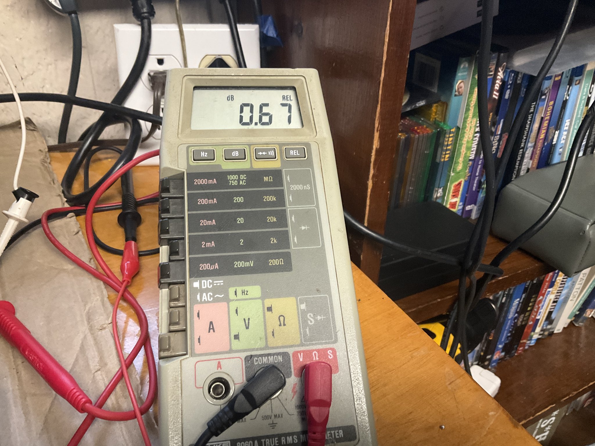

5th photo frequency response @ 20k down .67db. Frequency response from 20-20K is flat except for the drop at the high end.

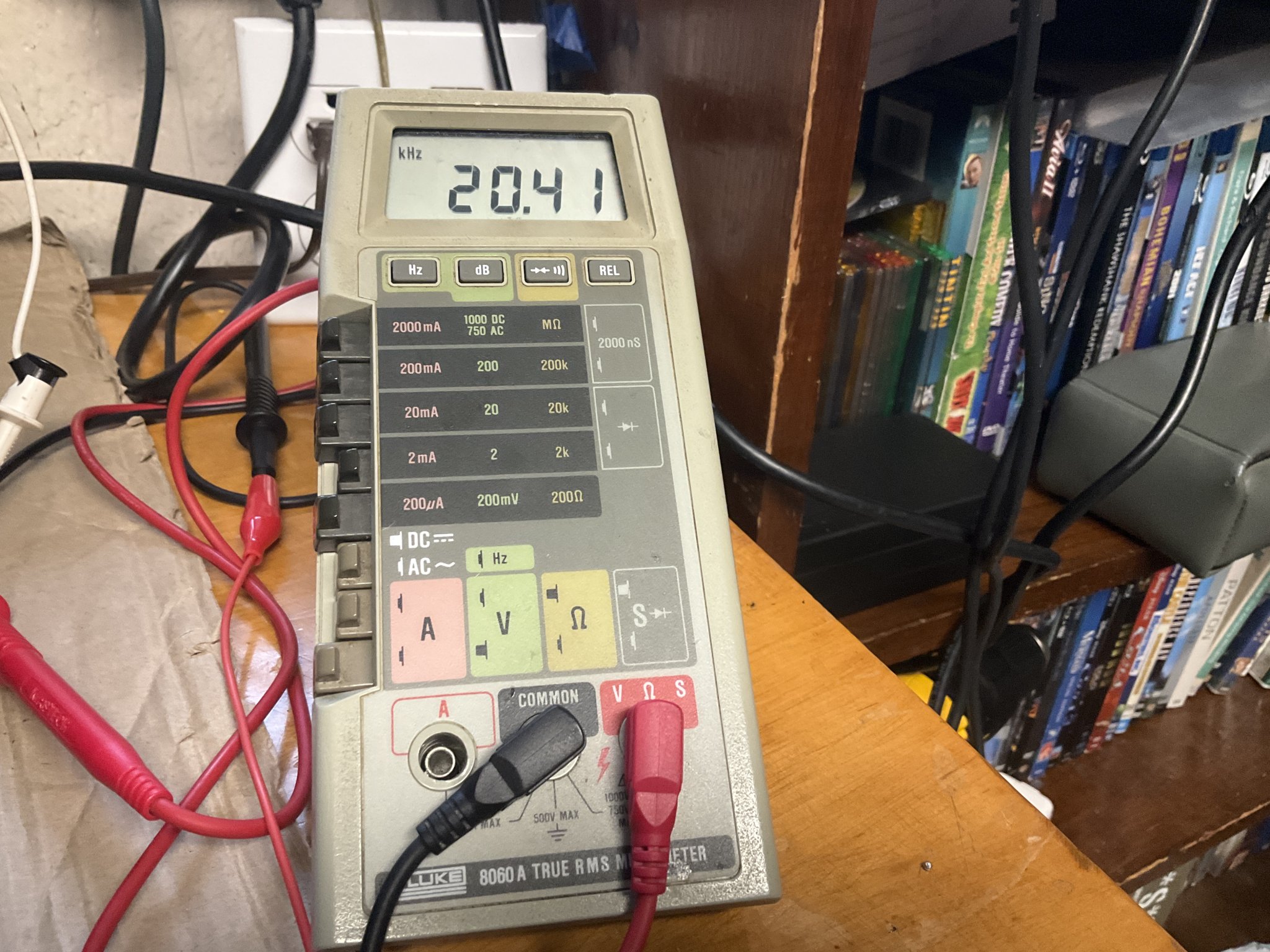

6th photo meter reading 20k Hz.

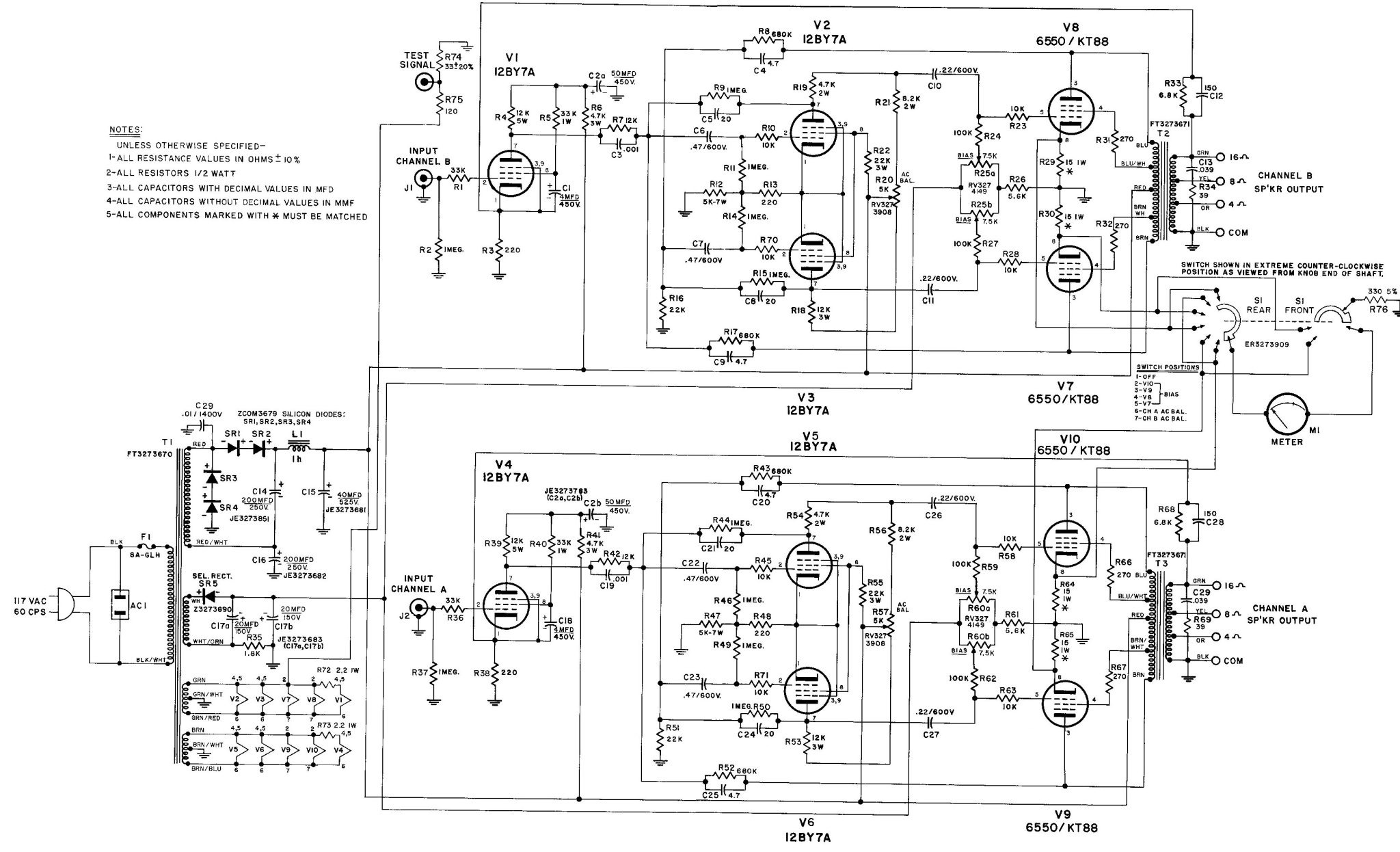

Please remember this amp update uses the exact audio circuits as the original, but different transformers, no choke, and the RC network across the output transformer deleted.

The 10 Hz square wave is certainly very good. The high frequency response could probably be adjusted for less ringing.

Look at BOM & schematic supplied in an earlier post.

I'd first try removing (or decreasing to around 220pF) peaking capacitors C5 and C6, and see how the ringing is changed.
It should be less, and at a lower frequency.

Thanks, I’ll look at this tomorrow. First shorting out the rec networks, then reducing it to 220 pf
The high frequency drop may cause by the digital meter. Direct input the signal to the meter to verify the frequency response of the meter.
I would restore C13/C29 and R34/R69 across the outputs. They're zobels or "tweeter savers" to tame spurious oscillations and protect your speakers. Might also help tame the HF ringing. Try increasing the value of C12 a bit at a time, maybe up to 240pF or a bit more. If the 10kHz wave looks smoother, dab a .1uF cap across the load and see if the square wave falls apart or goes into oscillation. HF stability into a partially capacitive load will be a key issue with the new output transformers.
