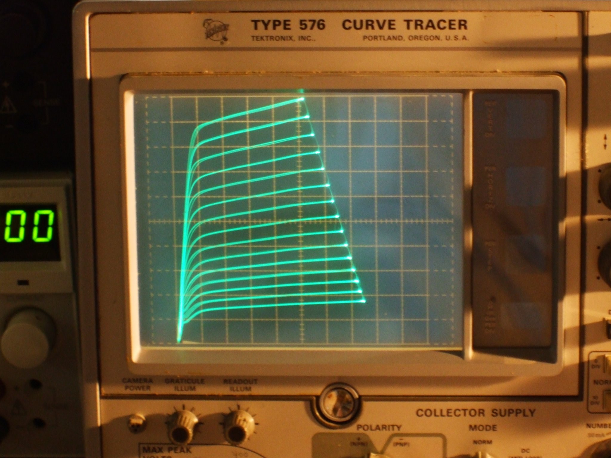

I had the good fortune to use and support the Sony-Tektronix 370B curve tracer.
The old Tek 576 curve tracer is near ideal for converting to vacuum tube curve tracing, since it is a dumb and straight-forward design. (no CPU) I just added a pot in the Fdbk loop for the step generator to change the gain, and put HV transistors in the step amplifier circuit to handle 250V. Then a boost power supply for the step amplifier got added, which can be switched in or out. Some caps and diodes around the step amplifier got upgraded for the higher step V too.
Can do up to 170V total for steps now, instead of the stock 20V.
The Tek museum recently de-assessed two of these for cheap ($100 IIRC, or something else dirt cheap). Only kicker was no shipping - ya hadda pick up at the museum. Still crying.
