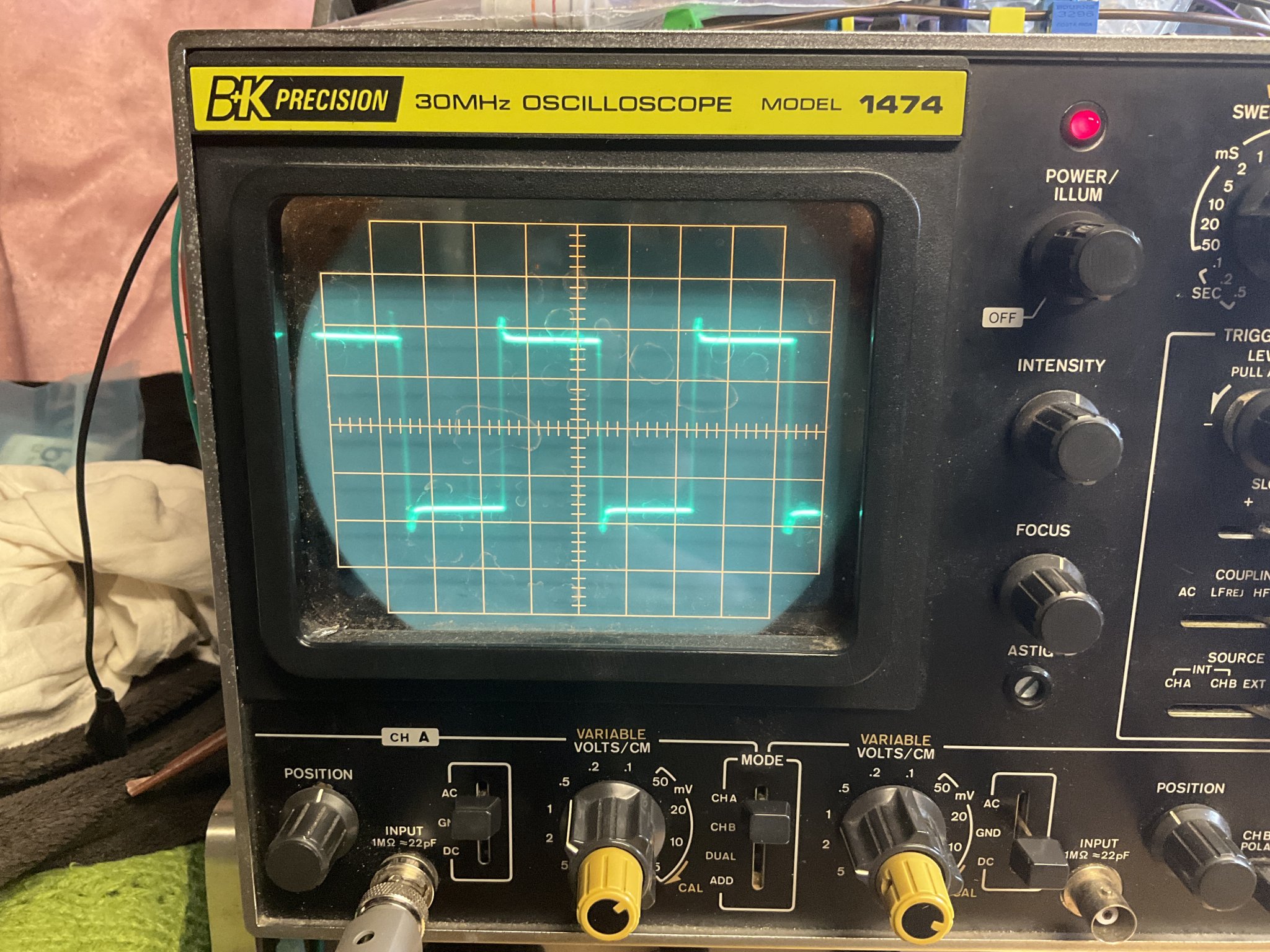

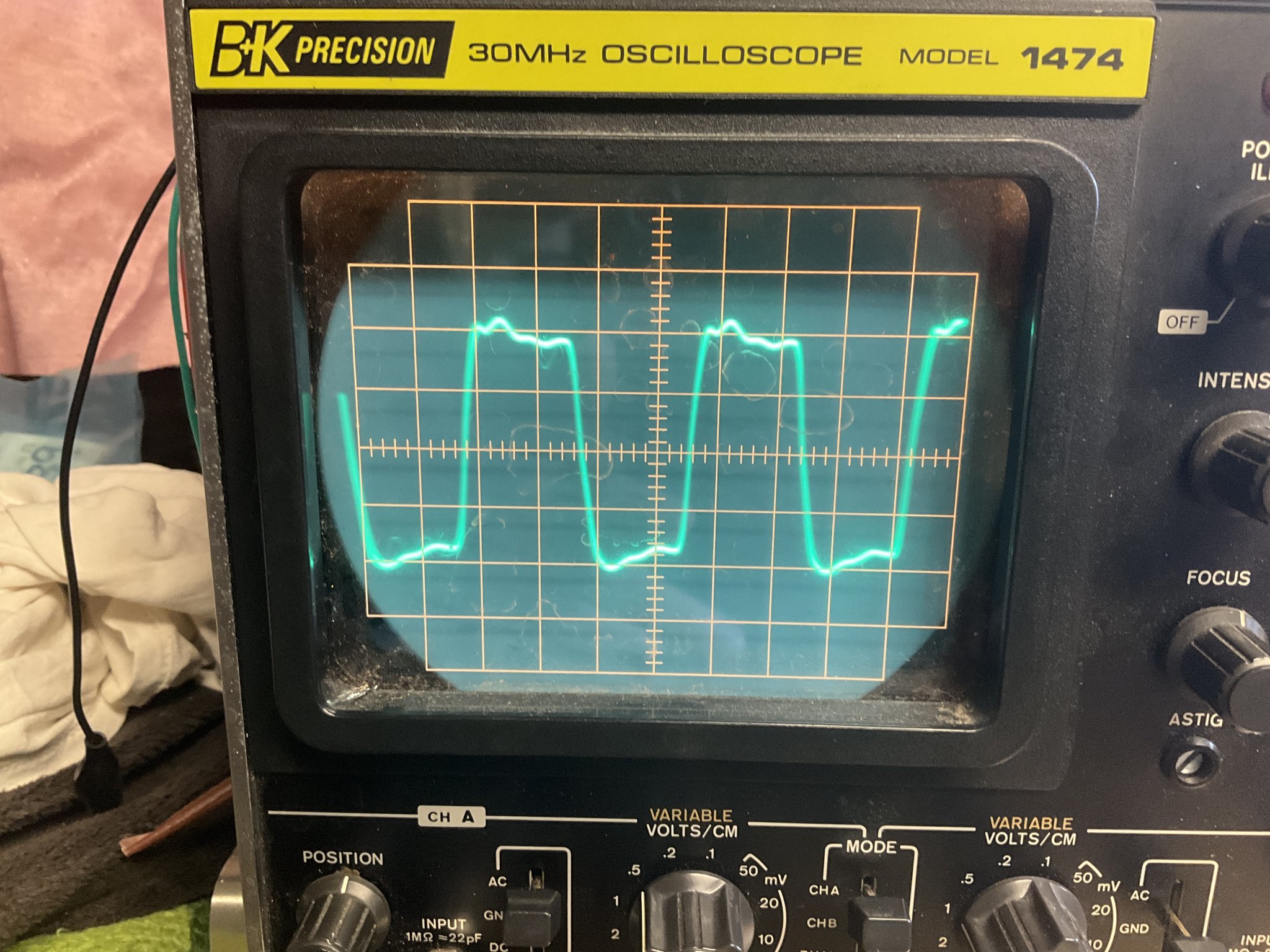

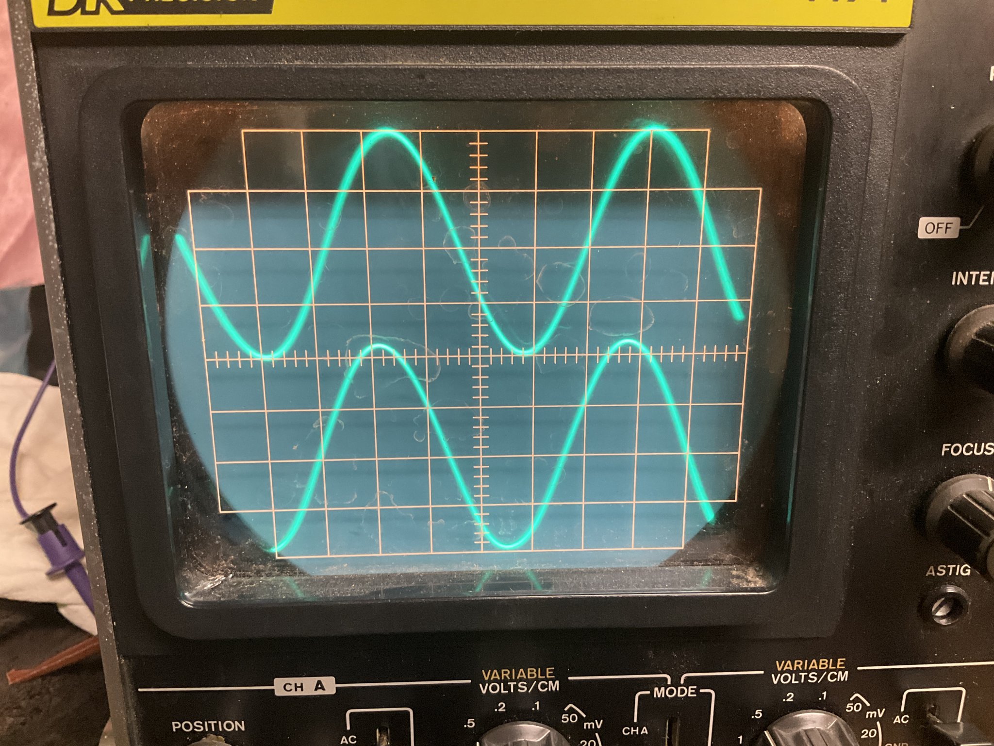

Changed C12/C15 to 10nF it improved square @ 10k. I'm done making changes.
Sinewave frequency response is 20-23k -2db across the spectrum.
Thanks for all the help.
The only way I see to improve response is to possibly change out the output transformer to a Toroidy TTG EL34PP 6.6K OT.
Maybe later in the year.
Lowering the caps anywhere between 20pf to 10nf would improve the response to make it a little flatter. The drop off would be at the top end about -3db.

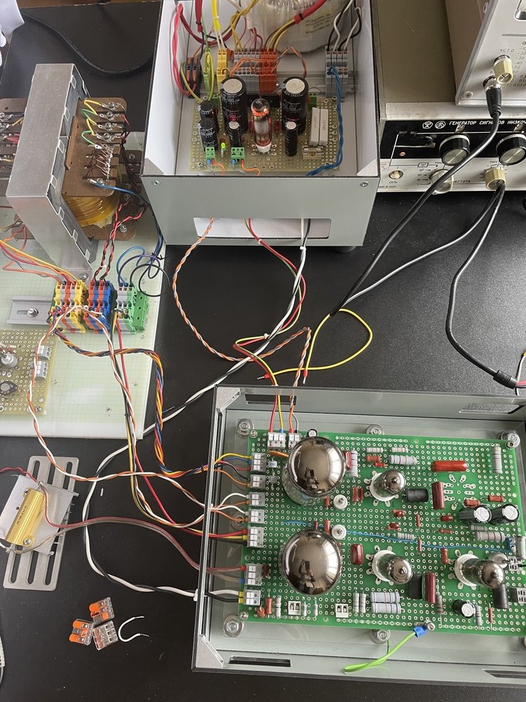

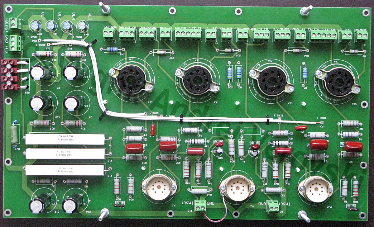

I made a mistake on my rev 4 main pcb. I mixed both the AC heater runs with the signal path. Guess what, got a great AC hum when turning on amp and running. Sorry about that. You will need to cut the heater traces from the input connection, and run new wires from point to point for all the heater runs. Don’t feel bad for me, I cleaned up the board layout and did the same mistake again. That’s part of leaning and old age.
I apologize for this oversite.
The first version Rev 4 that I posted looked good on the bench BUT had a terrible turn problem when turn on in my system.
See MP4 video below.
I'm working with a friend that more experience and better tools to help solve this problem. He does believe it can be solved.
We are working on it, but it is going to take same time. He can help me only when he has time on the weekends. His business comes first.
My friend is being nice to me, He said that I was to close to give up. I'm very fortunate to have his help and time.
I will post our results when we figure things out.

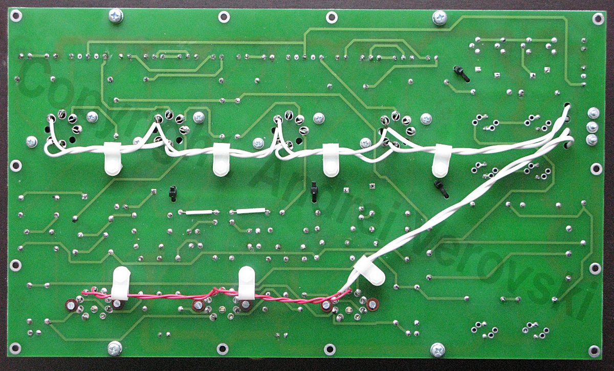

I think running heater circuit as PCB traces was not the optimal solution. Separate twisted wires is much better option. Sample PCB photos attached, albeit its not Citation II clone.

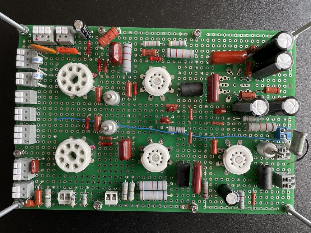

I build Citation II clone with 3.9K 33% UL-12% CFB, and modded its LTP, which at first sight, had quite strange balancing resistor net which I had simplified. It was a BIG mistake. Finally I balanced LTP with closely matched tubes. For whatever reason got only 50W of output before visible clipping, probably because of my LTP mods. Due to many re-solder attempts prototyping board now have too many chipped off soldering pads, is barely usable and had to be scrapped.
