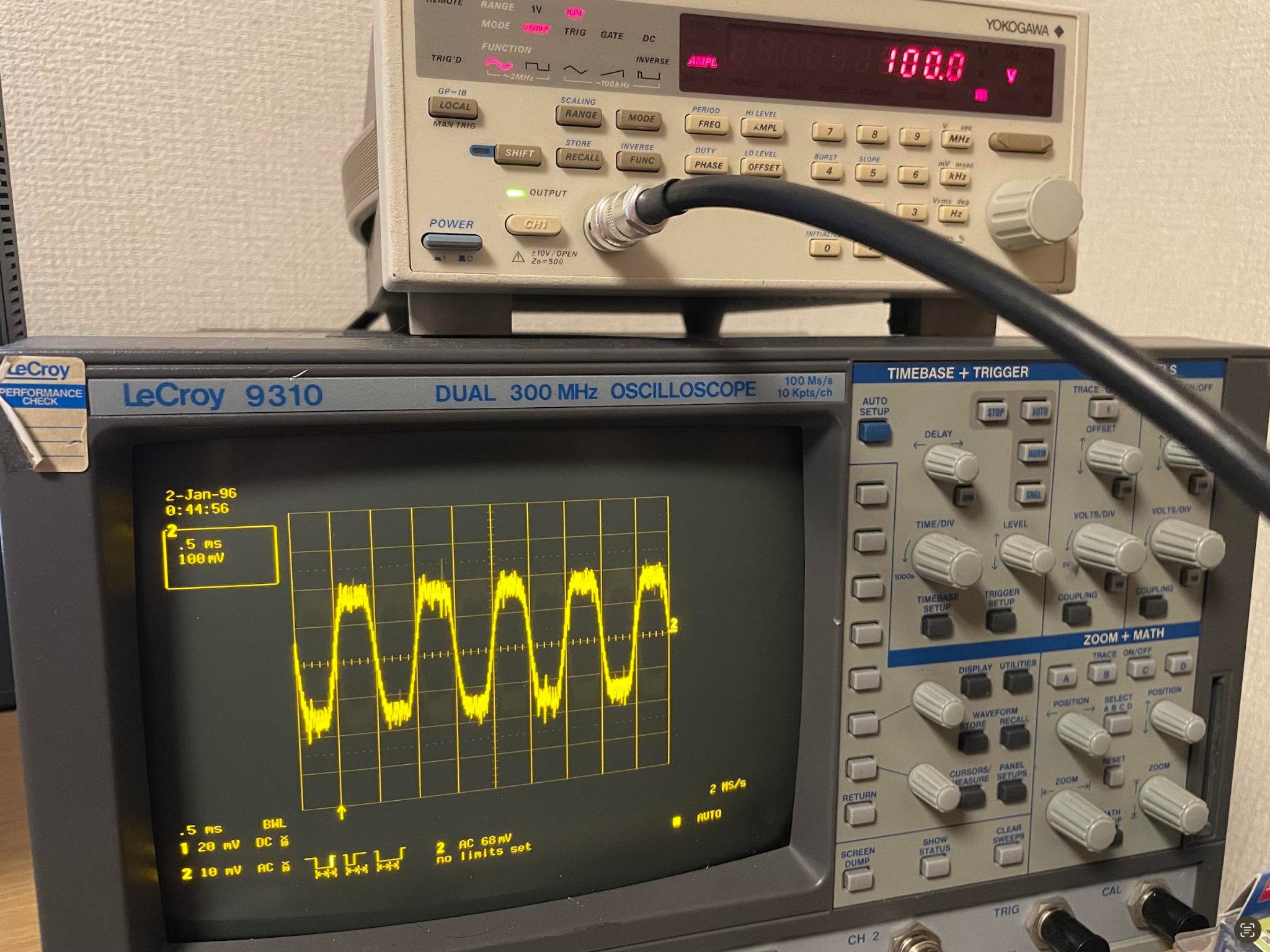

So the definition of the grid would be,
  1. Every major block on horizontal axis maps to the set time division. In total 10 blocks. Time division set as 0.5 ms, 1 complete period per 2 block, so that would be 1 ms period as I set frequency as 1 kHz. Corresponding.
  2. The voltage number at lower left of screen would mean voltage difference per block vertically, as I tested different input signal amplitude. Not sure why the voltage division on screen left is 5 V.
Based on this and assuming the previous output wave I got is 1st harmonic + 2nd harmonic, the capture would mean, 60 nS per period, which would be 16,667 kHz, roughly 120mV p-p. I believe at the time I set input as 1 kHz 10 mV p-p from my signal generator.

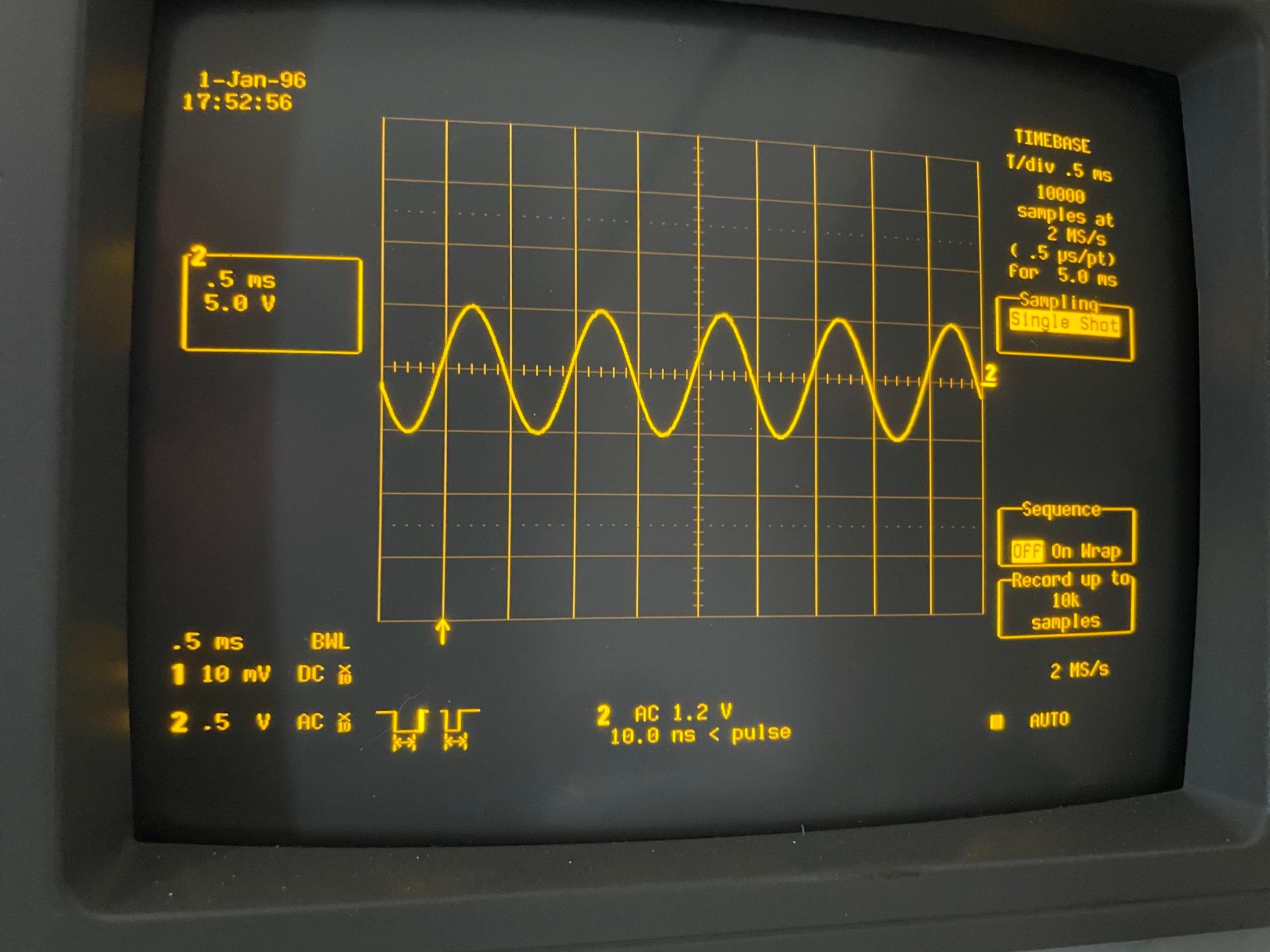

So after a few try setting time interval I was able to get to this.
What I don't quite understand is, I had to turn input up to 900mV to get this stably visible wave, 100mV it would just be a slightly twisting thick band, not readable at all.
I recall CDP and DAC generally do 2.0~2.5V p-p at output, but considering the volume knob resistor on amplifier, I dare not go further much.
I could get an almost sine-looking wave at 1200mV. But on the original paper we don't really turn up input level during front stage testing and tuning.

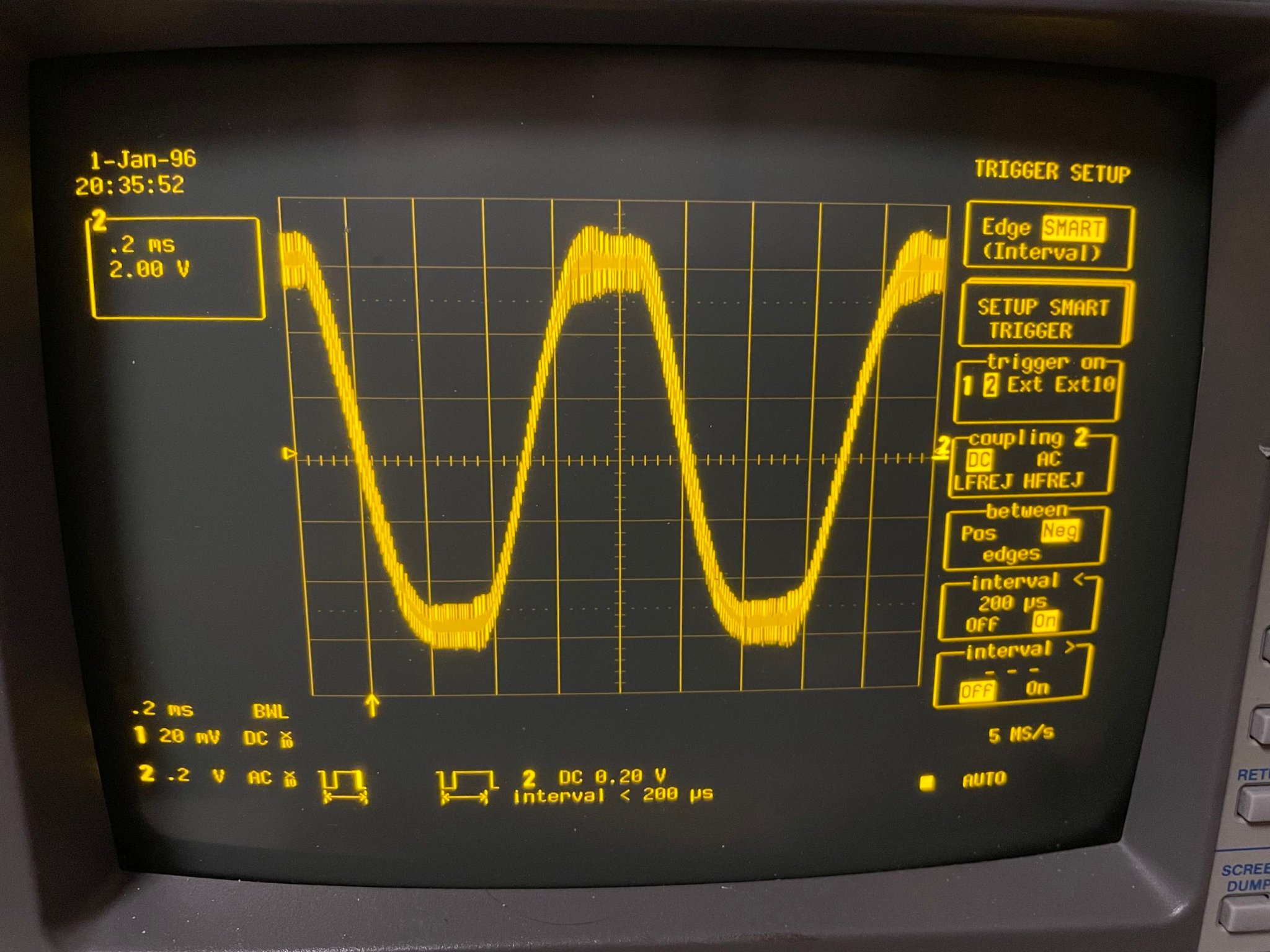

To clear up how the front stage behaved.
I could get the wave form coming out when I tune R7 R8 down to around 0.2v.
As I tune R7 R8 up towards 0.9V the wave form shrank down to a horizontal line. Just noise, we said.
The wave won't survive past ~0.27V, and looks like a clipped sine wave.
Looks like something is wrong and in a very simple way?
PSU voltage, Z1 Z2 voltage, R9 R10 voltage are correct. DRV+ DRV- voltage ~6.1V.
After reaching 0.9V at R7 R8 and output offset voltage low I can still get the same clipped looking sine wave, just tune signal up to 600mV the wave form will come out.
And I never got 2V AC output.

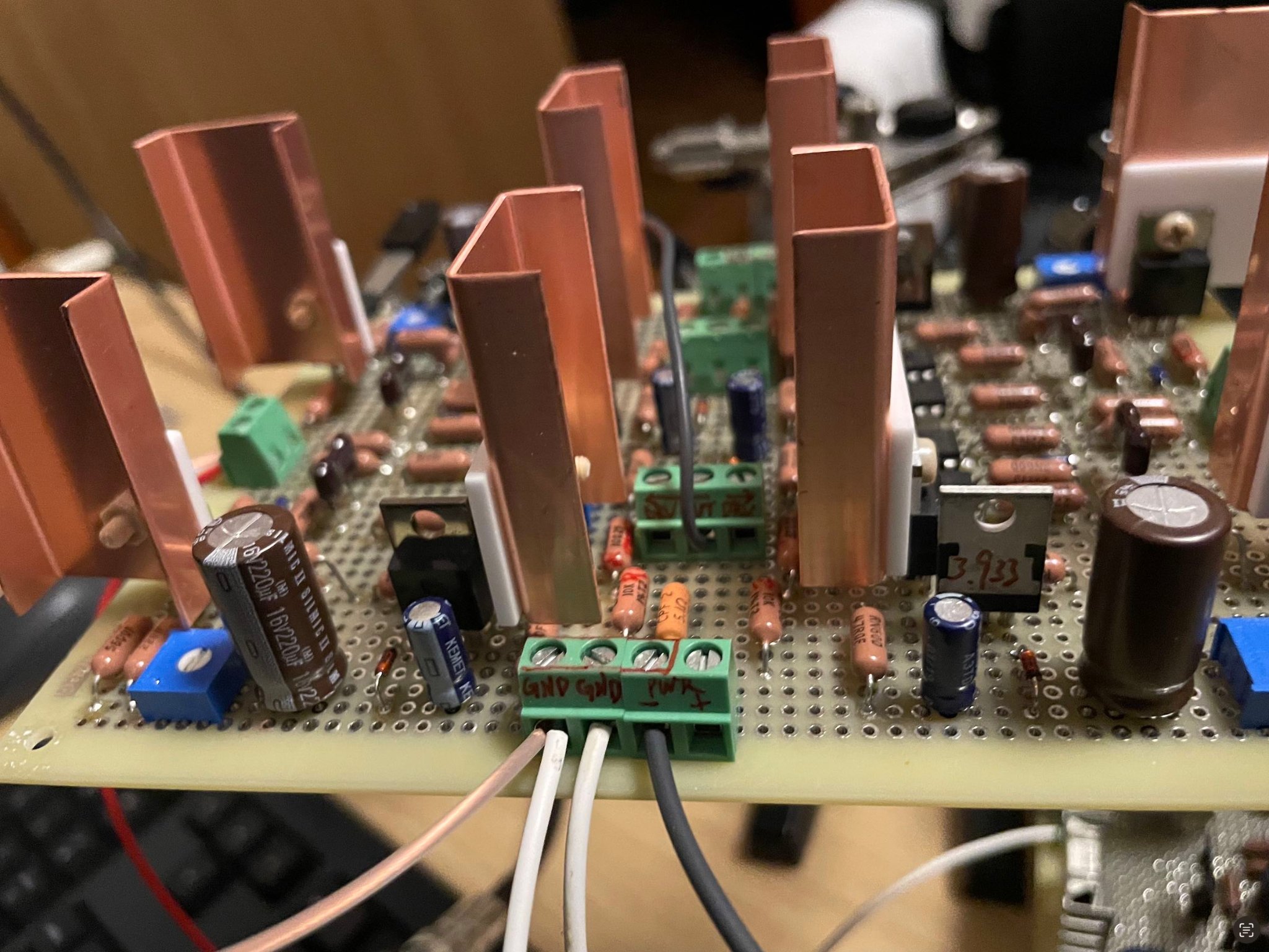

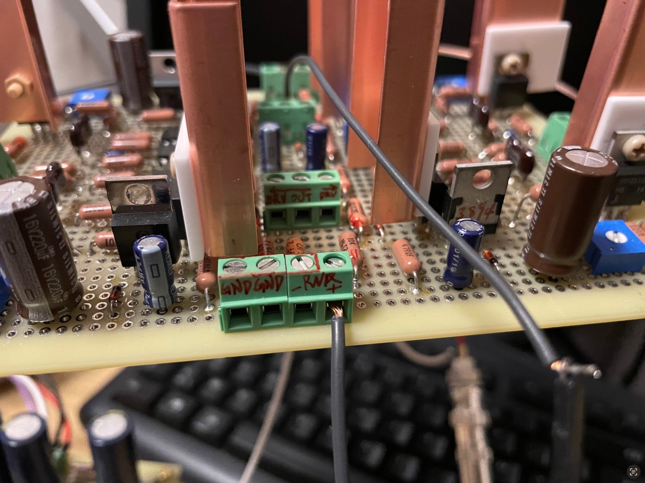

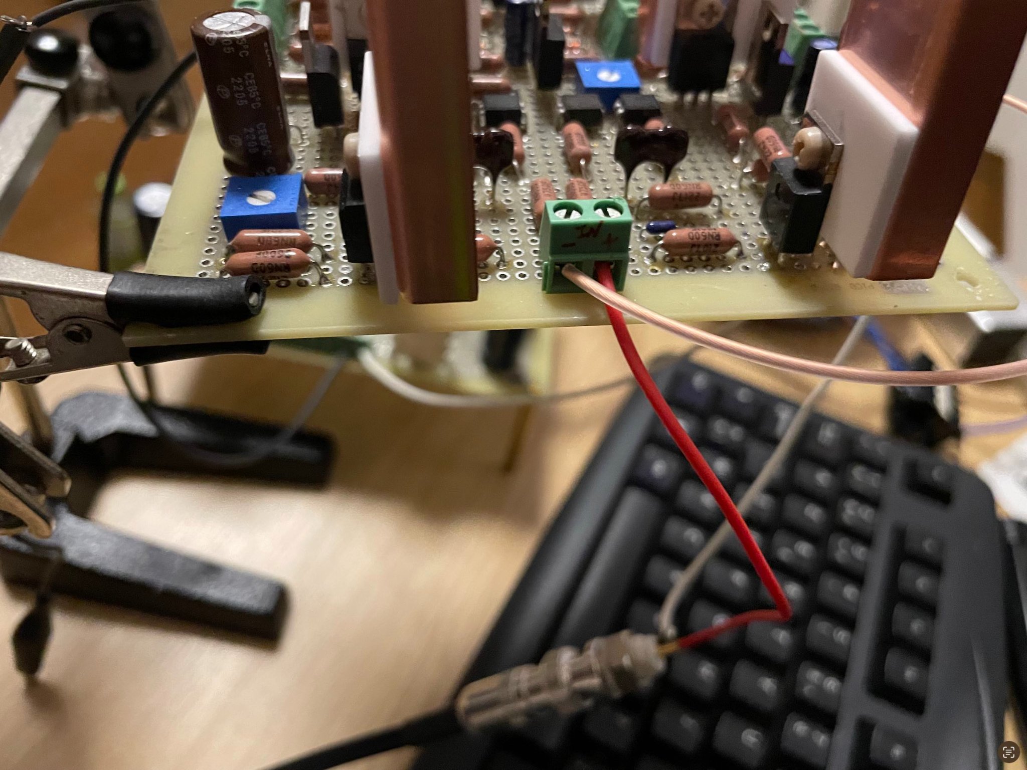

DRV+ and DRV- is the bias voltage for the power transistors. It is set by trimmer P3 - Q11. The voltage DRV+, DRV- is measured against the output - behind the resistor R81.
Power transistors open at a bias of approx. +4V between Gate and S for N channel and -4V between Gate and S for P channel. This pre-voltage is limited by diodes Z3 and Z4 to a maximum of 9V.
If you have this voltage around 2V or less, you can connect power transistors without any worries. Then you can increase the voltage with the trimmer P3. When increasing, measure the voltage on the sensing resistors R34 and R35. For a start, it will be enough to set 0.05V on them. Then you will be able to set the output offset realistically and correctly.
1V on resistors R7 and R8 means a current of 20mA flowing through these resistors. It is DC voltage and current. Do not connect the signal generator to start setting. But connect the terminals IN+ and IN- to GND. It's as if you set the potentiometer at the input to minimum volume.
