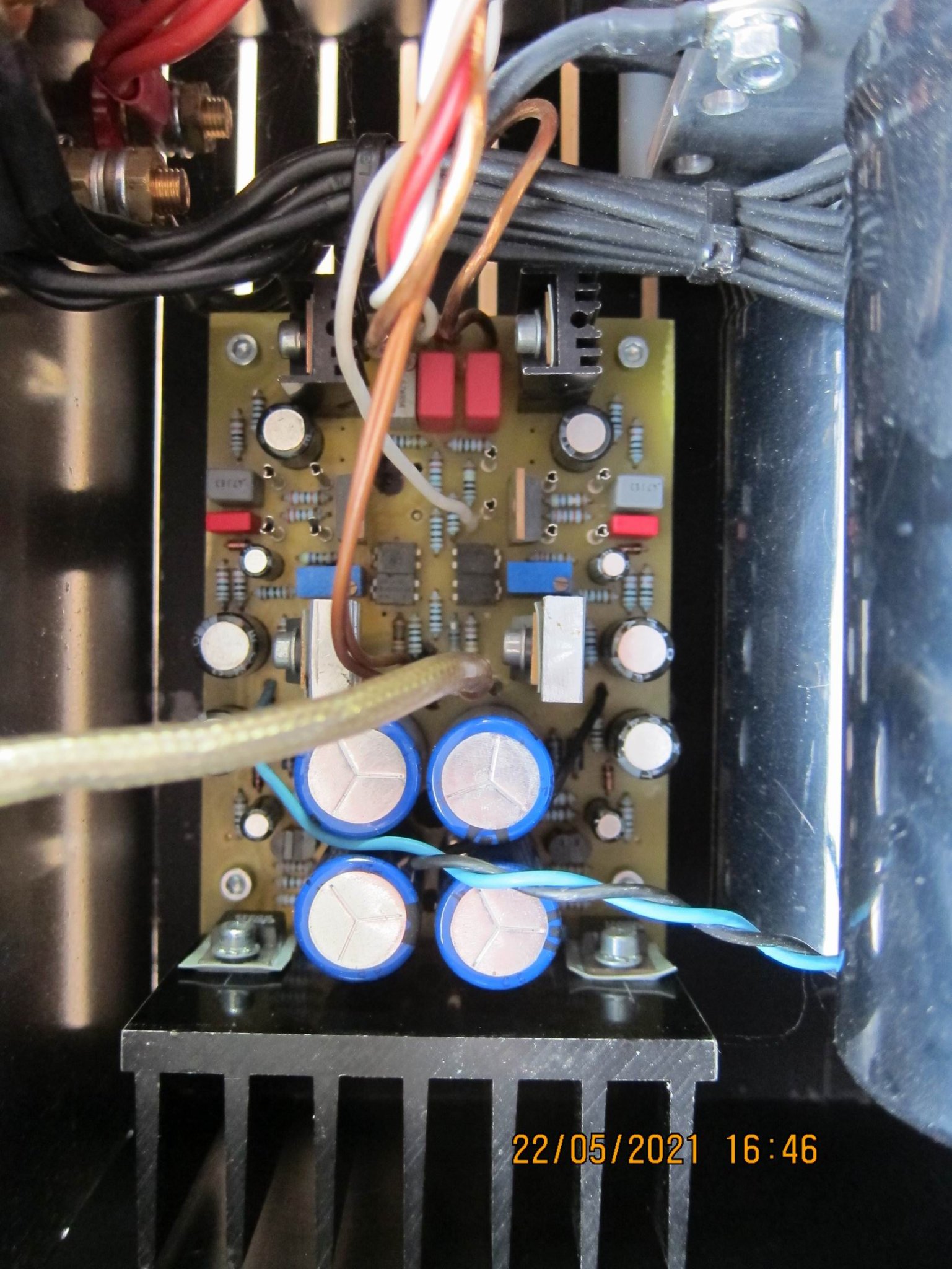

Hi @seann
Nice to see a build of a A75.
Not sure where you are at your build right now, but once you have a look at the construction of the front end, I can recommend having a common heat sink for all the front end mosfets. This will make the amplifier much much easier to trim, due to temperature change, heat up etc.
Regards Mikkel
Regards Mikkel
