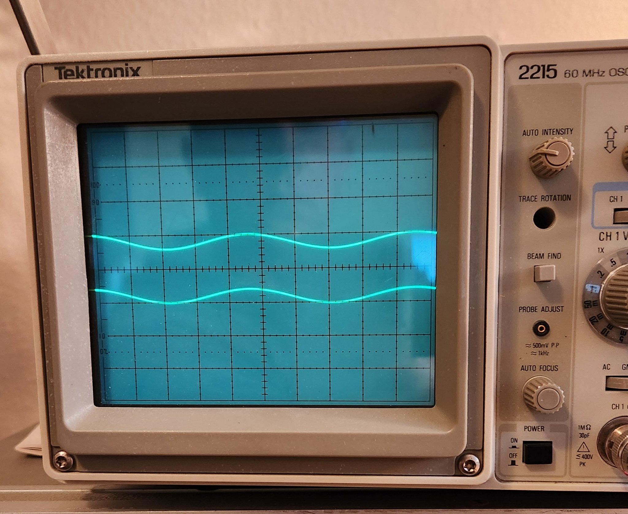

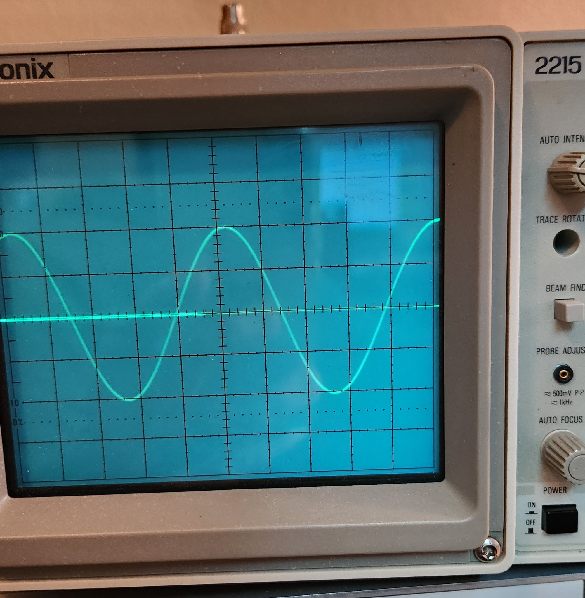

Curiosity got the better of me. Plus, it's been a long time since I built the amp and had it apart for cleaning..
So, I took the cover off. Removed the fuses to the output stage. Removed the R81 output stage feedback jumper. The output stage was wired but not powered.
Switch in unbalanced mode. Shorted the (+) inputs.
Checked the DC voltages across the biasing resistors.
R9 and R10, 10 mA feeding each differential pair, check, the same as 20 + years ago. Wow
R7=1.063 volts, R8=1.066 volts. divided by 47.5 ohms, about 22mA bias. Check
Output offset 20mV measured between R23 and R24. Check
DC drive voltages. +DRV, 4.00v. -DRV, 4.05v, Check
Connected signal generator to + input of one channel at 25mV, 1Khz. Output measured between R23 and R24 equaled 0.727vrms.
For a gain of 29.08. check
Distortion was .02% The front end is operating folded cascode with R21, R22 at 100 ohms
Looking with the scope set to DC mode I see the wave form at the drive terminals shifted the +/-4 volts dc. Between R23 and R24 (output of front end) wave form with no dc. Well, 20mV
First pic is 5 volts/div. One scope channel at +DRV and the other channel -DRV.
Second is 0.5 volts/div of the output between R23 and R24. You can see its half the DRV level.
NOTE: When R81 was in (shorted, max feedback) there was some interaction between the non-powered output stage and the frontend, and it appeared that there was no signal present to the feedback network?? I measured a gain of 45 at the DRV terminals.

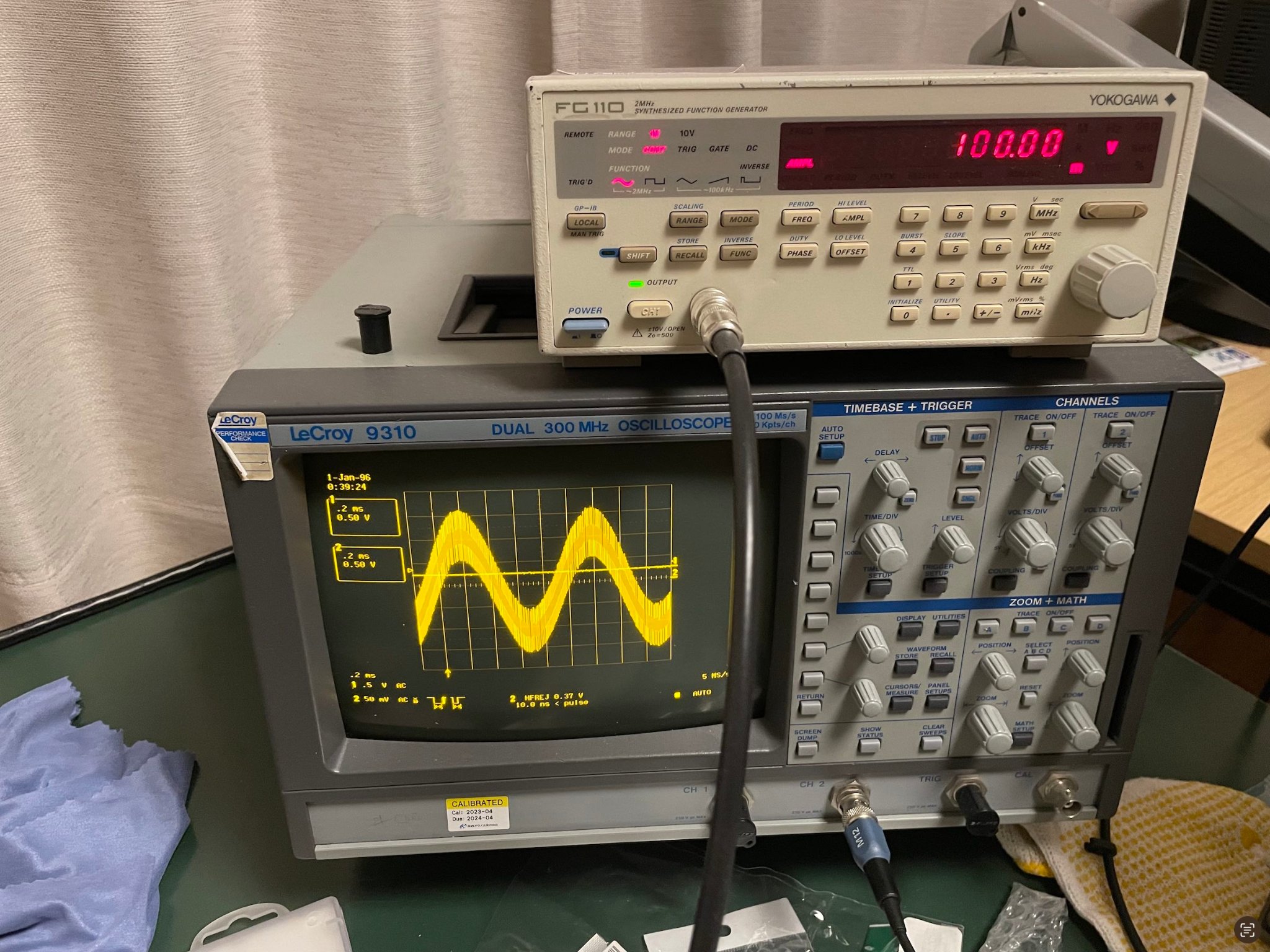

Hey everyone, I wired up with one pair of output stage and tested.
With signal input connected (signal generator), I got a Sine that looked pretty Sine and time interval is correct, 1kHz, although it looked a bit noisy, probably because I forgot to check again output offset when I tuned the trimpots a bit?
Belows are what I measured this time.
R8 ~0.9V R7 ~1.1V
No R81
Sine wave input 100mV
+DRV 0.69V -DRV0.55V
R34 R35 0.018V
But I still only get noise when I tune signal level down to some 30mV. At least things seem to be working.

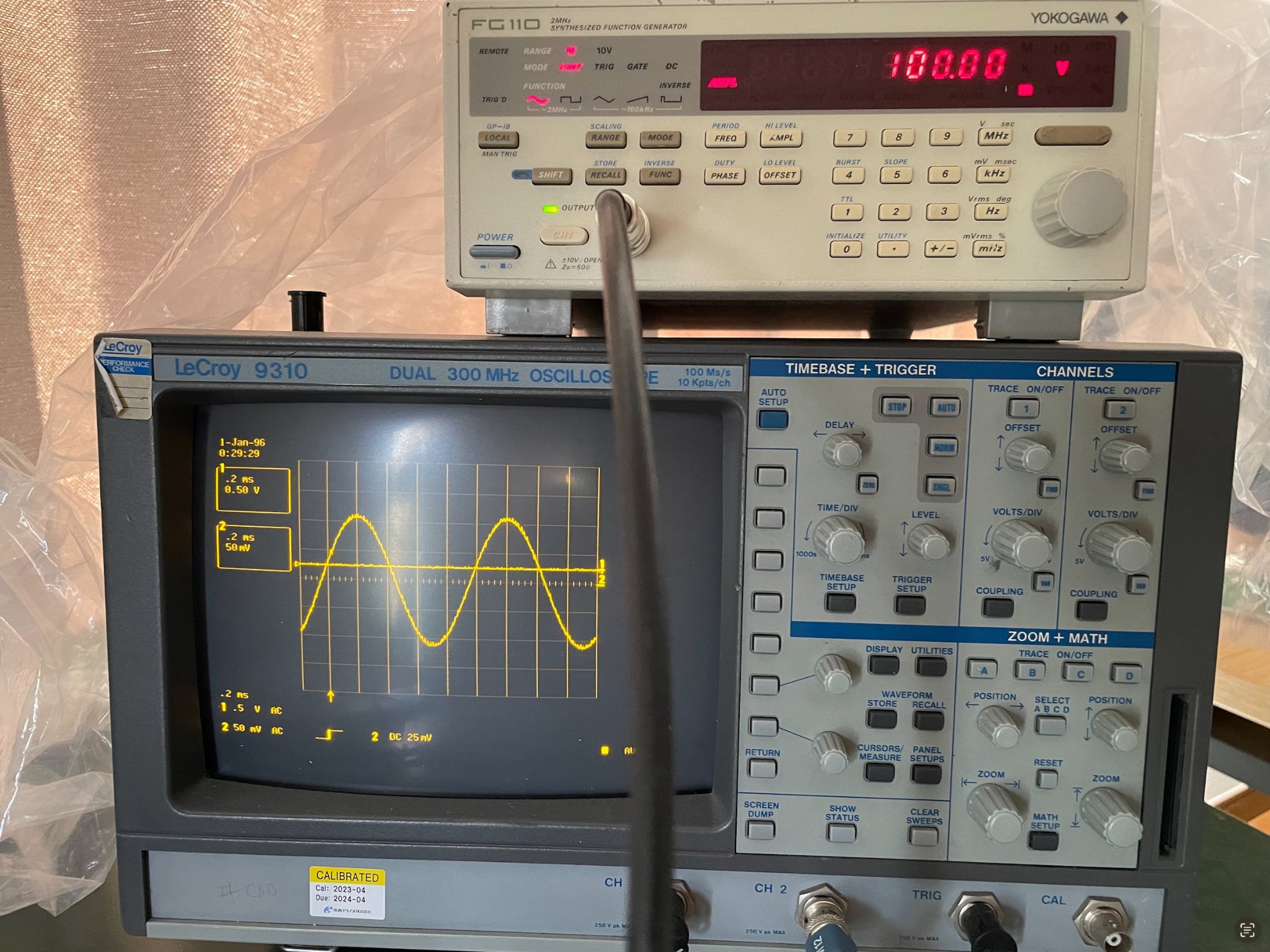

So I got my additional DMM. It really is the correct way to go.
The channel I was testing always has a 23~26mV gap when output stage disconnected. I think not an issue.
Voltage across Z3 and Z4 (DRV) was some 5.9V.
With 1 pair of output stage connected this time I got a clean signal. Input was same 100mV Sine wave.
The voltage I got at output resistor R34 was some 0.010V, voltage across DRV also was some much less than 1.0V number.
But R7 R8 seemed to have dropped to ~0.5V so I guessed it just needed some tuning after output stage was connected.
I stopped here for a funny reason: I didn't have no more test lead clips to tune R7 R8. I used all my clips to hook up the cables at output stage.
Now I will just wait until those bus bars are sent back from the machining shop.

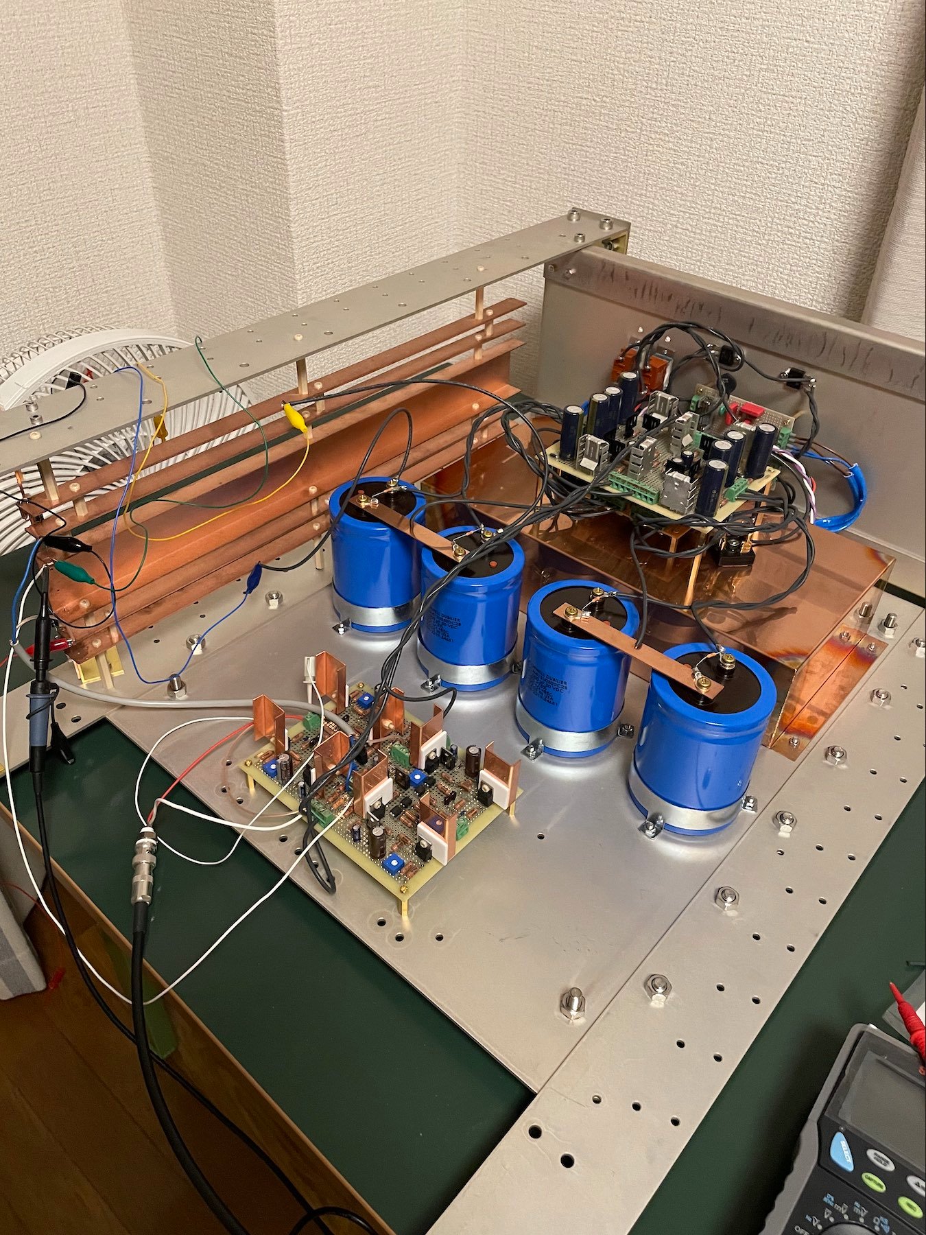

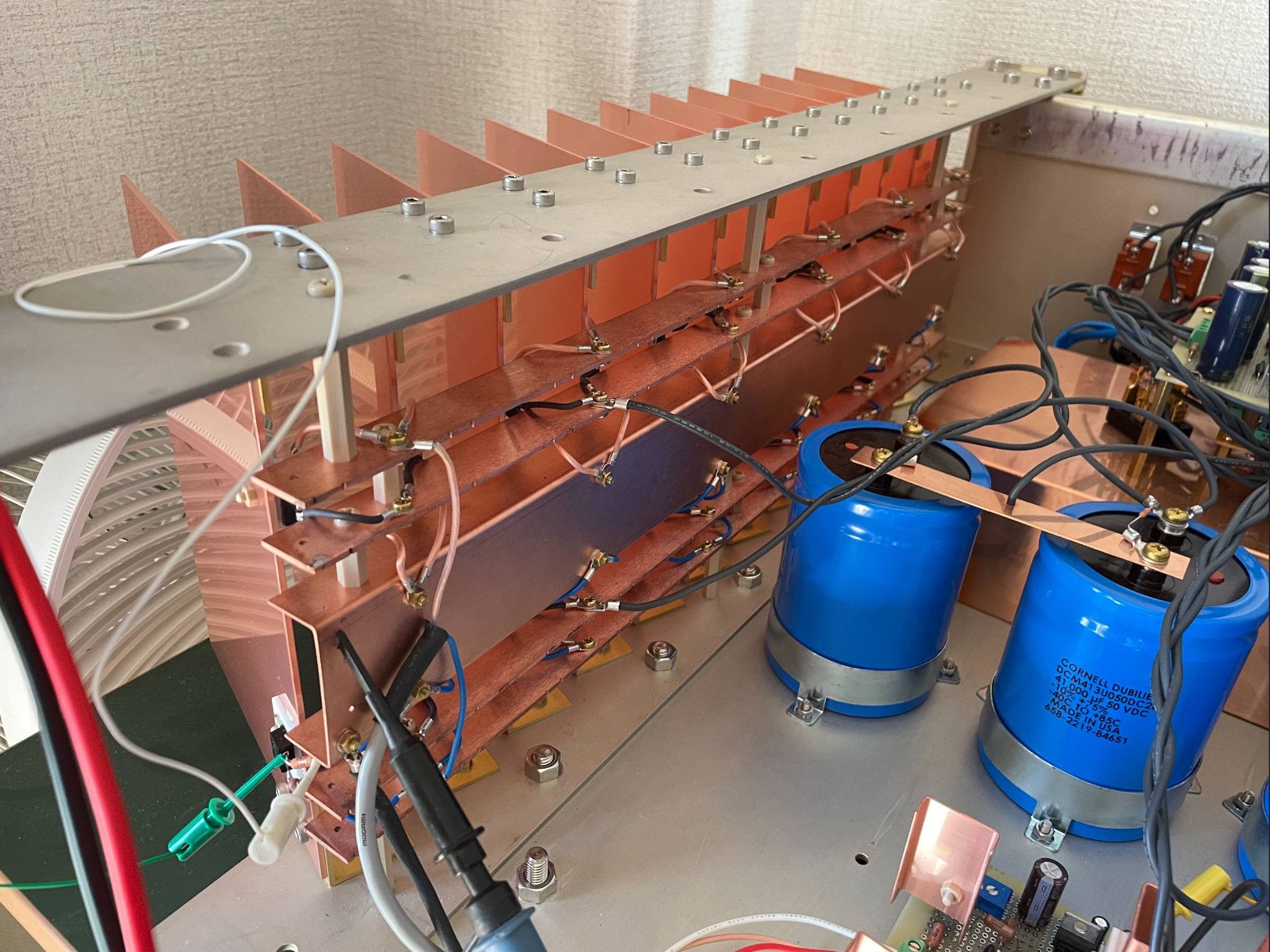

Some updates and a question about output offset voltage.
My output stage design turned out to be a pretty stupid design, took lots of effort putting it together and making sure nothing is shorted.
But it worked. Still got one channel to go.
So I got this confusion with output offset voltage.
I have the whole output stage connected and P3 set to maximum, readjusted R7 and R8 from scratch again to ~0.93V and managed to get low output offset in both 100mV and 30mV 1KHz Sine wave condition. Don't recall exact number but definitely < 50mV as suggested in original text. +DRV -DRV was some ~6.01V.
But do we still measure output offset voltage after P3 is set? (~170mV for R34)
Probably not since as P3 opens R34 starts conducting more current and it returns to ground so it won't be near zero?
I measured ~0.8V DC with 300mV Sine wave input and ~0.6V with signal generator & oscilloscope physically disconnected to the amp.

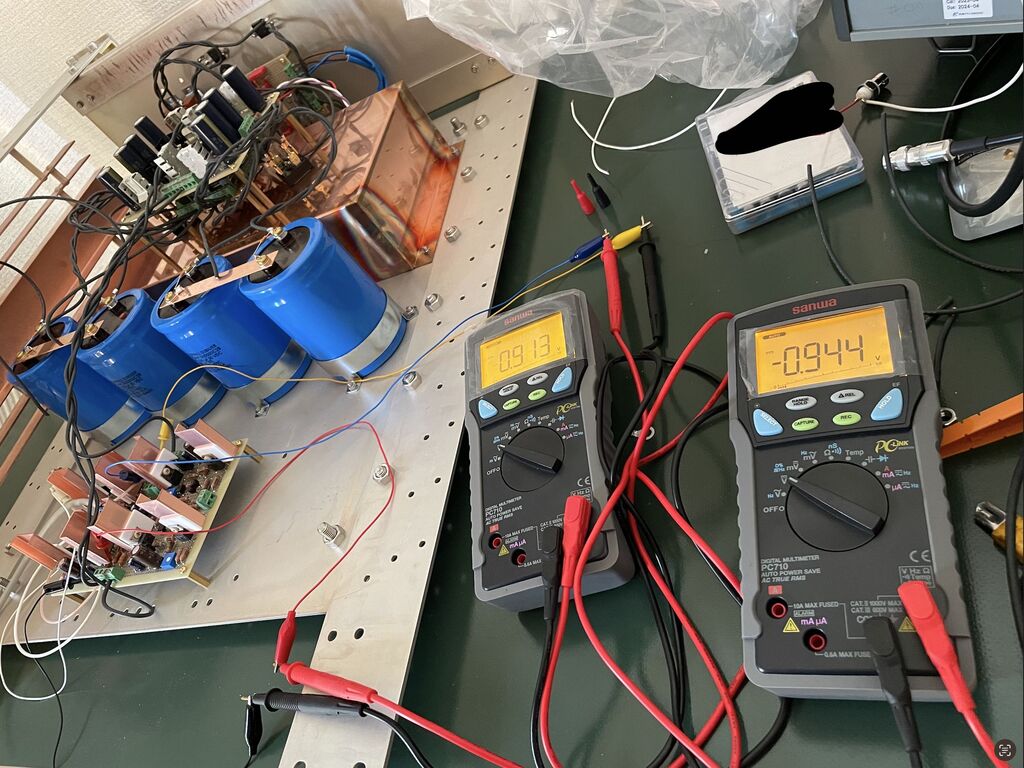

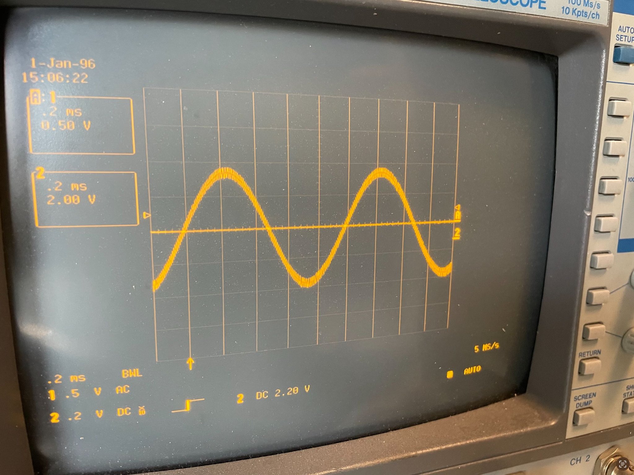

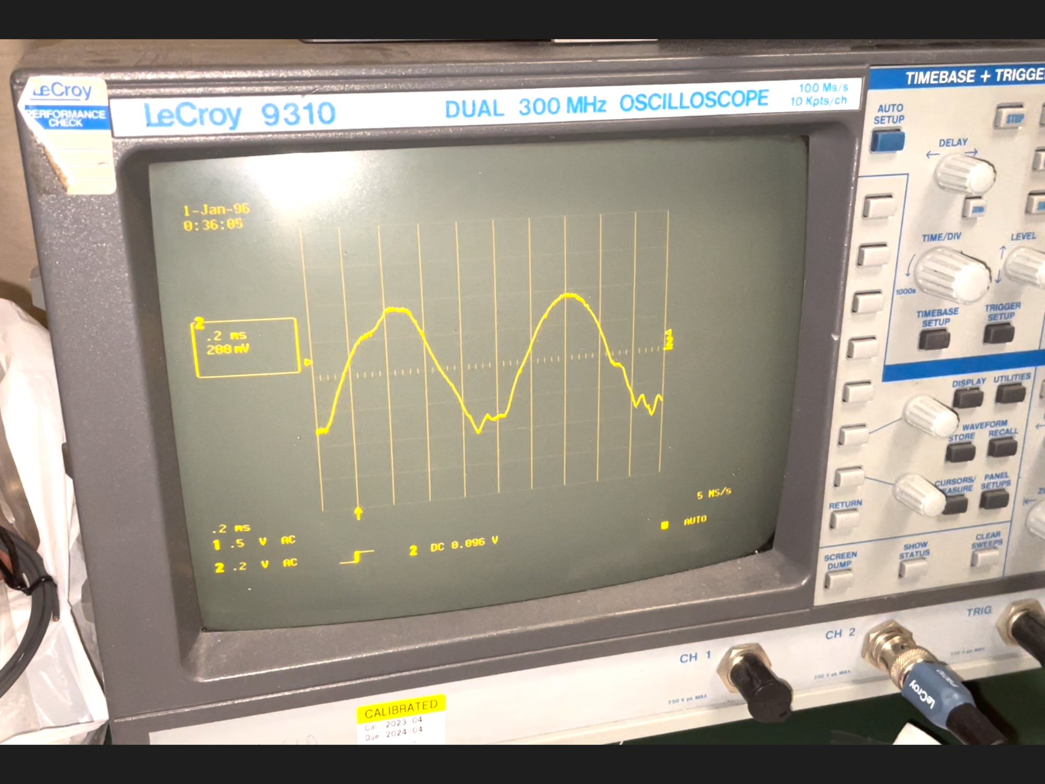

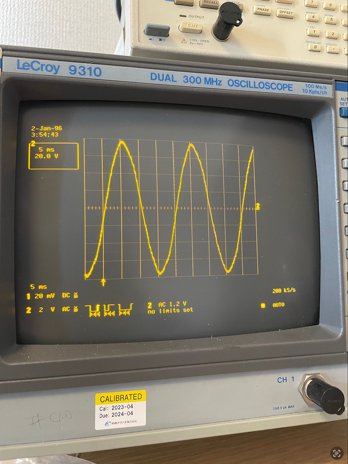

I got our good friend multi-turn trimpot Bourns 3296, and tried tuning R7 R8 using DMM and oscilloscope these few days. Here is what I found and learned (and still learning).
My Sine wave remain clean thin line up to R7 R8 roughly ~0.50V, further going up the Sine wave will go noisy. I tried turning the trimpots in different directions and proportions, the waveform noise seems inevitable.
Aside from noisy waveform and some ~2V DC offset, there seems to be no other problem.
At some point it occurred to me the first time I got the Sine wave on oscilloscope.
I was able to get a clean wave at R7 R8 ~0.9V back in #93 in this thread, and with 25 mV DC offset. At that time I had only one pair of output stage connected. Assuming nothing broke along the way til today, my A75 condition has not changed. I also assume I set the oscilloscope correct at that time and that 25mV DC is credible.
So now it got me interested and one way I might find out is disconnect output stage pairs 2 pairs at a time and see, is it there is some integrity issue with my poorly assembled output stage, or somehow my long circuit (all those cabling on the MOSFET) caused this problem that once output stage pairs build up, something go wrong?
Or, I can do that while assembling the remaining channel, measuring with each pair installed.
I have disconnected 4 pairs of output stage so far, what I got on the oscilloscope is still the same. So my suspicion with assembly integrity is getting weaker. And with P3 going maximum I still got same noisy waveform once R7 R8 past ~0.53V. Some how now when that front stage current feed go past 10mA the waveform starts getting noisy.

@Fero_11
Thank you as always.

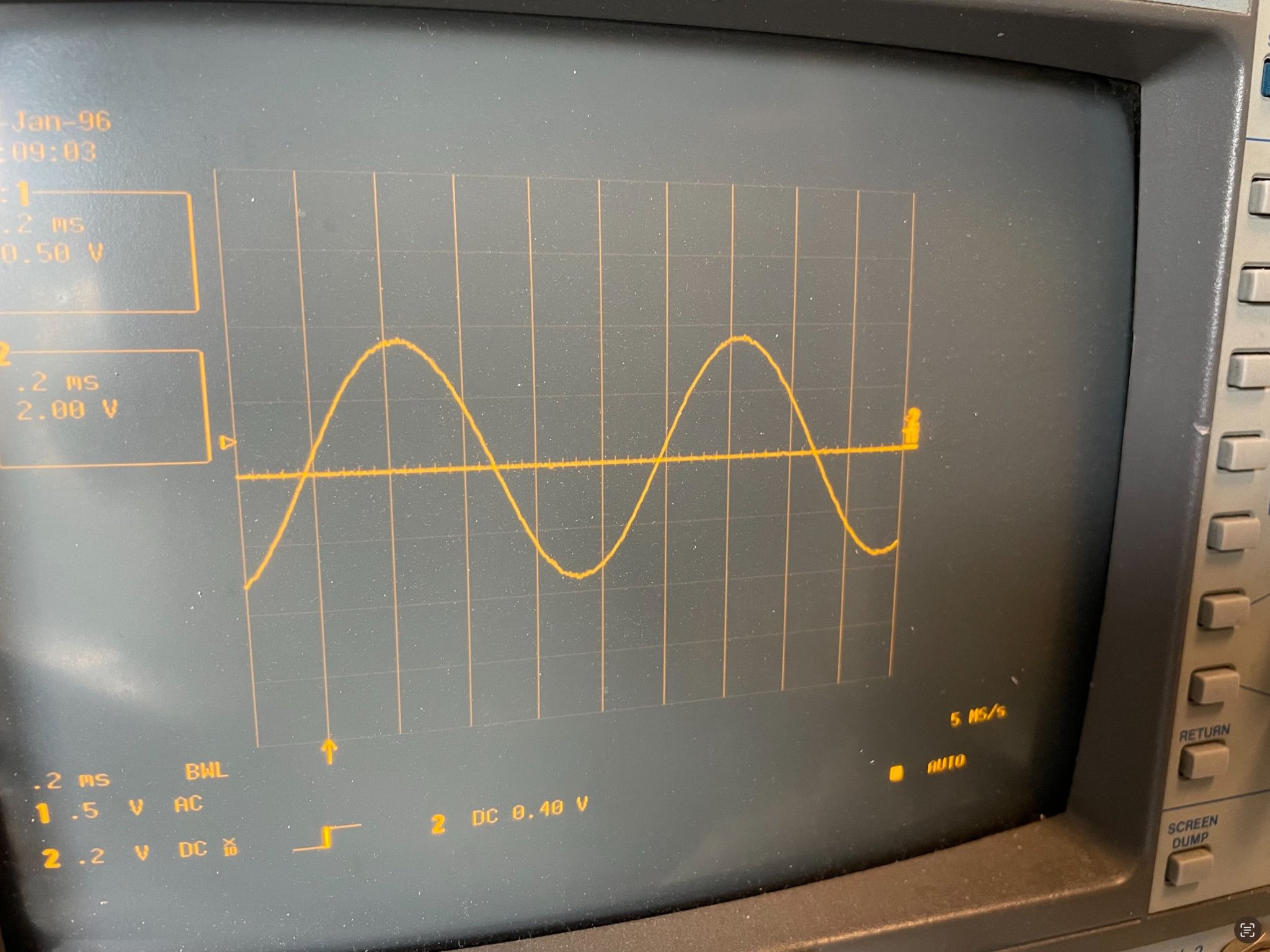

What I found interesting was that DMM seem to become a significant load to my circuit.
My reading on R7 and R8 will bounce when I only connect to one of them, because the value always drift when I connect the other side with DMM, and then settle. Maybe with both sides loaded they are now settled?
So here came the question, that how many DMM is enough? Because I still need to measure DC offset. This was also the point I started thinking hmm that mighty oscilloscope should be able to measure offset voltage right? I had tried no input signal and input grounded, now I could try tuning it using the scope.
Anyway I still tried, by tuning R7 and R8, then disconnect and check DC offset.
I was able to find a point of low DC offset, though that offset generally drifts a lot, even after letting it settle. And this attached image is what it looked like. Unfortunately I didn't wait longer see if the waveform could settle.
But I think I didn't set the scope to 10x, which is the probe I am using, so that DC should be multiplied by 10, which is still 0.96V, quite a lot.
