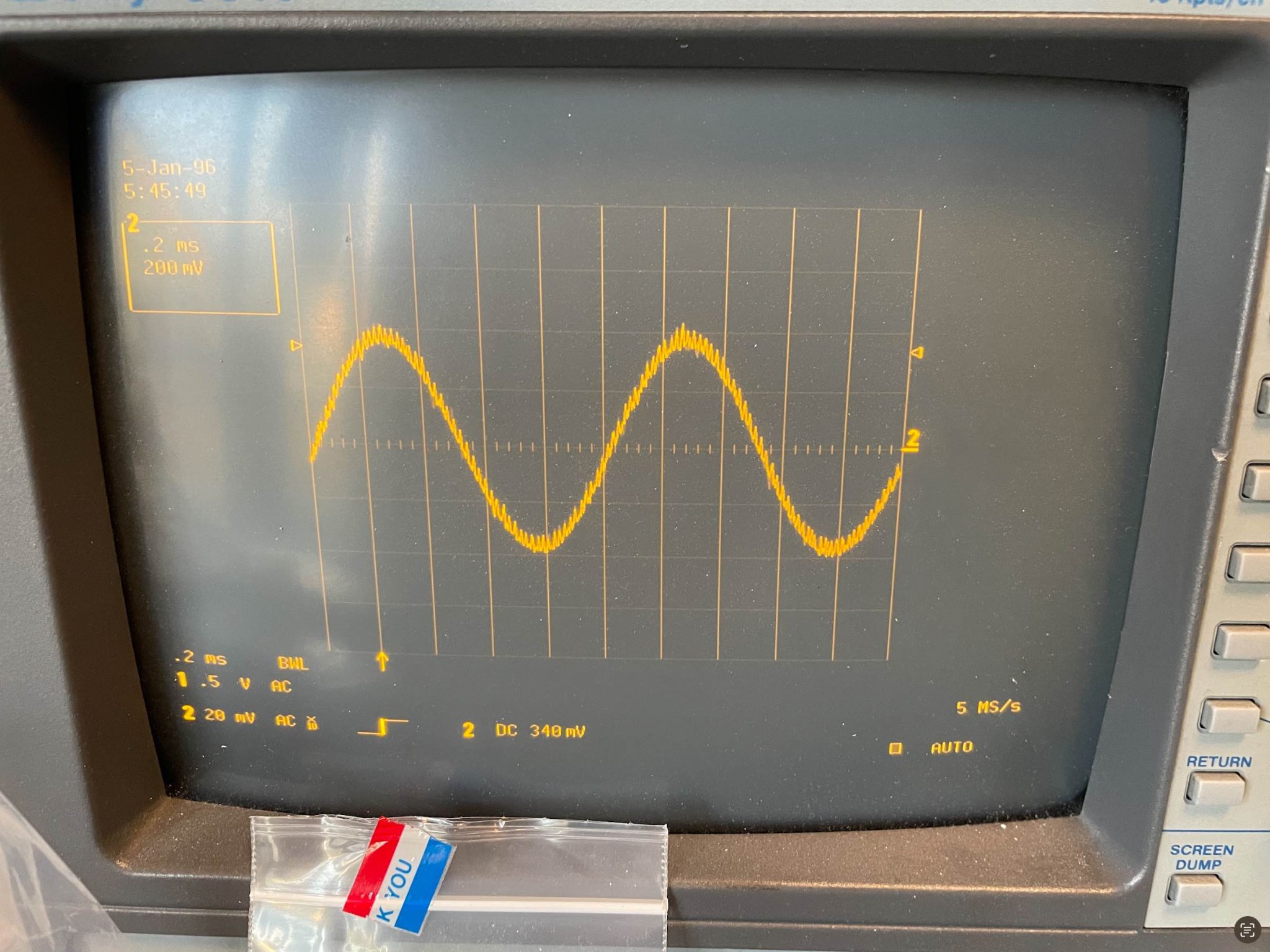

I set R34 R35 to ~50mV.
REG+ REG- both at some ~50.xxV, very stable. UNREG+ UNREG- also stable at ~37V.
I just finished A/B test. Regardless of the tests I have done, the other channel should be intact, so I wired it up, first tested with an existing output stage pair, got same noisy waveform with abovementioned setting. DC output measured using DMM was ~1.7V.
Then I picked a new pair of MOSFETS, wired up and again with same setting. Same noisy wave form, DC ouput ~1.9V. The different thing being the wave form kept 'twitching', no deformation but jumping slightly on the screen.
Next thing I am going to try is try different resistor value for R34 R35. Might look at front stage wiring again too.
I did use a bit bigger UNREG capacitor, that shouldn't be the reason of this..?

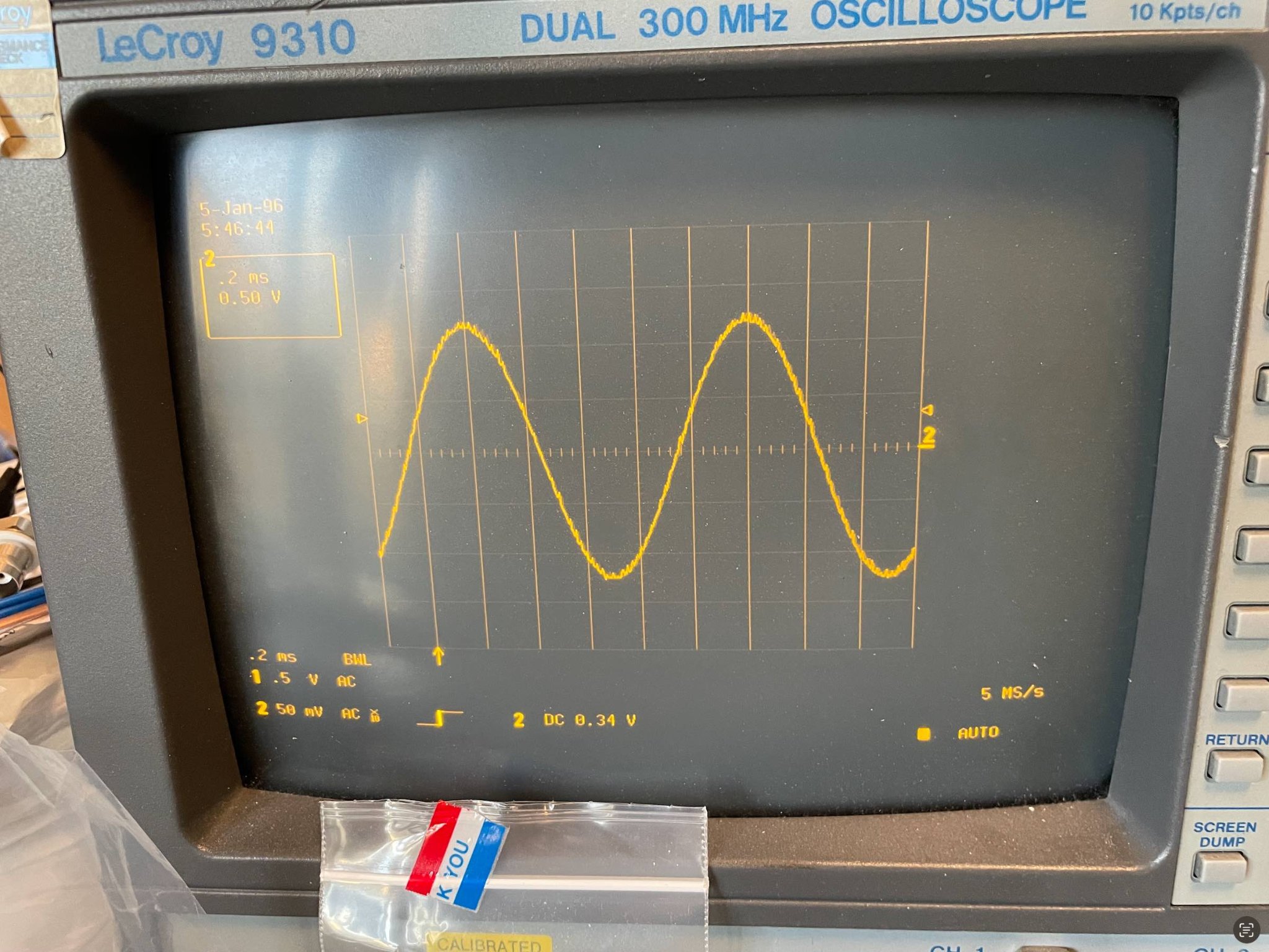

Anyway double checking no live wires are hanging around, shorted input with GND, powered on, checked PSU voltage, re-tunedR7 R8 to ~1.010V.
Set R34 to ~56mV, output offset on DMM was 68mV.
Started tuning R7 R8 to search around, no problem going down to 0mV, it would drift between some -10mV~+18mV. I didn't wait for long to see how stable it can settle in, I still need to re-solder the gate resistors on the other channel so I can do all the fine-tune later.
Sent in Sine wave signal 100mV, clean waveform popped up instantly. Yeah still slightly jagged but based on my previous tries this probably would be the cleanest I could get. Pulling off all those gate resistors again for higher value is definitely possible but I am not at all thrilled with this idea.
Going down to 30mV the wave would become noisier.

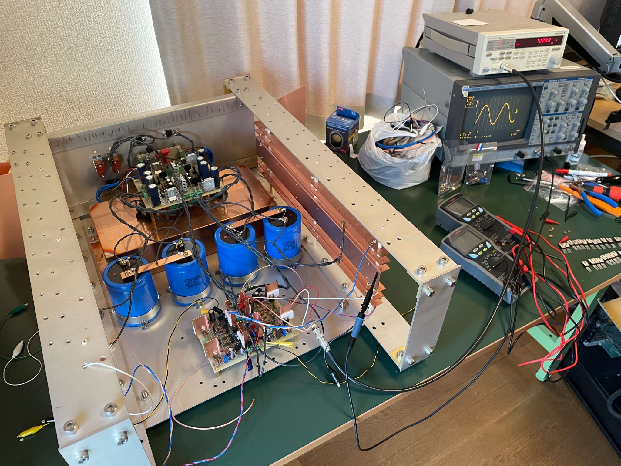

Still a few steps til a fully assembled ready for music A75, but I am a happy man. At least for now based on these test result. 😀
Will still post how it turns out later. Many thanks for the helping.
