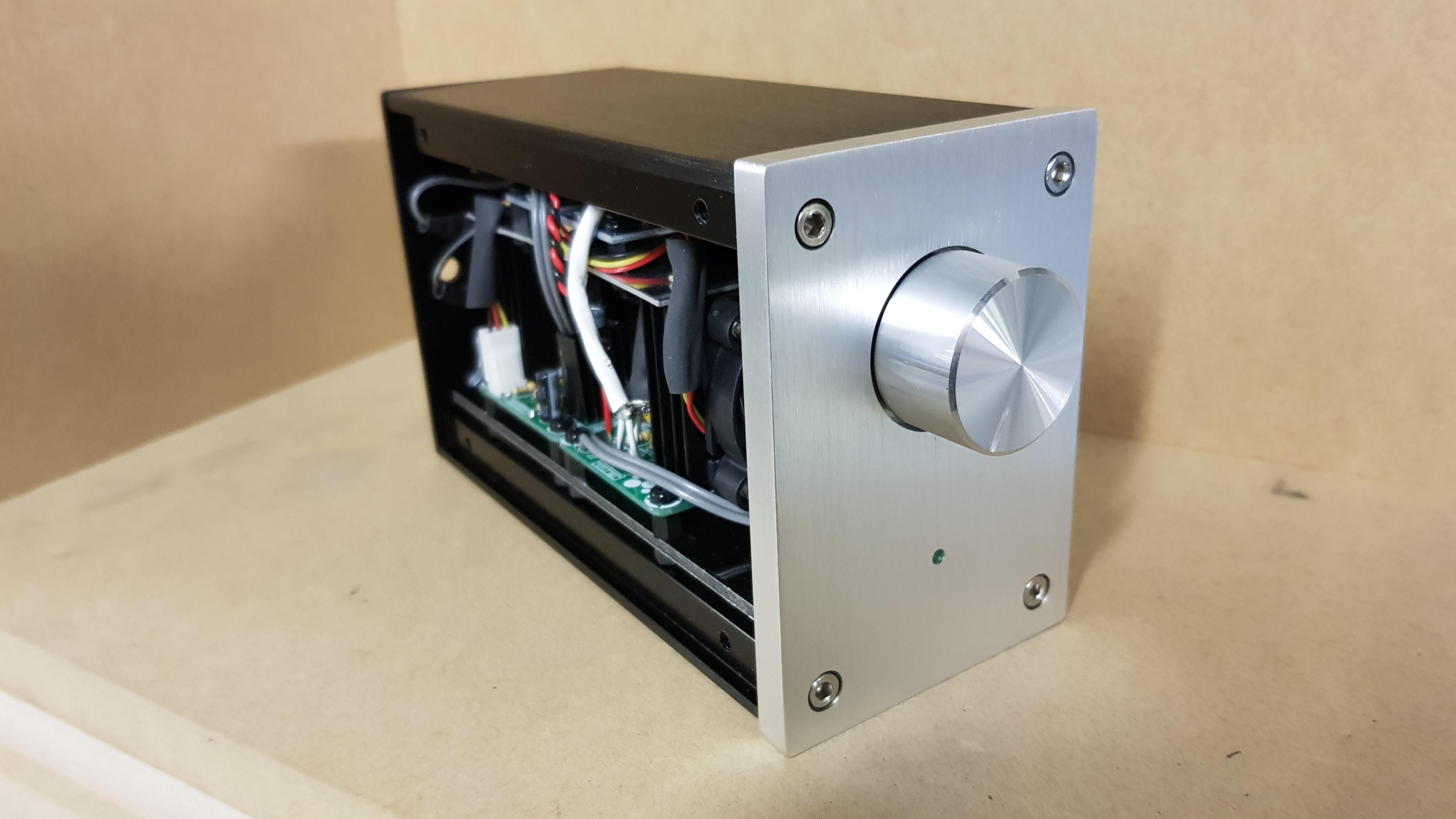

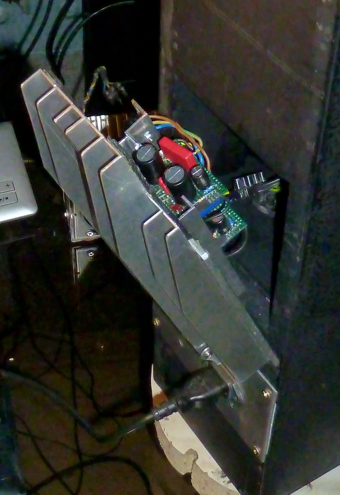

A pair of TDA2050 kits and a Bluetooth receiver squeezed into the smallest case I could manage.
Mostly assembly and figuring out how to mount everything but still an enjoyable side project 🙂
Bluetooth is the only input?

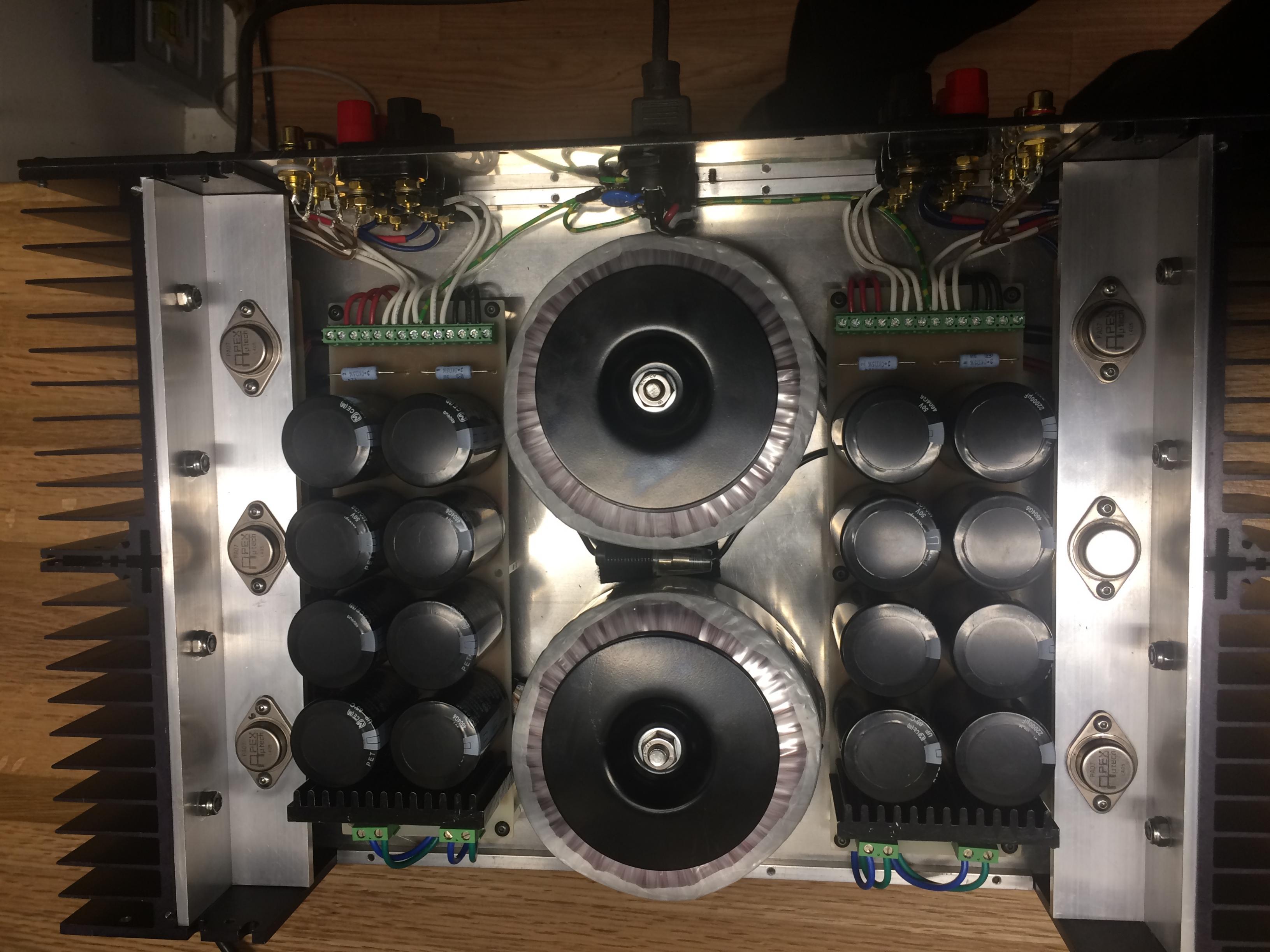

Hello all,
I used Mick Feuerbacher's two resistor circuit.
I wanted to make the simplest and least expensive chip amp I could.
A wooden box. Two transformers second hand on Ebay, bought some years ago.
Junk box items; mains socket, 4 bridge rectifiers, old very robust DP switch, heatsinks from a scrap yard, connectors and single core wire.
And I bought for £16.74 resistors and capacitors from Cricklewood Electronics
I thought it's going to hum with no screened cables, it doesn't
I thought there would be some RF interference, there is none.
In fact it's the best amp I've ever made, sonically superb.
Apologies, I didn't get a notification this time.
Yes, at this stage I am only using a bluetooth input but I have a hole ready to accept a 3.5mm jack (just need to buy the jack).
The bluetooth module has a function whereby it detects an additional input source and it will pass-thru the signal.

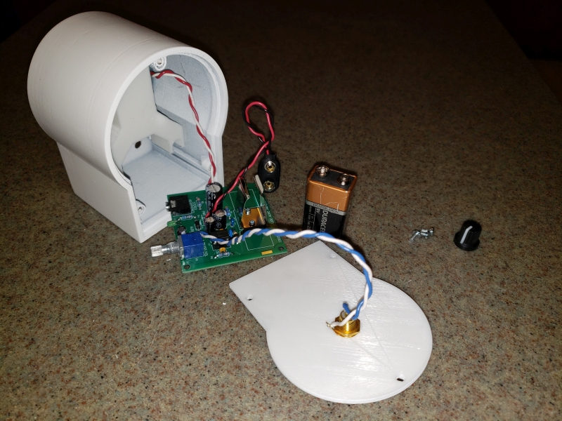

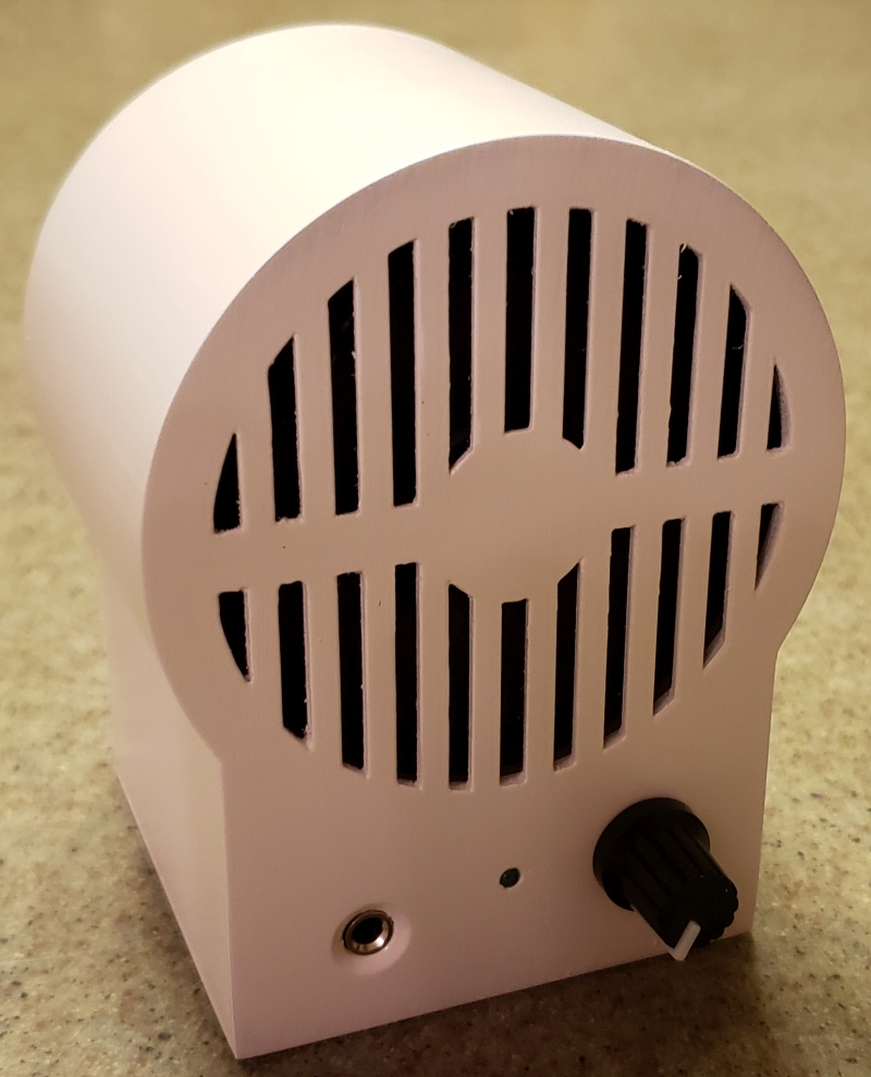

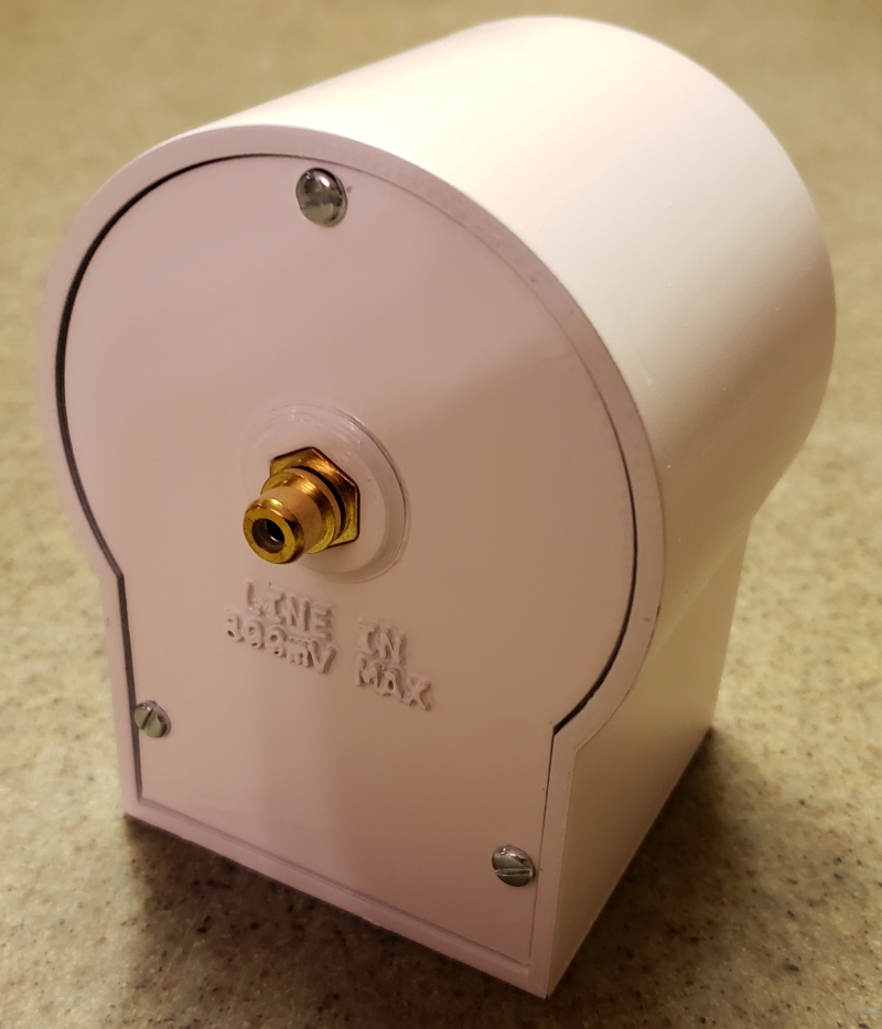

LM386 Bench Speaker
With a whopping output of about 500mW max, this little LM386 amplified speaker departs a bit from most of the creations posted here. The case components were modeled in SolidWorks and were printed with PLA on a Monoprice Select Mini 3D printer.

Nice to see something different.
What are your thoughts on the 3d printer? Your end result looks pretty good.
Thanks. The 3D printed case took a couple of coats of filler primer, some filler putty, and some sanding to smooth it to the point where I got tired of messing with it. The paint is 2 coats of Krylon Gloss White Enamel.
My experience with the Monoprice printer has been mostly positive. The SD card reader has stopped working so I have it connected to my computer via USB, which works so far. I do, however, find the available build volume of the Mini to be constraining.

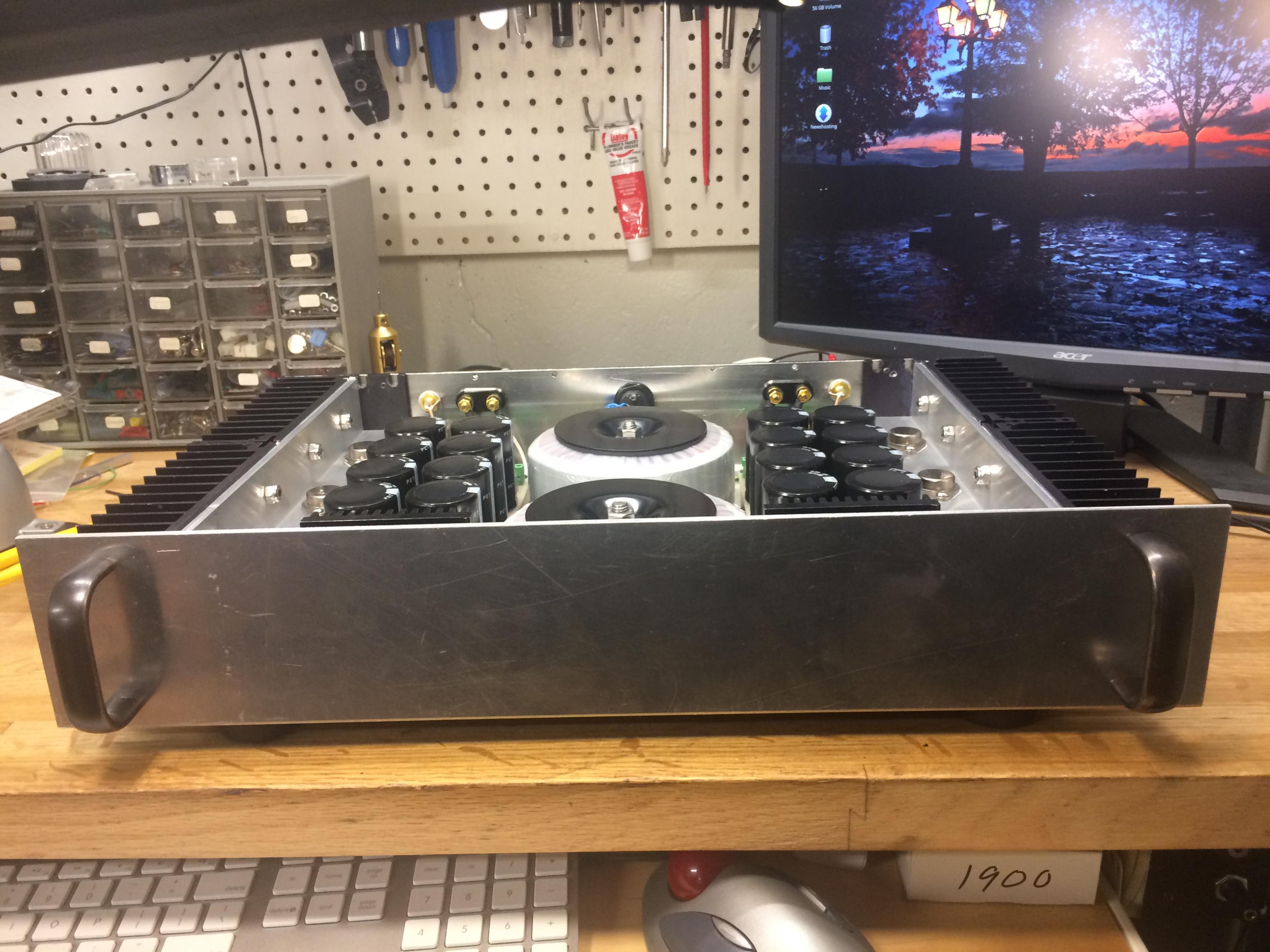

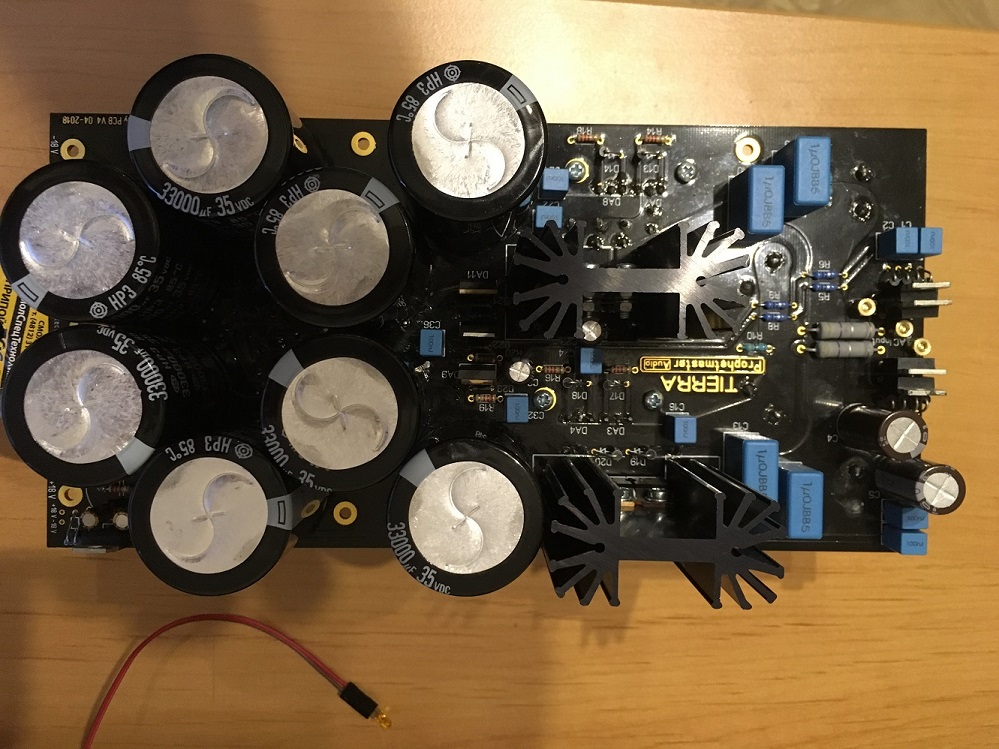

KMTech 24dB/octave crossovers and gainclone boards, powered from a +/-35V supply in a separate box. Gives a very acceptable near field sound from a pair of Tannoy 607s run active.
Wiring is a bit "prototype" for now, while the roundtuits are accumulated.

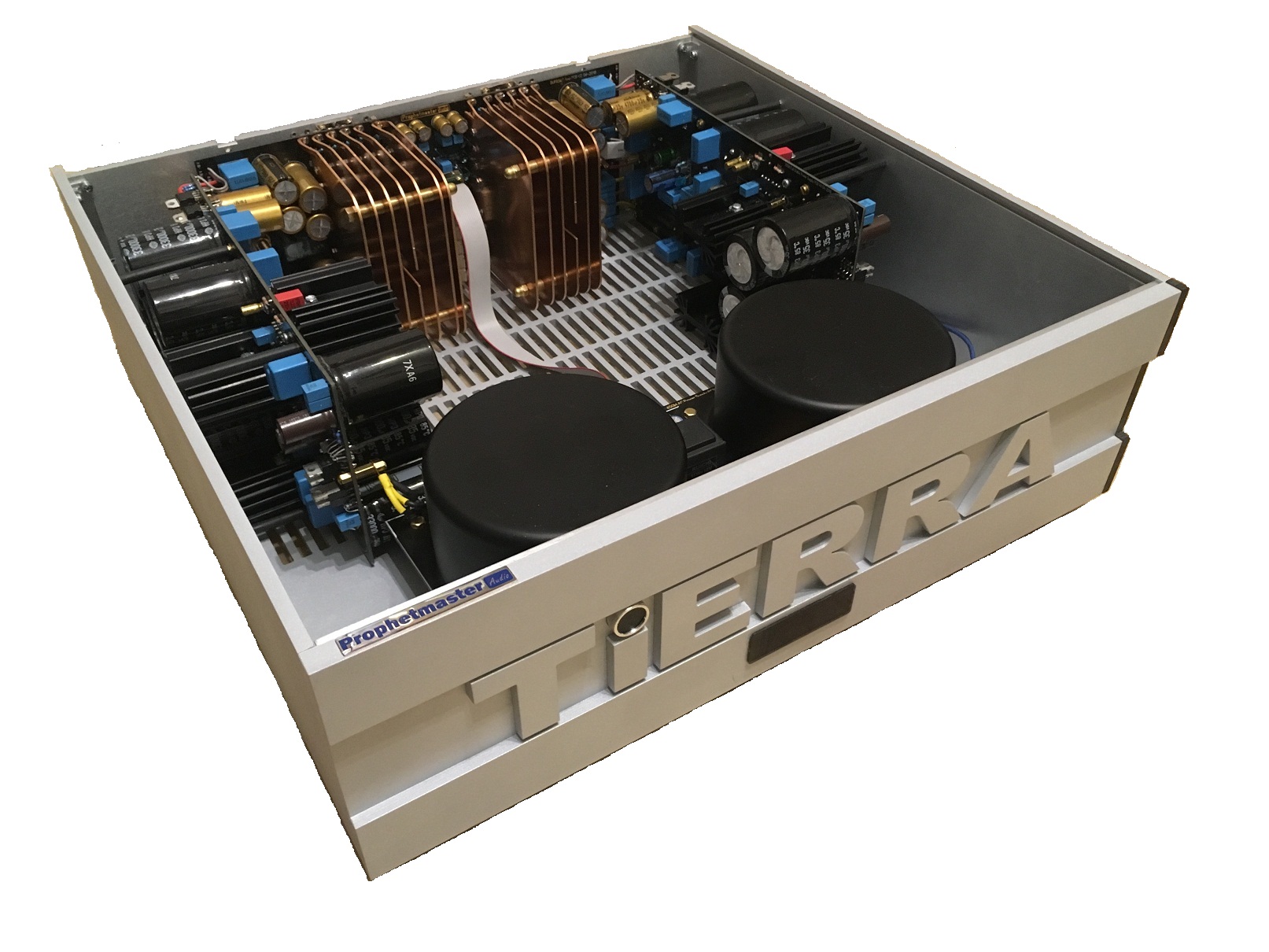

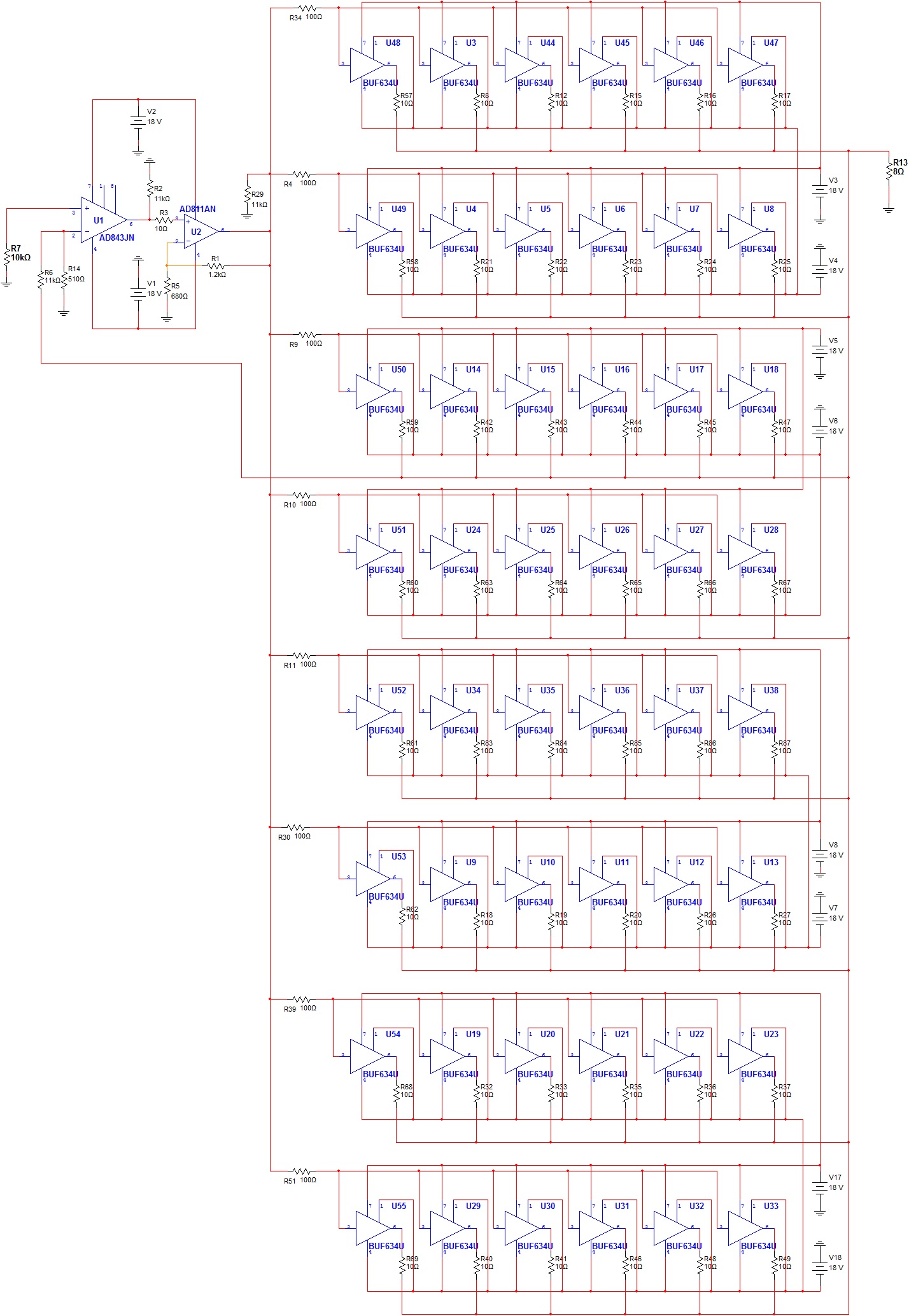

My new Amp🙂
30 W/4 Ohm, 15 W/8 Ohm
SR 400 V/usec
0 Hz - 8 MHz (can amplify video signal🙂)
Output R: 0.0001 Ohm
400 W full stable power supply +/- 18 V. About 1 Farad inside.
48 BUF634T in each channel (parallel connection).
SR 400 V/usec

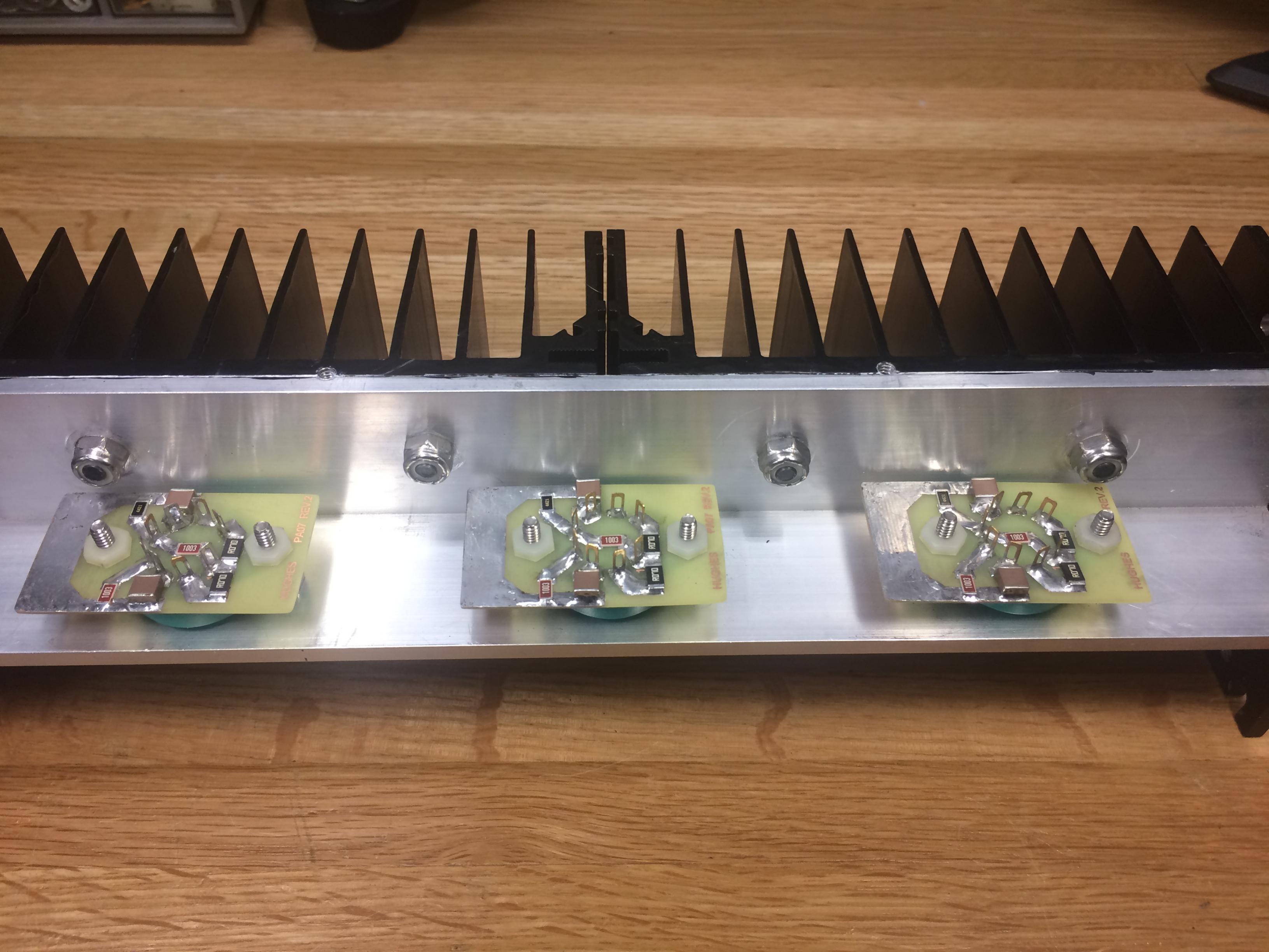

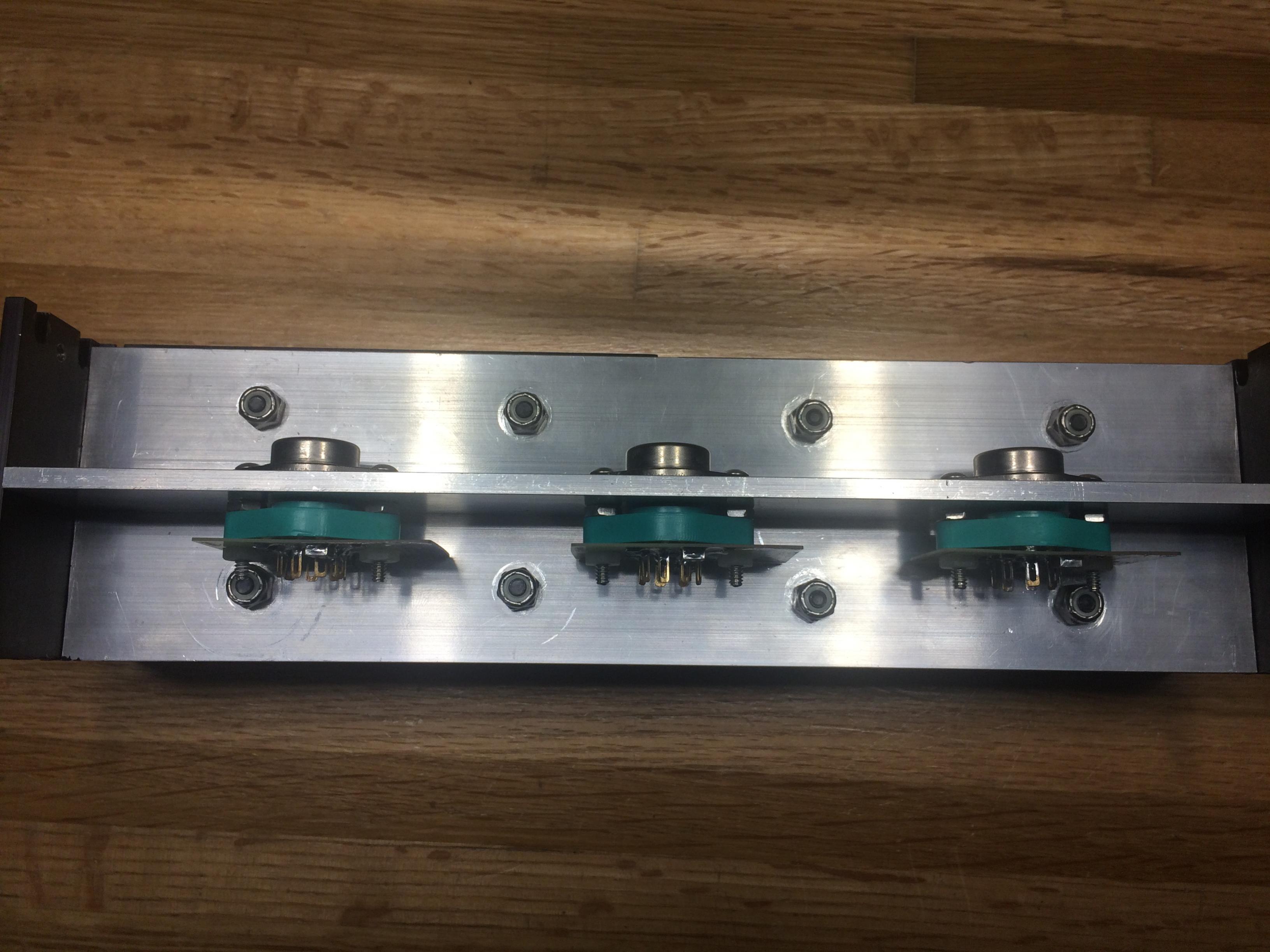

Recent amp project with Apex PA07
Here’s my recent amp project based on the Apex Microtechnology PA07 hybrid operational amplifier. I haven’t seen Apex opamps used here before, so I thought it might of interest to the group. The PA07 is a power opamp with a FET input that runs in Class A/B mode off a +/- 50V supply with a peak output current of +/- 5A. It comes in a metal 8-pin TO-3 package. It’s suitable of audio amps in the 60W range. I know these chips are kind of pricey but I got mine from a surplus house many years ago for next to nothing.
My amp is a dual three-channel configuration - six channels total at about 70W per. My speakers are 2-way with two woofers and one tweeter per cabinet, so the idea was to go with an active crossover and a dedicated amp for each driver, and so the need for six channels.
The external circuitry was kept to an absolute minimum. Since the PA07 is internally compensated, thermally protected, and protected against inductive kickback only seven external components were needed. These are the gain control resistors, power supply decoupling caps and current limiting resistors. All are SMD and fit on a small 30x50 mm board which is built around a socket for the 8-pin TO-3.
I omitted the traditional input coupling capacitor since these are present at the output of the active crossover anyway. In prototyping the PA07 exhibited virtually no power-on transient or pop-noise, so I decided a mute circuit was not needed.
I have been listening to this for a couple of weeks now and I have to say the sound is truly amazing….. warm, clean, powerful, and detailed. Everything you want an amp to be. I don’t have the equipment to measure THD so I can’t provide any numbers in this department, but quite frankly, I don’t care. I’ve been listening to and building amps for 40+ years and this thing is up there with the best of the best. It’s hard to say how much is attributable to the amp itself, or the transition to bi-amping with an active crossover, or the dedicated amp-per-driver technique, but the combination of those has been a really nice improvement and well worth it.
