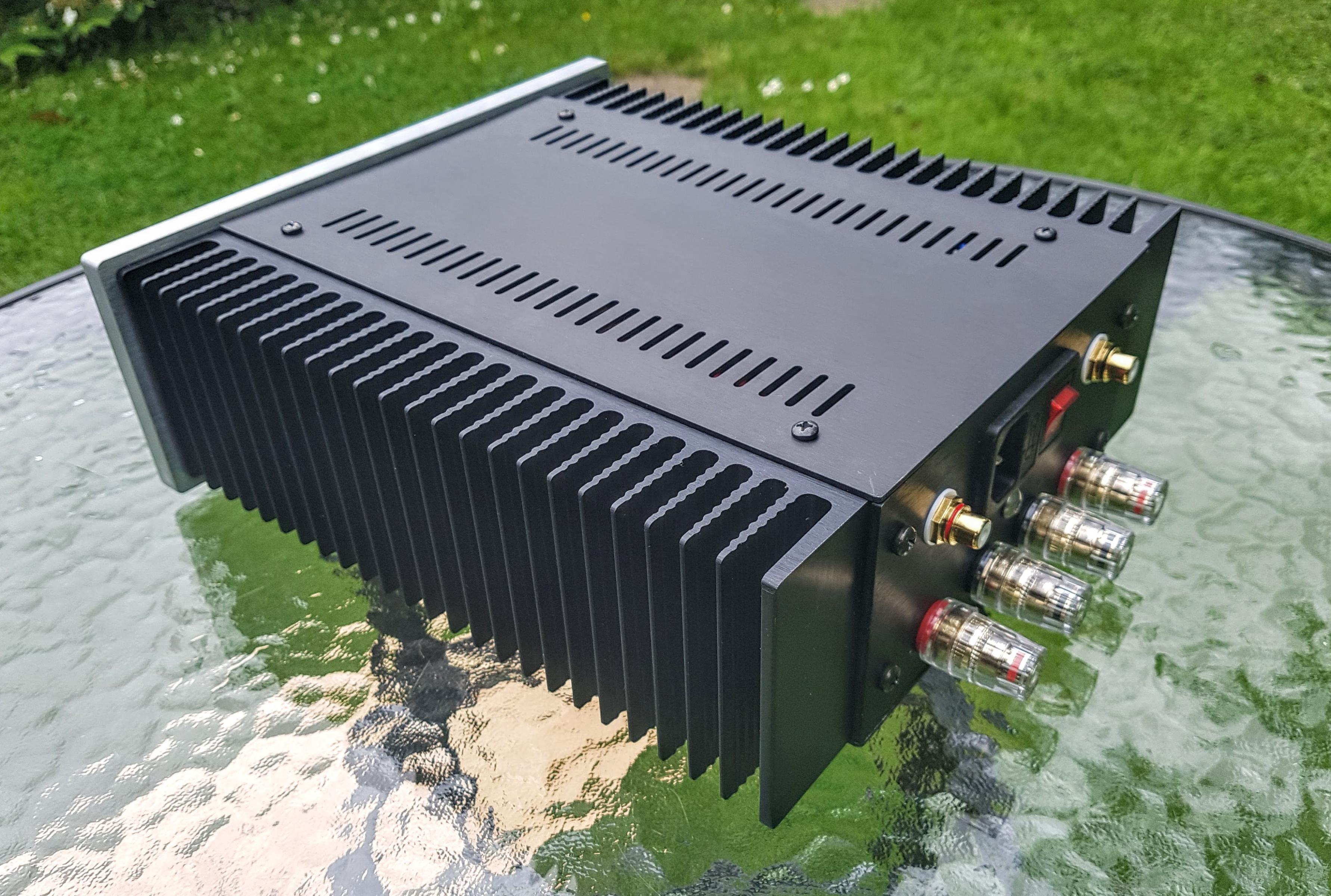

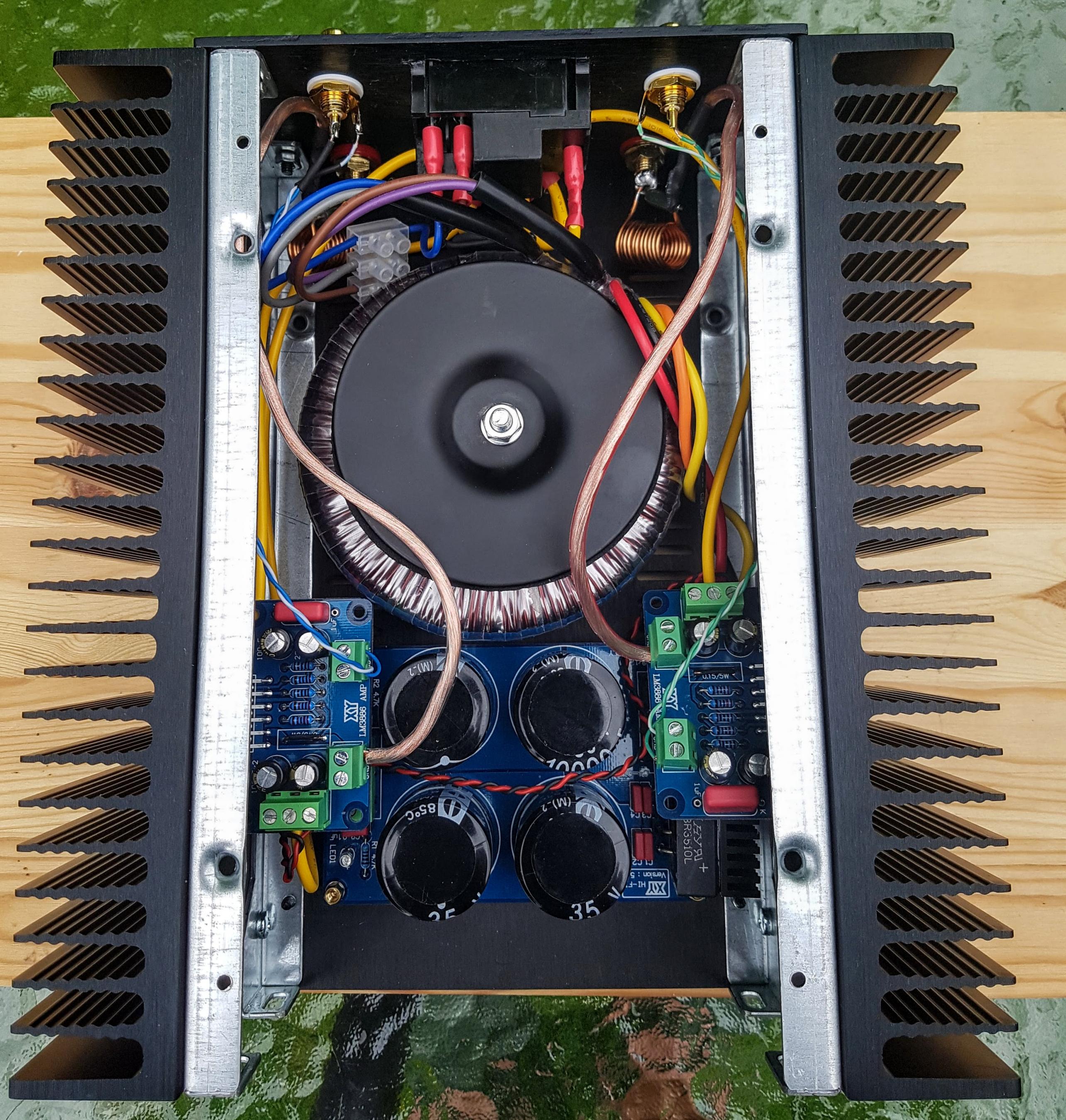

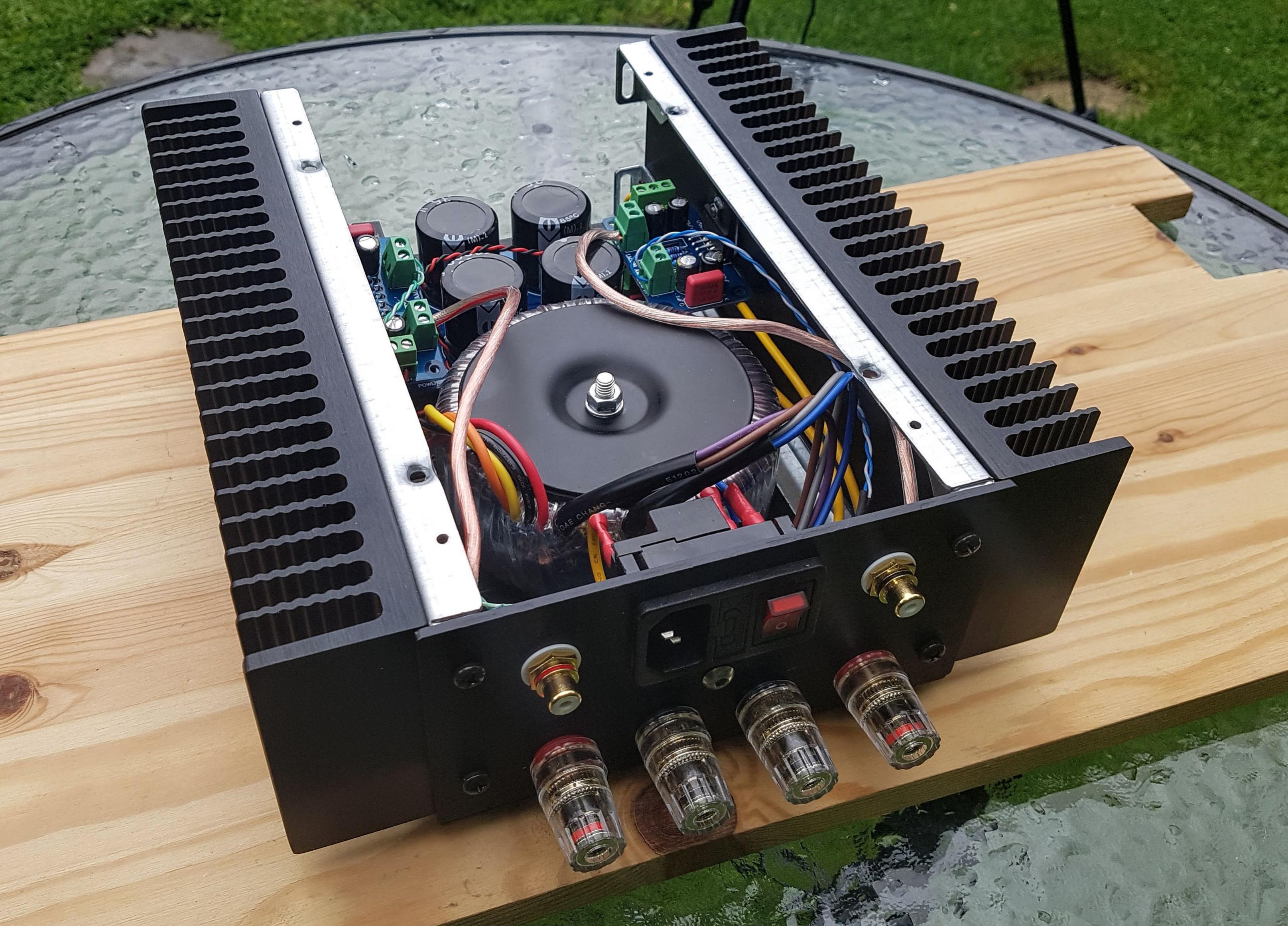

This is my LM3886. I just started with electronics this year. I've made a couple of CMoy headphone amps, the O2 headphone amp and the ACA. I love how you can go from no knowledge whatsover to building an amp you're proud of, and enjoy listening to, in a short period of time by using this site and others.
Nice build as one of your first. You'll never have to worry about heat dissipation with that case.
I would route the output wire around the sides of the transformer. A toroidal transformer is noisiest above and below.
Thanks, I realise the heatsinks are over the top but I like the look and it fitted perfectly in my rack.
I didn't realise transformers had a direction to their noise, thanks for the tip.

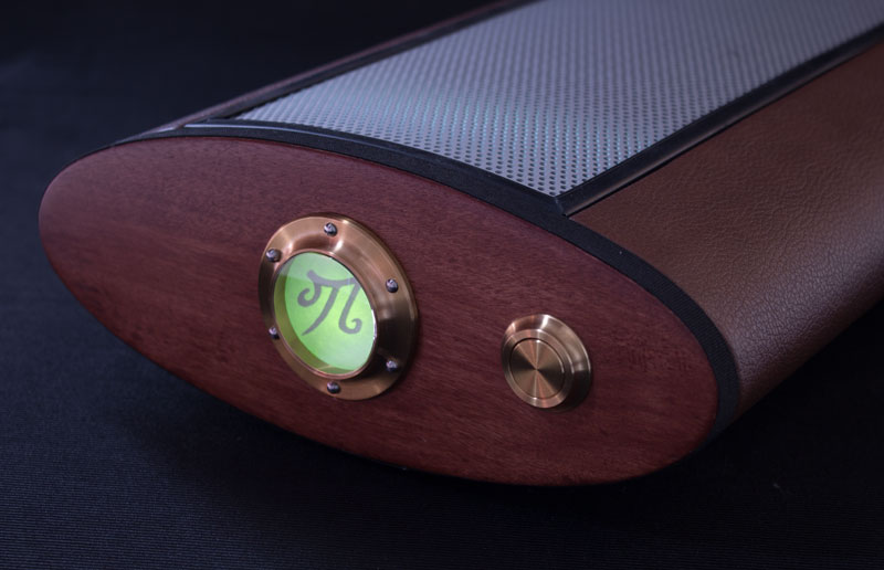

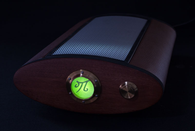

Not all amps need to be square boxes, do they? This LM3886 kit has been waiting for an enclosure for ages. Now it has one. Wood, leather, brass etc.
