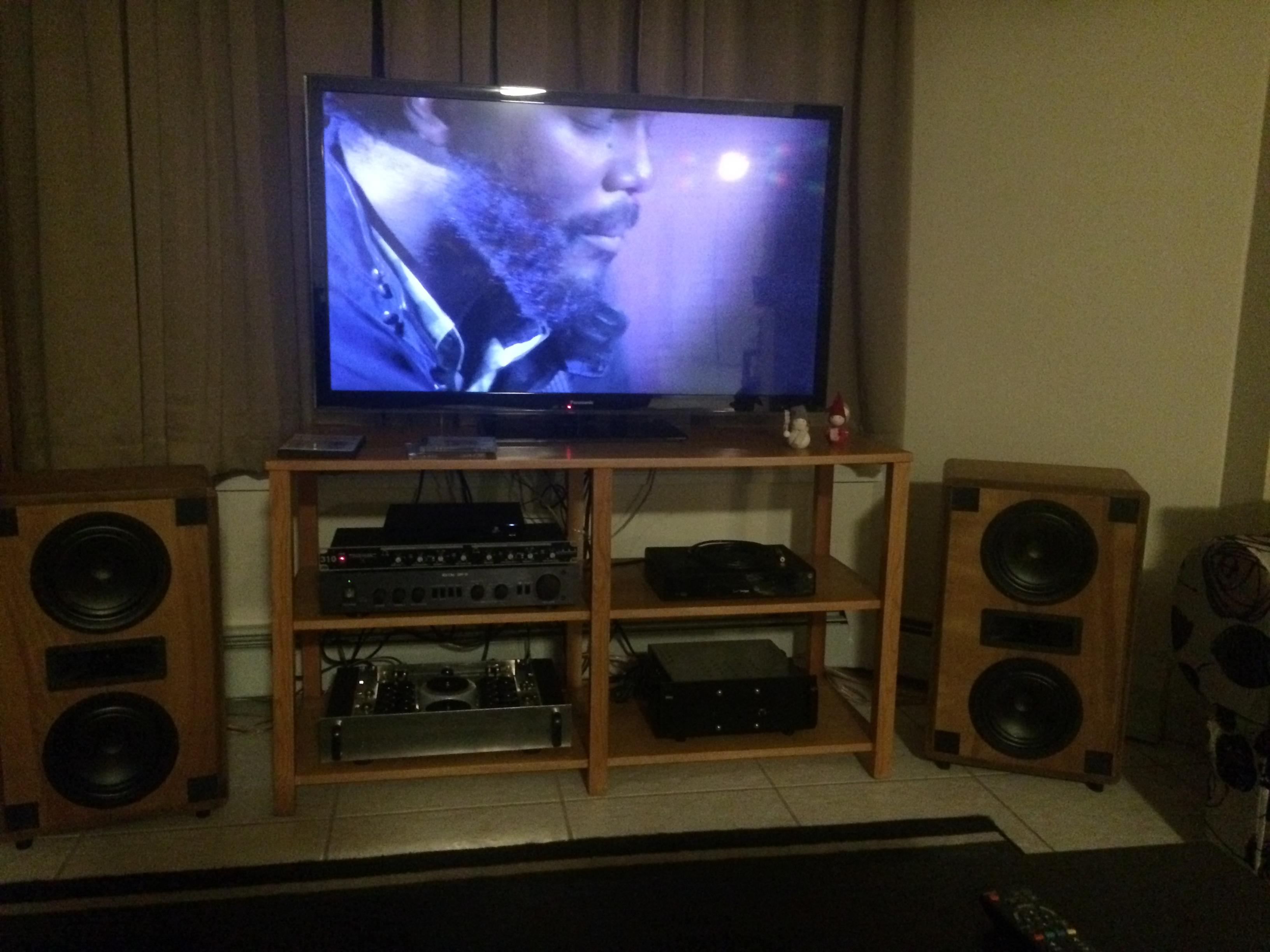

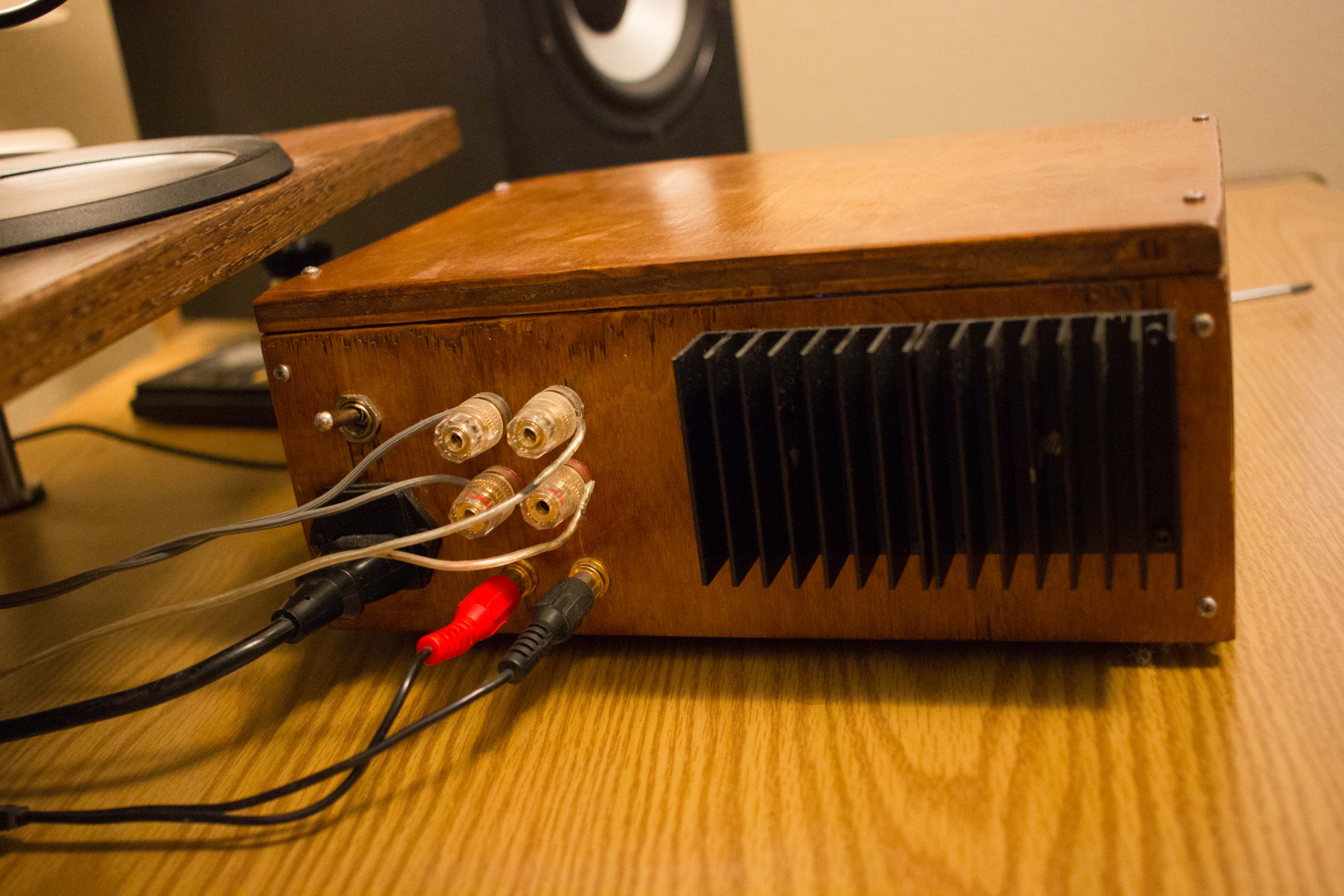

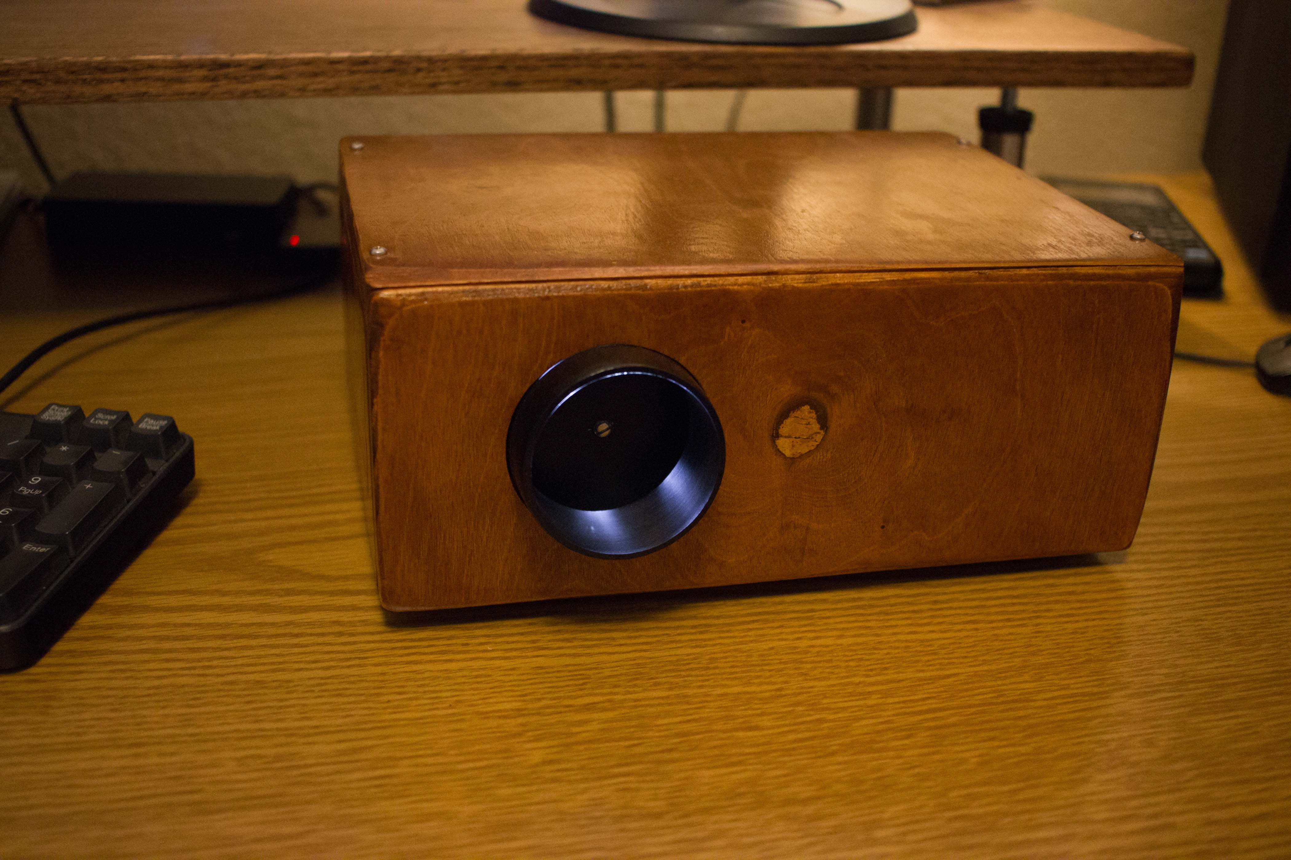

Desktop LM3886

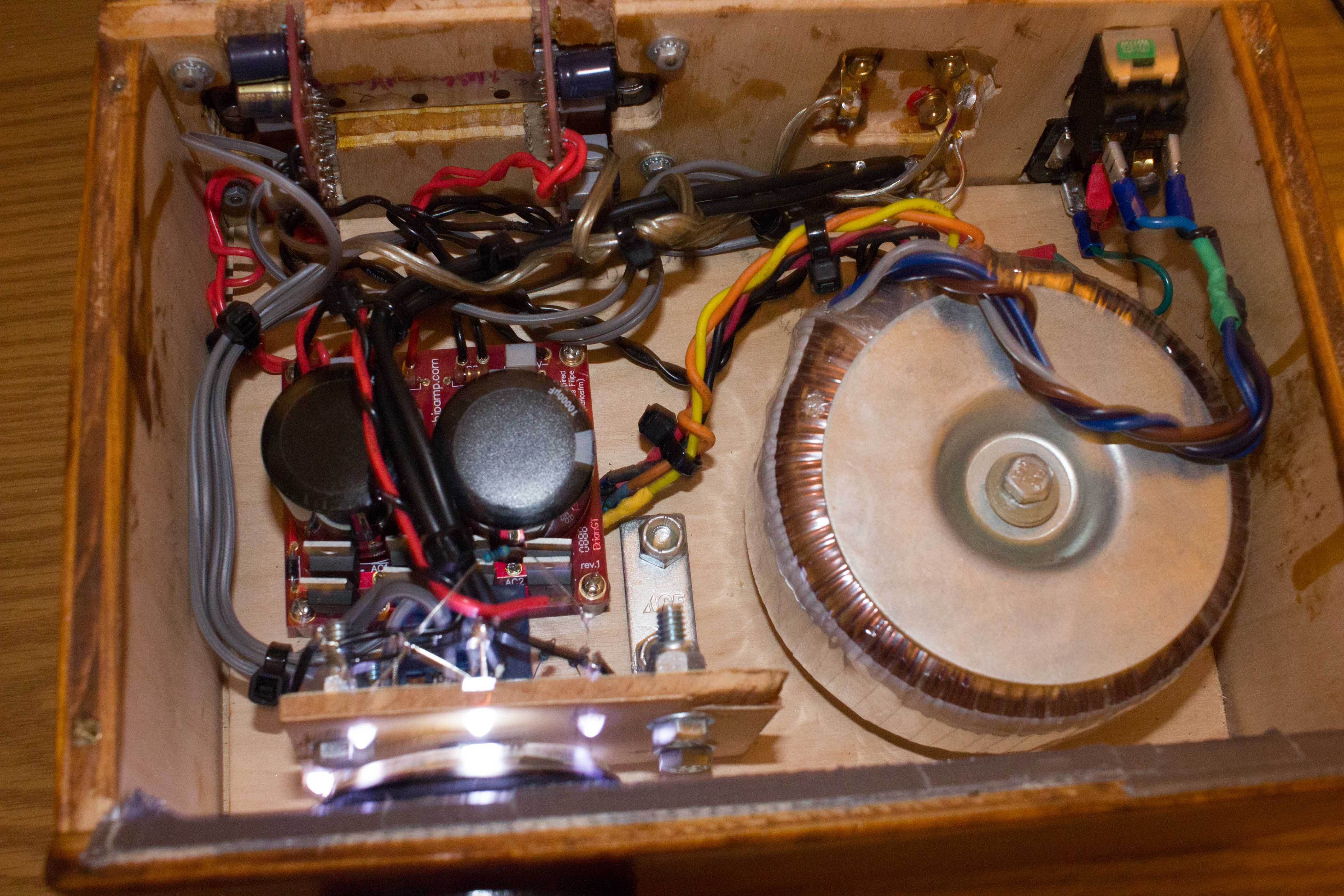

Built this a couple of years ago with some help from people around here, never got around to posting the final product.
Closely based on WWWJD's LM3886 Gainclone over at PE. He is a bit more of a craftsman than I am but I am still happy with my results. I did not, however, integrate the DAC like he did. I wanted to be able to change out at some point so it just has coax inputs for now and a litty HiFiMeDIY U2 DAC.
Has a very slight hum even with input disconnected. Probably because of everything's proximity to trafo but let me know if you see something obvious. It is not audible over the air handler so haven't had any reason to really go digging. Other than that the sound is incredible. Any decent source fine feels like they are in the room with you.

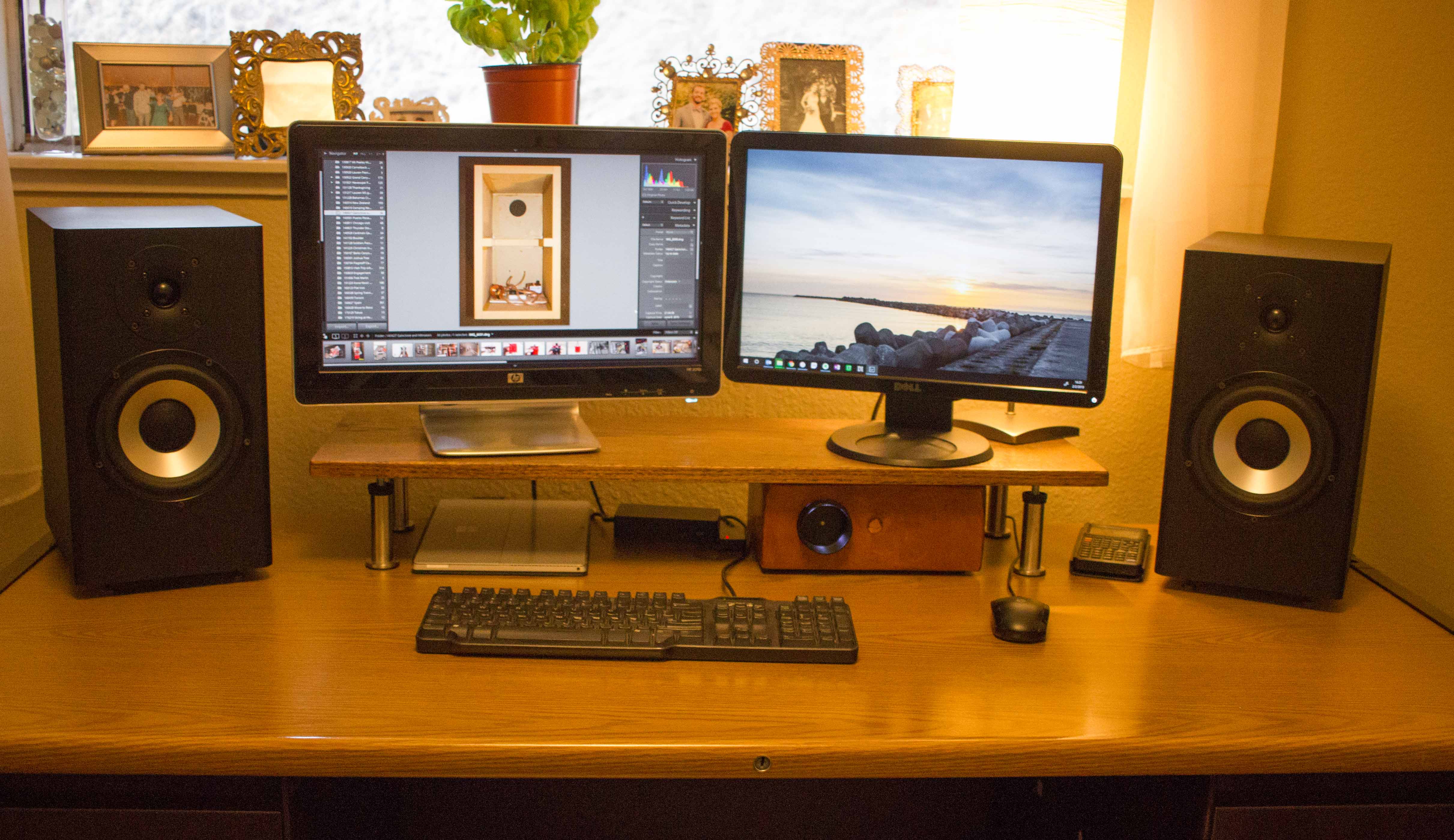

Still need to make a desk riser that is full width to get the Hitmaker's up to the right height, but pretty close to done with my desktop setup.

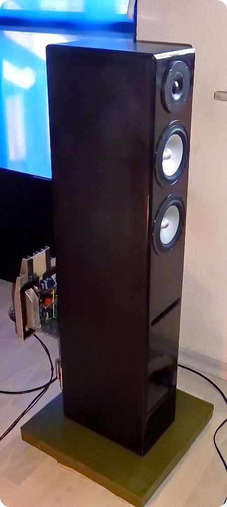

My new Amp🙂
48 BUF634T in each channel (parallel connection).

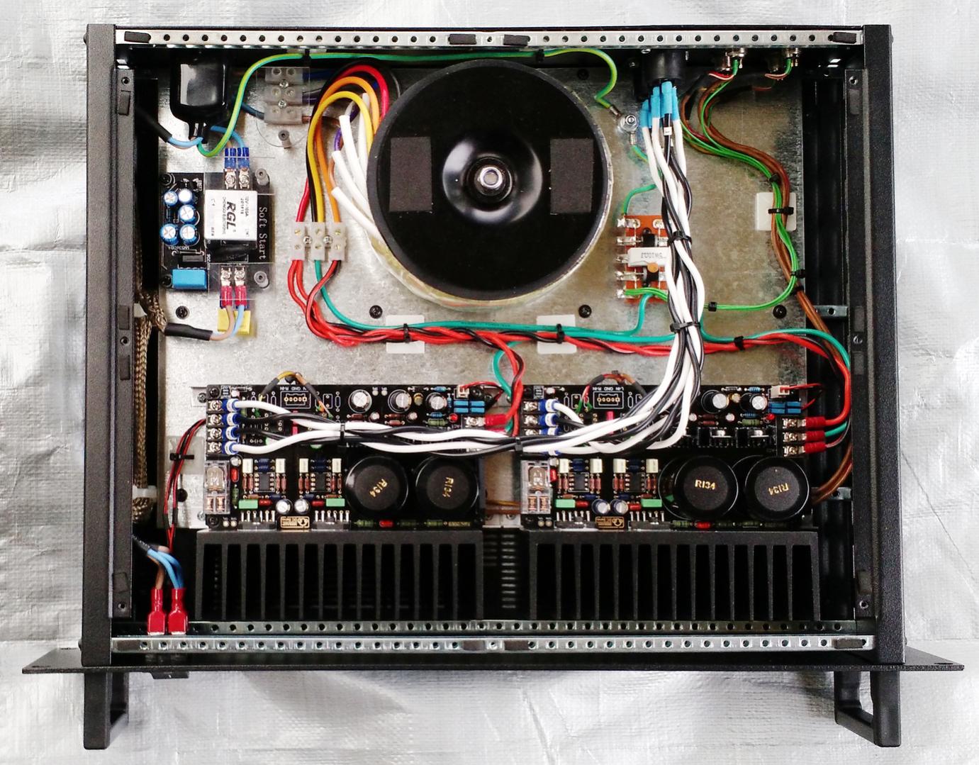

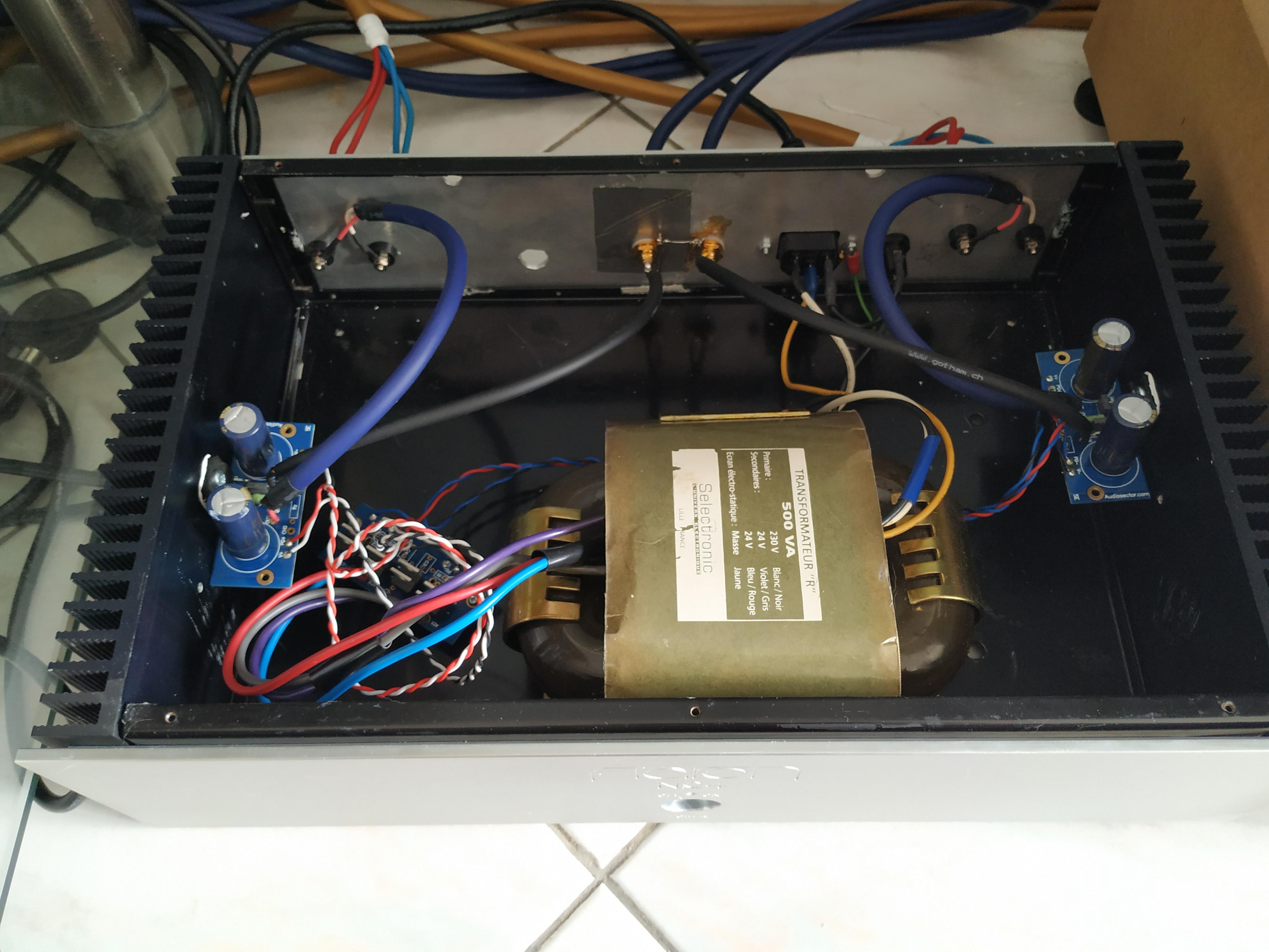

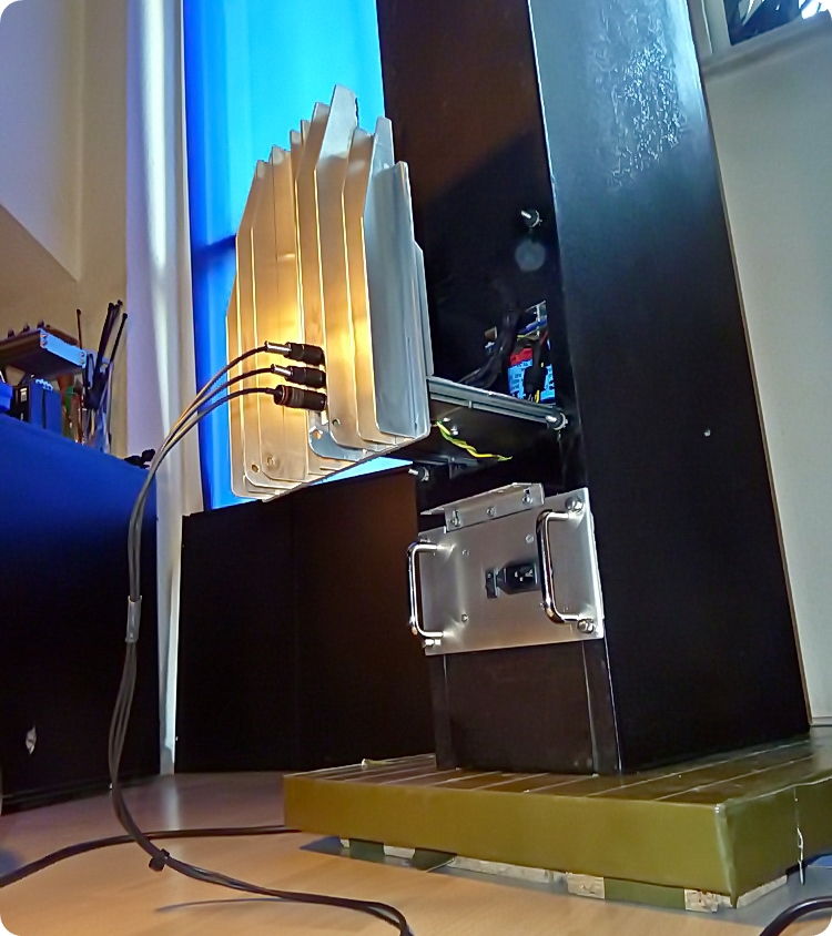

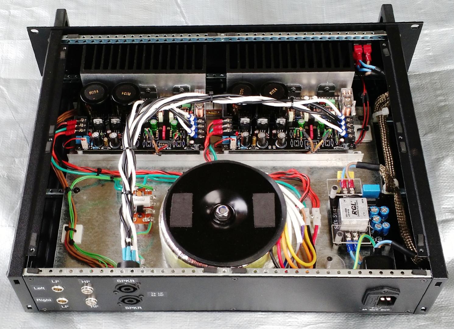

My 4 channel box for bi-amping a pair of Altec 604-168X speakers. 2 x Chinese kits modified for balanced inputs using SSM2141 line receivers. 500VA transformer with soft start circuit. Mini XLR inputs and Speakon output connectors.
The pre-amp and 2 way L-R 4th order 1550Hz x-over are in another box.

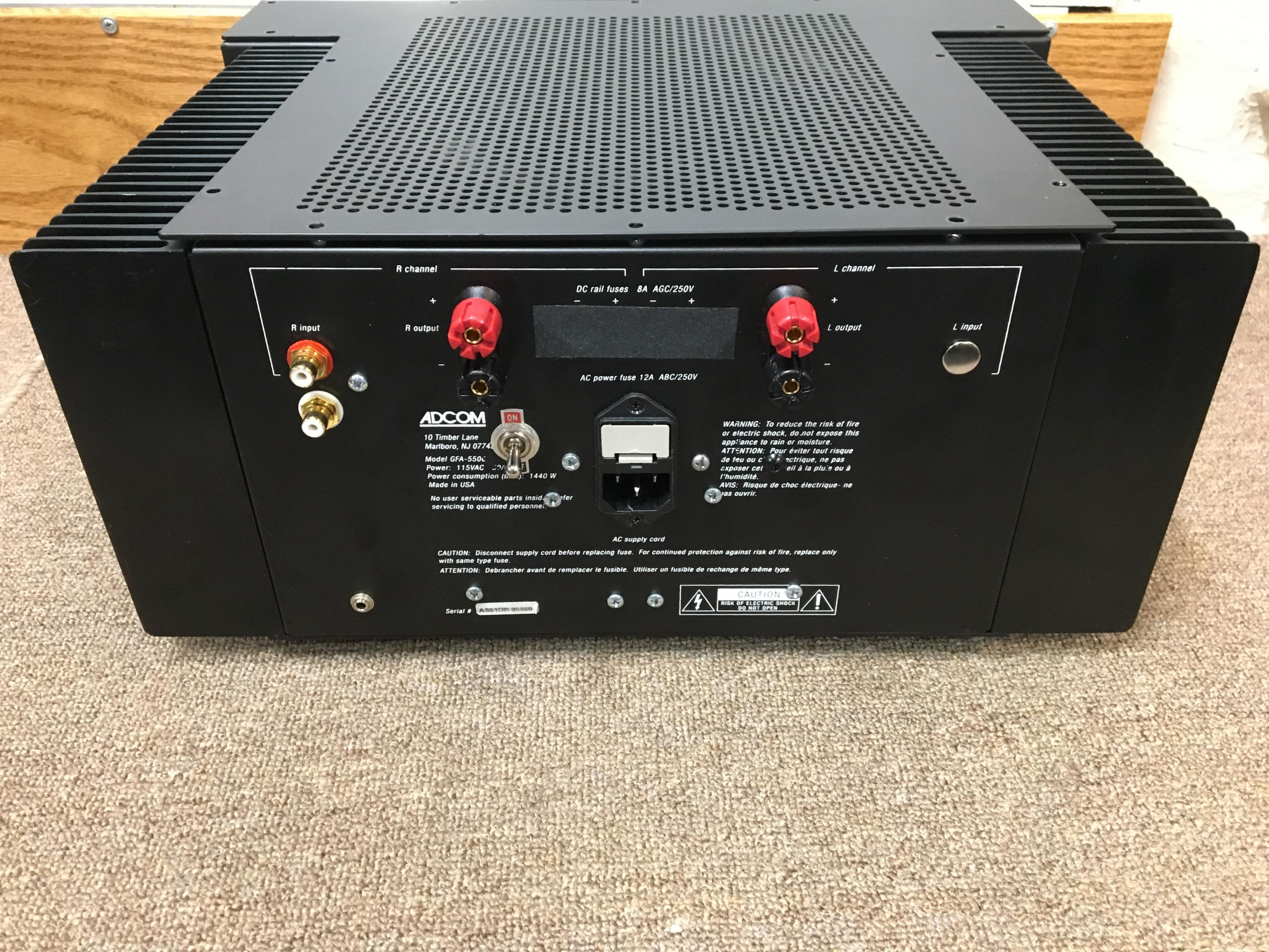

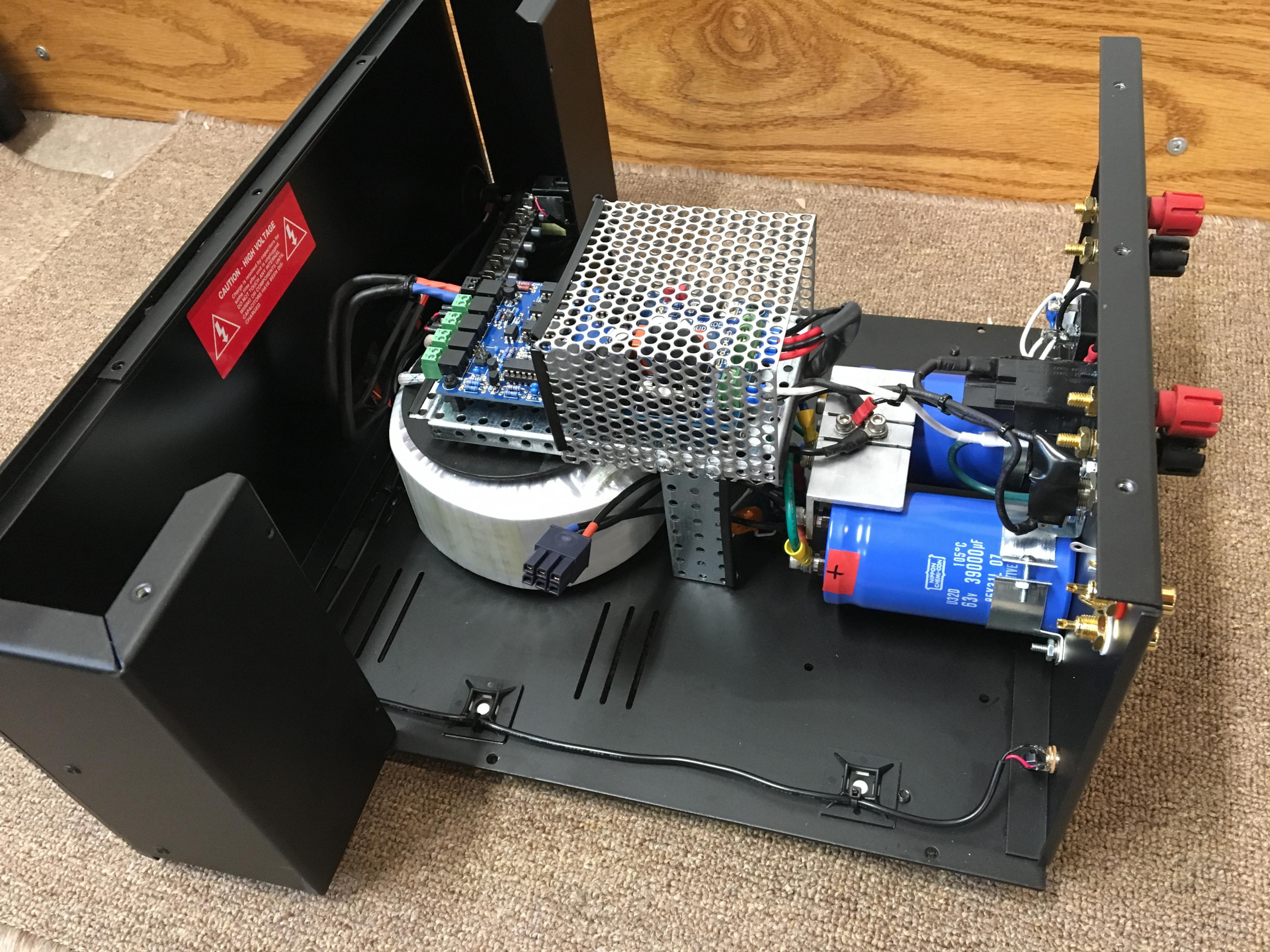

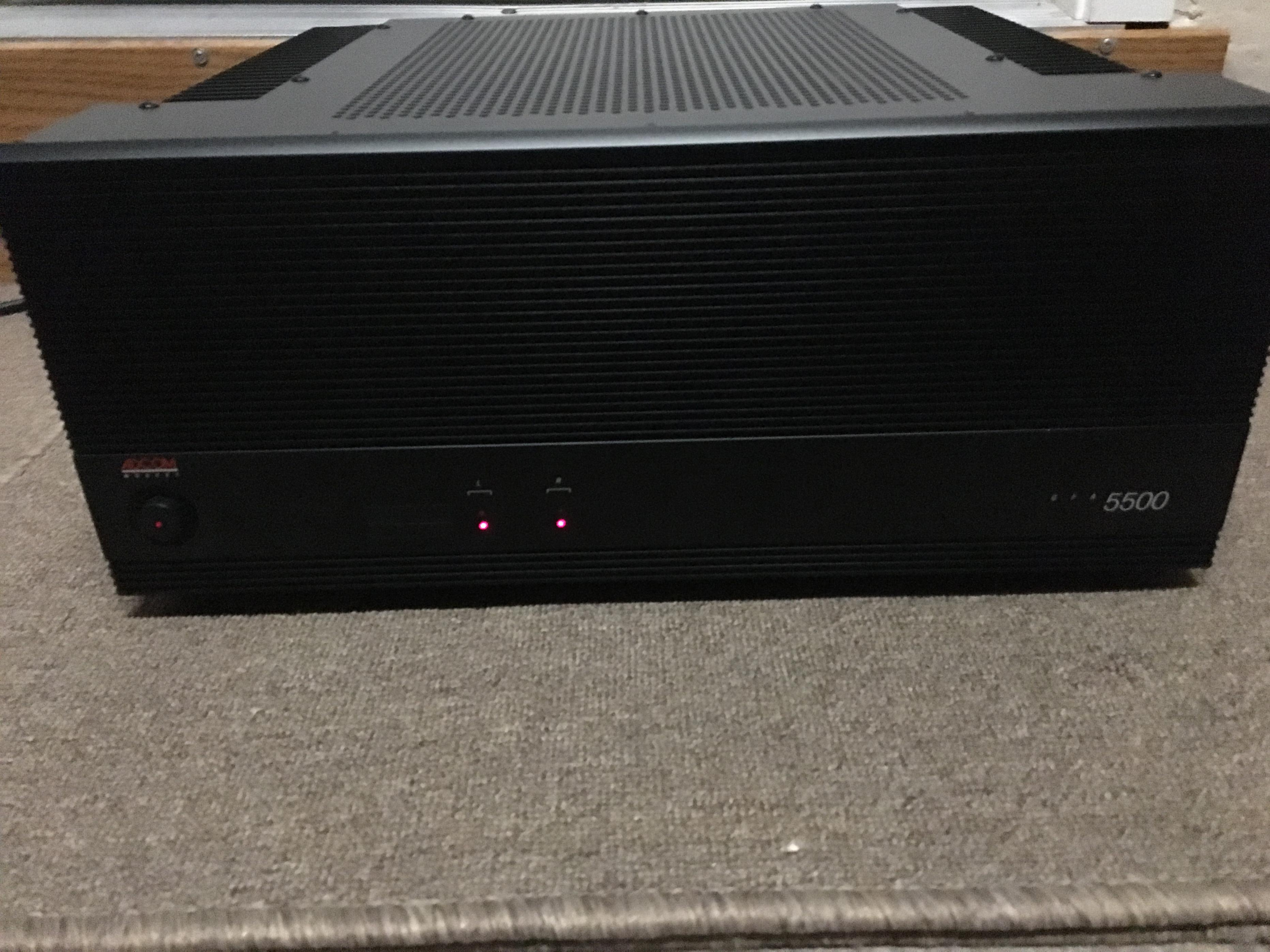

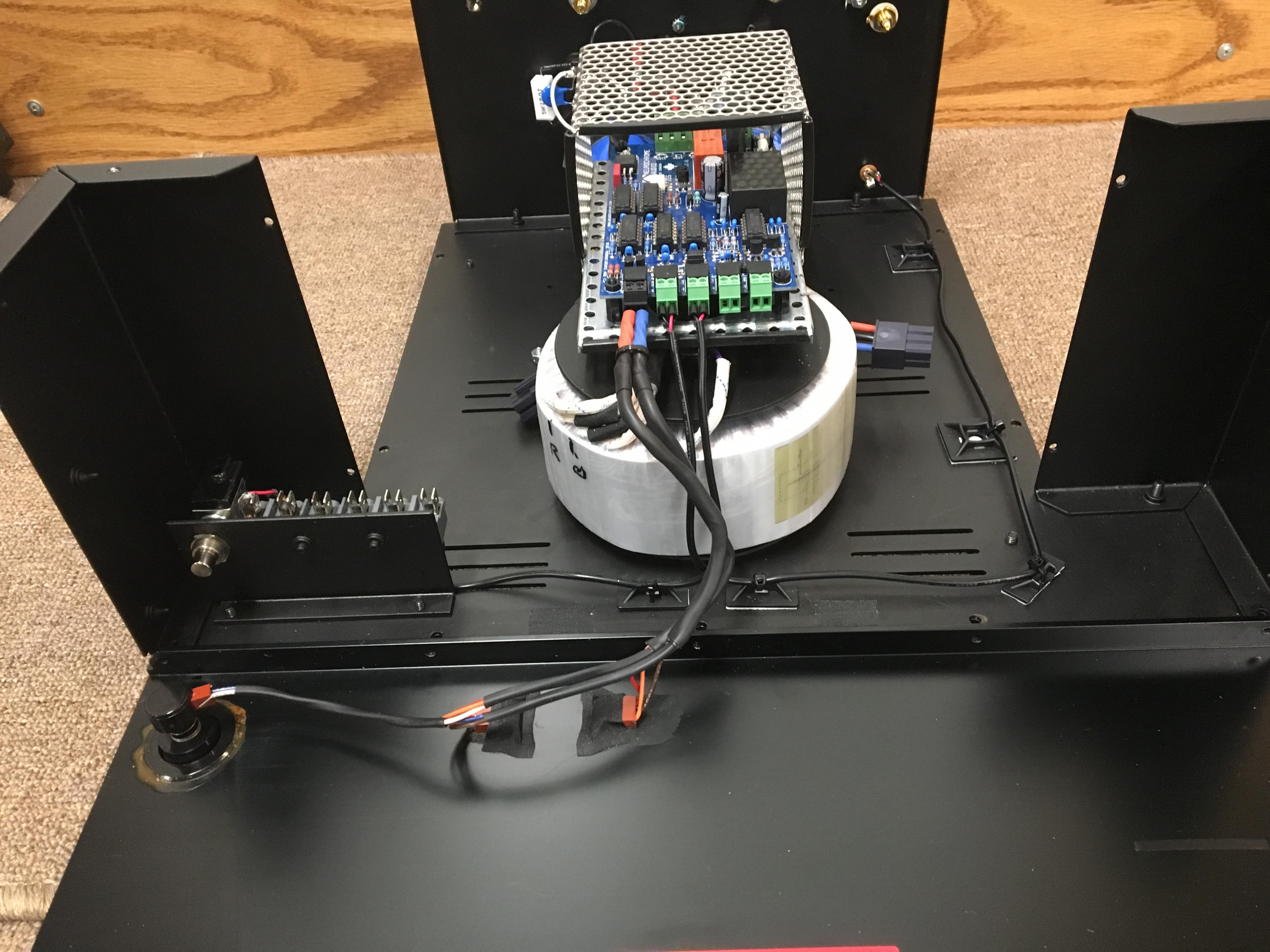

Here is a Neurochrome Modulus 686 pair installed inside an ancient ADCOM GFA-5500 donor chassis. Included is a simple beer-can power supply, using an Antek AS-4222 transformer with ±39,000µF after the bridge. It has a ground-loop-isolator and a Neurochrome ISS for soft start and associated logic control.
The extraordinary PSSR of the LM3886 composite amp accommodates a very simple power supply, and thus a relatively quick build. It all works a treat!
Instrumentation: Fluke 179 TrueRMS voltmeter, and a Tek TDS1002B 2 ch 60mHz scope.
At a line voltage of 122.4 VAC, and a 440Hz signal, 2 channels driven and loaded, the non-adjusted, raw data for the BTL Modulus-686 was:
8 ohm load: PS = ±31.00 VDC at idle
8 ohm load: PS = ±30.57 VDC at a light load of 2.39 VAC into 8 Ω
8 ohm load: PS = ±26.78 VDC at just under clip, 33.12 VAC into 8 Ω, ( = 137W/Ch )
4 ohm load: PS = ±24.67 VDC at just under clip, 27.56 VAC into 4 Ω, ( = 190W/Ch, )
16 ohm load: PS = ±28.60 VDC at just under clip, 36.20 VAC into 16 Ω, ( = 82W/Ch )
In this application, I was shooting for 150W/Ch into the midbass ScanSpeak 18W8531, which has an impedance saddle of 6.4 ohms from 140 to 300 Hz. The estimated 6Ω power is: (27.56*33.12) / 6 = 152W/Ch = smiles here!

My new Amp🙂
30 W/4 Ohm, 15 W/8 Ohm
SR 400 V/usec
0 Hz - 8 MHz (can amplify video signal🙂)
Output R: 0.0001 Ohm
400 W full stable power supply +/- 18 V. About 1 Farad inside.

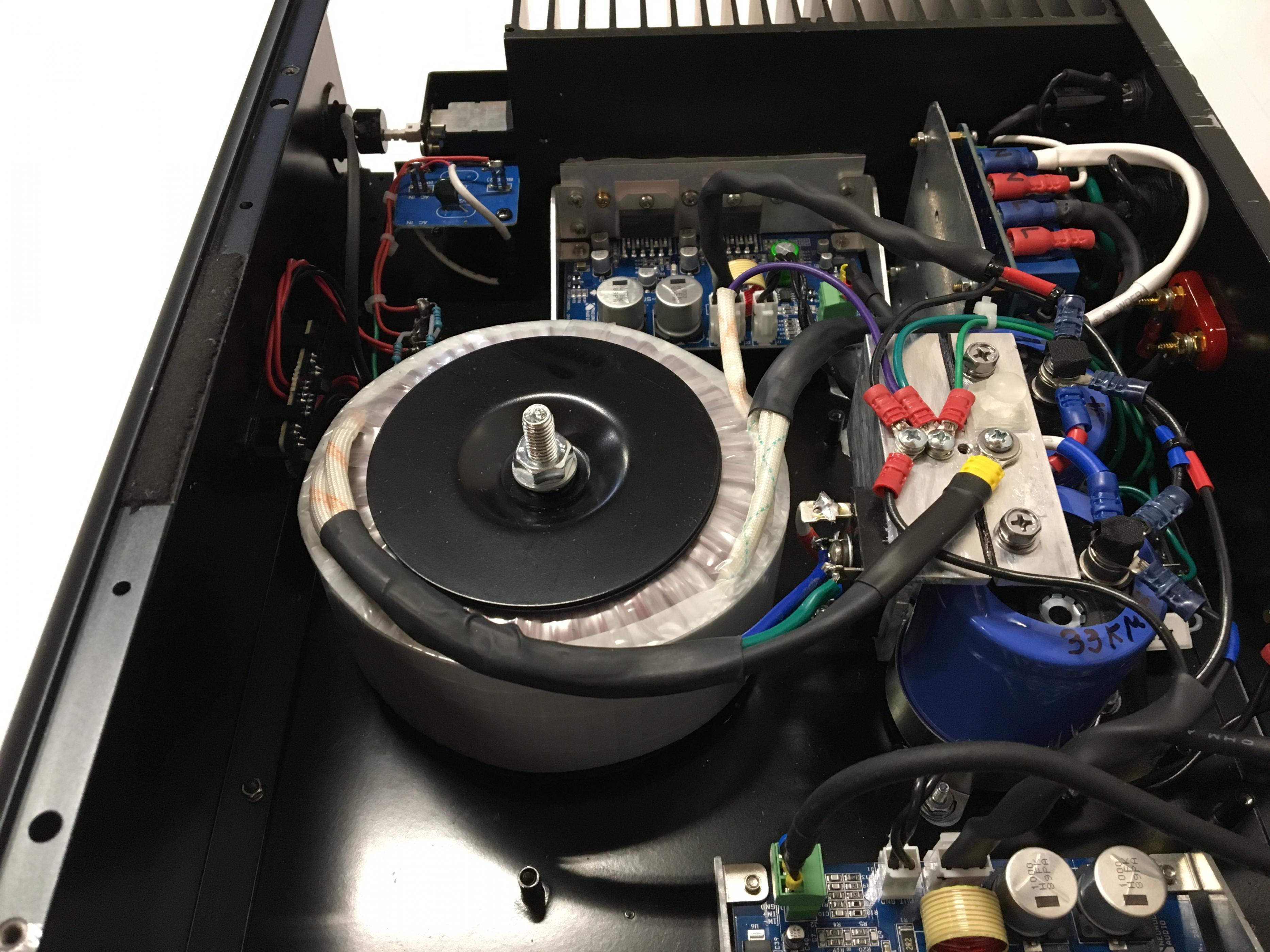

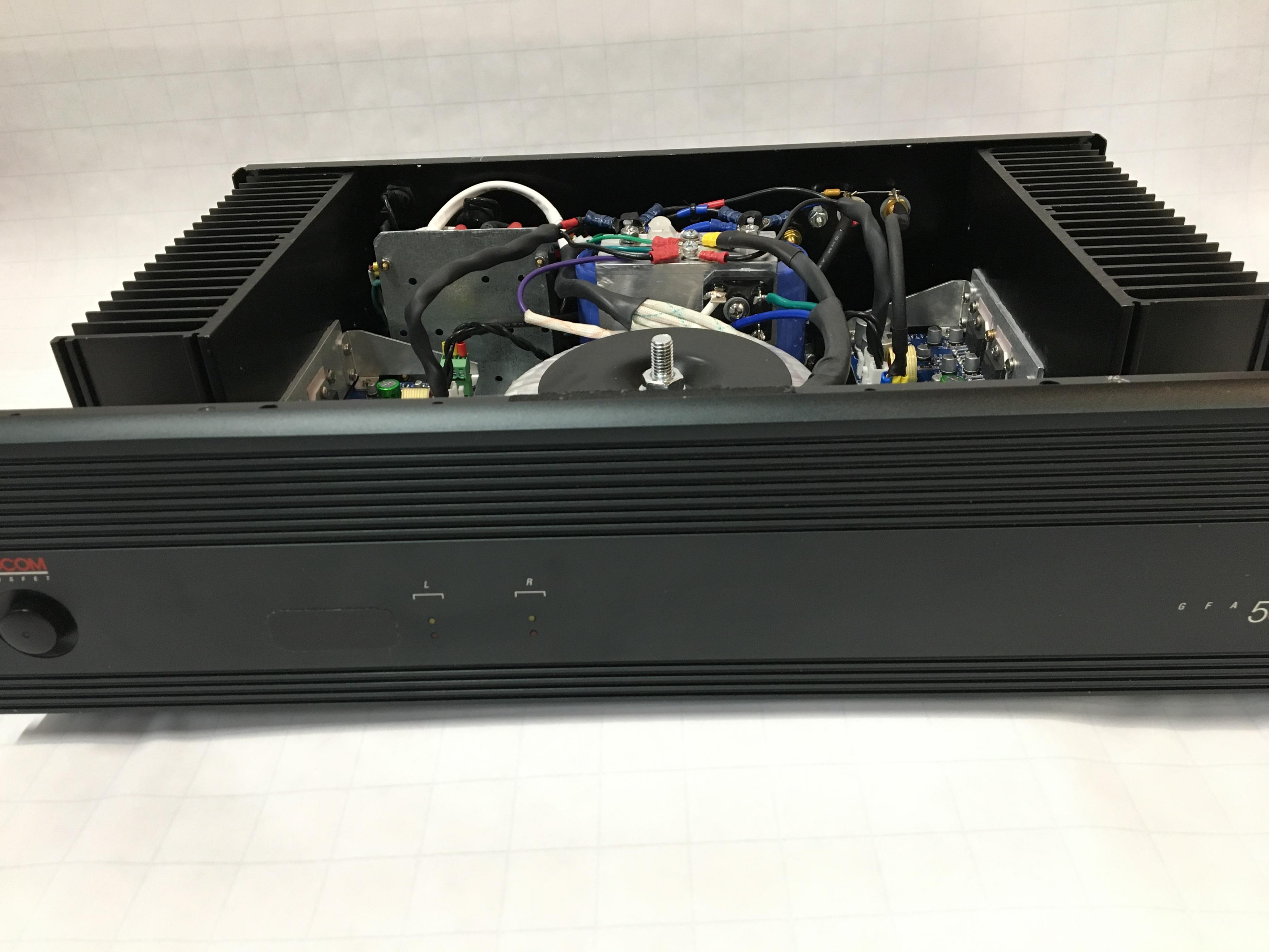

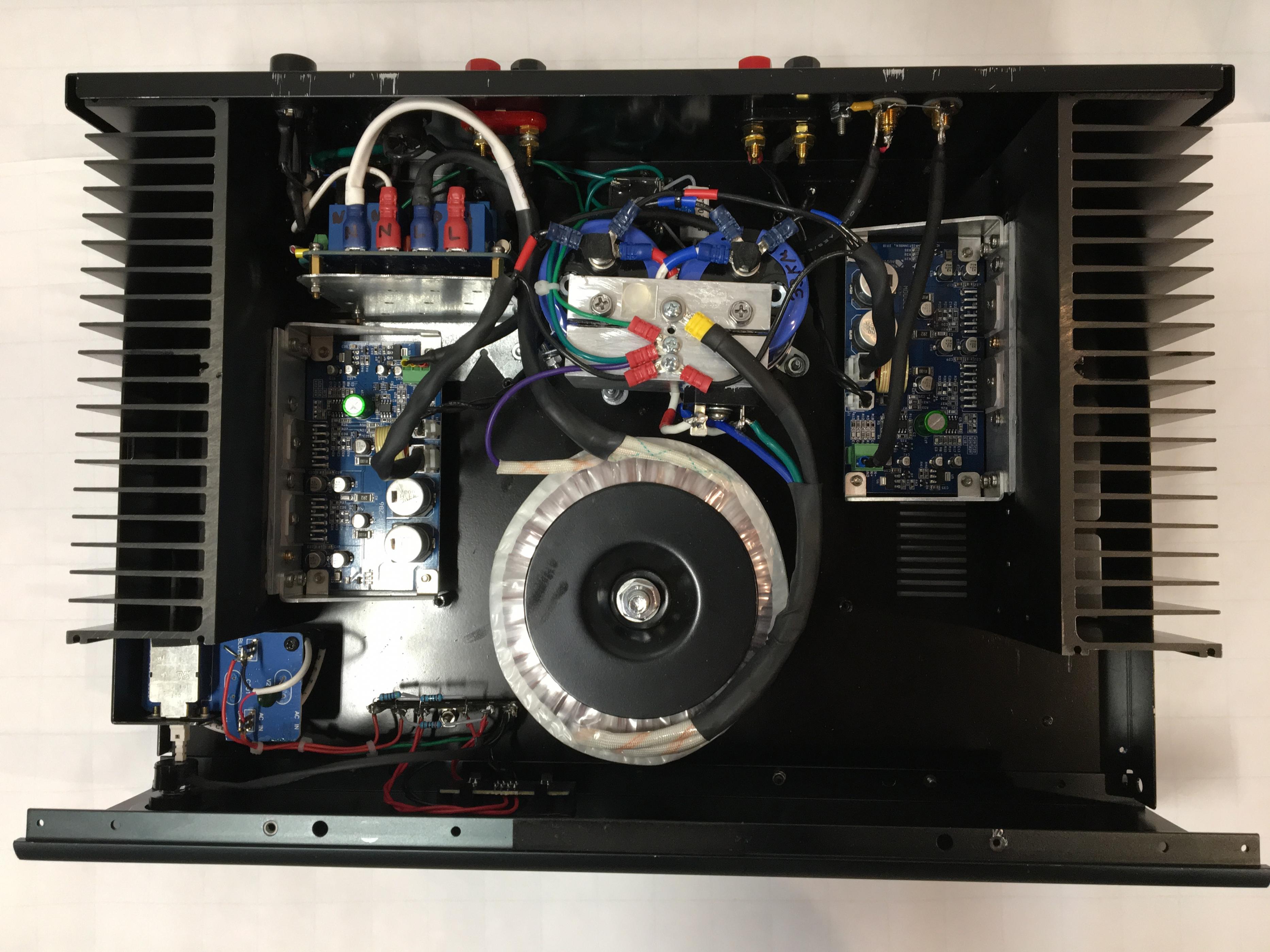

This time, here is a Neurochrome Modulus 286 pair installed inside an ancient ADCOM GFA-5300 donor chassis. Included is a simple beer-can power supply, using an Antek AS-3425 transformer with ±33,000µF after the bridge. It has a ground-loop-isolator and a Connexelectronics soft start and associated logic control.
The extraordinary PSSR of the LM3886 composite amp accommodates a very simple power supply, and thus a relatively quick build. It all works a treat, again!
The grounding scheme follows the Hifsonix method.
At a line voltage of 123.0 VAC, and a 440Hz signal, 2 channels driven and loaded, the non-adjusted, raw data for the Modulus-286 was:
8 ohm load: PS = ±35.8 VDC at idle
8 ohm load: PS = ±35.3 VDC at a light load of 2.00 VAC into 8 Ω
8 ohm load: PS = ±33.4 VDC at just under clip, 20.4 VAC into 8 Ω, ( = 52W/Ch )
4 ohm load: PS = ±31.8 VDC at just under clip, 19.3 VAC into 4 Ω, ( = 93W/Ch, )
16 ohm load: PS = ±34.4 VDC at just under clip, 20.5 VAC into 16 Ω, ( = 26W/Ch )
In this application, I was shooting for 65W/Ch into a midbass ScanSpeak 18W8531, which has an impedance saddle of 6.4 ohms from 140 to 300 Hz. The estimated 6Ω power is: (20.4*19.3) / 6 = 66W/Ch = smiles again!
Very nice builds. Thank you for sharing. I love the chassis repurposing. That worked out really well here.
Yep. The error correction employed in the Modulus-series comes with many advantages - including high PSRR.
I'm glad you like the amps.

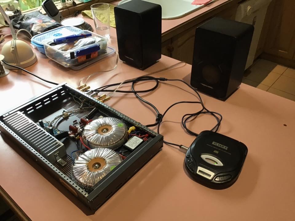

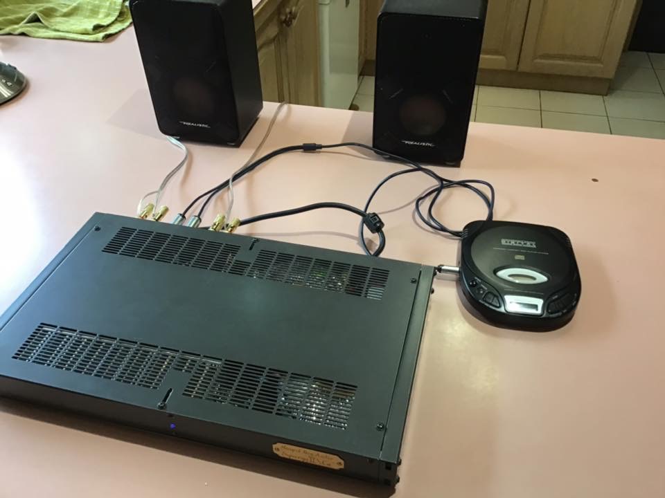

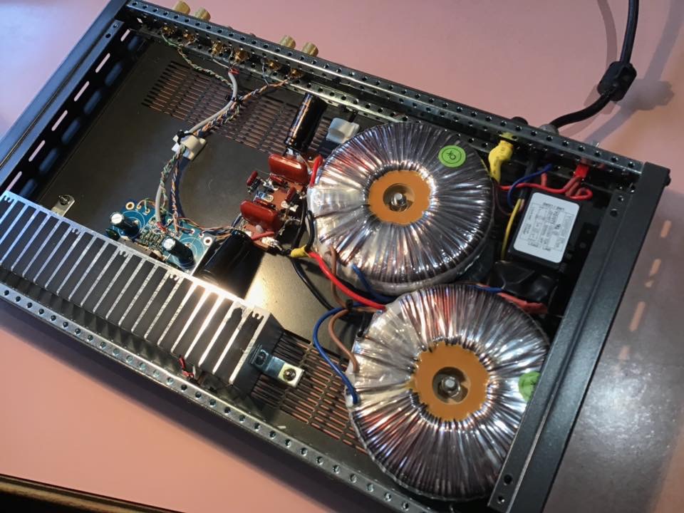

Wow! Really impressed with the builds in this thread! This is my poor man's version of the AudioSector chipamp. Still needs to put in place a soft start circuit and perhaps shielding for chip and dc v-wires. Sound is impressive with lots of detail and solid bass.
Looks good! Seems like a pretty small amount of storage capacitance in the power supply end. You might find that with a bit more in the power supply you get even more/better detail and bass. But if you do that, do make it low ESR if possible.
It already provides more bass and better overall sonics than my quad 303s and Marantz PM94. I am also really surprised with the result as there's only 1500uf per channel. Would using, let's say 60000uf per channel, improve the sonics? (have a m2/f6 power supply board lying around somewhere) 🙂
