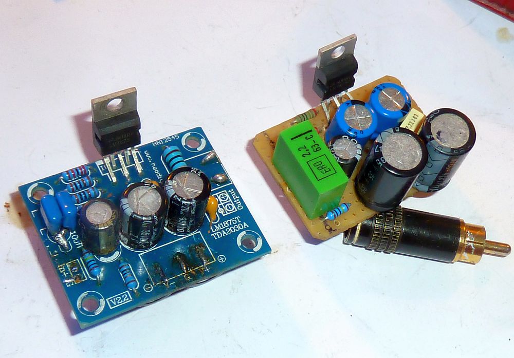

Can you post a better image of the PCB layout?There is even room on the PSU board to add 2 capacitors.
I could give it a try as I have a spare PCB board, but what about the value near the chip? Should it be lowered to 100uf? (now 1500uf)

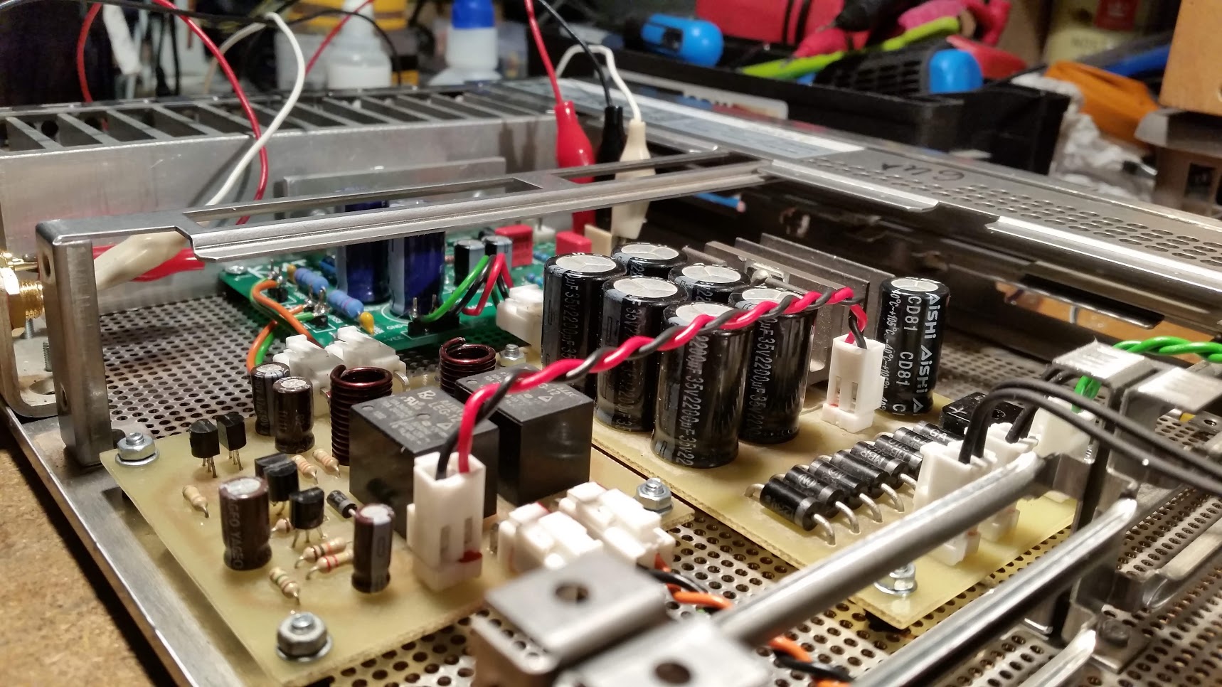

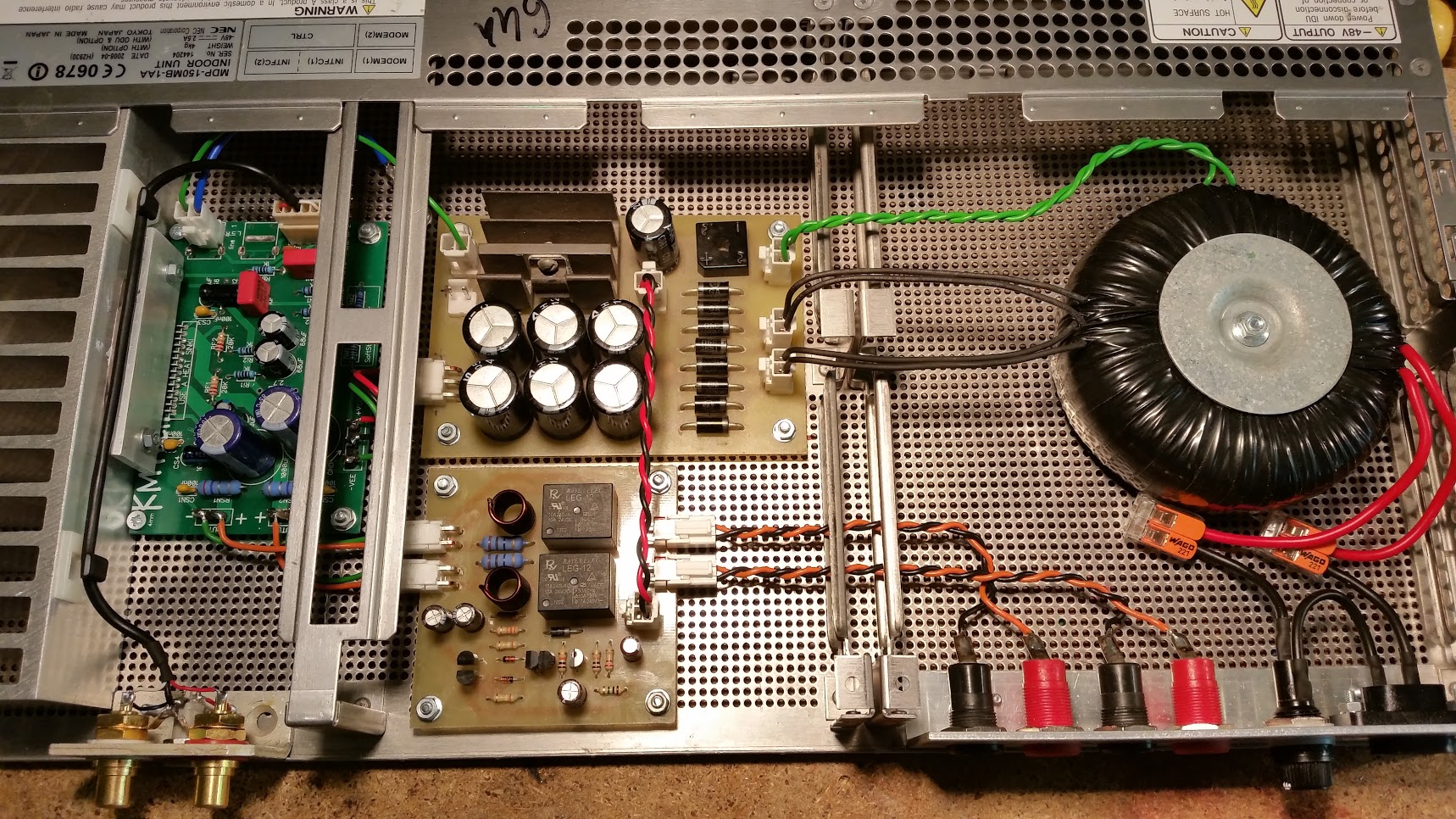

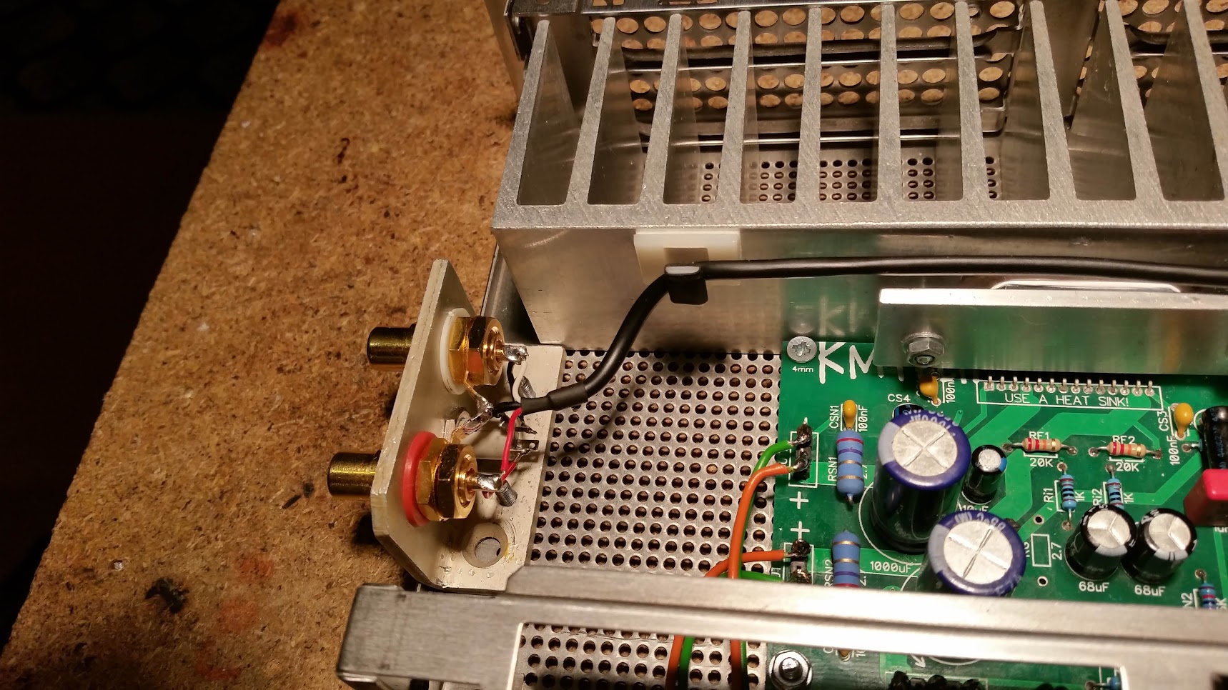

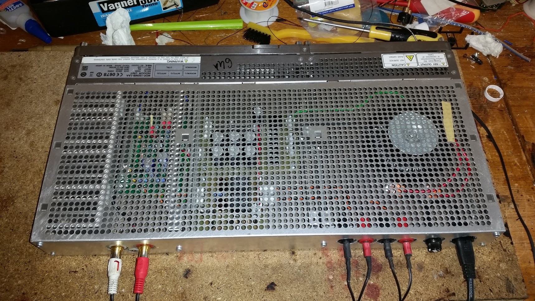

Simple LM4780 amplifier
Hi

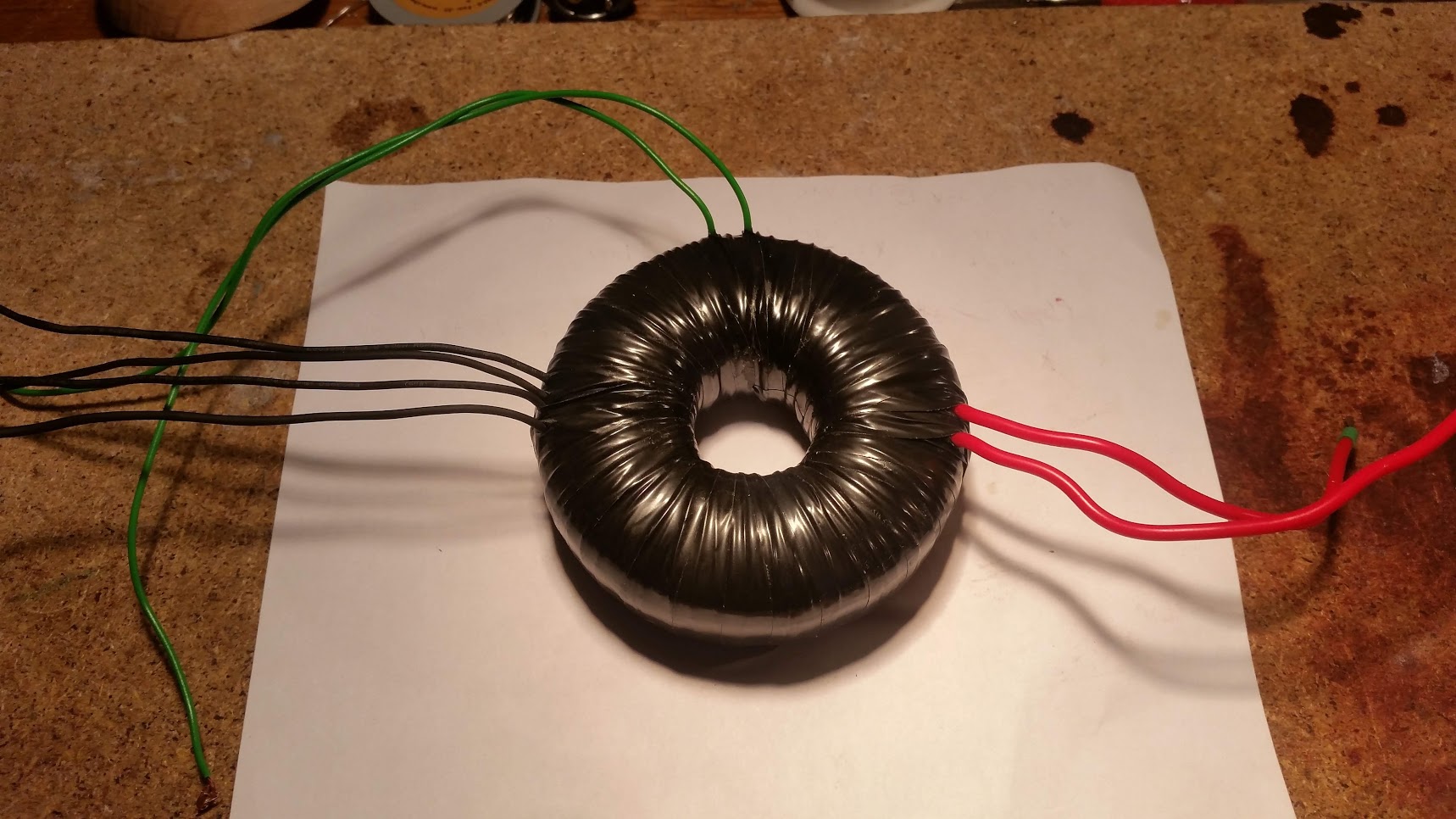

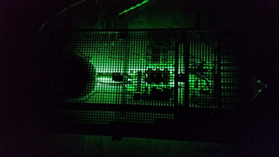

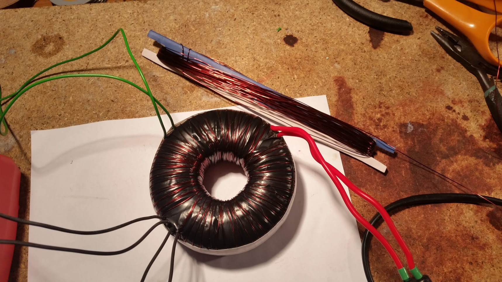

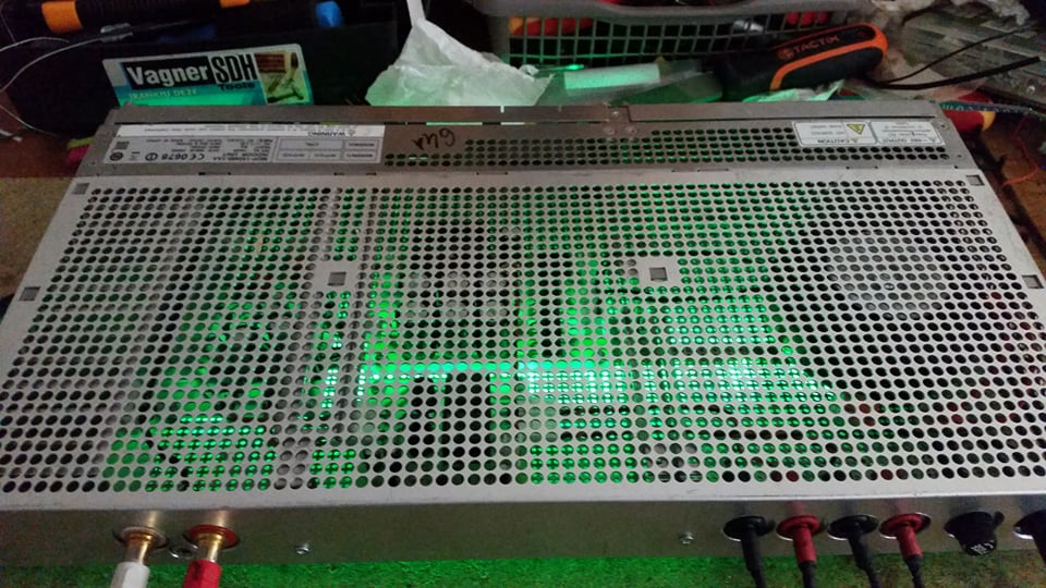

Just finished this little amp. Well, kinda finished, it still needs some deburing around all those holes in cover, and some flat front panel to hide those ugly holes in the front.
Talking about technical side, its very basic amp. I used KM TECH pcb from ebay, which is not perfect, but very close to datasheet, which is star grounded layout. Maybe sometime, I will make my own with improvements.
Parts used are mostly standard application stuff, except power supply caps. I used 1uF ceramics in place of "normal" 100 nF, and 22 uF instead of 10 uF. And ditched the 2.7 ohm resistor between signal and power grounds, because I don't see how it can do something good, if thinking based on feedback and ground routing suggestions, presented by forum member tomchr, it only can make things worse.
Amp has DC protection, since I had it laying around from unfinished project and because it has thiele network. Power supply PCB is from same project and has 12V regulator. Transformer is 2x17 VAC, 100VA.
DC protection need 12VDC, so I added 12.6V winding.
Before someone asks about safety earth, there isn't one in my apartment, so adding it to the projects is useless.

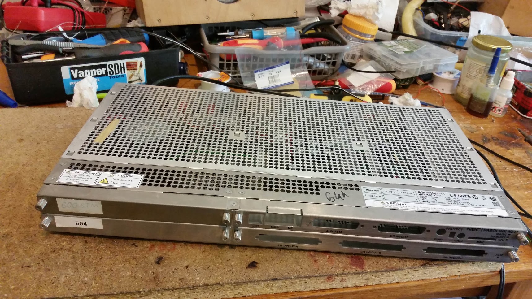

Thanks, I didn't know what was inside those cases. I bought them empty from local electronics shop for cheap.Pasolink Amp 🙂
