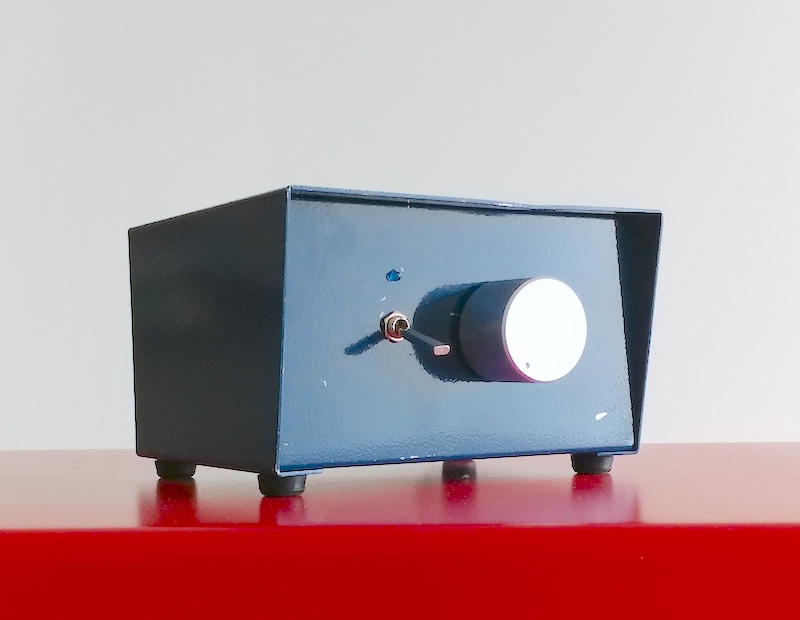

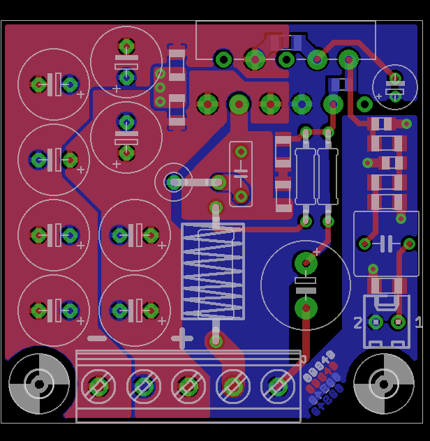

Just finished a stereo lm3886. It's housed in a former receiver enclosure (reusing the old 24-0-24 transformer), with a veneered plywood new frontplate. PCB are my own. 4*4700uF/63V for the main PS.
As it will serve for a computer system where absolute fidelity isn't expected, I've only a 0db, -10db, -20db selector at the back; volume will be mostly digitally controlled. If I'm not too lazy, I might use all the available room for a DAC.
I still have to measure it in details but it seems fine. No offset, no noise, good sound.

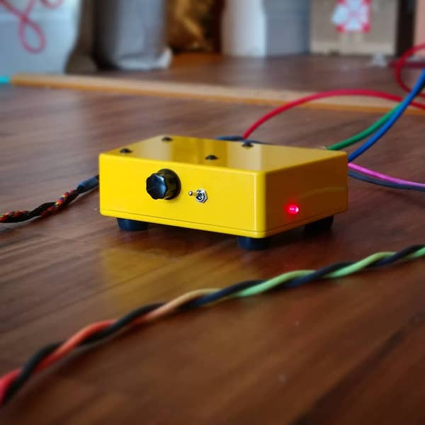

A little class D module I put together for my grandma. Originally there was a different chip, mounted on the side of the case, but some erroneous troubleshooting led to me mounting the TPA3116 on the top. The same troubleshooting led to the 3.5mm input jack on the back going away, the original input switch on the front became the power switch, and I filled an original mounting hole with an LED. I like these little painted Hammond cases.

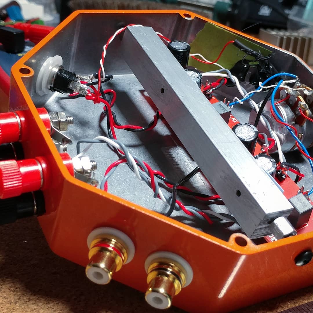

Another one of these little Hammond chassis. After unsuccessfully trying to fit some tiny, $3.25 single-supply LM1875 modules in the yellow case, I figured out a creative heatsink solution using a piece of aluminum bar and got them situated in this orange octagon.
My spatial planning didn't work out perfectly and the power switch was sacrificed: sticker of my dog covering the extra hole. I think I'll hang an inline switch off the back if I want one rather than drill any more holes.
Using an 18V laptop supply and this little thing is doing great with my Tekton Lores.
