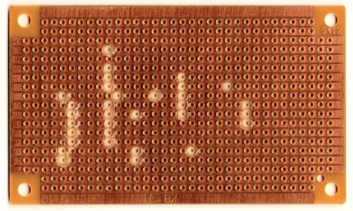

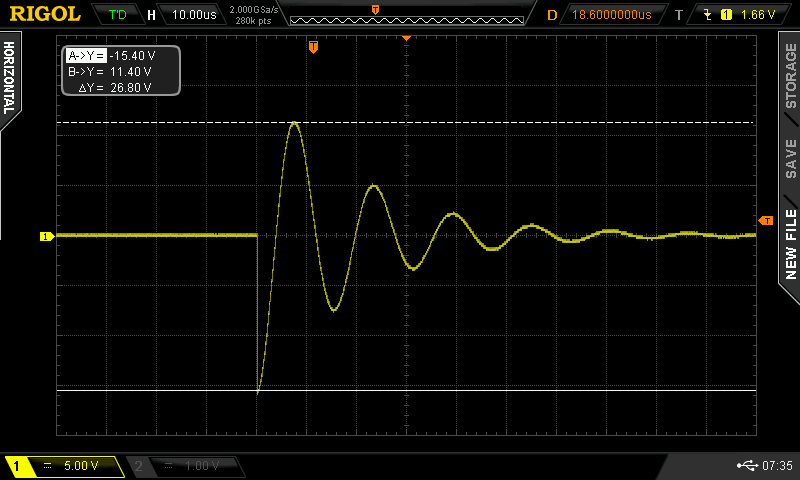

Just now I dragged out my stripboard (aka "veroboard") cheapomodo and took a scope photo with it: Figure 1 below. As you can see the vertical scale is 5 volts/div and the horizontal scale is 10 microsec/div.
The signal amplitude was quite large: -15 volts (cursor A) to +11 volts (cursor B). More than ten thousand millivolts.
You don't need an oscilloscope with 5 millivolts/division of vertical gain, to use Cheapomodo. There may be other reasons to want high sensitivity but Cheapomodo is not one of them.

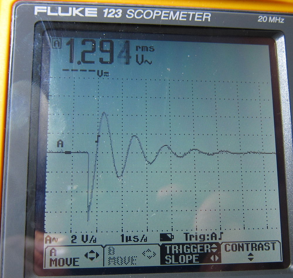

diyAudio member GaryB got a nice result on his Fluke 123 pocket oscilloscope, in post #478 on the Quasimodo thread. Figure 1 below.

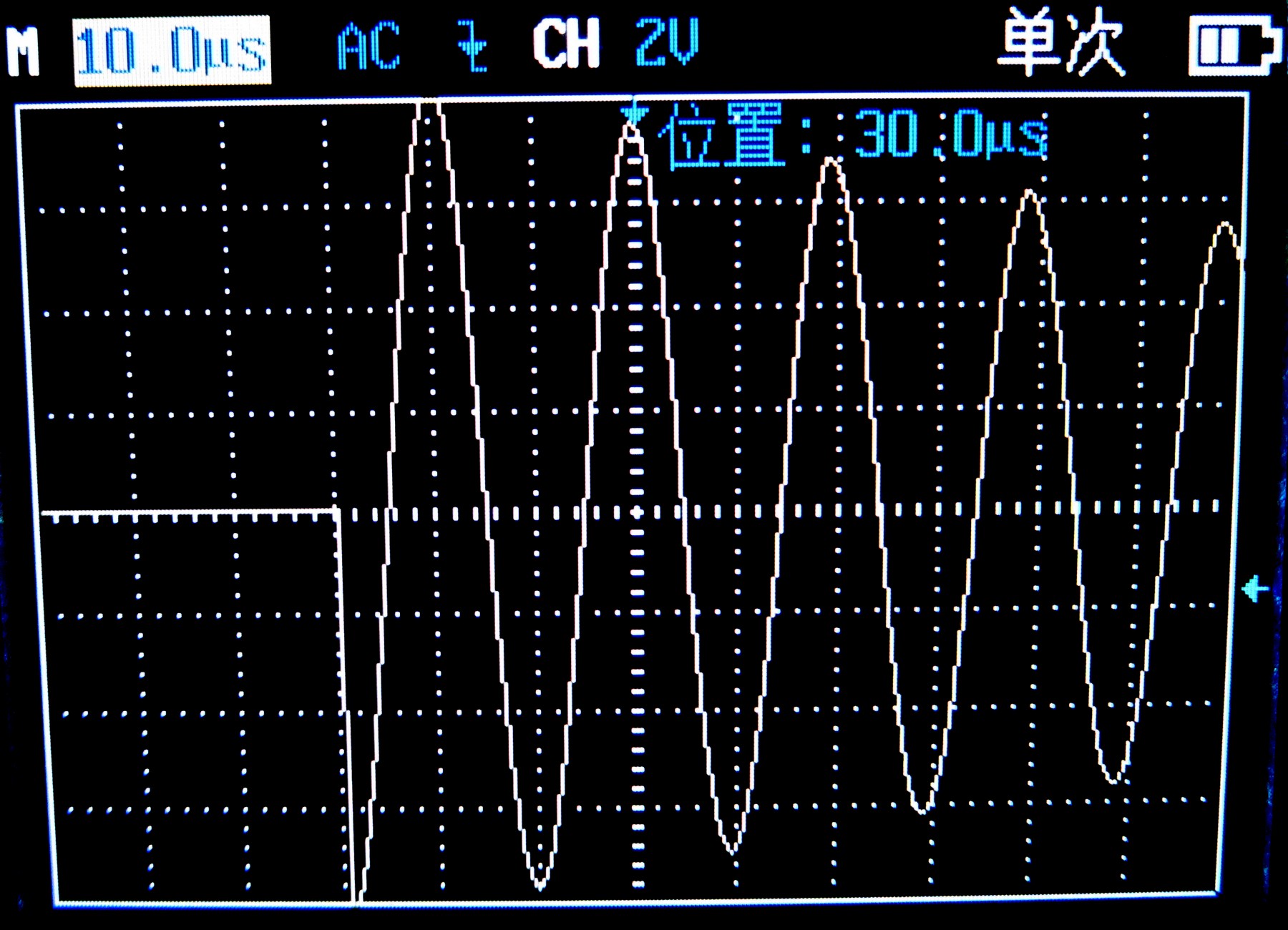

member cwtim01 got a nice result on his pocket oscilloscope in post #375 on the Quasimodo thread. Regrettably I can't read Chinese so I don't know the make and model, see Figure 2 below.

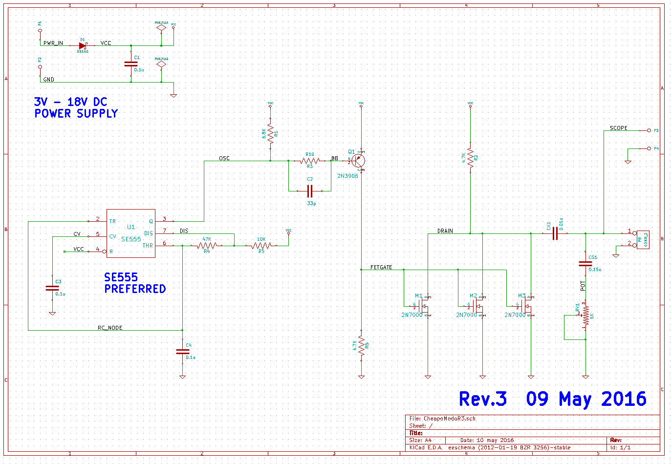

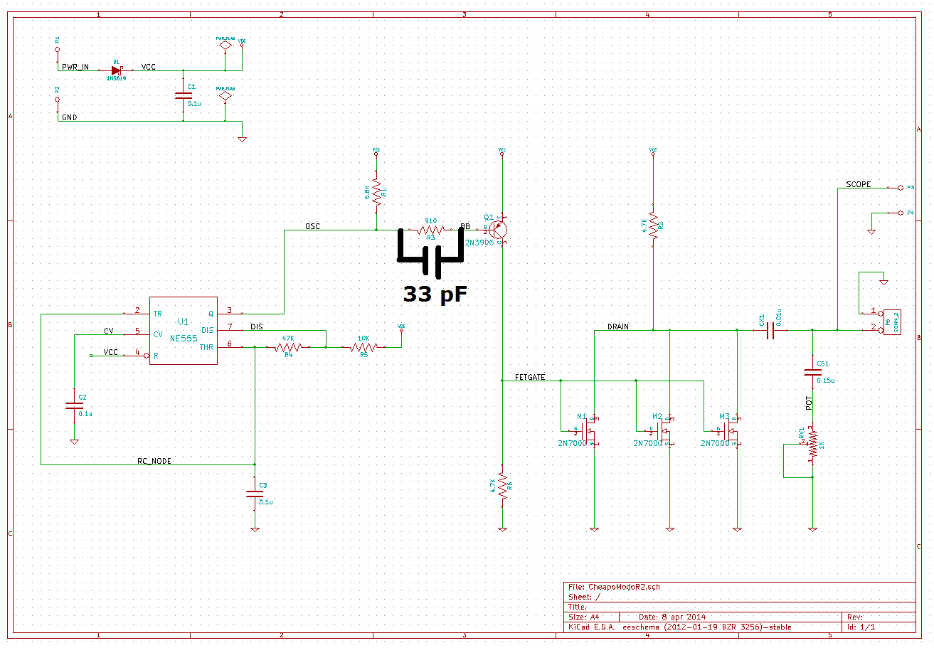

I was noodling around with the Cheapomodo schematic in Post #78, the one with the PNP driver. In LTSPICE simulation it performs ever so slightly better (faster edge rates) when you install a 33 pF capacitor in parallel with the base series resistor, schematic below.
The performance improvement is probably invisible in most situations; I imagine it might only matter when you're testing a transformer with extremely low leakage inductance and, at the same time, operating Cheapomodo from an abnormally low voltage power supply like 3.3V. But still, better is better, even if imperceptably so. 🙂
It's a simple matter to solder this cap straight across the terminals of tbe base resistor. Take a scope photo of a "difficult" transformer before you install the cap, and take another one after the cap. Was the change perceptible? Was it good? (I hope it was).

I added the 33pF speedup capacitor to my CheapoModo PCB layout, moved a few things around a bit, and christened it CheapoModo rev3. The slightly faster risetime on node FETGATE is shown below. (post #129 first mentioned this capacitor) The waveform shows the textbook classic "Miller Effect" when the gate of a MOSFET is trying to rise, at the same time its drain is falling quickly.
