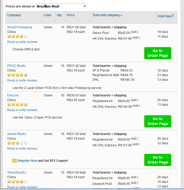

Thanks, Mark, for a very useful design. Some questions:
1) I found the Cheapmodo when I was looking for a TH pcb for the Quasimodo. Is here a place to get pcb for the Quasimodo or the Cheapmodo?
2) Any measuring advantage on building one or the other?
3) I live in Brazil, so I would pay with Paypal and need the kit to be air-mailed to me. Shipping cost?
The CAD files (in Gerber format) for Cheapomodo V.3 are attached to post #132 of this thread. The CAD files (in Gerber format) for Quasimodo are attached to post #1 of the Quasimodo thread. You can download those files yourself, and send them to a PCB maker in China. Choose one from the website pcbshopper.com. An example of its output is shown in the attached image.

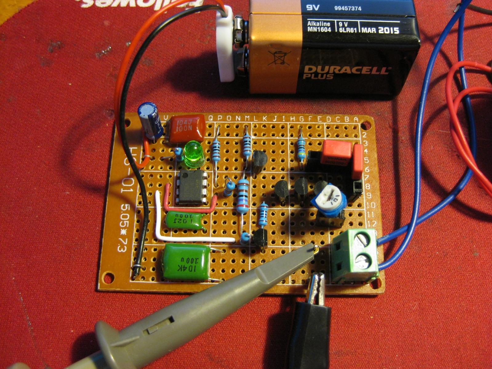

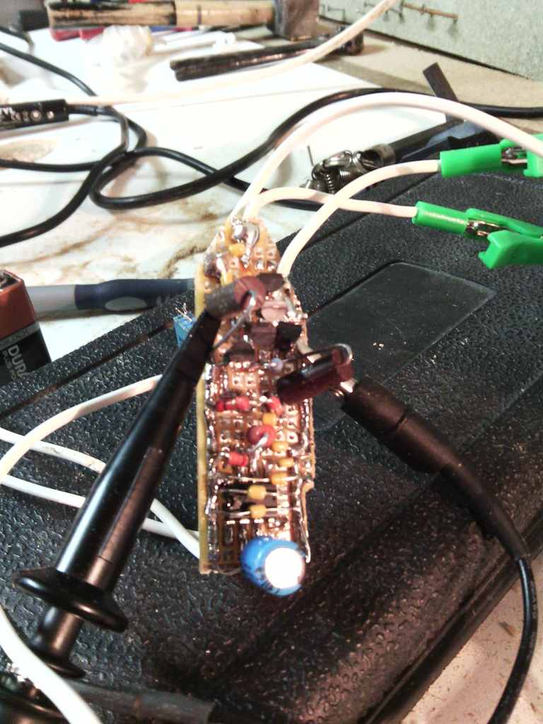

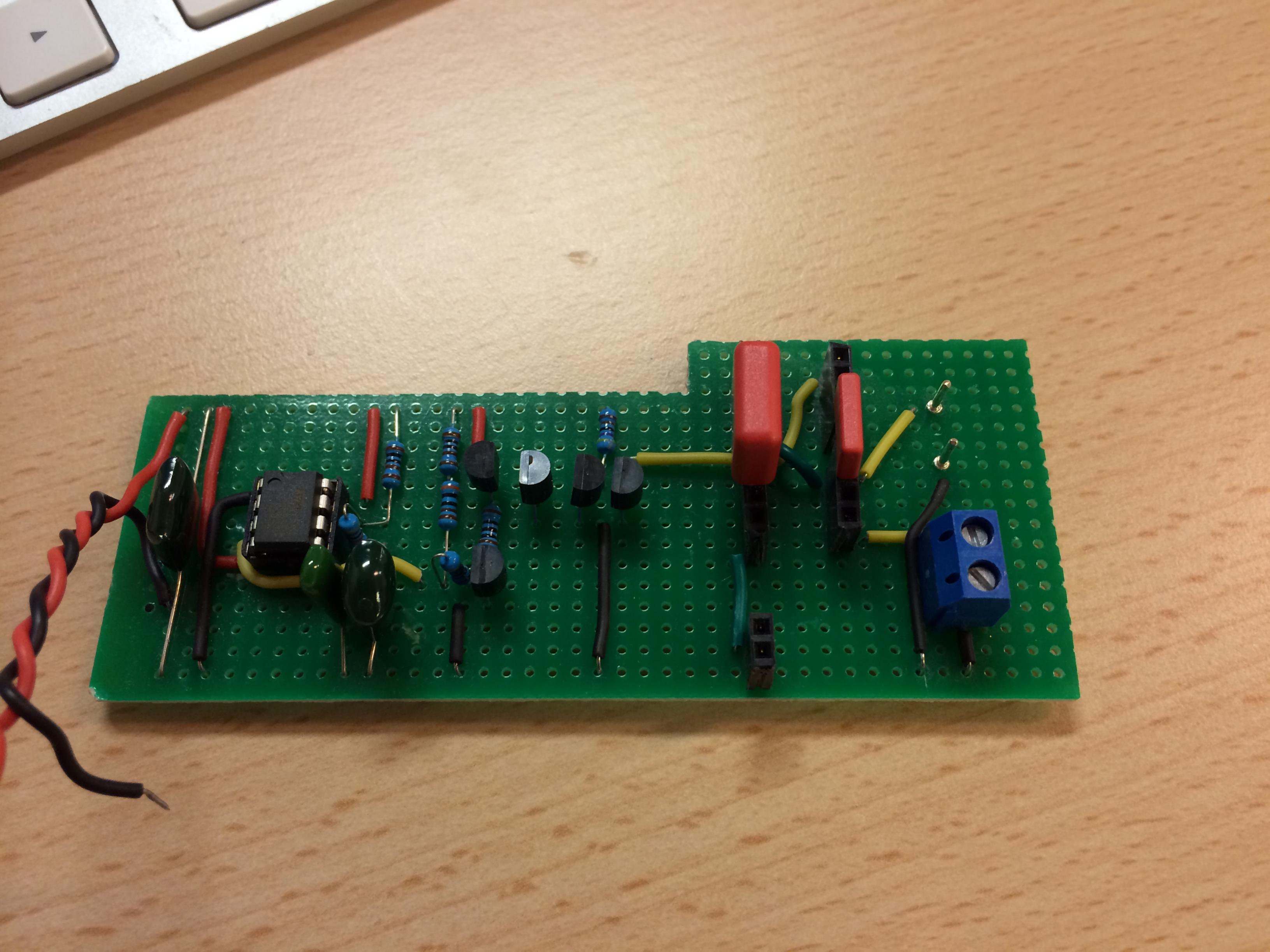

Read post #1 of this thread very carefully. Read it two or three times. Then look at the photographs attached below. Then scan the thread and look at the scope pictures posted by people who built Cheapomodo.

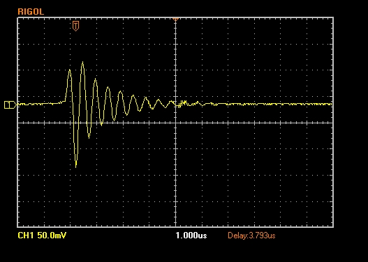

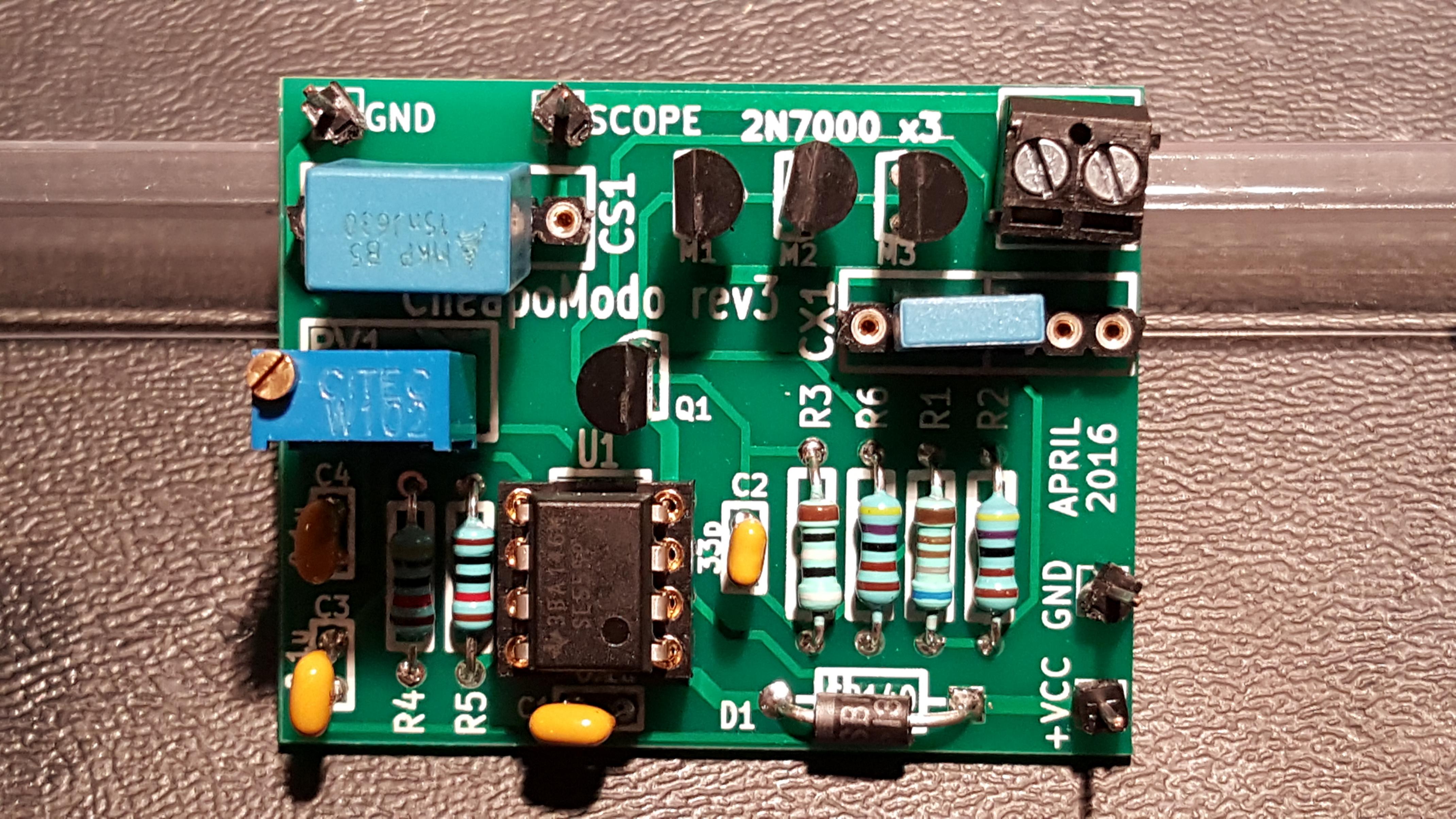

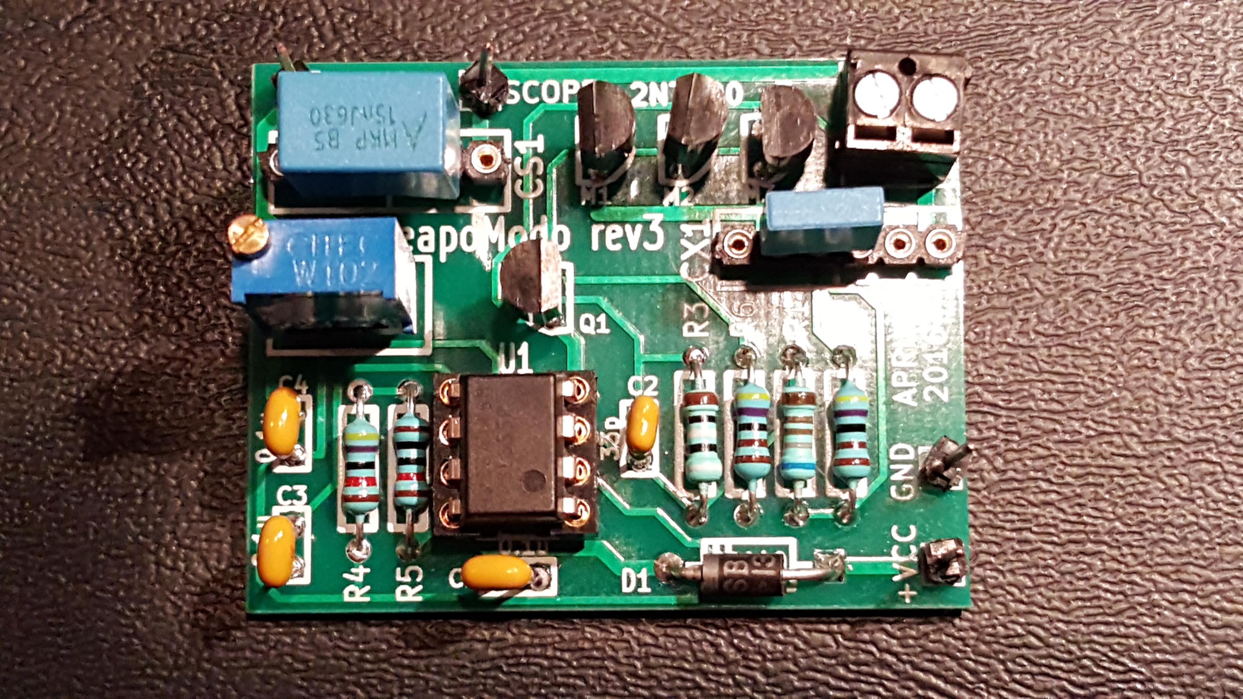

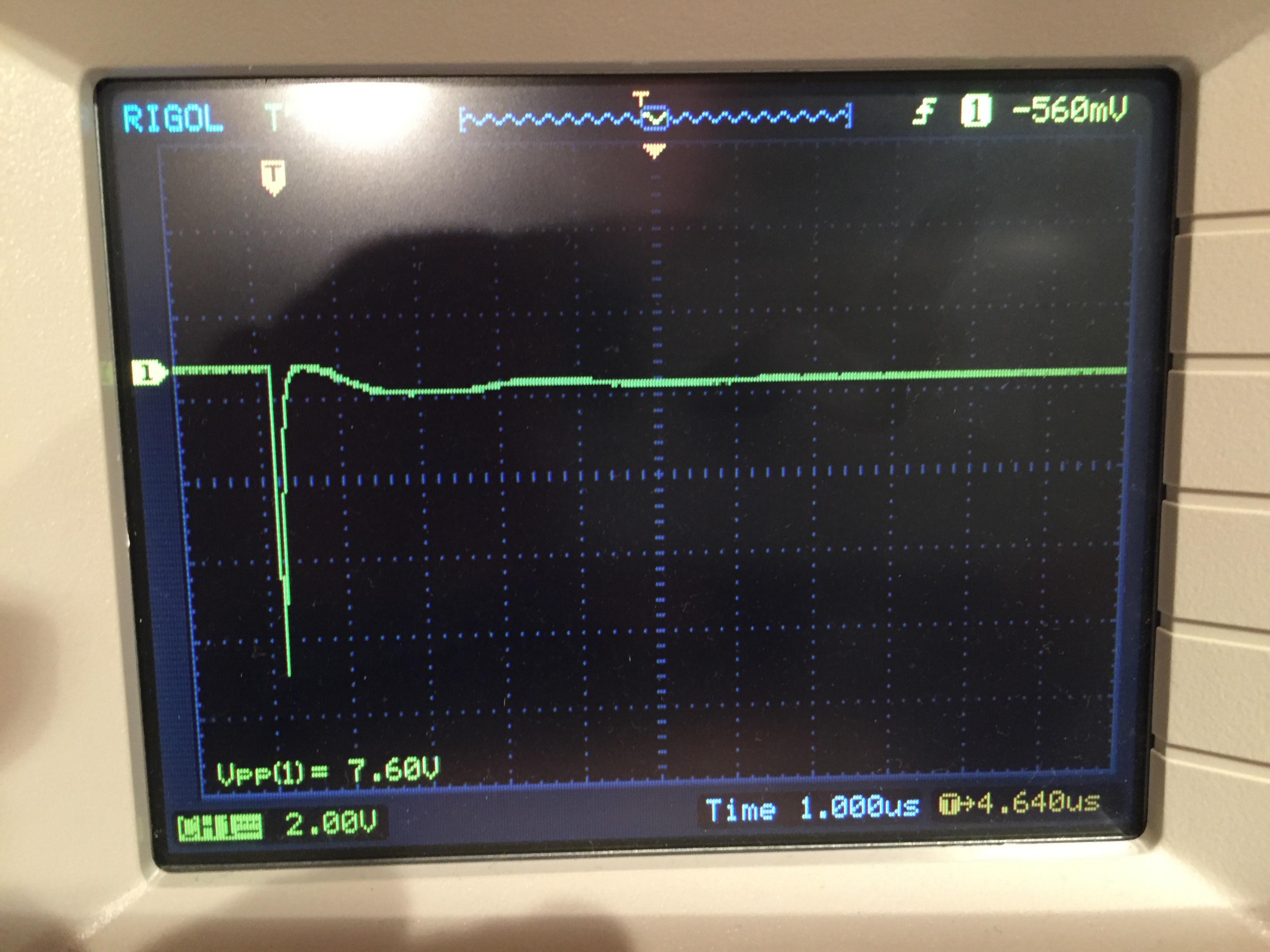

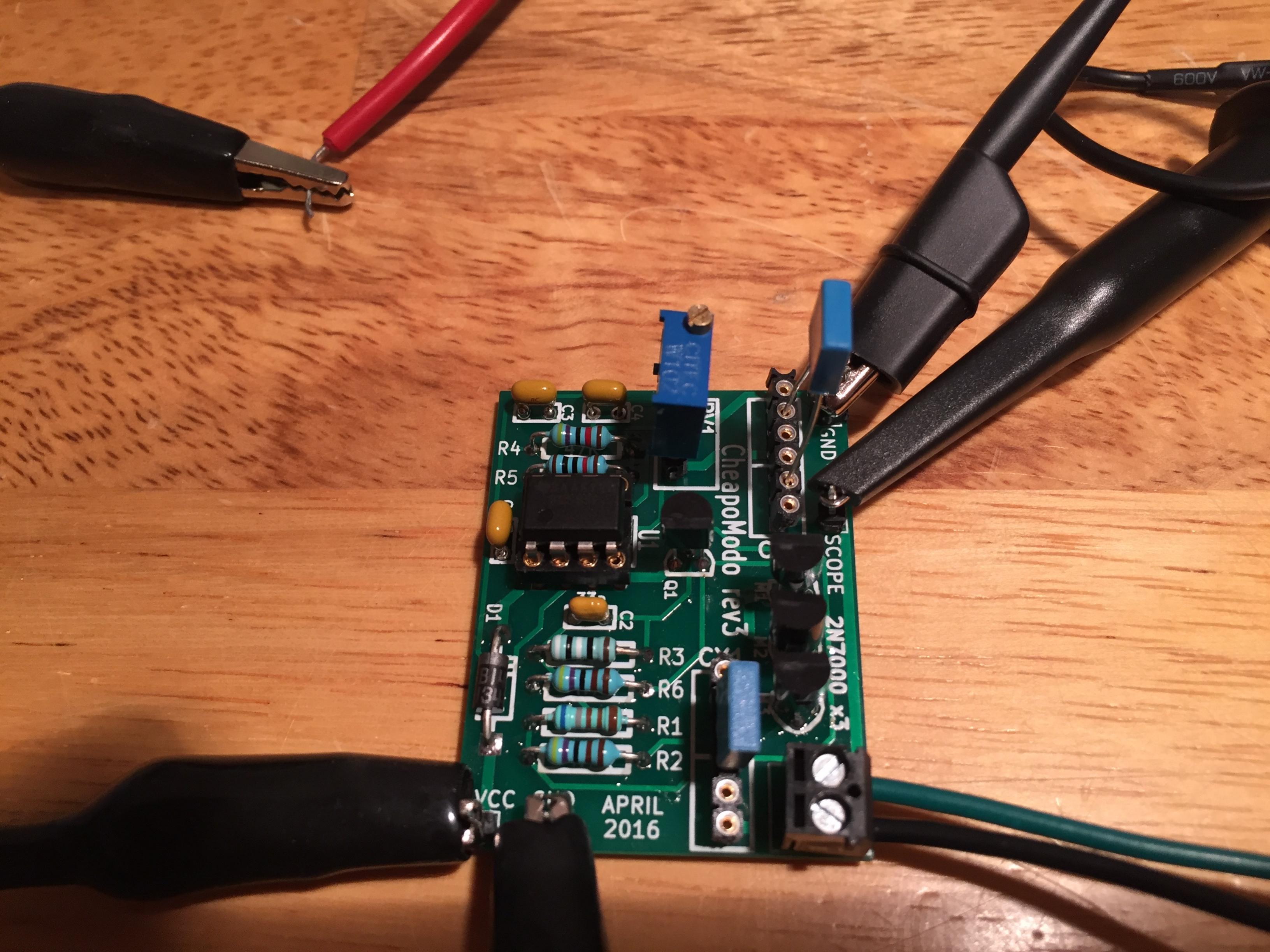

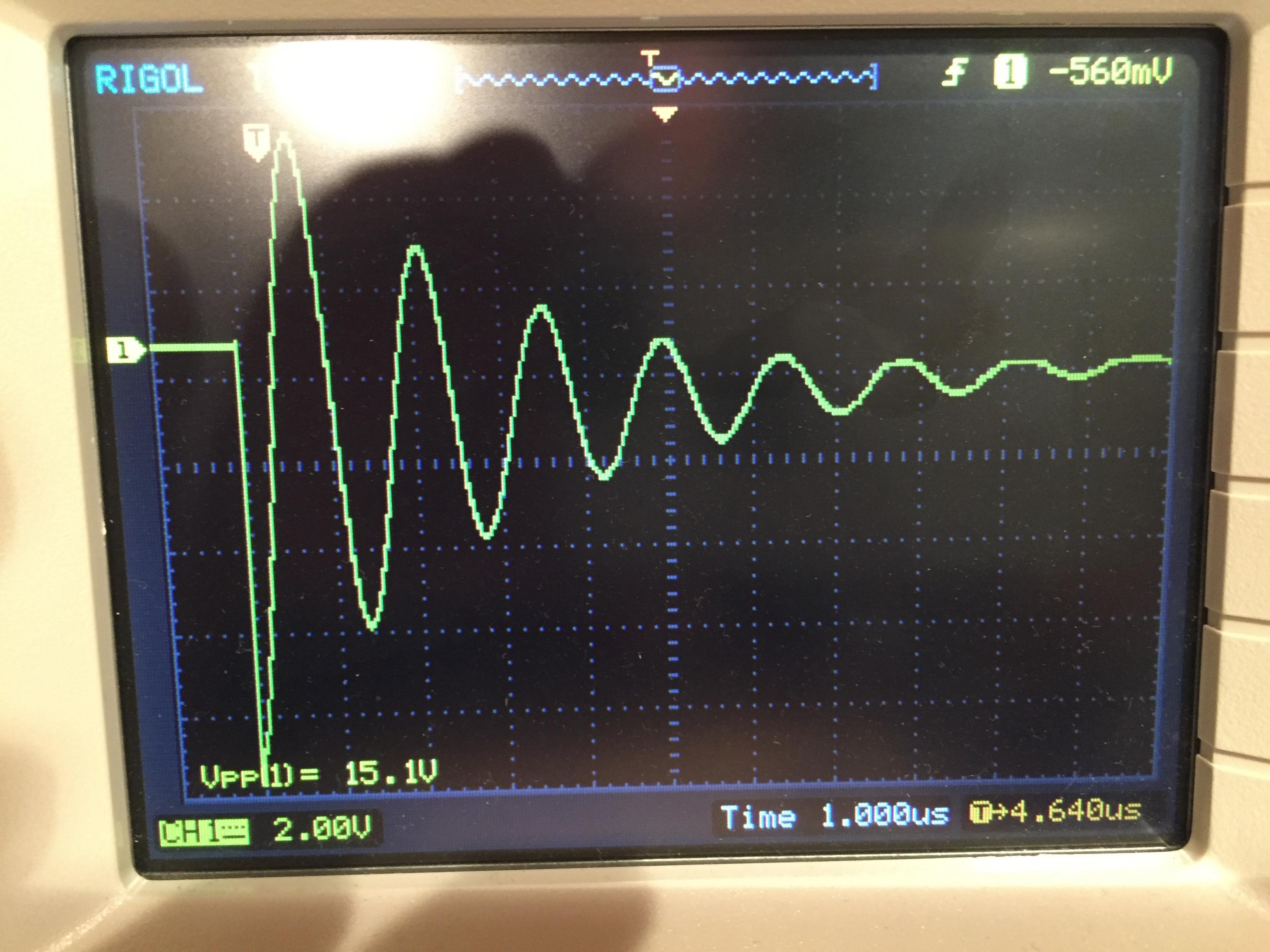

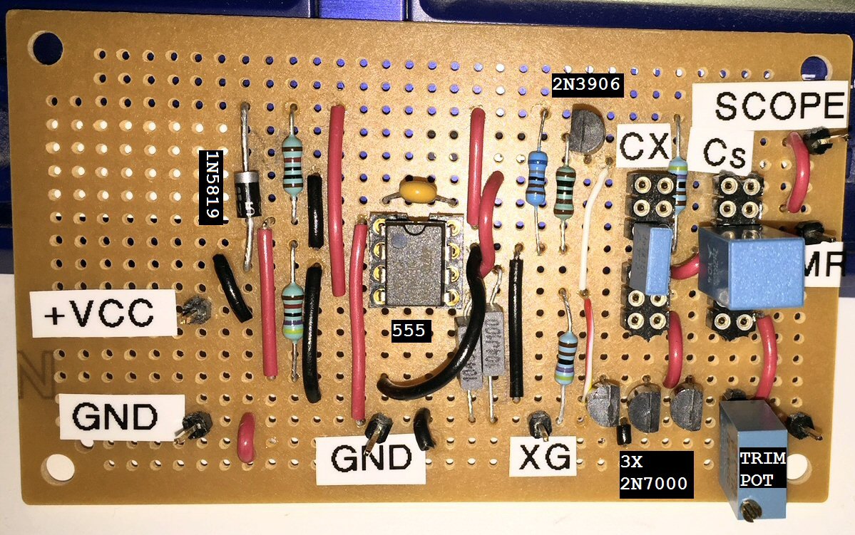

Cheapomodo rev.3 PCB and parts kit arrived yesterday. This is one cool product. I put it together last night and this morning, then did set-up and testing this afternoon...estimated construction and test times are pretty accurate. This has been a real learning experience, and lots of fun. I was able to get the following results at Rs=0Ω (pic 2) and Rs=7.1Ω (pic3) using Cx=.01u and Cs=.15u caps supplied.
Attaboy and congratulations, Kevin!

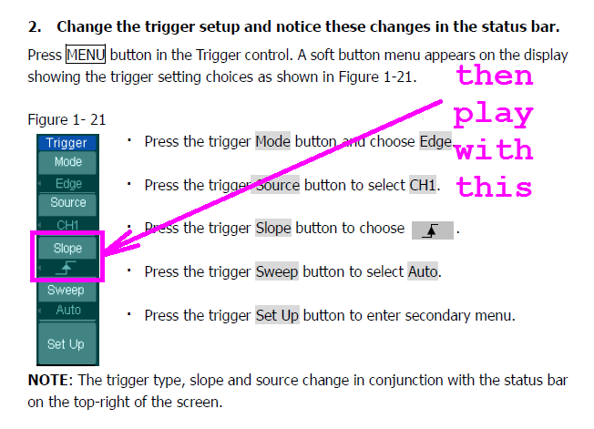

Looks like a very clean build and lovely waveforms on the scope. I see that you're triggering on the rising edge in picture 2; you may discover that with some "ill behaved" transformers, you get a cleaner display if you trigger on the falling edge.
You might want to purchase a couple of additional trimmer potentiometers, next time you place a parts order, just to give yourself finer granularity if and when needed. Maybe a 100 ohm and a 20 ohm pot would be nice things to have in your Cheapomodo project box.
Thanks. You kinda lost me at the rising/falling edge thing. That's ok, it will force me to crack open the manual for my scope. Honestly, It's easier for me to learn visually and go "hands on". I'm actually looking at photos of waveforms in this thread and then turning dials and pushing buttons until I duplicate them. Reading is not my strong point. I've read thru post #51 of this thread, some of the Quasimodo thread, and of most of the Quasimodo note...that was enough to get me this far.
I will be ordering parts soon, so I'll get some trimmers.

It clearly shows why we should NOT add a lonely capacitor across the rectifier.
the ringing pic2 shows what we get when the transformer sees a step change in current demand and the rectifier or the transformer has a capacitor (0r of resistance) across instead of a snubber (R+C).Cheapomodo rev.3 PCB and parts kit arrived yesterday. This is one cool product. I put it together last night and this morning, then did set-up and testing this afternoon...estimated construction and test times are pretty accurate. This has been a real learning experience, and lots of fun. I was able to get the following results at Rs=0Ω (pic 2) and Rs=7.1Ω (pic3) using Cx=.01u and Cs=.15u caps supplied.

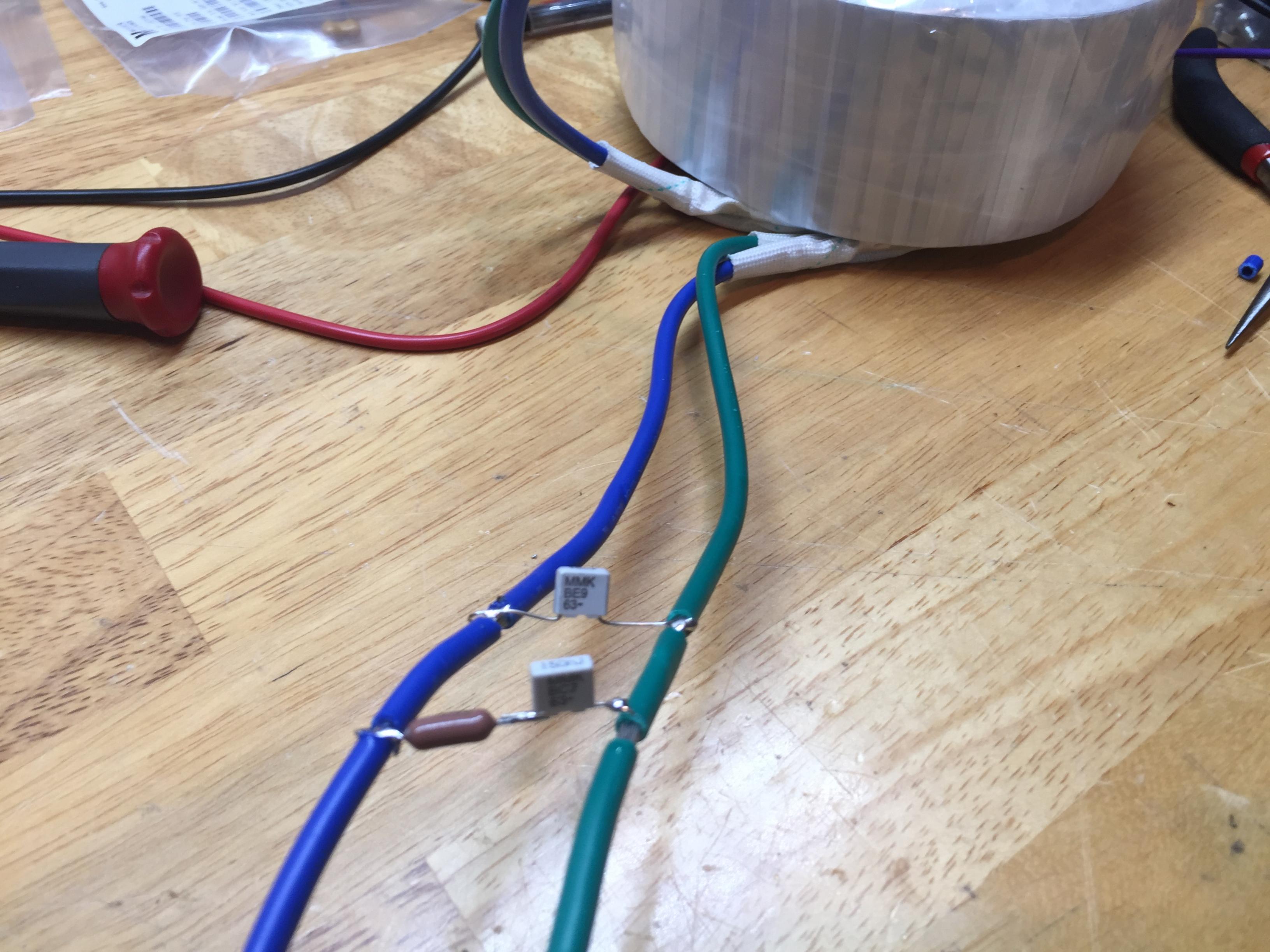

The simple thing to do is (a) read Quasimodo design note page 7 paragraph 2; (b) purchase ten pieces each of Cx and Cs, with a voltage rating that's quite a bit larger than (1.5 x Vrms) voltage of your transformer secondary; (c) use these newly purchased capacitors, both for Cheapomodo testing AND in the final audio equipment.
Now you are very confident that the capacitors which worked well with your transformer in Cheapomodo, will also work well with your transformer in the final audio equipment -- because the exact same capacitors and the exact same transformer were used for both. You saw it perform well, with your own eyeballs, on your own oscilloscope. Sleep soundly.

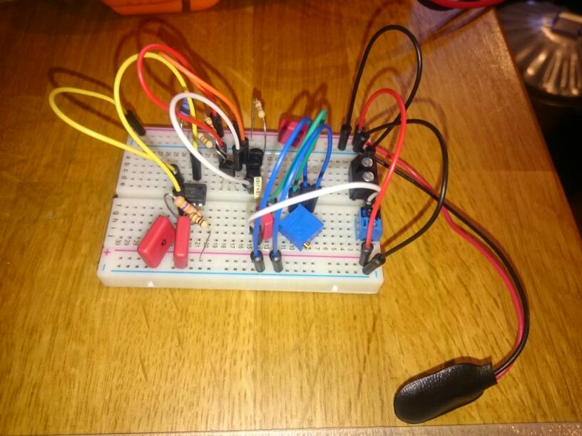

Is it possible to verify that the actual snubber connected across the secondary is working by using the CheapoModo? The first attachment is the trace I get when inserting the actual parts I ordered in the CheapoModo and connecting to one secondary. The second attachment is the snubber installed in the transformer secondary. The third attachment is the trace I get with Cx, Cs, and Rs removed from CheapoModo, but having it connected to the transformer with snubber installed.
![IMG_1821[1].jpg IMG_1821[1].jpg](https://www.diyaudio.com/community/data/attachments/562/562111-e1555ec7a2b4f3aabf954e3cfac013f8.jpg?hash=4VVex6K086)
