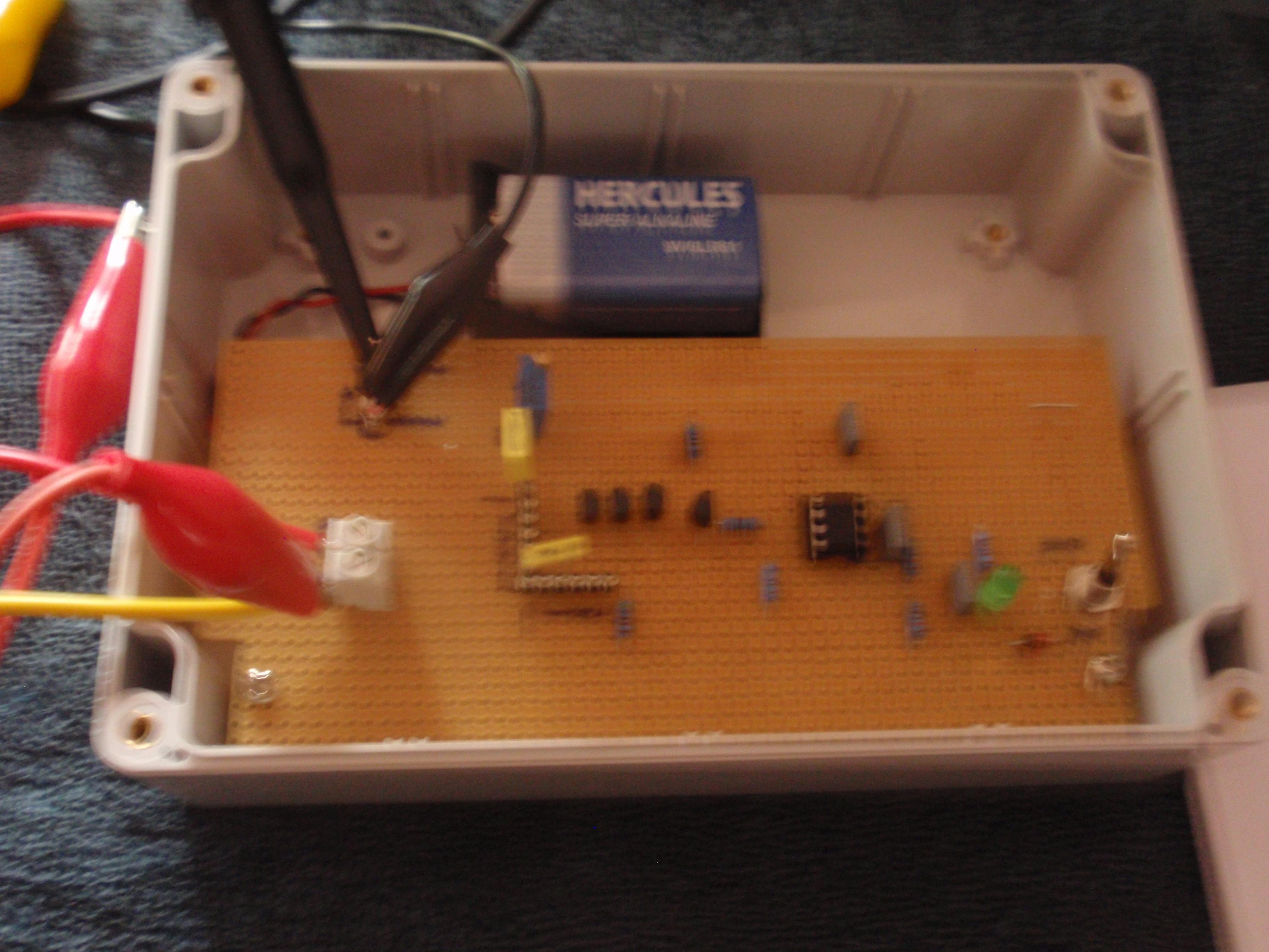

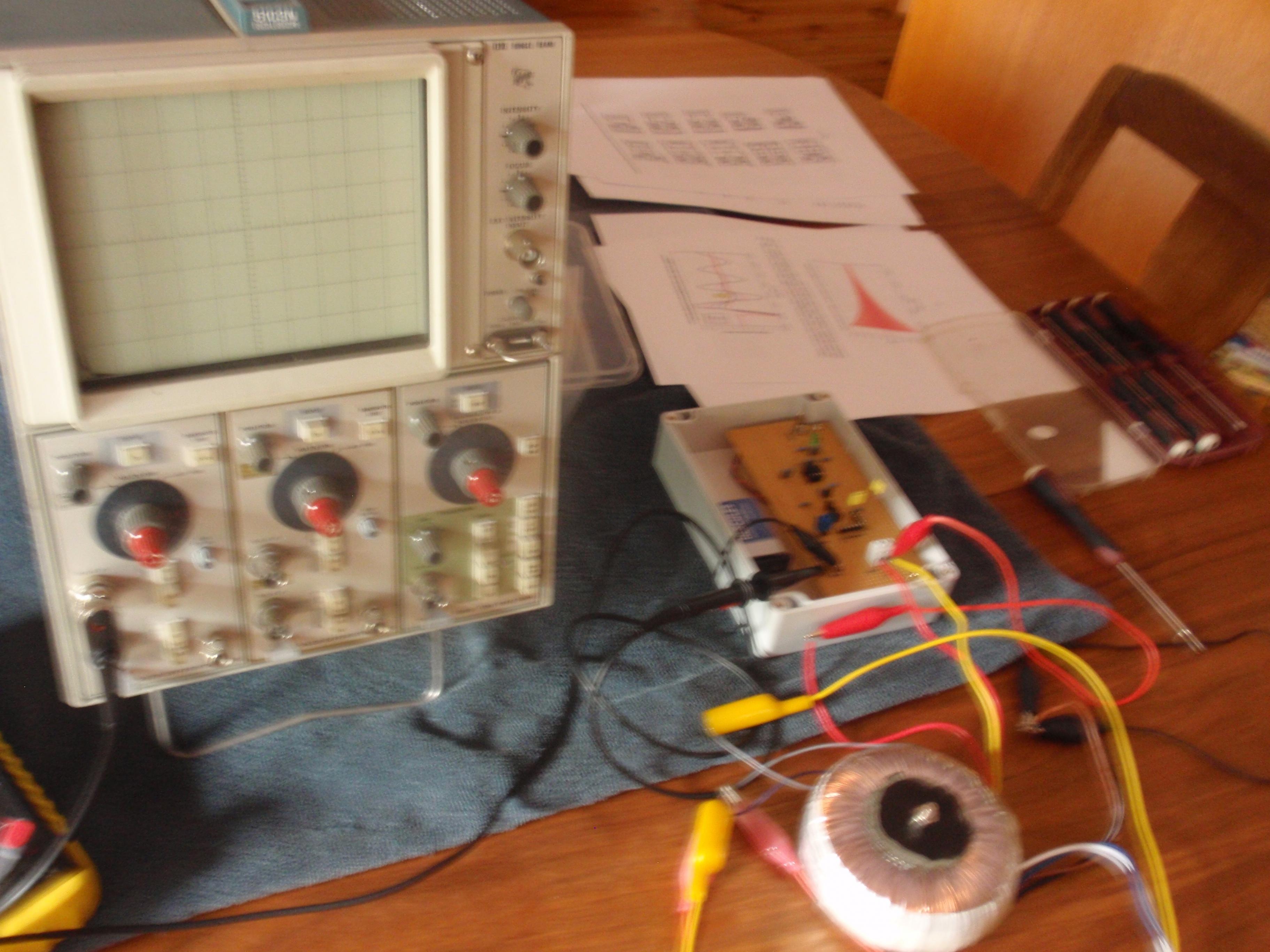

Cheap Modo Rev 2 up and running
I think it was more like four hours to put it on a board and in a box. The trace is very faint on my Tek 5103N - just dim the lights and there it is.

Nice job and congratulations, bondini!
CheapoModo's bigger brother Quasimodo lets you vary the frequency 1X, 5X, 25X to help out in exactly this situation: dim trace on analog scope. Boosting the frequency 5X will, in theory, make the trace 5X brighter, since you're increasing the duty cycle (time painting the screen)/(time not painting the screen) by 5X. If you're happy with it as-is, good on ya and carry on. If you want to fool around with an experiment or two, use crocodile clip jumpers to temporarily connect a 12K or 10K resistor in parallel with the 47K resistor R2 (schematic in post #1 of CheapoModo thread). This will speed up the oscillator. If it improves your CM, great.
I omitted the frequency switch from CheapoModo because it increases complexity, because most people have digital scopes these days, and because a fast oscillator may not let the RLC ringing completely settle out to zero, in a severely underdamped situation.
