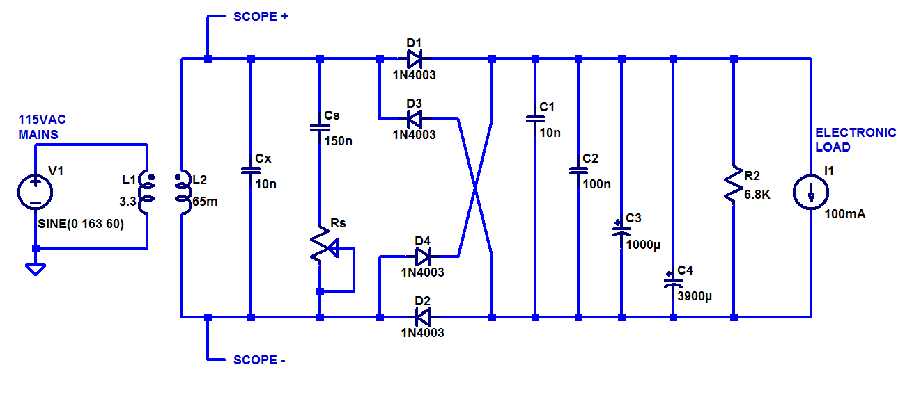

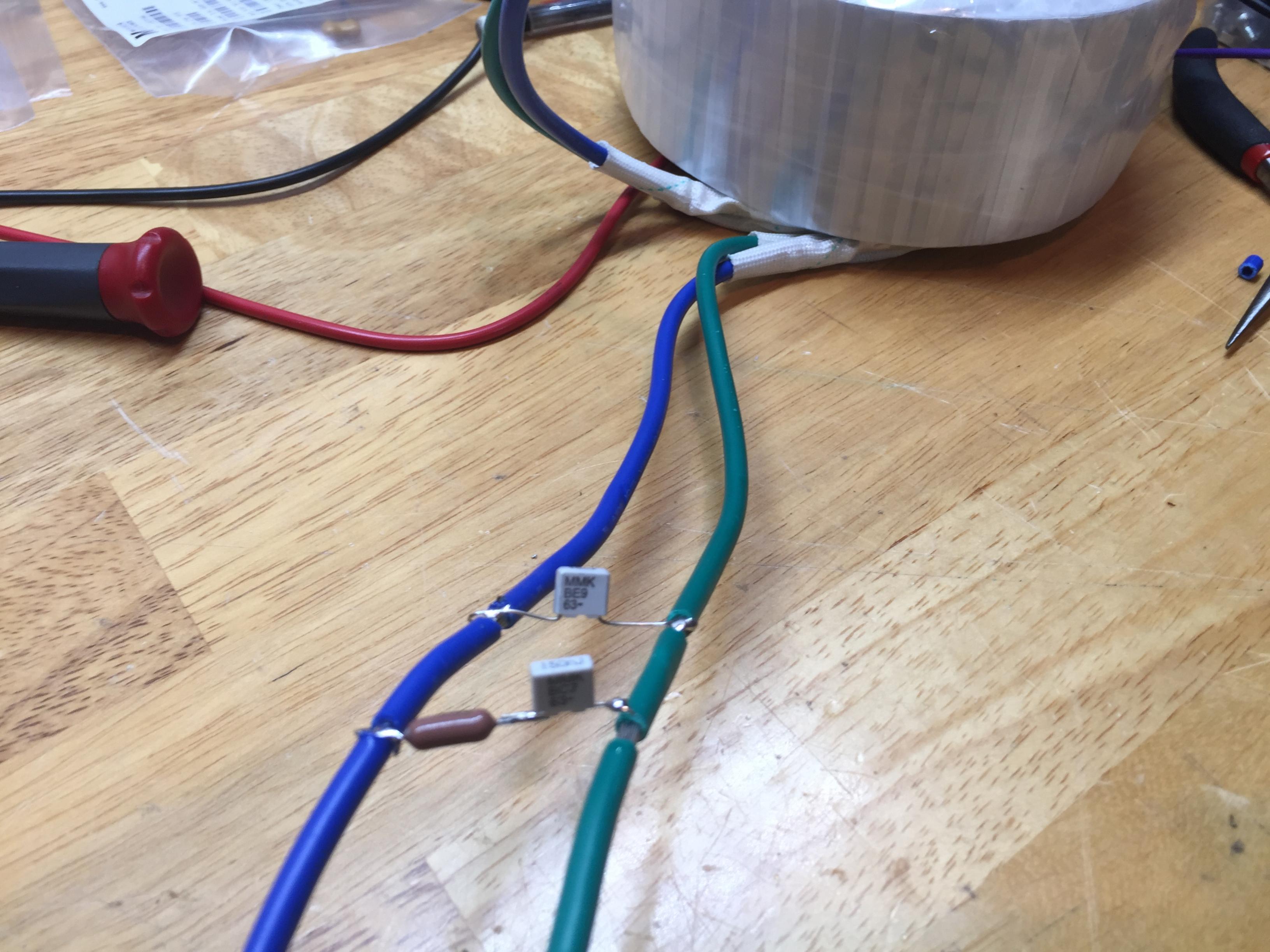

Is it possible to verify that the actual snubber connected across the secondary is working by using the CheapoModo? The first attachment is the trace I get when inserting the actual parts I ordered in the CheapoModo and connecting to one secondary. The second attachment is the snubber installed in the transformer secondary. The third attachment is the trace I get with Cx, Cs, and Rs removed from CheapoModo, but having it connected to the transformer with snubber installed.
View attachment 602493 View attachment 602497View attachment 602494
interesting question - in addition to the snubber network what are the blue and green secondary wires connected to ? A diode bridge + cap bank + load ?
PS. Why does one leg of the snubber network look like its left unsoldered from the tap on the green wire ?
The secondary wires are not connected to anything other than the Cheapomodo.
It was difficult to solder the components to the 10 gauge wire coming from the transformer. A cold solder joint broke, I was hoping no one would notice. You guys don't miss a thing. That was repaired and has nothing to do with the trace in attachment 3.

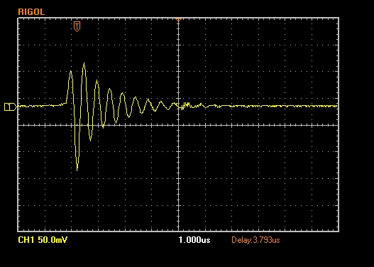

Cx=10nF was fitted. Cs=150nF was fitted. Rs was unsocketed (infinity ohms) to make it easier to measure the ringing frequency and confirm / disconfirm the results from diyAudio member DNi. It was the exact schematic shown below, with actual live mains AC applied (USA 115V) at the left and actual live electronic load connected at the right. Rs = infinity. To no-one's great surprise, the ringing frequency was the same whether (Lleakage + Cx) was resonating in the bellringer jig, or in the linear power supply shown here.
Spend a dozen seconds calculating Lleakage given Cx and f_ringing; it is a startling number of femtohenries.

A single Cx straight across the secondary is a snubber, at least in some people's opinion. Neurochrome's website says so, for example. Image below.
And if you experiment with your own Cheapomodo you can verify that Cx all by itself, does in fact change the secondary's ringing waveform amplitude, frequency, and Q (damping). Does that make Cx a "snubber" all by itself? Some people think so.

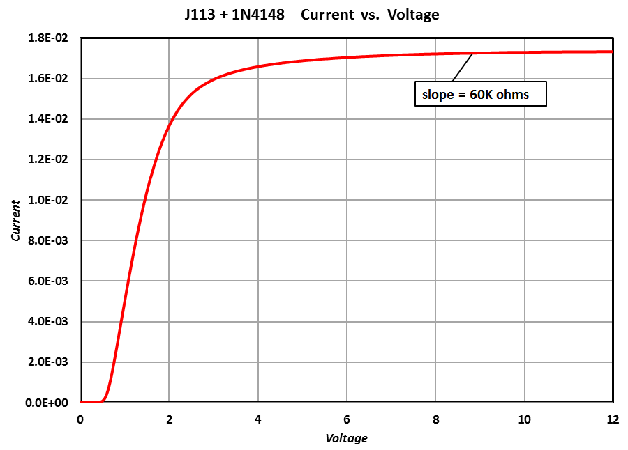

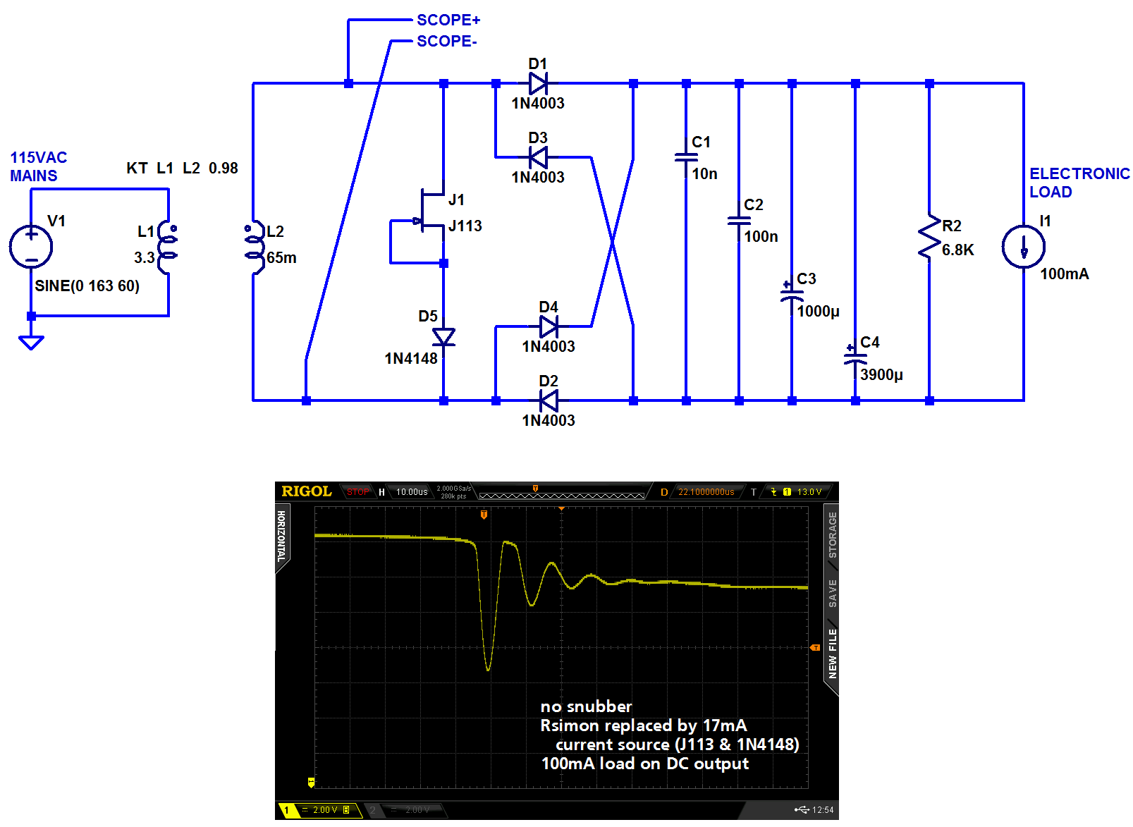

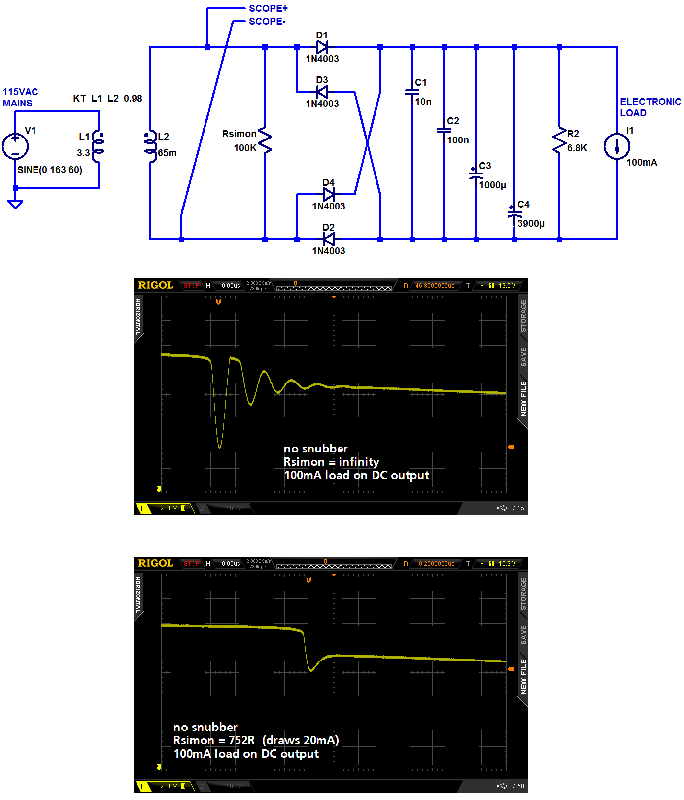

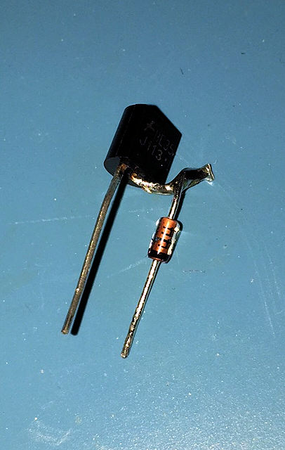

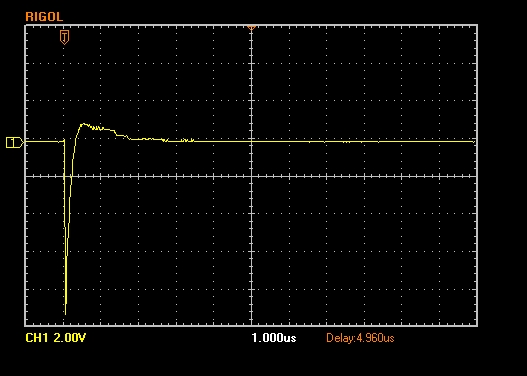

diyAudio member simon7000 and I fooled around with R-only snubbers last month. I took the scope photos shown below.
We tested (and disproved!) the hypothesis that the resistor prevents the transformer from suddenly "un-loading" -- its secondary current suddenly snaps to zero -- when the diode switches off, and it is this "un-loading" which allows ringing to occur. According to this false hypothesis, by connecting a resistor straight across the secondary, a healthy amount of current continues to flow in the secondary when the diode switches off, and ringing is prevented.
This was disproved by replacing the resistor with a constant current source whose Norton output resistance was 60 Kohms. Same current flows but -- Shazam! -- ringing persists.
The explanation is straightforward: the resistor is simply the "R" part of the RLC resonant circuit in the secondary, and it damps the oscillatory ringing. Just like they teach in Linear Systems Theory at EE school: R = (1/(2*Zeta))*sqrt(L/C).
Connecting a single R across the secondary becomes more and more impractical when (a) transformers with higher secondary voltages are used; (b) transformers with lower leakage inductances are used. The power dissipated in the resistor becomes unacceptably large in both situations, which is why the more universal snubbing solution connects a capacitor in series with the damping resistor.
