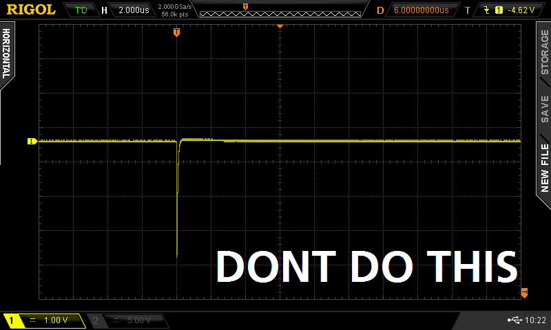

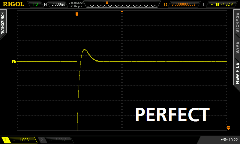

Turned around and I get pretty much the same as my first photo. About as good as I can get it. Turning either way just seems to produce less damping.
It sounds like you might have accidentally plugged Cx where Cs is supposed to go, and plugged Cs where Cx is supposed to go. It's worth checking.
I think you may want to back up and find out whether the problem is with your CheapoModo board, or with the Cs, Cx, Rtrimmer, or with the transformer.
One experiment that always boosts people's confidence, is to temporarily disconnect the transformer secondary, and instead connect a fixed inductor of known value, something between 5 uH and 220 uH, in its place. See whether Quasomodo can damp this RLC circuit to give Zeta=1.0. If it can then you feel more confident in your board and in your lab technique. It it can't then you are certain the problem is with the tester and not with the transformer.
You might need to try a 200 ohm trimmer or even a 50 ohm trimmer, just so you can slowly and methodically explore the very low-ohms end of the potentiometer's travel.

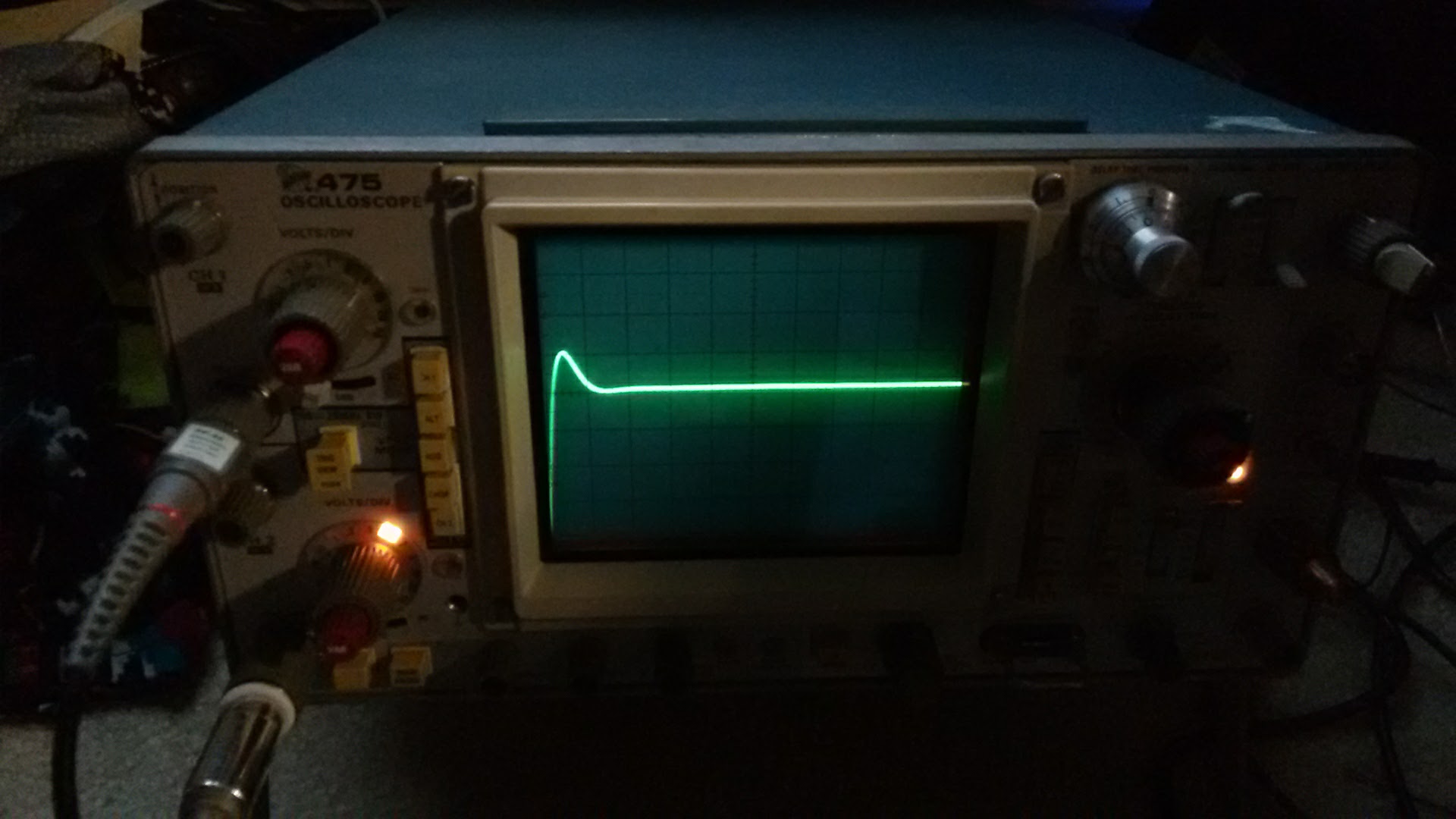

Since I didn't have a choke handy, I do have various transformers in my parts box. So I grabbed a small Antek toroidal, hooked it up, and made sure to put back the default Cs cap.
This transformer was easier to dial in, as seen here. No problems with this one compared to the dual bobbin I had earlier.

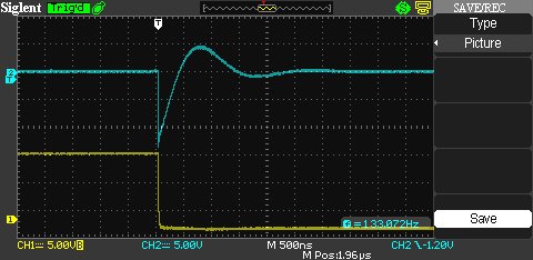

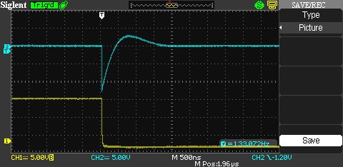

Alright, I got the board working, I think. Plugged it in to my AN-10445 and got this output on the oscilloscope. The Rs goes from infinity down to 41 Ohm and down to 28.5 Ohm. If I reduce resistance the line flattens even more... What is the optimal value for Rs? Why can't I just short it out?

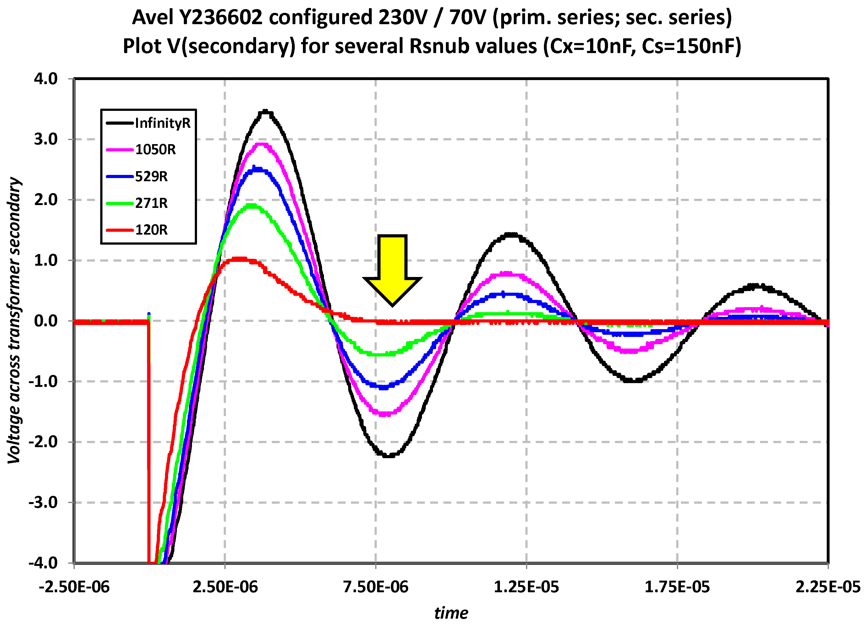

Can you dial in the Rs value even lower?
Looking at your plots, it seems to me that 41ohms is still ringing a bit.
28r5 seems close to optimum. Maybe optimum is somewhere between 20ohms and 30ohms.
Try 10ohms and 5ohms and compare to your existing plots.
C+R = snubber when the resistor absorbs energy and thus damps the ringing.
If R is made infinite, no current flows and no energy is absorbed and no damping ocurrs.
If R is made zero then current flows through the capacitor but the resistor absorbs no energy and thus no damping of the ringing.
The optimum value of Rs is the value which juuuuust barely manages to flatten the 2nd hump in the waveform. The 2nd hump is indicated by the yellow arrow in Figures 10 and 11 of the Quasimodo design note (below). The setting of Rs which gives the red waveform, is optimum for this transformer + Cx + Cs.
_
Alright, the way I understand this explanation is that I will keep reducing Rs until I don't see the second hump, but not beyond that point, right?
In that case, going to the scope pictures I posted I'm my earlier post, 28.5 Ohm is perfect. I flattened the second hump (which was still visible on the 41 Ohm picture) but not more.
If I keep reducing Rs the snubber will not serve it's purpose (even though from the scope it looks like I keep flattening resonance output). Why so? I was fully expecting the resonance to start picking up as I keep lowering Rs down to 0, however I don't see this happening
