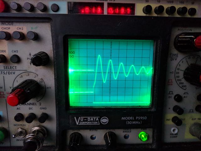

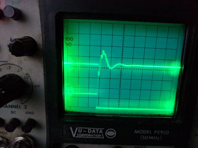

Have now replaced all 3 2N7000 FETs and have produced some results. However, it does not seen to look like these Oscilloscope Outputs
With the oscilloscope set to 1V/div and 10uS/div, these are my results
Overdamped
Underdamped
Critical damping?
Do these results look OK?
Joined 2011
You want to set your oscilloscope to trigger on the FALLING edge of the transformer secondary waveform.
Even better, connect two scope probes to the two channels of the scope: channel A to the transformer secondary, channel B to node "DRAIN" (accessible as the leg of capacitor Cx). Trigger on the falling edge of channel B and display both waveforms on the scope. You should see a dual trace picture very similar to post #85.

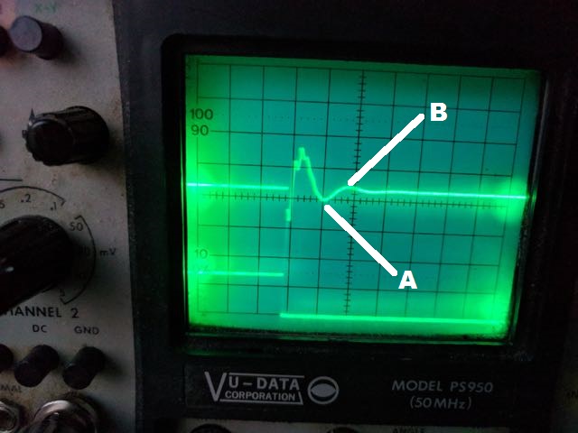

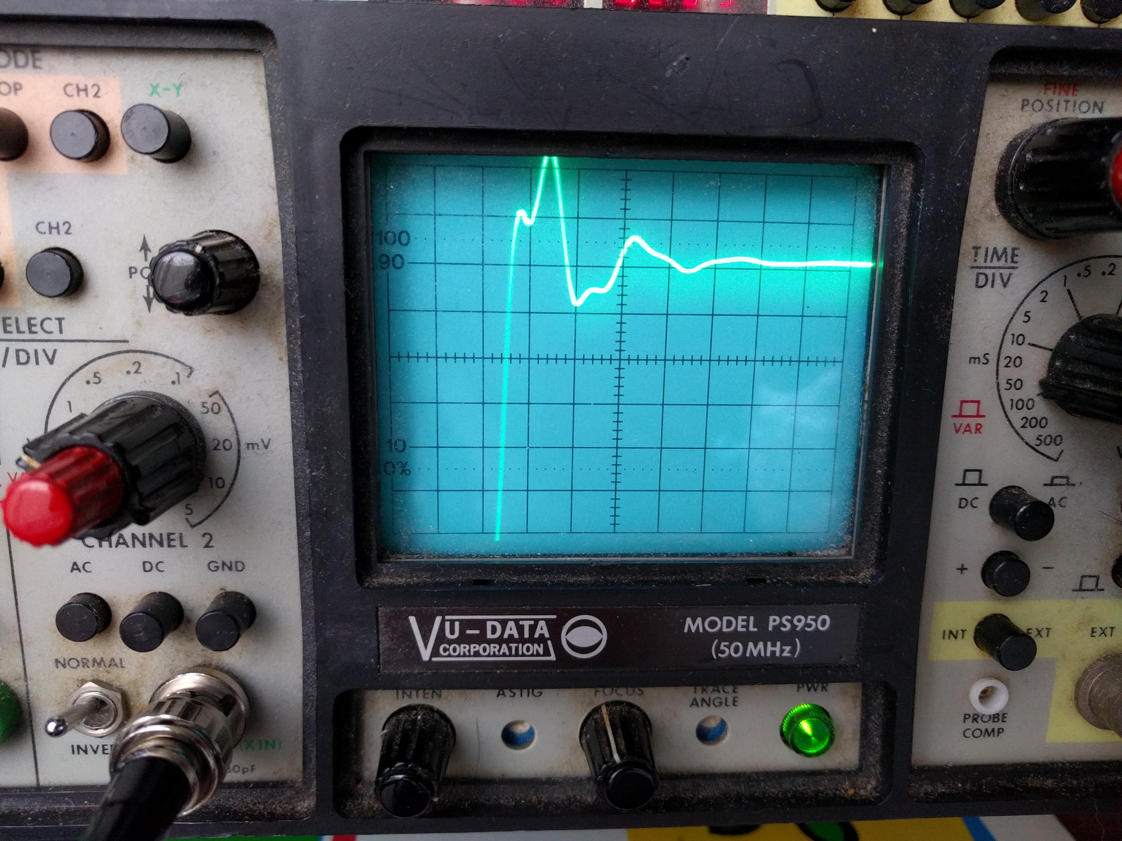

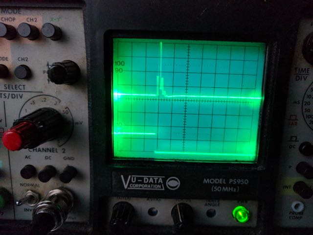

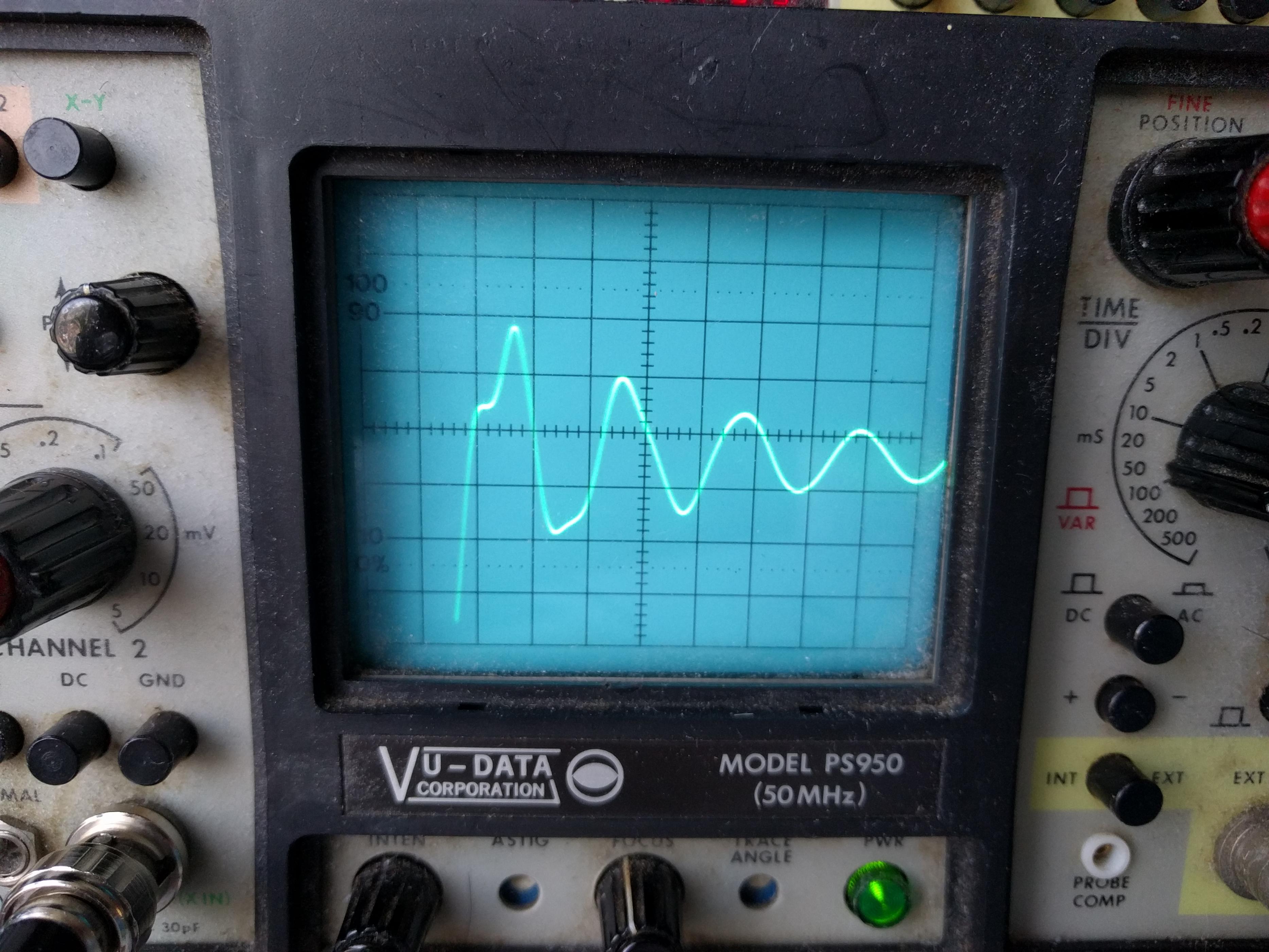

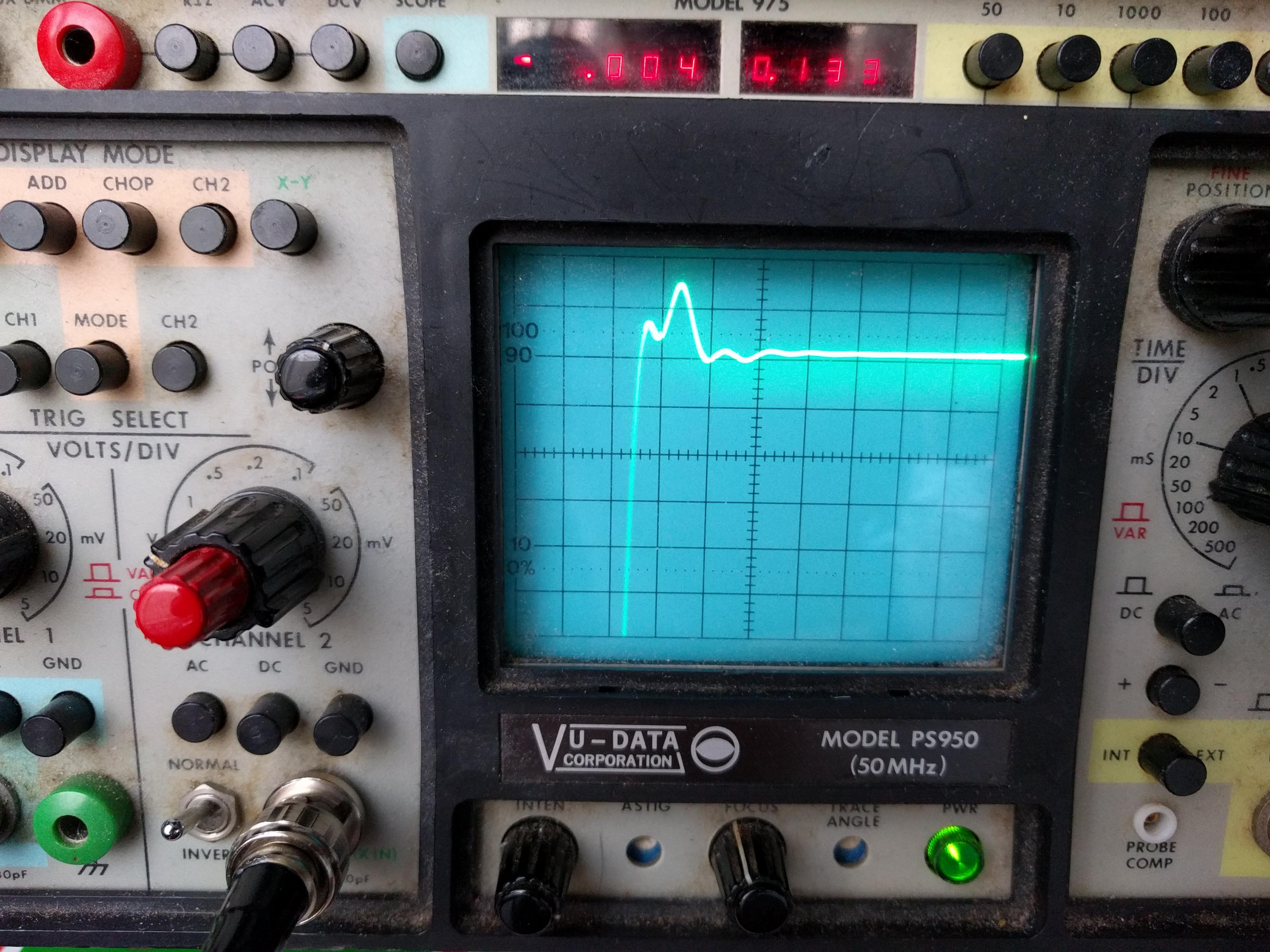

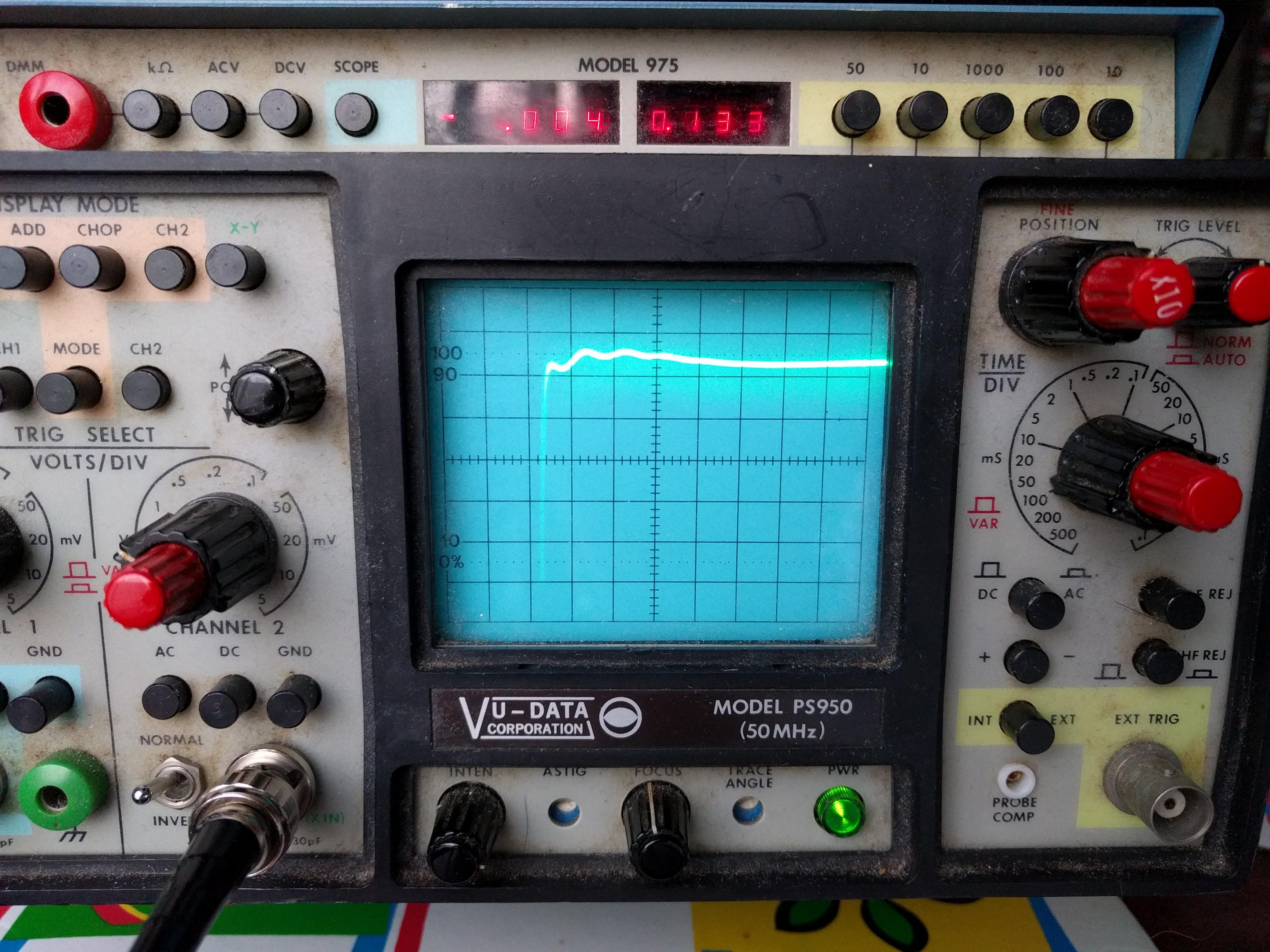

Thanks Mark, did you suggested as seen in the following displays. One peculiar niggle is from the 2nd photo the leading rising edge is jagged and seems to get worse as damping is increased, see 3rd photo. Is this normal bearing in mind I'm using a R-Core transformer.
No damping
Damping
More damping
Joined 2011
I've never seen that kind of jaggy edge on any of the Quasimodos I've built and tested, including solderless breadboard, SMD, and thru-hole versions. Not with any of the transformers I've measured.
I've also never seen that kind of jaggy edge on any of the Cheapomodos I've built and tested, including V1-V3, PCB, and stripboard.
I also don't remember ever seeing that kind of jaggy edge on any of the scope photos posted by other DIYA members, either here or in the Quasimodo thread.
Does the jaggy edge disappear when you're driving a fixed inductor instead of the secondary of an R-core transformer? I suspect it's just an artifact of unwanted extra inductance in the ground(s) of your experimental setup. You can move the grounds around, clip the scope ground clip to a different spot, rearrange the positions of the wires, etc., to see what changes and what does not change.
But the good news is, you've almost got the correct Rs dialled in anyway! Dial it down a little more until bump "B" disappears and becomes perfectly flat. Then dial it down a little more after that, very slooooowly, until bump "A" just barely disappears or nearly disappears. Remove the DC power supply from Cheapomodo, measure across Rs with your ohmmeter, done! Disregard, ignore, and pay no attention to the jaggies while you're doing this.

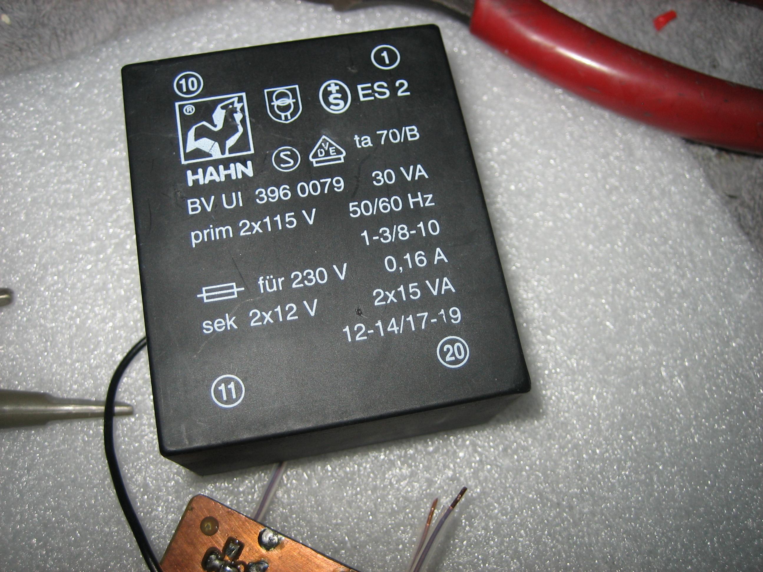

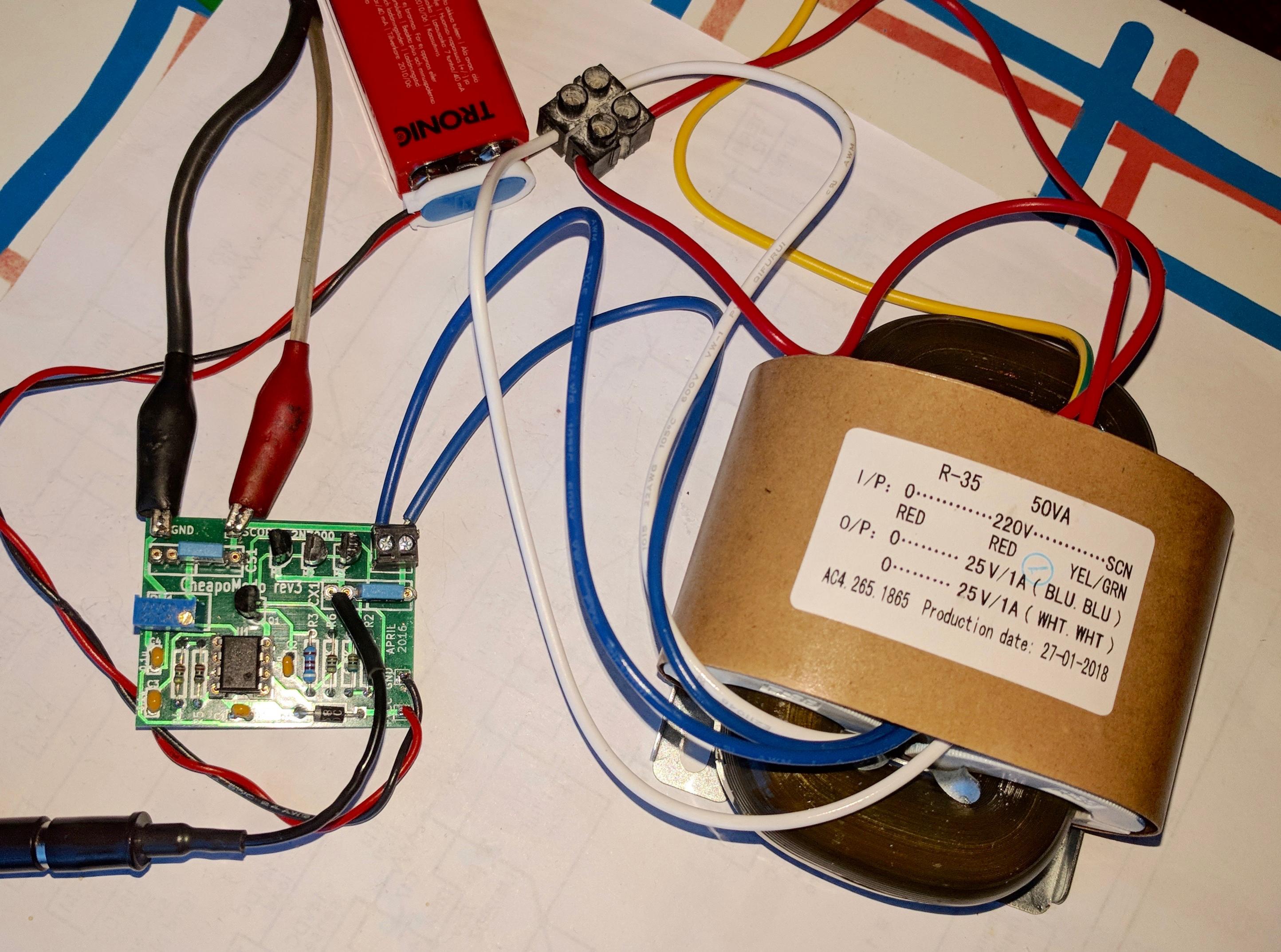

This is the R-Core transformer that I bought on Ebay from China. It has 2 secondaries and am testing one at a time.
Interestingly when I join the secondary in series, I get a waveform like yours, without any jaggies. As this method seem more reliable, could I use the derived resistance value for the two snubber circuits used in a centre tapped transformer configuration.

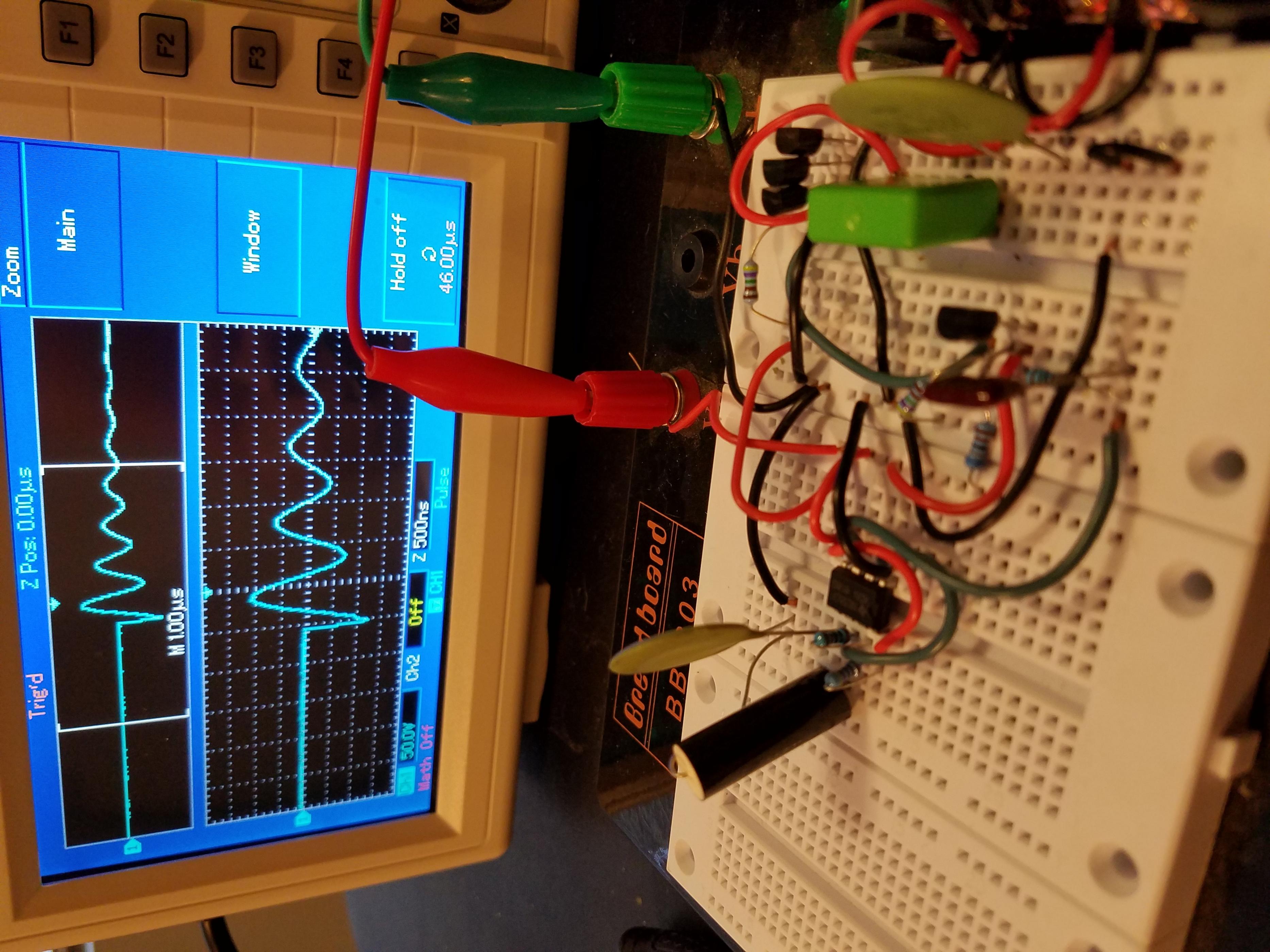

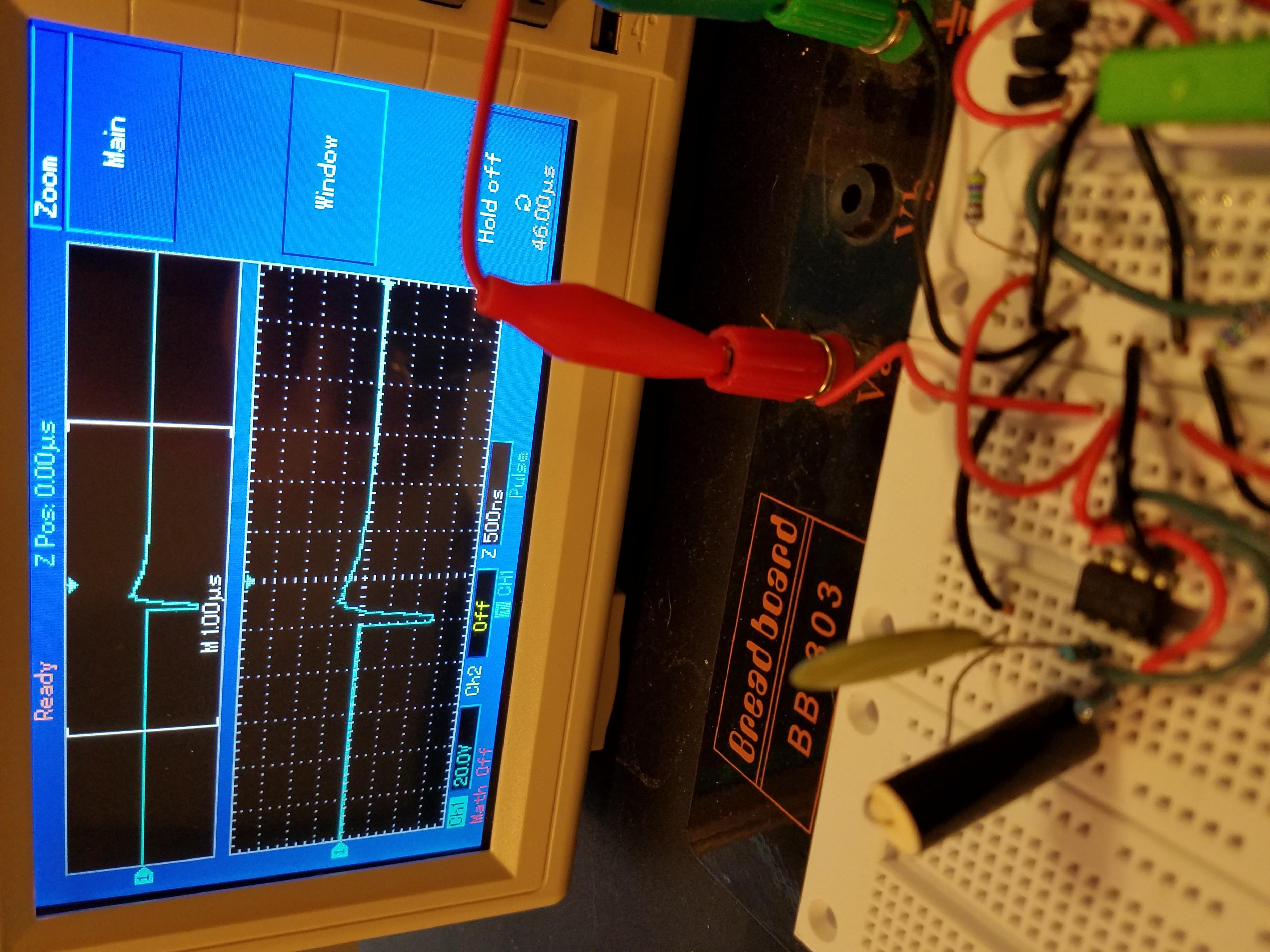

Just my experience added. Put together the tester circuit on solderless board just to see if I could make it work. It works very well. Will transfer to a soldered board soon. Cx=6800pf and Cs=.1uf. Under test is an Antek AS-1212, a 115/230 - 12-0-12 toroidal.
Great jig Mark.

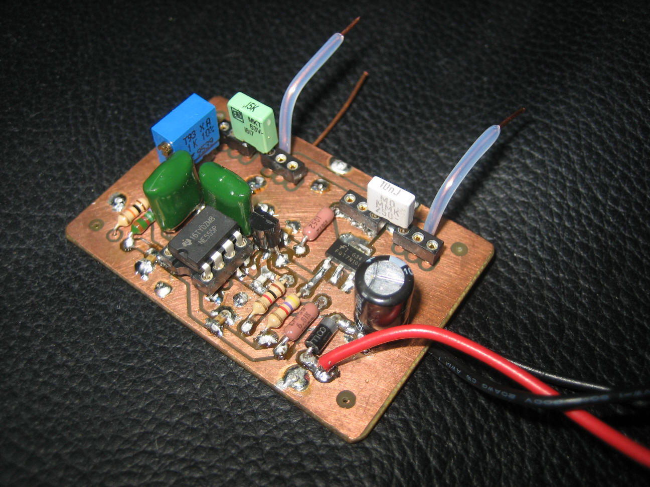

Hot off the press, not tested yet...
But this one was truly made from the parts I has at hand.
I ran out of 0.1uF leaded ceramic caps, substituted with SMD. had no leaded appropriate mosfets.. used an SOT-223 FQT7N10L. As to, R3-900 ohm was substituted with a 1K.
After all this, I made changes to the original design to accept the different parts, and printed it in my kitchen...:D
Will test it as soon as I have more time, hope it will work...
Very exciting indeed.

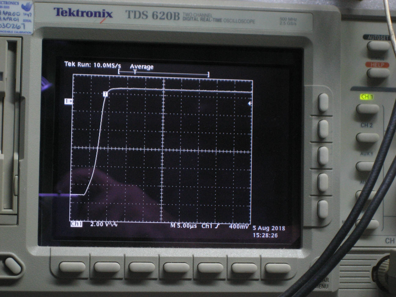

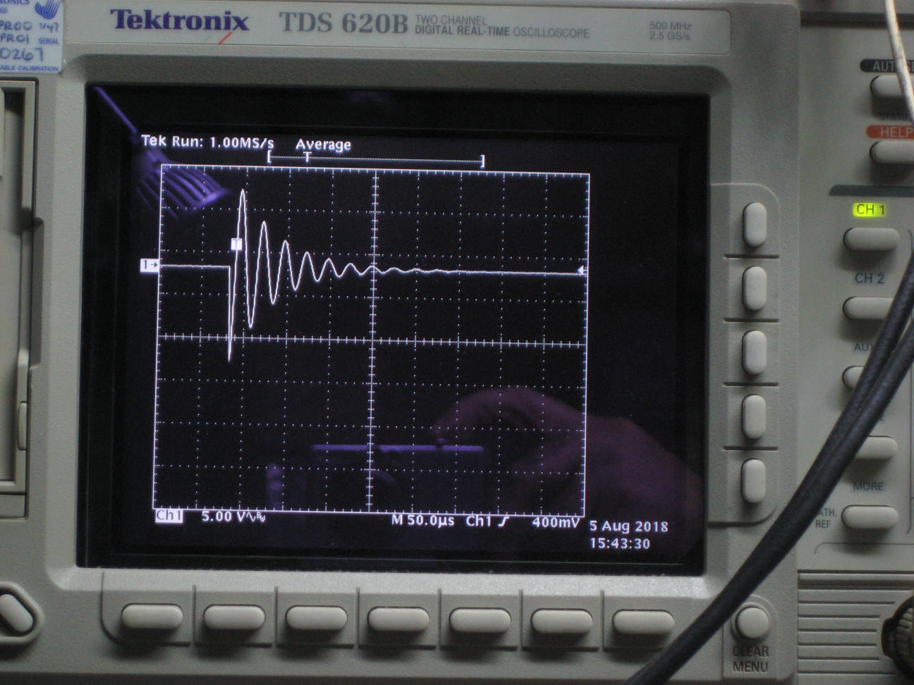

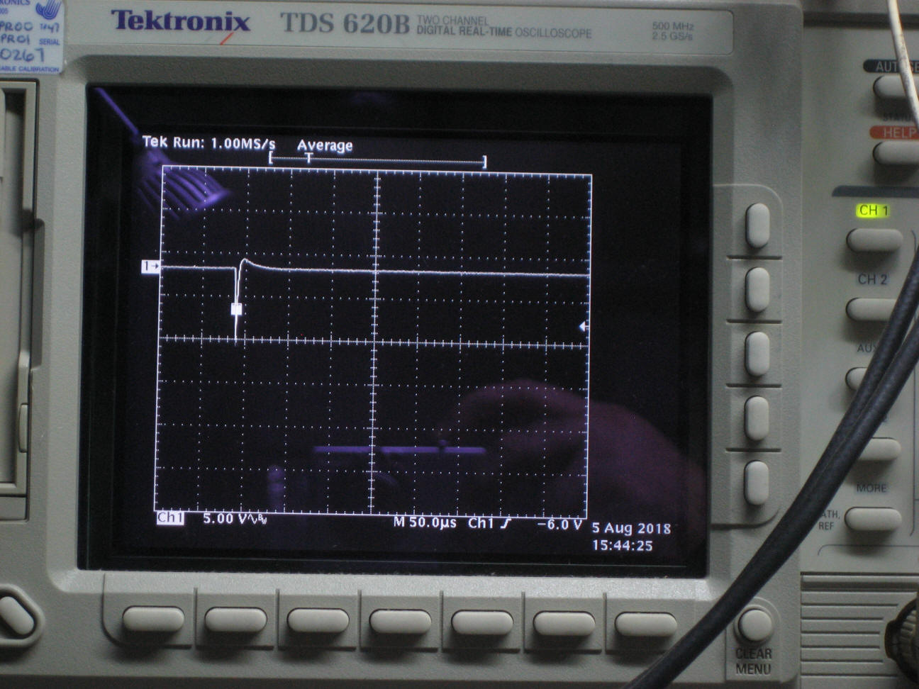

First, I would like to thank Mark for this wonderful and helpful instrument...
It was powered up today...and IT WORKS..!!
the pictures are:
The test subject is a 12V 30VA transformer.
Step response on R2, no load.
Transformer response, no dampening.
Transformer with the optimized snubber- 150 ohm resistor.
GREAT!!… Thank you very much..
Now I must test to hear if there is a difference in sound ???... will let you know.
