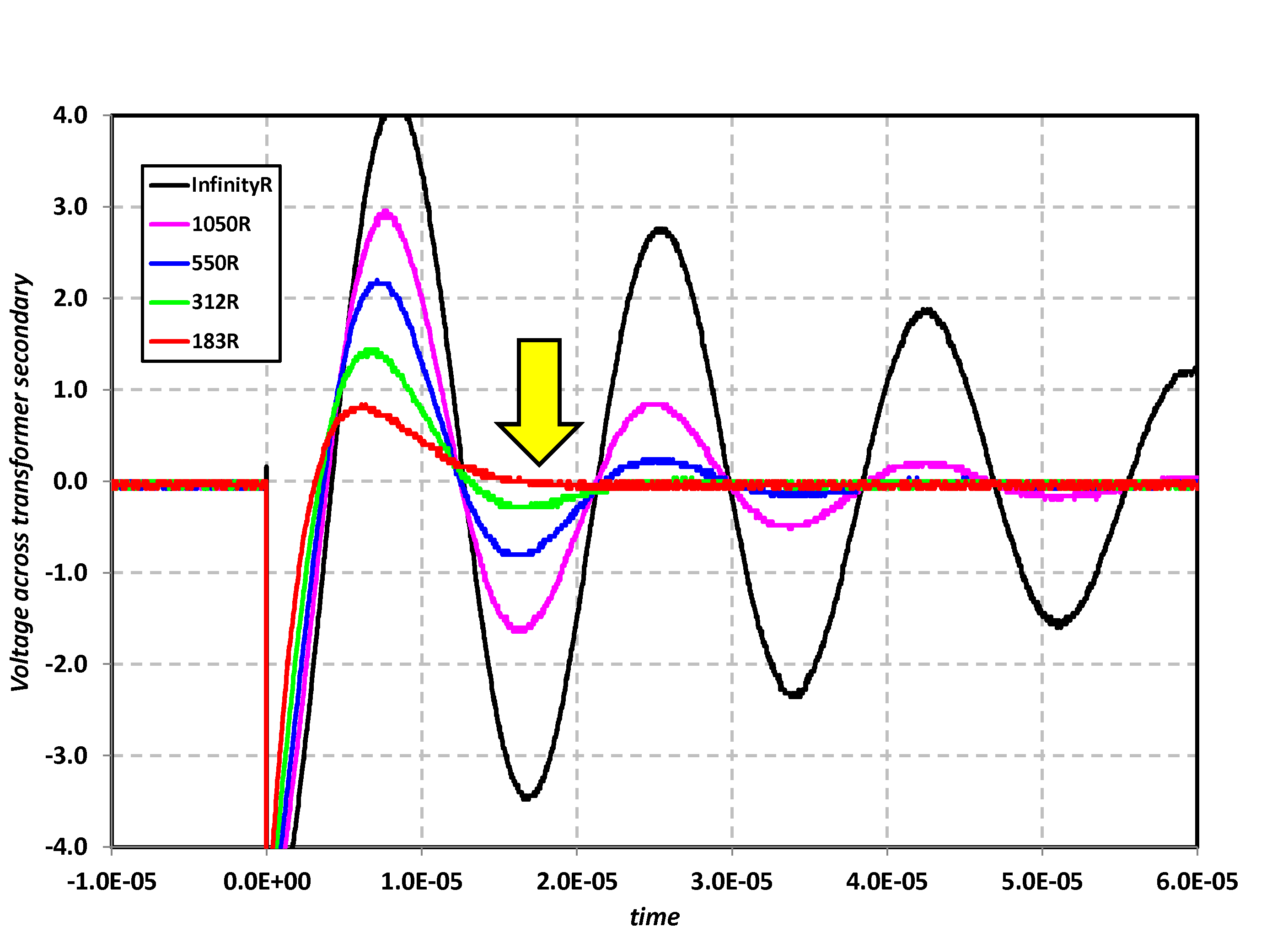

See whether you can successfully get down to zeta=1 (critical damping) when Cheapomodo is connected to an inductor instead of a transformer. If you don't happen to have a factory made inductor in your parts box, you can still do a quick test with an Improvised Component. Wind 100 turns of insulated wire around an AA battery and use a few wraps of sticky tape to hold the inductor together in one piece when you slide it off the battery. Connect the two ends of the inductor to Cheapomodo's terminal block in place of the transformer. Now see whether you can or can't get the scope waveform you want. It's a boost to your confidence when you see that SOMETHING has been successfully damped.
If your Cheapomodo is working fine and damping inductors well, your problem might be a poor match between the transformer and the trimmer potentiometer. You might need to get another trimmer pot whose total end-to-end resistance is 100 ohms or 50 ohms. This will let you carefully explore the low-resistance region more thoroughly than with a 1K trimmer pot. Maybe you simply had bad luck. Maybe your transformer needs 15 ohms for critical damping, but your 1K pot can only dial down to 25 ohms, not zero (!!?). That would be terrible bad luck but it is not impossible according to Murphy's Law.
When is overdamped

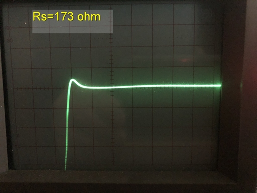

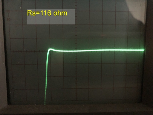

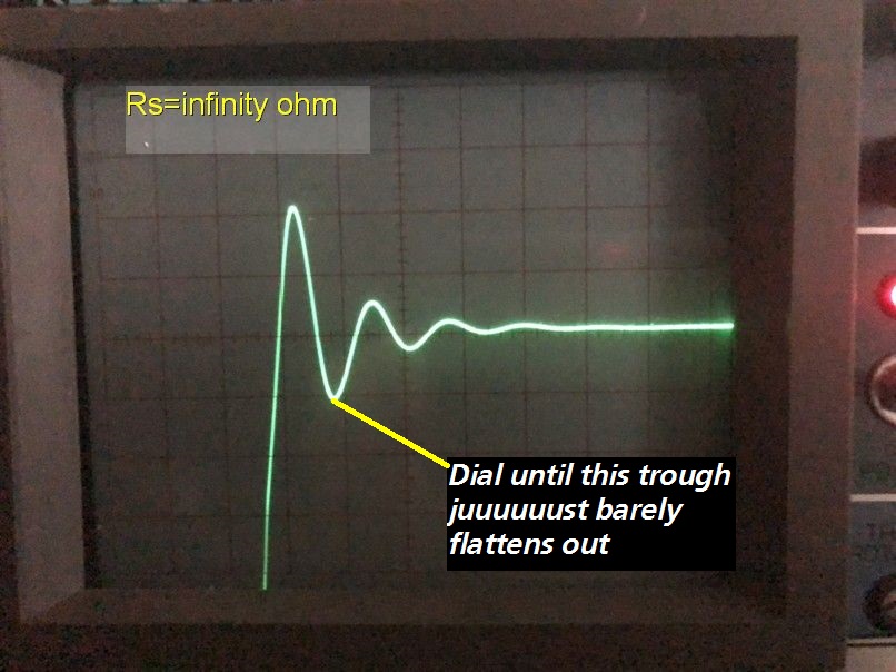

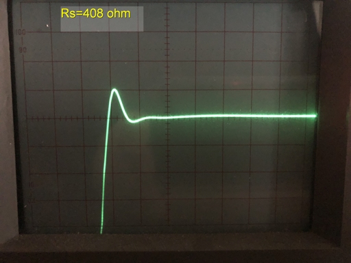

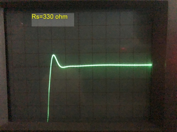

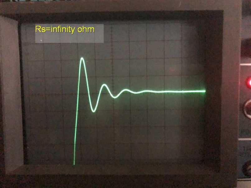

Hi Mark

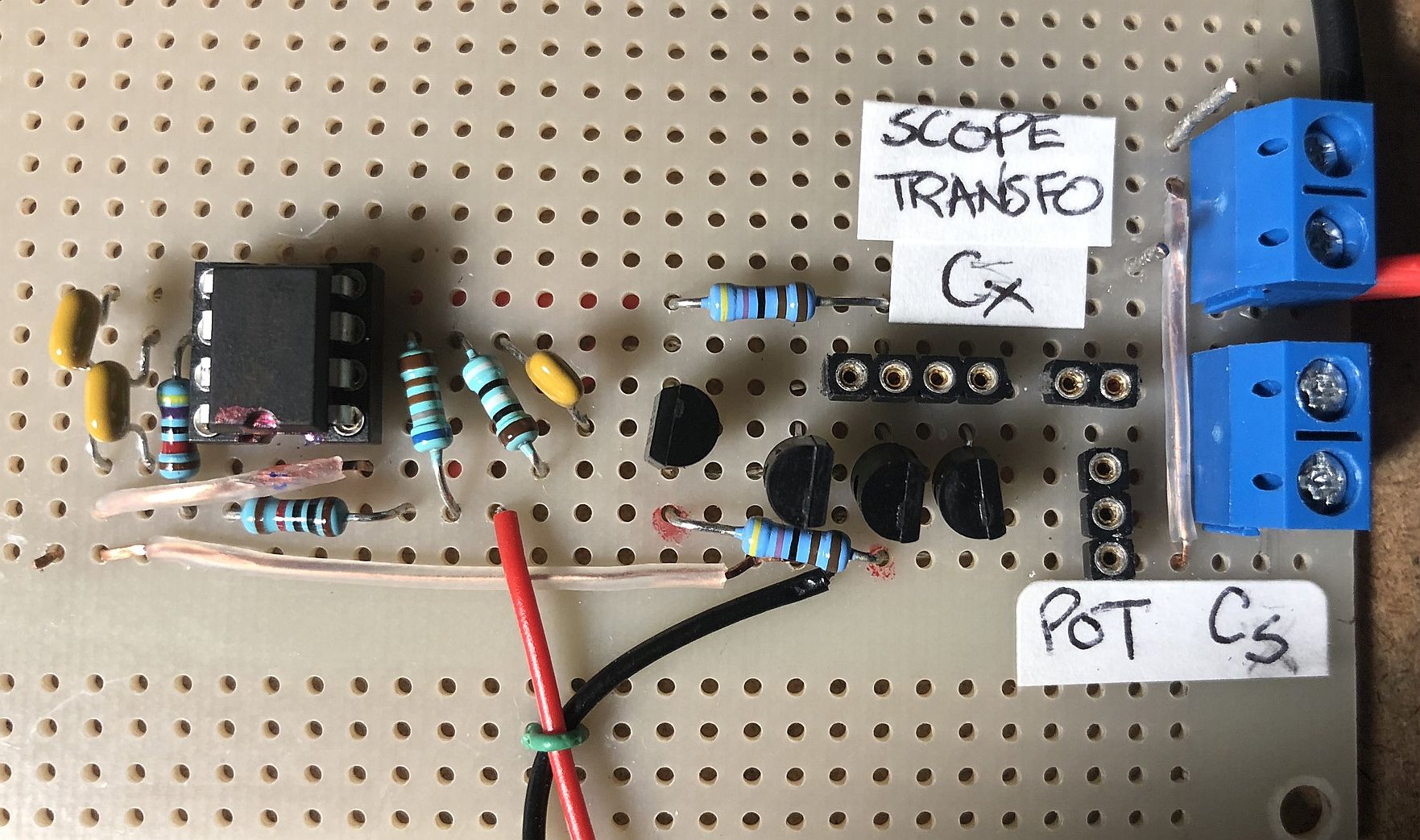

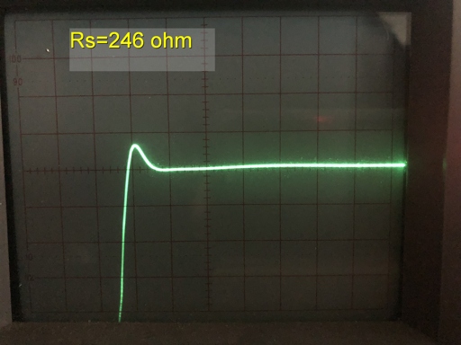

I put together my cheapomodo on a strip board. It's such a great jig. After some figuring out how to use a very old CRT scope, I got the following snubbed images.
For background, my tube preamp (Sonic Frontiers Line3), has 3 transfos: for L, R channels and control circuits.
Each channel transfo has 3 secondary windings, for +240V, -150V and 20V rails. I would think the transfor for each channel is about 60VA-70VA.
I'm using the standard values Cx=.01uF, Cs=.15uF.
My question is when is critically damped and when is overdamped. Seems I can turn the trim pot 50 ohm or more in any direction and the effect is quite small? I fear overdamping may make the SQ sterile. ;(
Denis
PS: the 2nd scope is Rs=713 ohm
Hi Mark

OK
That would put it between 330 and 246 ohm. Digikey comes up with 270 ohm metal film 5% 1/2W at good size and price.
Thanks much Mark.
Thanks much Mark.

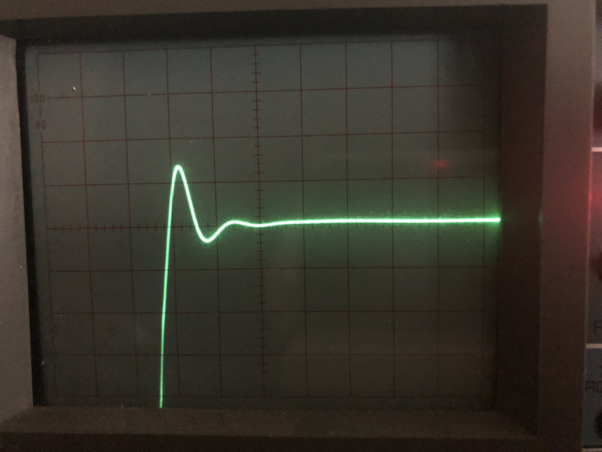

a) Why is it that we are after zeta=1 actually?
b) The graph still shows overshot, no?
Please feel free to adjust the potentiometer on your Cheapomodo, to get whatever waveform shape you like most. No doubt you studied differential equations, Laplace Transforms, and continuous-time control systems on your way to becoming Ing. Michael Gerstgrasser, so you don't need an introductory tutorial on damped oscillation in second order systems.
For those who are not degreed EE's, I recommend a target value of zeta=1.0 (so called "critical damping") because I feel it gives the greatest margin-of-safety against setup errors, measurement errors, and interpretation errors. I lump all of these together into a "beginner's mistakes" category, and I estimate that a beginner's total error can be as large as ±40%. In my opinion, zeta = 1 is the target centerline which gives the least dangerous worst-case, when a beginner accidentally builds (target_zeta ±40%). Zeta=1 also has the secondary benefit of being easy to estimate visually.
For those who ARE degreed EE's: you don't need any advice from me. Pick your own value of zeta based on your own judgement and create your own design. You will probably want to avoid the No-Math approach (since you are very good at math) and perform the calculations instead. In this case you use Cheapomodo simply as a device which measures inductance, extracting L from f_osc data. Figure 17 shows one possible procedure. Then calculate Rdamping from the textbook equation for a second order system
You can view the resulting waveform on your scope, by plugging a resistor whose value is the calculated Rdamping into Cheapomodo. This is a valuable double-check, especially if you are aiming for zeta > 1, because the assumption (Cs is approximately a short circuit) becomes less and less valid as you dial in more and more overdamping. Try it on your own Cheapomodo and observe what happens.
- Rdamping = (0.5 / DesiredZeta) * SQRT(L / Ctot)

The answer to your question "Why is it that we are after zeta=1 actually?" is
The answer to your question "The graph still shows overshot, no?" is: yes, there is overshoot, but there is no oscillatory ringing.
If you wish more people would post their before-and-after listening evaluations of 2C+1R transformer snubbers, that might turn out to be full of difficulty. How do you motivate or influence other people to do what you want them to do? At first sight it doesn't seem easy, but I wish you good success in the endeavor.
two assumptions: (i) that author is you; (ii) "Ing." means you have a degree in electrical engineering. Apparently my assumptions were not correct and I apologize for the error.

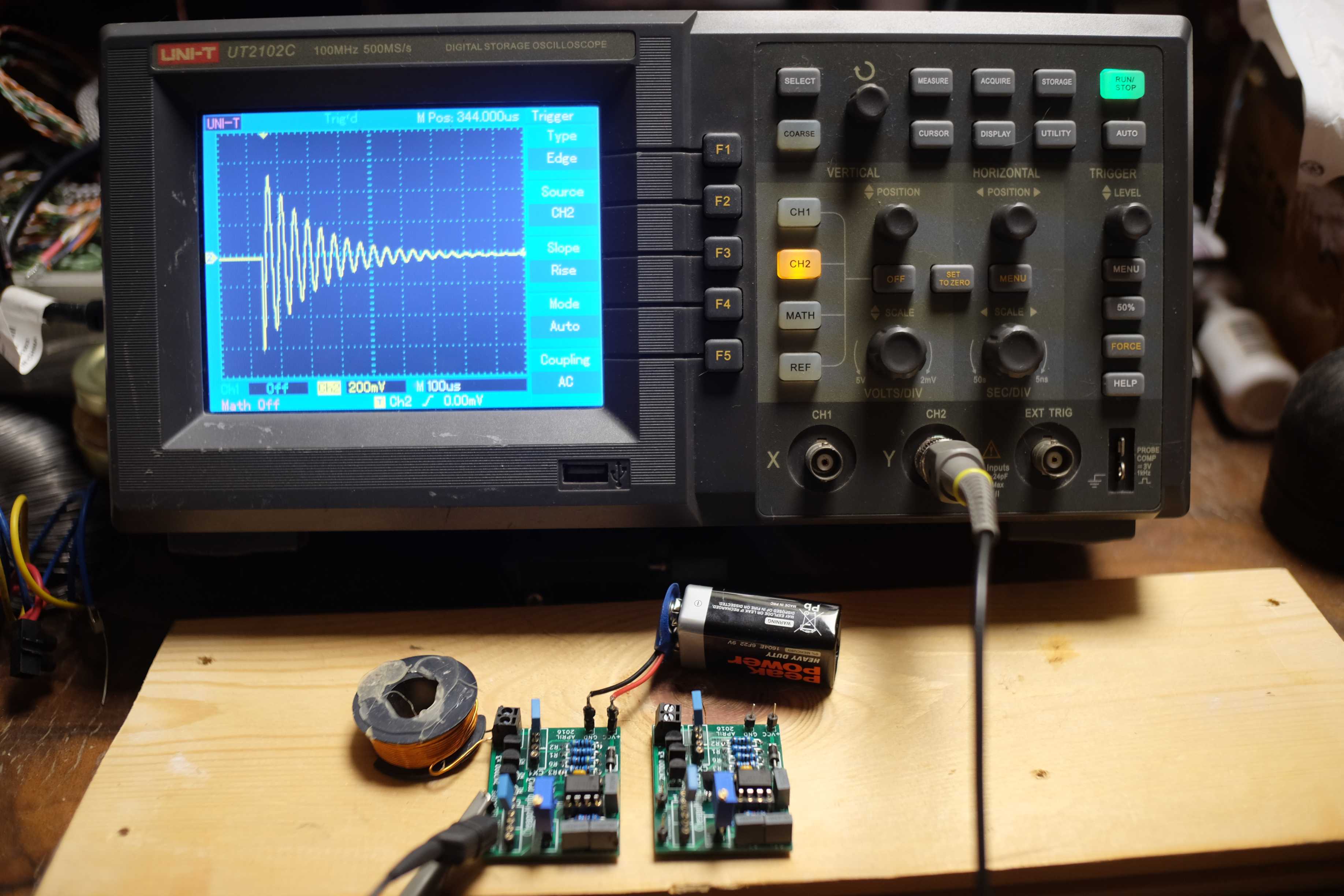

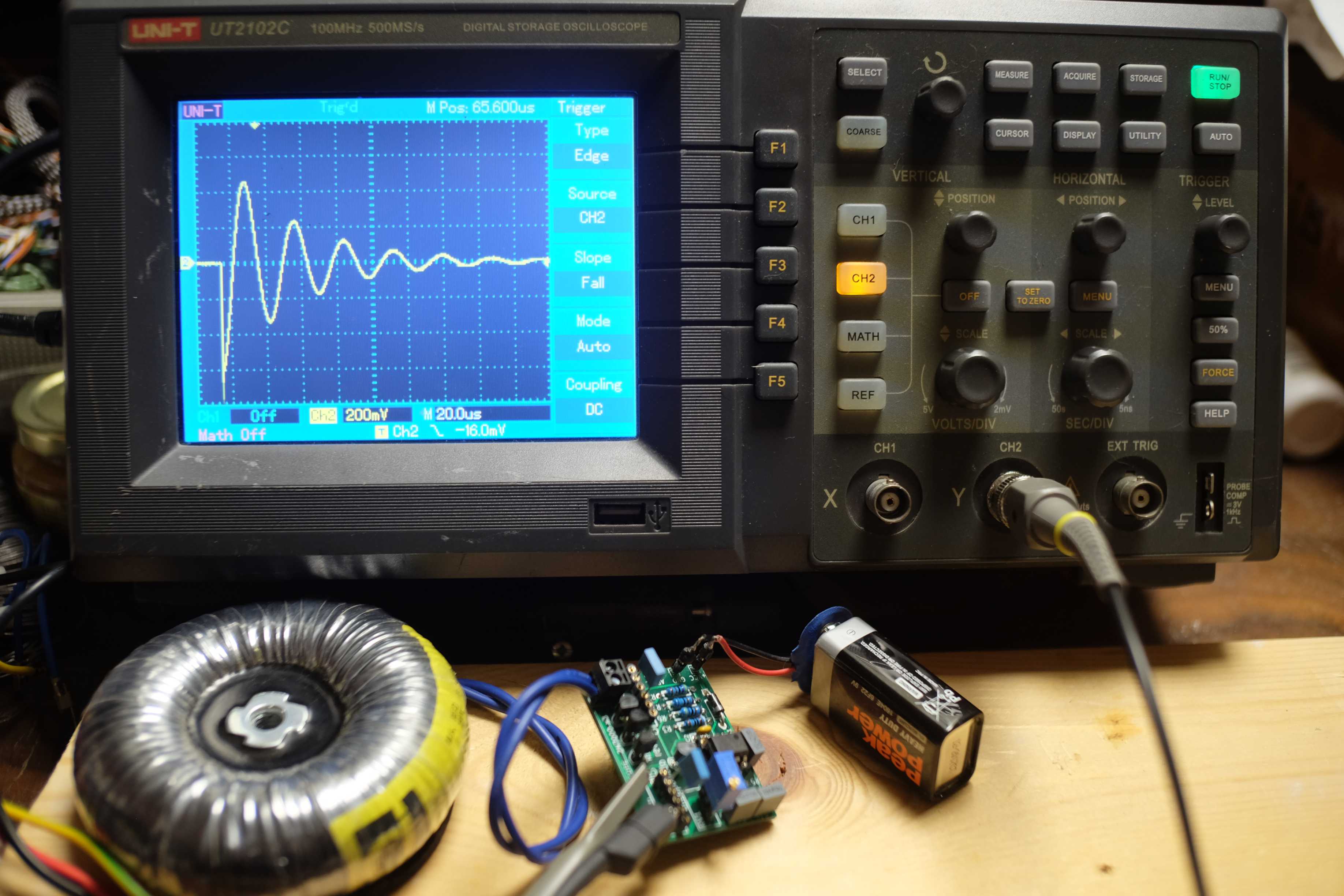

Hello, today my first try on recently completed 'cheapmodo' board, also first use of secondhand osciloscope so... you could figure...
I was in luck after some buttons play, I menage to display the transformer oscilation. See pic. below. The problem I have, is no matter how much I turn the trimmer bolt, there is no change on osciloscope display.
Maybe I miss something😕
Jordi.
Jordi.
idea 1. Temporarily disconnect the transformer and instead connect an inductor, any value > 50 microhenries. Can you "snub" its oscillations away and get zeta=1?
idea 2. Try a different 1K trimmer potentiometer. Yours might be faulty.
Concerning the trimmer, most likely not that, since I already have an spare module (I completed two modules) and no way, both behave the same.
I had already tried that -also to discard bad soldering-
Now I checked an inductor, he has oscilation (see attch) but no way, the 10 turn trimmer from both modules, I turned bolt to the both ends -No way, again not any change in osciloscope display !!
Clearly there is some kind of implementation error on both of your boards, since dozens of other DIYer's here on this thread have successfully built a working Cheapomodo, using the same schematic as you.
Which means you now must begin debugging and troubleshooting, to find out what is wrong with your board(s).
The obvious first thing to check, which I am sure has already occurred to you, and which you have doubtless already tried, is to be sure that all socketed parts are securely plugged into their sockets. Are all three leads of the trimpot securely plugged in? Are both leads of Cs=0.15uF securely plugged in? Are both leads of Cx=0.01uF securely plugged in? Does your DVM show good continuity between the rest of the circuit, and the leads of the socketed components?

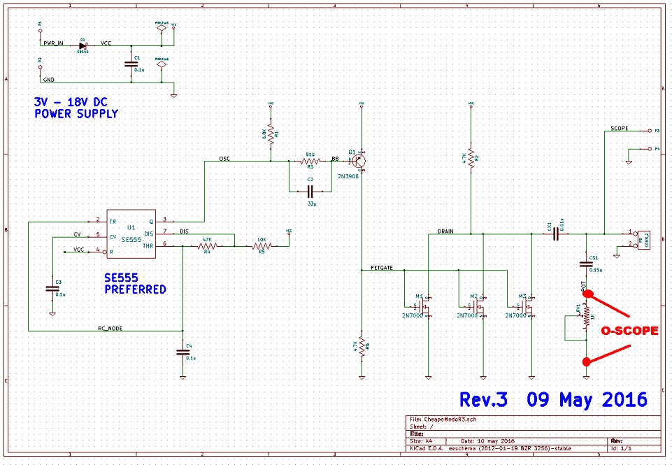

I am in need for a schemantic with voltages expected on the circuitery while powering it using 12v. battery.
