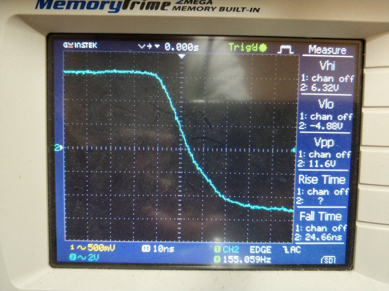

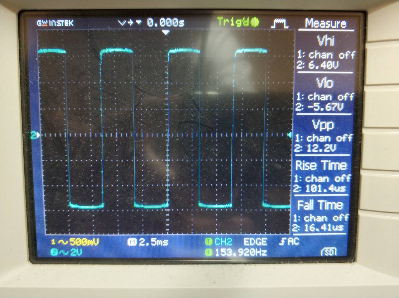

Hi Mark,
It took me 2 hours to build it. Tried it on my new trafo. At first sight, it seems working. The fall time is around 25ns. I'm not sure if this is fast enough since I use HFA08TB60 (18ns Trr) for my amplifier. Unfortunately, I don't have any 0.15uf cap at hand, so I pick up a 0.22uf C0G/NP0 for the Cs. After some tuning, I got Rs=36.5ohm on one of the secondary. Here is my question. Is it mandatory to short other secondaries while doing the measurement? This transformer has 6 secondaries!
Yes you do need to short all other windings when measuring Secondary #3. That means short all primary windings and all other secondary windings. Just like the Quasimodo design note says.

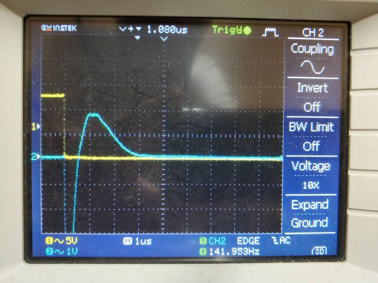

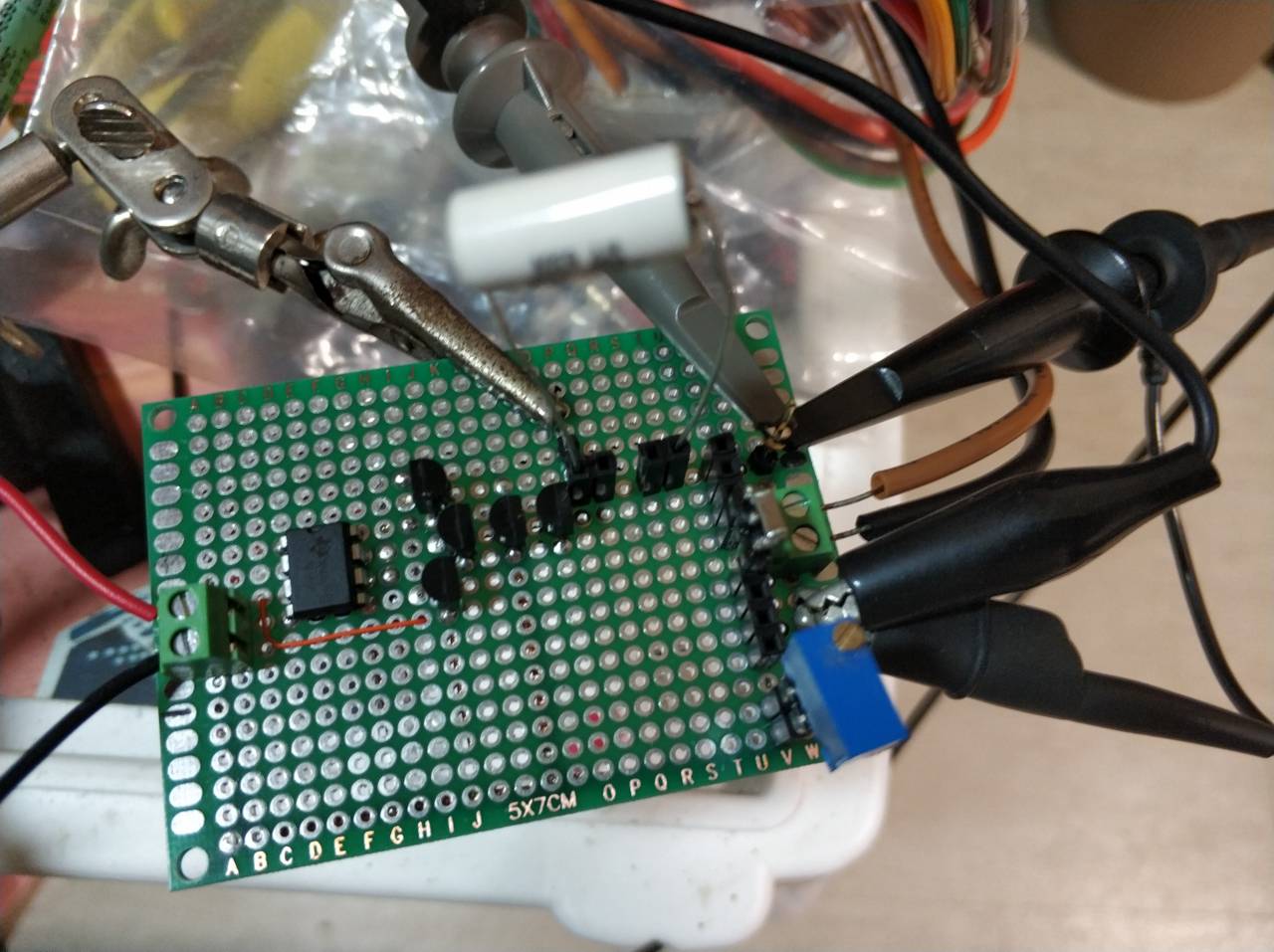

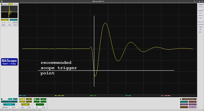

Success?
Thanks Mark for your generous work on Quasi/Cheap-modo.
This project will not only be useful to me for it's intended purpose, but also as a great learning tool - this being the first time I've breadboarded a circuit or used a oscilloscope. Funny, but after buying the parts, board, scope, and transformer Cheapmodo turned out to be not so cheapo! 😀
My breadboard interpretation of the Cheapomodo circuit is very literal, if you see what I mean.

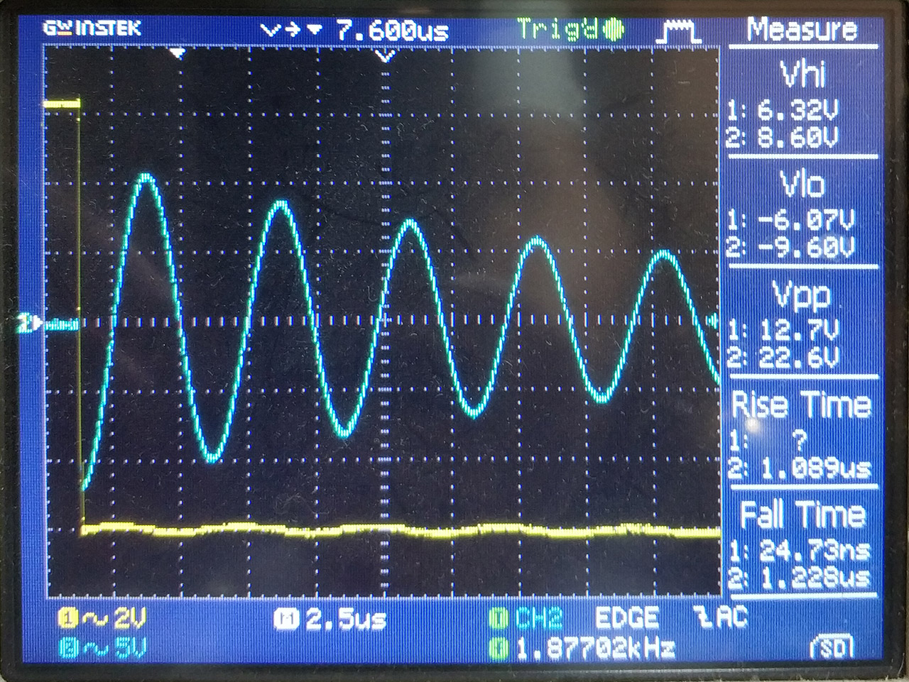

It didn't take too much button-mashing of the software to display the ringing on the scope, albeit with what appeared to be some odd clipping of the signal.
I was however still able to reach of critical damping.
Altering the scopes software parameters I still could not get a clean wave pattern without the clipping. Re-reading the Quasimodo Jig PDF showed that I was connecting the transformer incorrectly. It is centre-tapped, but I had not shorted one of the secondary wires to the CT wire, instead leaving it dangling free.
Now I was able to get unclipped peaks. The signal does jiggle around a lot more than before though, but I obviously need more time learning how to operate my scope.
Critical damping at 26ohm. Now I'm really looking forward to using 'modo on future projects!

Congratulations, @FullyArticulated ! A very clean build and a nice set of waveforms including excellent judgment of what critical damping should look like. I don't quite know how to read the settings on that scope display; I hope you're triggering on the falling edge, and setting the trigger voltage level quite far down on the initial impulse. Some scopes will display a helpful horizontal line when you're fiddling around with the trigger level.

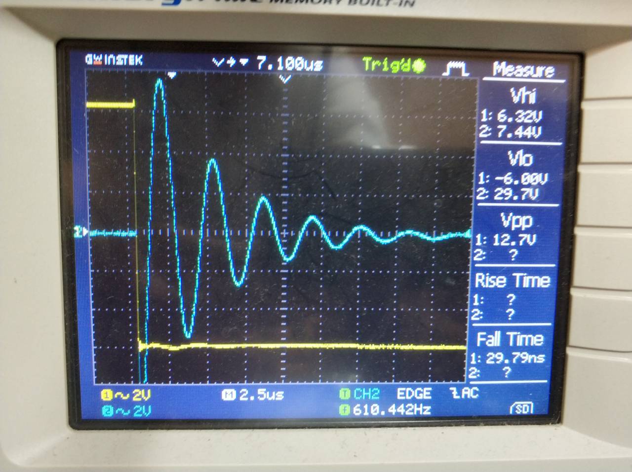

Thanks for your kind words Mark.
I think understanding how to correctly set the trigger is my main hurdle to getting consistent and reliable results. When I had the transformer hooked up wrongly I was actually able to trigger on the fall, but it proved impossible once it was connected properly.
However, this morning I connected a second channel to pin 3 on the SE555 and was successfully able to set the trigger on the fall of the square wave being produced. That's correct isn't it? I can't remember where I read about that.
Anyway, here is how it looked:
In the top left corner is the triggering settings. I think the line your alluding to is there, which I've set to -2V.
Pin3 doesn't fall below 0V so I doubt that you're triggering when Pin3 crosses below -2V. (Unless you're AC coupling the trigger which would be rather unconventional)
It's no doubt just conventional operator error. With a second attempt I wasn't able to duplicate that value.
If I'm reading the software correctly I have an 8V square wave which is being triggered at 4V. As you say, it doesn't fall below 0.
