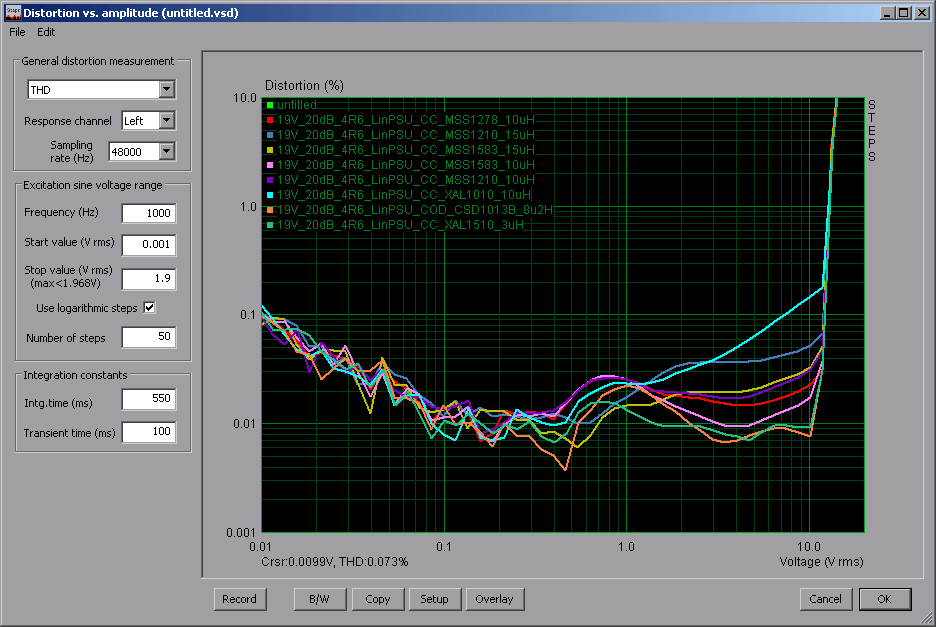

Another thing i'm interested in is the increased THD at around 1Vrms.
Setup:
PVCC: 19V
Gain: 20dB
Load: 4R6 resistive
Stock board, only changed inductors.

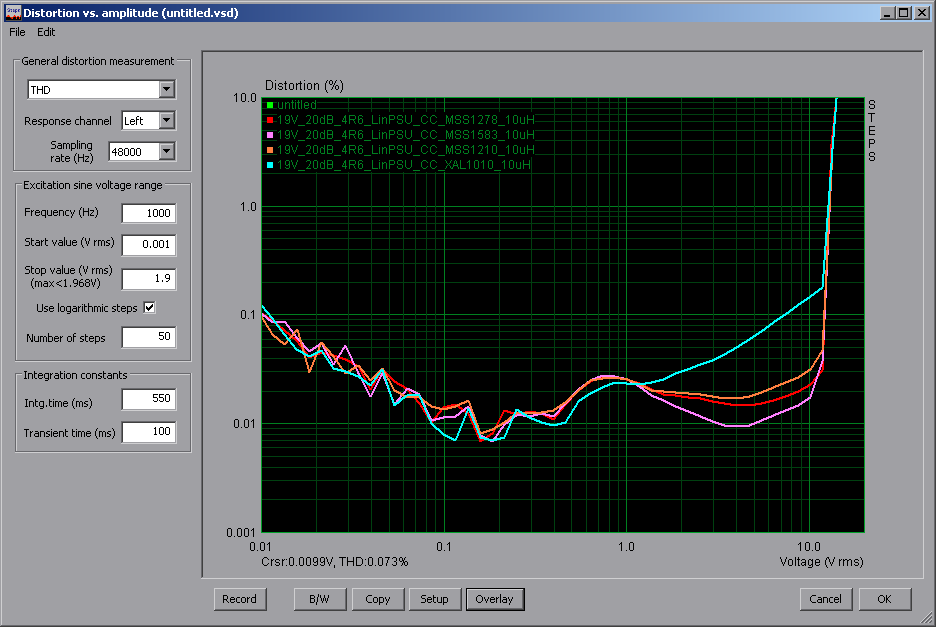

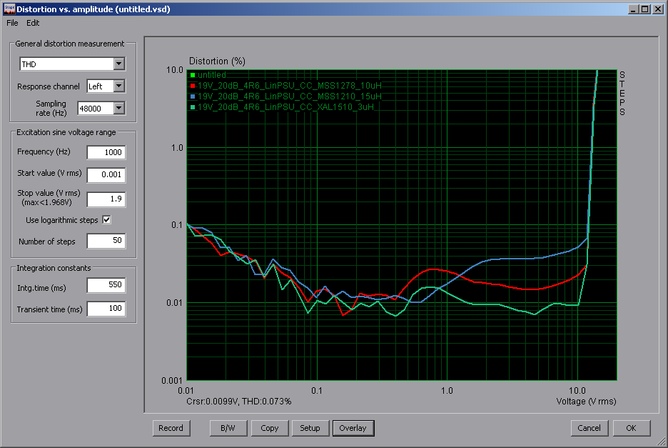

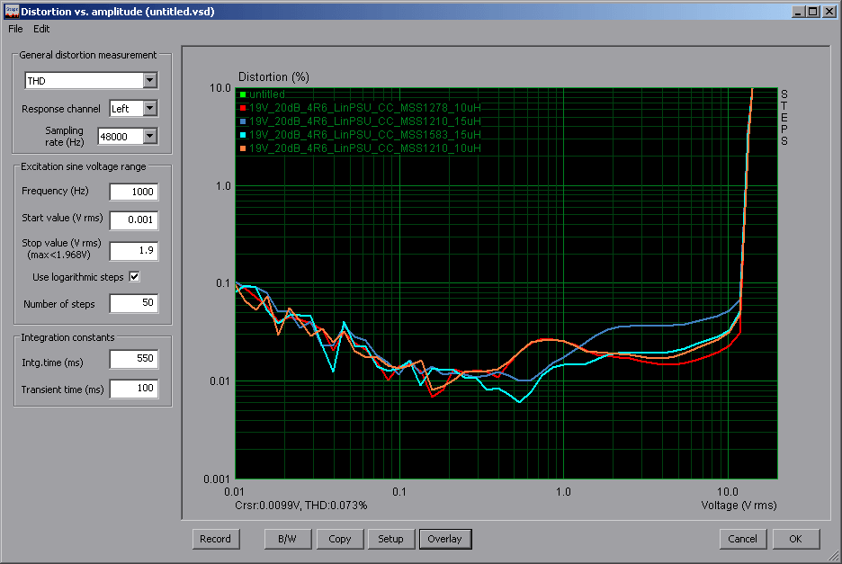

For this i tested several different inductors:
The influence of inductance is shown here, 10uH vs 15uH. The "bubble" is flattened and shifted to higher levels:

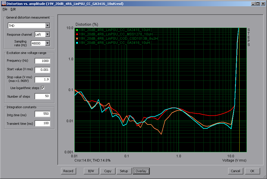

Different geometries/material at the same inductance:
Lower inductance will shift the "bubble" a bit to the lower end:
Surprisingly the small Codaca CSD1013B dual inductor performed really well, even compared to its more expensive competitor from Coilcraft, the GA3416.
Compared with fig.8 of the TPA3118 data sheet (yes it's BTL), the cheap clone is close to EVM performance with the MSS1278-10uH yet. But of course, comparing PBTL with BTL at the different PVCC/Gain settings isn't accurate.
If now we can get rid of the bubble please.
Setup:
PVCC: 19V
Gain: 20dB
Load: 4R6 resistive
Being close with pbtl and with mss-inductor also to btl 3251evm with same inductors already is very good. Board is a little small to easily implement a compact, I know you like them, bootstrap snubber/ prefilter snubber 🙂
Main ceramics in outputfilter probably cause some distortion, because also TI tells us. And TI doesn't use single ended input testing/measuring.
The high esr inputcaps they use might help grounded negative (in single ended) input too ???
Yes, changing fSW is also pita. 😀
I tried better/different ceramics in the output, can't measure any advantage out of it.
At higher levels, inductor saturation dominates while at lower levels inductance and geometrical construction seem to set the rules.

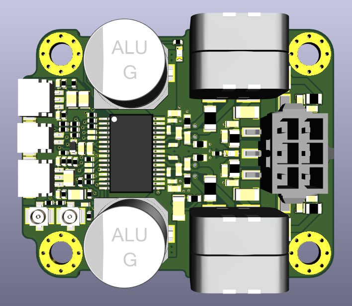

Anyone wants to join in?
Mainly 0402 components.
Selectable Gain (20-36dB) 0R-Jumpers
Selectable fSW 400-1200kHz 0R-Jumpers
BTL/PBTL 0R Jumpers
2u2F Softterm input coupling caps (low noise, automotive)
PBTL with parallel inductors (2x2) 0R Jumpers
Diff/SE Inputs
Anti-Pop-Circuit
BS-Snubbers
EMI-Snubbers
AGND island for AFE
AVCC RC-Filter
LC-Filter or Ferrite+C filter or filterless
Master/Slave/Daisychain synchronisation
44x35mm (Length x Wide)
High-Current connectors for PVCC and outputs 2x3 Snap-in
4x M3 (3.2mm) mounting holes
Mute/Shutdown input
opt. LED for power/fault
opt. hickup-mode
No polarity protection

you earlier said this board will be produced by a manufacturer, not soldered by hand. Are you looking for contributors for the prototypes ?
maybe...Anyone wants to join in?

At first i will solder some up by hand for testing, so if anyone is interested in a bare board (or two) let me know. (If just getting five or so boards, reordering a small batch is not than environment friendly.. )

The layout is much tighter than the Volt+.

PM sent.5€/each (bare unpopulated pcb) with unregistered shipping worldwide.

One more thing..how many layers on PCB for cheap boards and for your design ?
Is it possible that instead of looking for one mistake in the cheap boards you should look at multiple smaller problems that together add up ? Replace all parts at once and test again with everything changed instead of testing one by one. Synergy .
But yeah 1Oz not acceptable
Class D amp is by definition a mixed signals PCB. It is bad practice in mixed signals to use a 2 layer PCB , 4 layers thats the standard. Thats what Volt+ is using.
