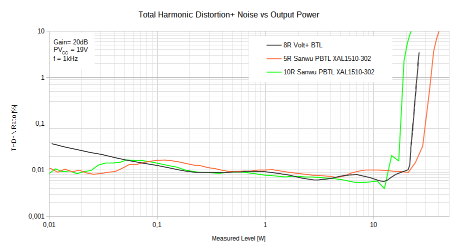

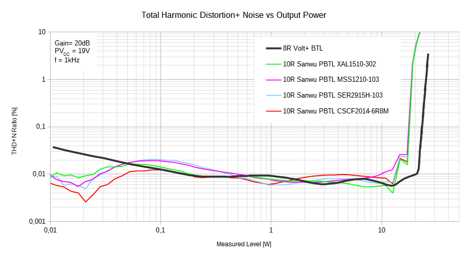

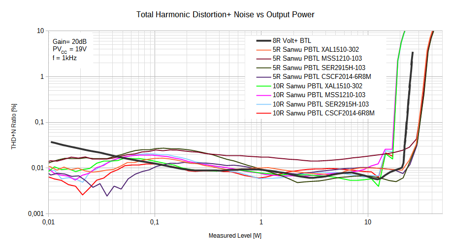

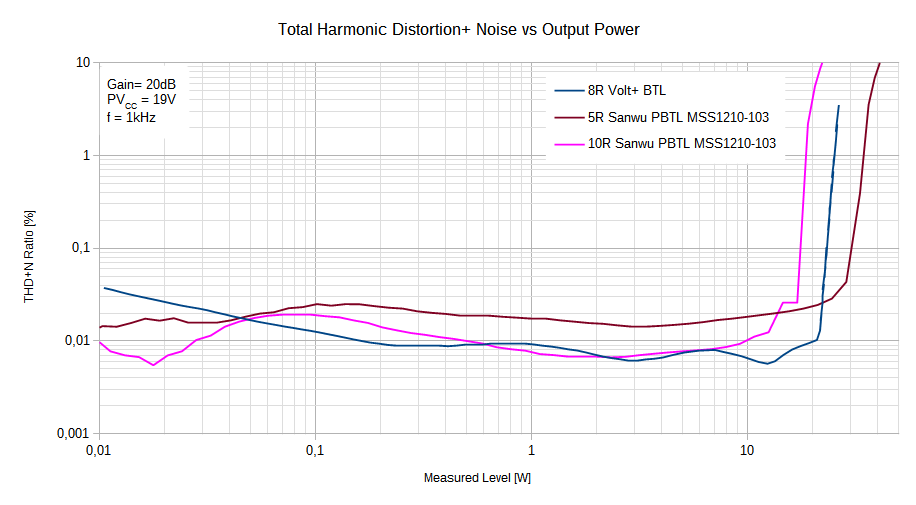

And the winner is... Codaca CSCF2014-6R8M on a stock Sanwu Clone PBTL TPA3118.
PVCC: 19V
Gain: 20dB
Load: 5R/10R
Reference: Volt+ at 8R load, 20dB Gain and PVCC = 19V+10%.
Volt+ Data is extracted from latest 8R measurements, posted in the vendor thread.
I'll make long story short, toked some hours to measure/compile the data:
All together:

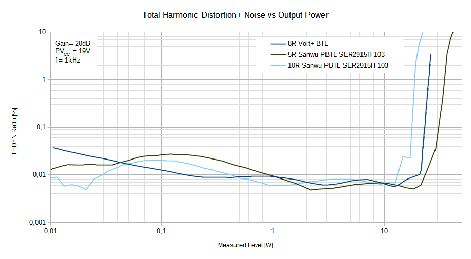

The MSS1210-103 (10uH):
The XAL1510-302 (3uH):
The SER2915H-103 (10uH):

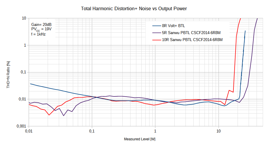

The Codaca CSCF2014-6R8M (6u8H):
XAL1510-302 and CSCF2014-6R8M are pretty close but XAL1510 fails due to high idle-loss.

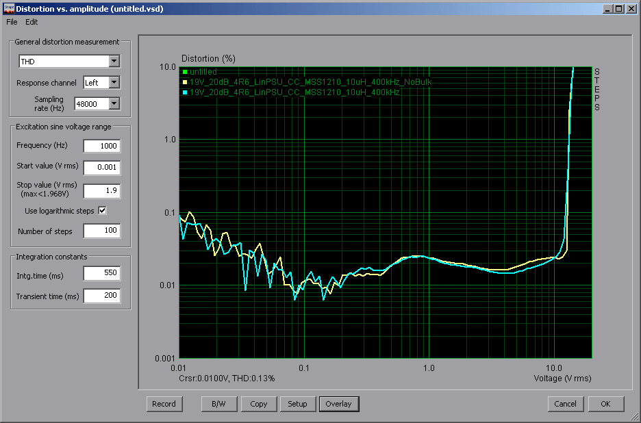

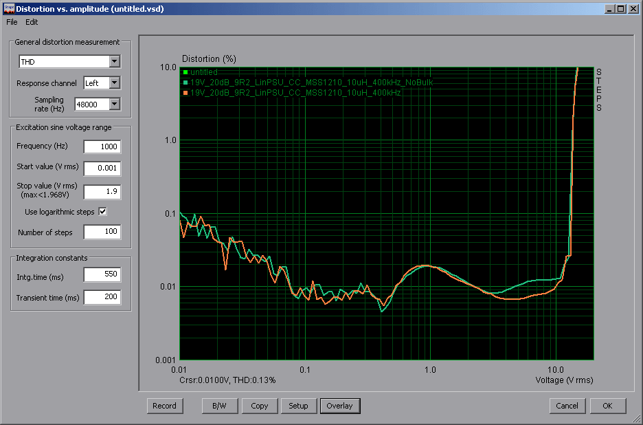

To make this post complete, the influence of bulk decoupling once again.
NoBulk: 1uF MLCC per side
Bulk: 2x330uF Elyt + 2x100nF MLCC per side.
5R load:
10R load:

A few questions to clarify the data
1. PSU used for your testing ? I assume its a SMPS like in our testing.
2. You are comparing BTL and PBTL boards..how is that ?
3. Even with the 2 points above (slightly unfair in my biased opinion)....is it fair to say that from 0.01W to 22w Volt+ is still the winner ?
