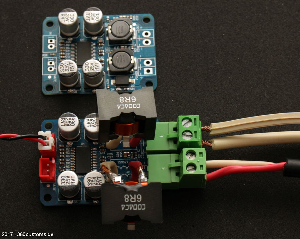

can you share a pic of the CSCF2014-6R8M tacked on sanwu pbtl clone?
i dont care if its ugly. just curious.

The (ugly) money shot.

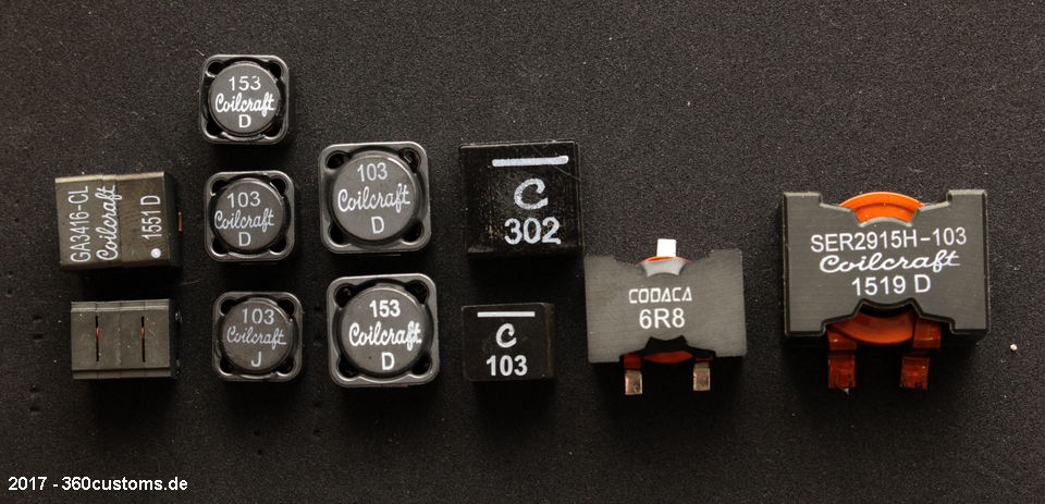

All inductors abused in this test:
"Bad news":
I sampled a variety of inductors from Codaca directly. (Sample+Shipping Cost)
The minimum order quantity is 200pcs. each value/model.
"Good news":
The "CSCF2014-6R8M" can be substituted by Wurth "7443630700". Same geometry, same core, ~same specs.

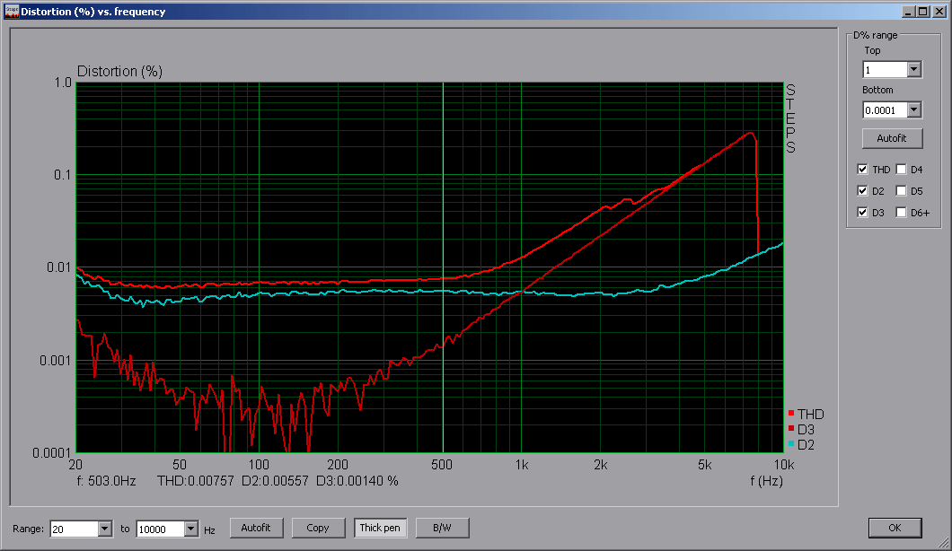

nice work and interesting results. They confirms the preponderant role of the inductors on THD.
Though, 1kHz is just before the raise of THD on most boards.
If you have it, could you share the THD+N per frequency graph @1W with the big winning inductor ?
Worse than that, you just need tpa3118 chip to have THD rising with frequency, no LC filter needed.
Ok dumb question time, what is the name of those red connectors? I could really use them.The (ugly) money shot.
Sent from my Nexus 5X using Tapatalk
that is the mute pull up

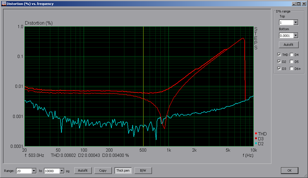

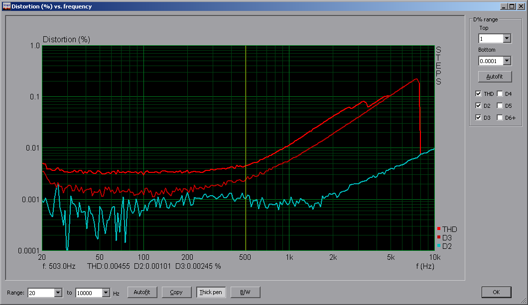

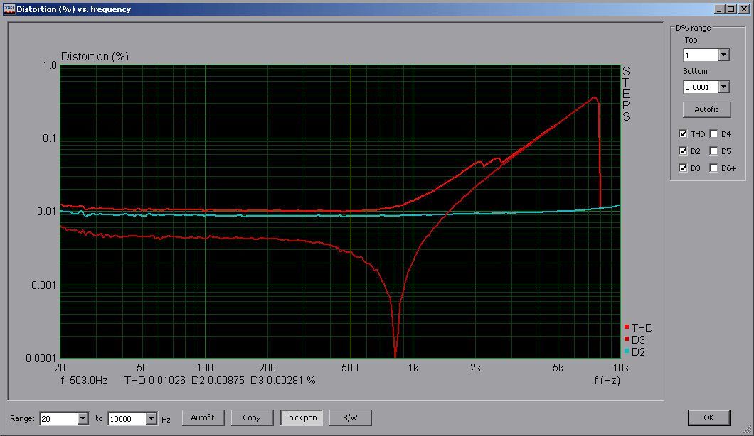

5R at 19V:
5R at 24V:
10R at 19V:
10R at 24V:
For 5R, the sweet spot is somewhere between 19V and 24V with tendencies to 24V - for a 10R load, it seems to be other way around.
