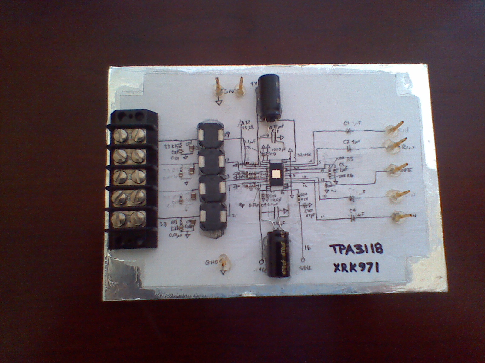

Ok, so I took all your suggestions and agree that this is crazy but I am doing it anyway. I laid out the smd components and glued them in place with acrylic clearcoat (smd) and hot melt for larger thru hole stuff and terminals. There is a layer of foil underneath paper for ground plane. The whole thing is on a 4 x 6 inch foam core board. Note the dead bug upside down TPA3118 chip. This was actually pretty fun to do. The hard part of soldering is next. Slow and easy... :)

My magnifying goggles came today - wow what a difference they make. I can actually see the text on the resistors (0603 size) which are the size of a flea. The binocular goggles have a 3x flip down lens on top of the 1.5 x main lens and a 9x swing out loupe all with LED illumination. Very handy. As soon as I have some time I will start the manual wire bonding with a soldering iron and flux core solder. I am told liquid flux in a hypo syringe is key for this sort of stuff but that would results another order.
It will be easier to solder the chip on the adaptor then solder the rest of the part around it. Soldering wires directly on those 0.5mm pitch pins is not gonna be easy, even if you have the proper PCB for it without the right tools and experiences/skills can be a challenge.
