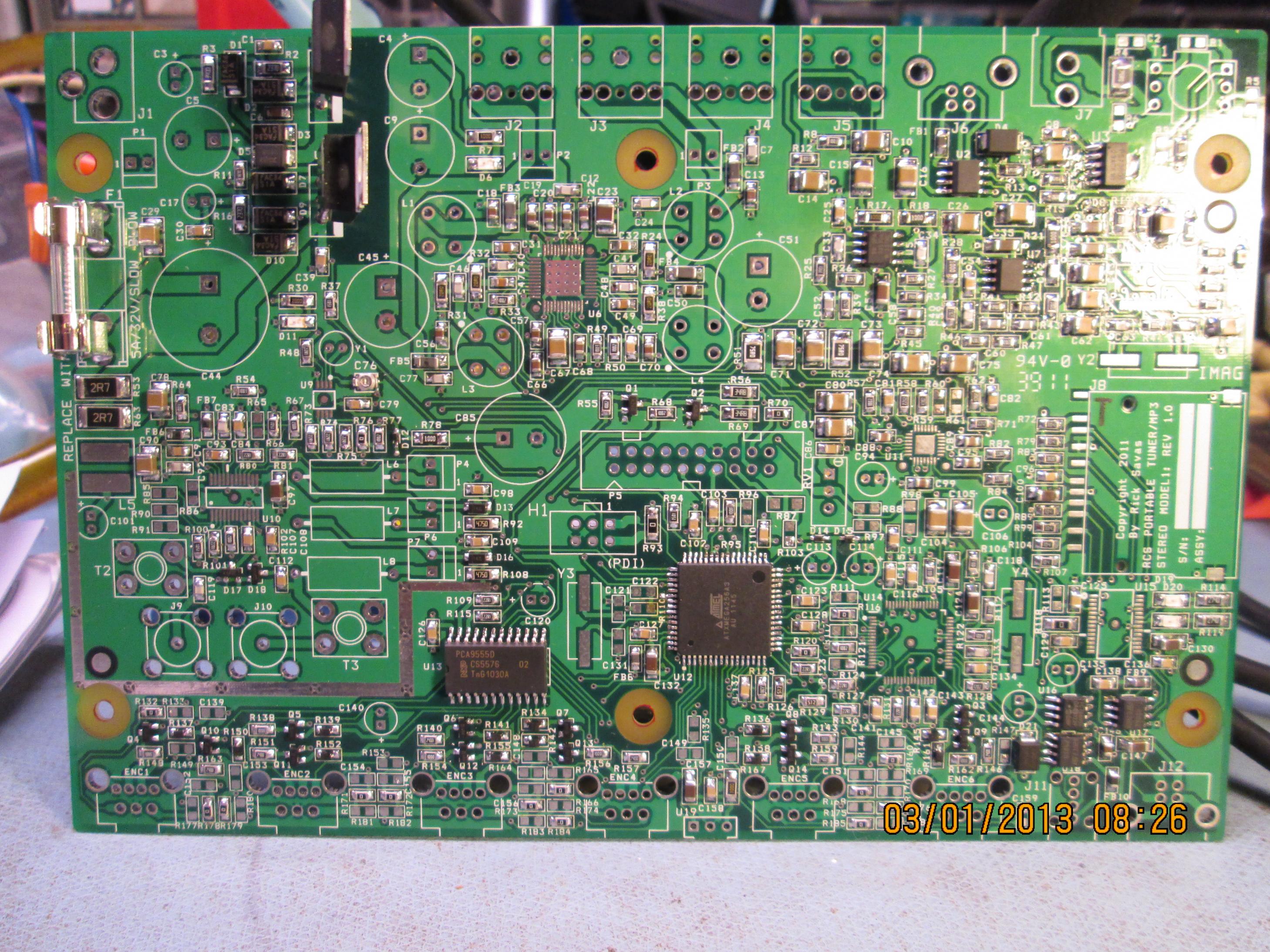

The pic is what I am working on these days.
As a reference, the part, U6 in the upper left, with the centre thermal pad is the place for the TPA3100D2 and its associated comps.

The board pictured is designed by myself. It is a portable radio/media player. It is what I would call medium density mixed technology since I used 0805 & 1206 sized passives. I do not use any flux at his time. I find that the flux that is contained in the core of the referenced solder meets all my needs. I would use liquid flux for hot air component removal, but do not have any on hand. I have been looking but have yet to find any no-clean liquid flux.I am sure it is available, I just have not found any yet.

I am using both 15 mil & 32mil glow core eutectic solder and "yes" it is all being done by hand.
I finished up the majority of it yesterday, today I finish adding the last bits then power up & start testing.
This is my second pcb like this. I built the other one in late 2011, I spent most of last year writing the software. It has become a complete working portable stereo. Radio, MP3 player, USB codec, 20W amp etc. Software is not my specialty, I am much better at HW (hardware) but I need to know both since it is a one man show.
Soldering irons are both Weller, WES51 with a "FTO" tip for the small stuff & WTCPT with "PTA" tip for the PTH (Plated through Hole) and larger SMT pads.
Having the lead content in the solder, helps a lot because of the lower melting point and that I had the pcb plated in lead based HASL (Hot Air Solder Leveling). No lead solder is harder to work with. This, I can not claim as ROHS/REACH compliant, but i will state that it is designed to last a life time, not sure how much that means to a bureaucrat.
I bought a head band magnifier, from Amidon, it works great. I only have to use the jewelers loup for final inspection of the solder joints and for touch up. Can't for get the 15mm wide solder wick, to clean up the solder bridges. The DFN packages are the trickest, but I have figured out how to do them by hand as well. For BGA, for get it, have to reflow.
I have yet to build anything using a stencil,paste & re-flow oven,
I did buy a hot-air machine fromm SparkFun, not too bad for a $100 bucks.

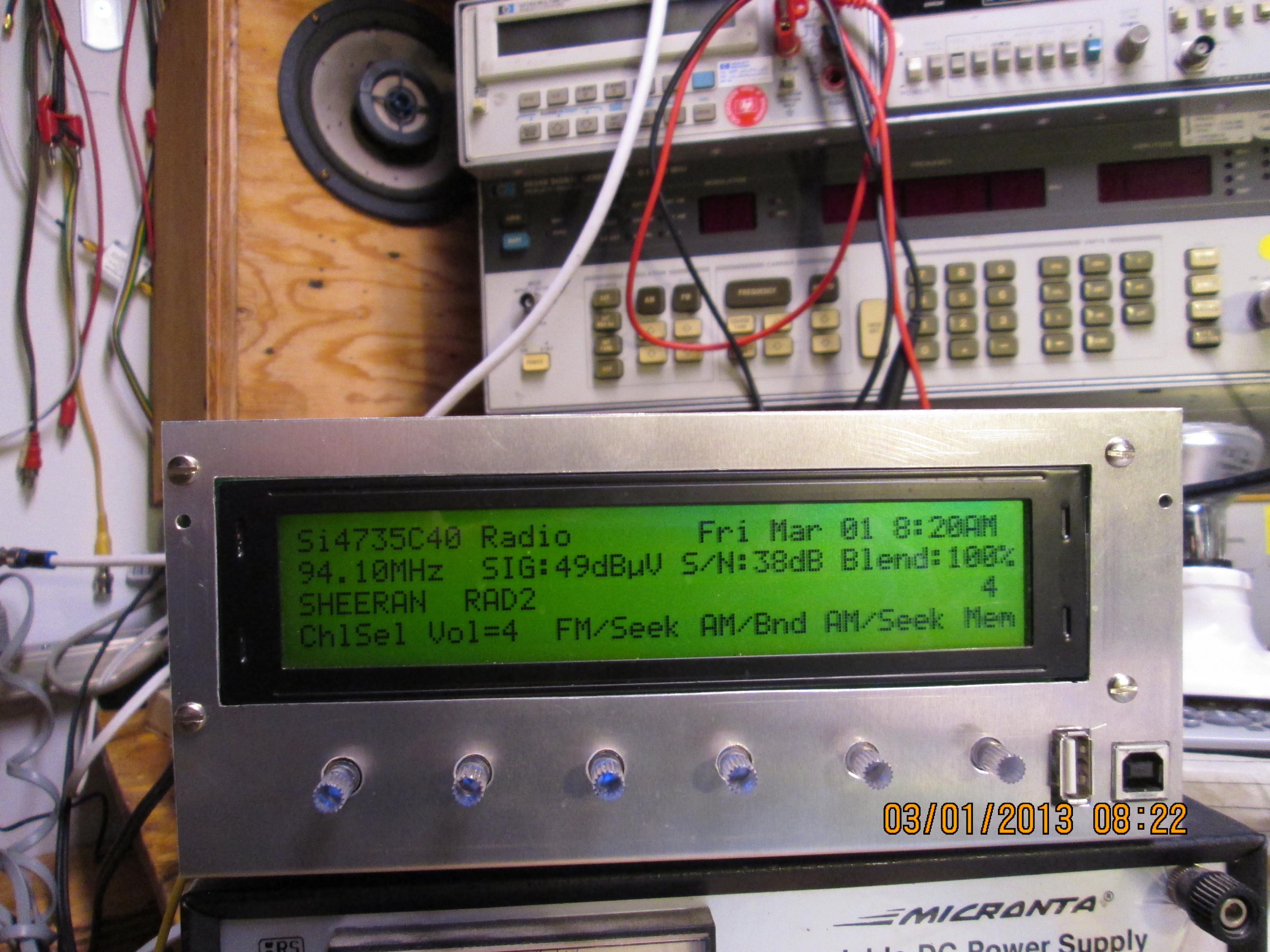

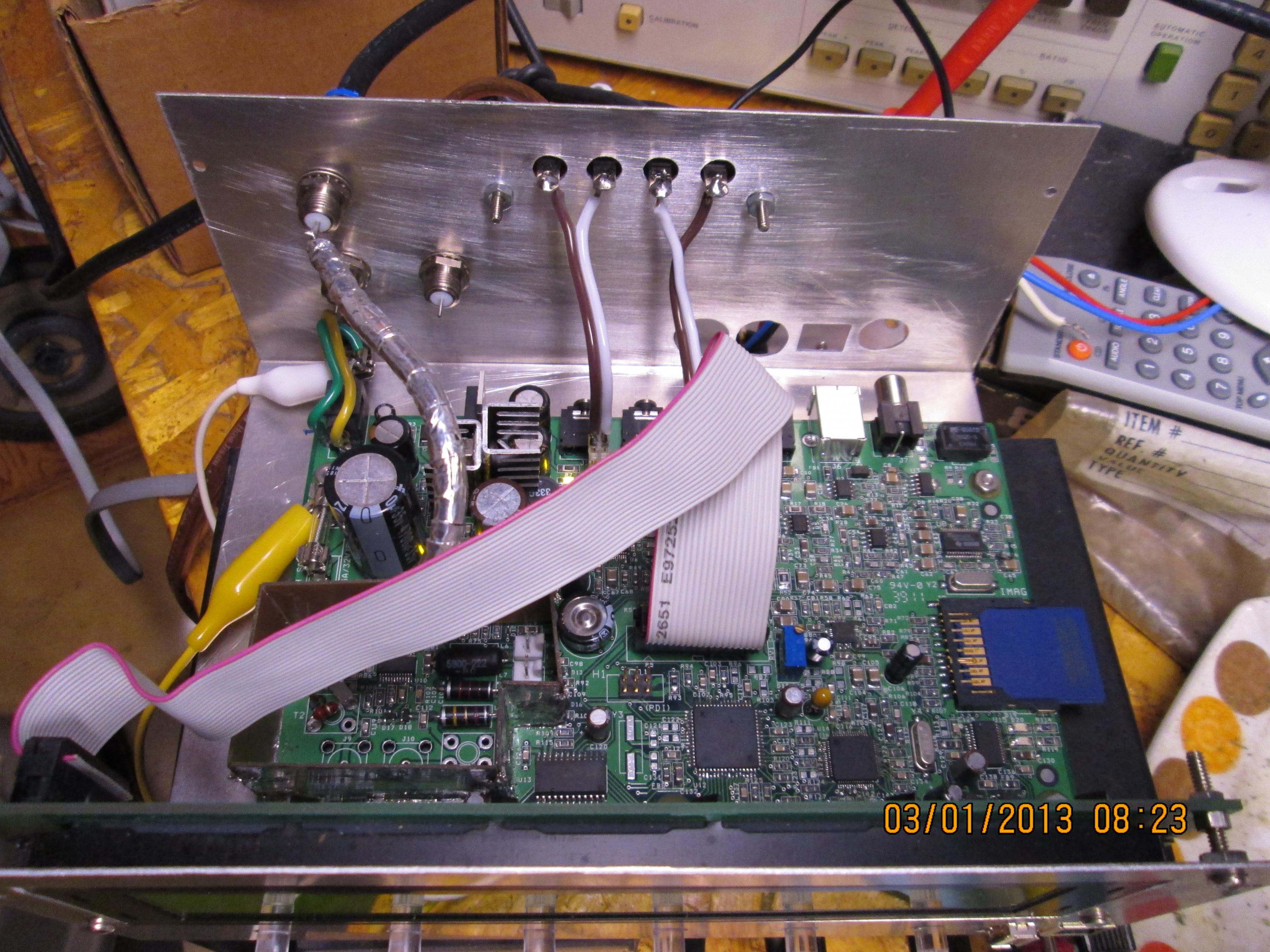

Working unit
A few pics of the working unit, in radio mode.
You can see my mechanical design/fabrication skills as well 😱
