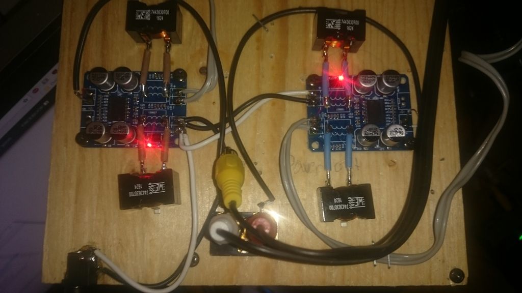

Got some samples from Wurth to test.
Now we talking!
Quick test I have hard to tell Volt+ apart from Sanwu!
Have only made the 20db mod running it with 24v SMPS.
Very low noise, in same level as Volt+.
Adding a bad pic.

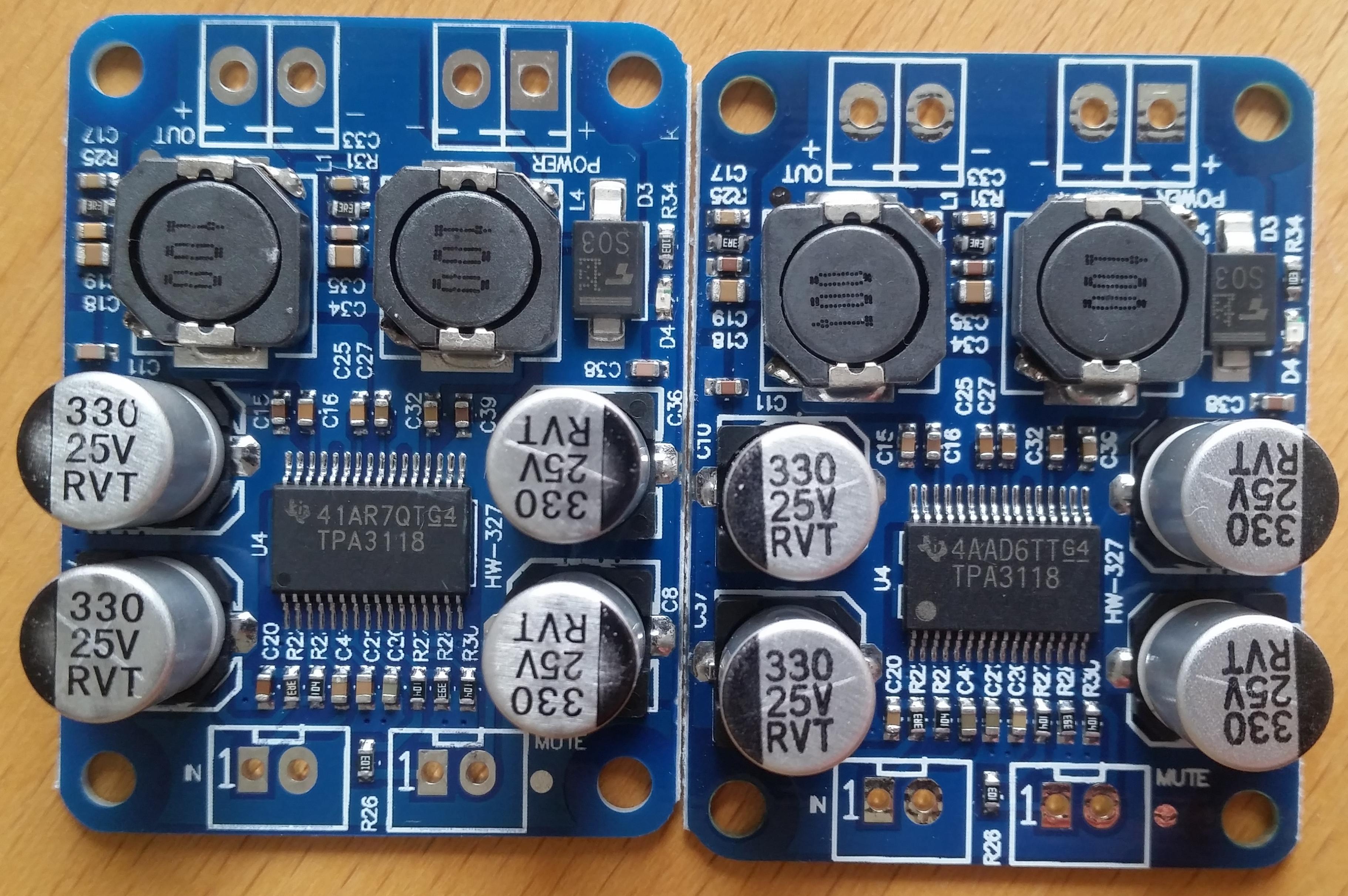

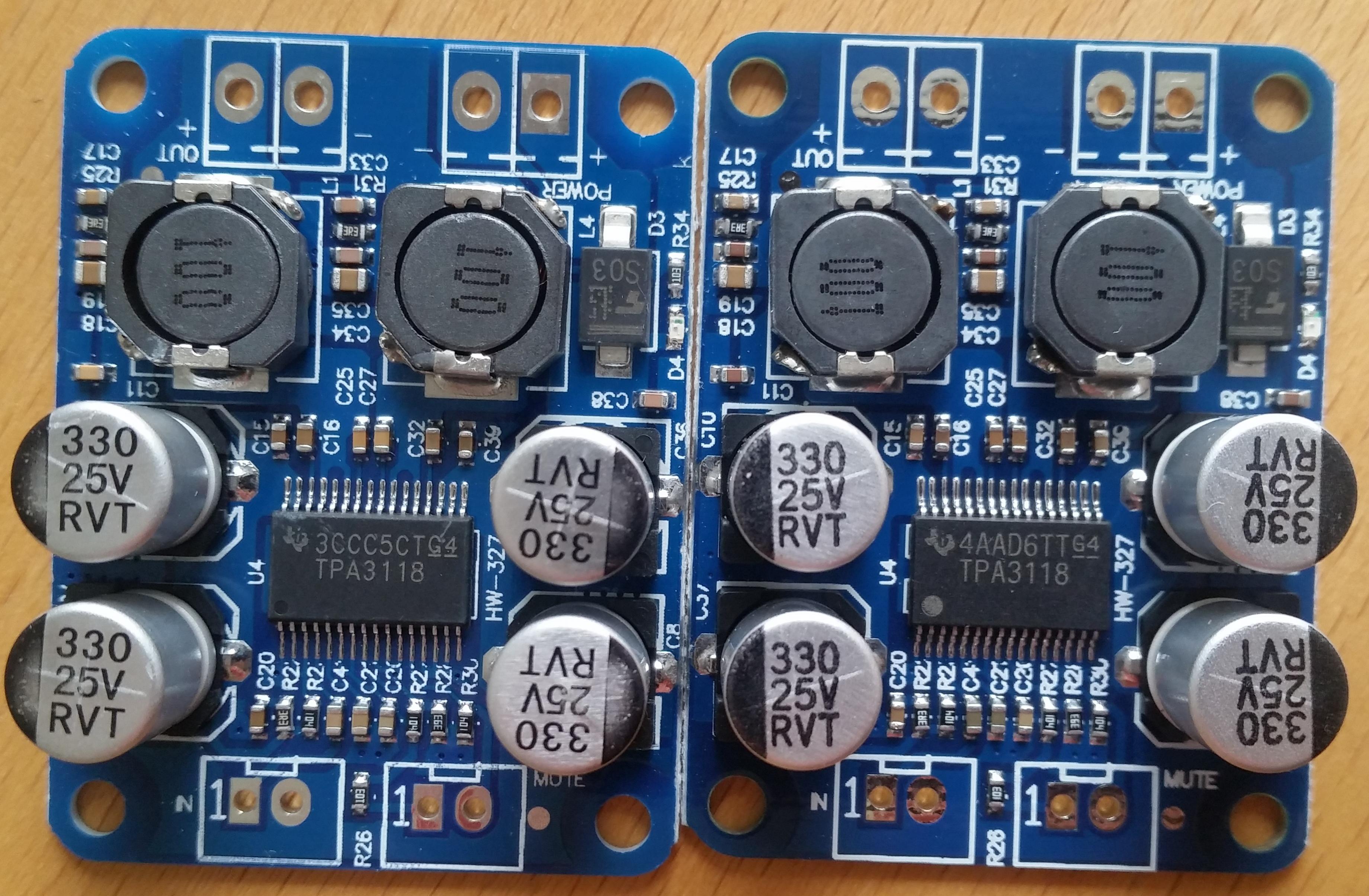

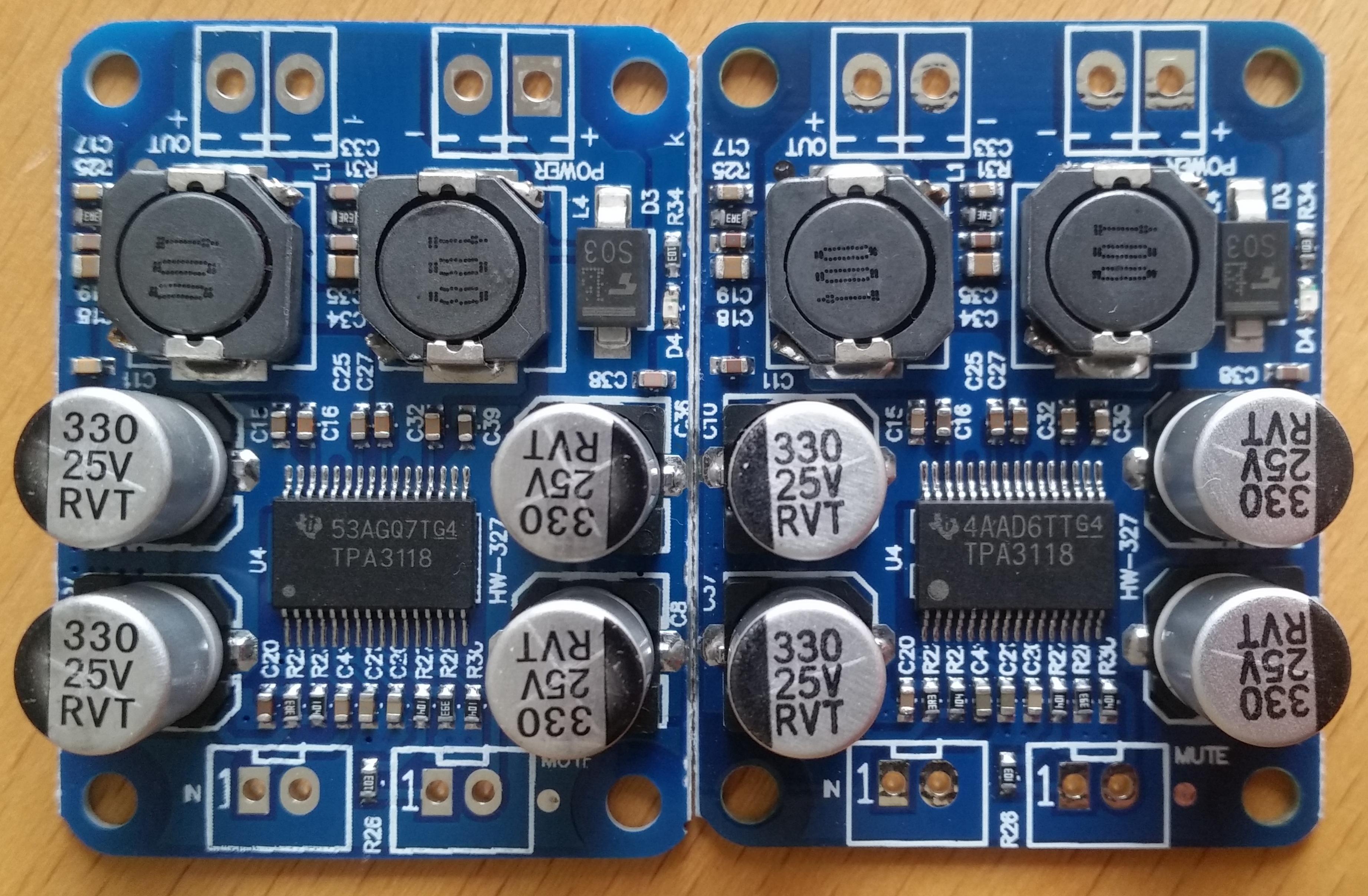

I made some funny findings when comparing boards I have. Some time ago I ordered few boards from Ebay and all chips had serial number 4AAD6TTG4
Later I ordered 4 more from the same seller with same price and to my surprice this time all chips had unique S/N:
53AGQ7TG4
3CCC4YTG4
3CCC5CTG4
41AR7QTG4
Chip markings also vary regarding the position of TI-logo and the dot in the lower left corner. Comparing boards to previous ones, there is also differences in cap markings (fuzzy/sharp), silk screen colour (4AA... has darker) and ESD bag.
I'm not too worried about dies inside the new chips, just wondering if they are running out of 4AA... stock or new people playing with chip markings. 🙄

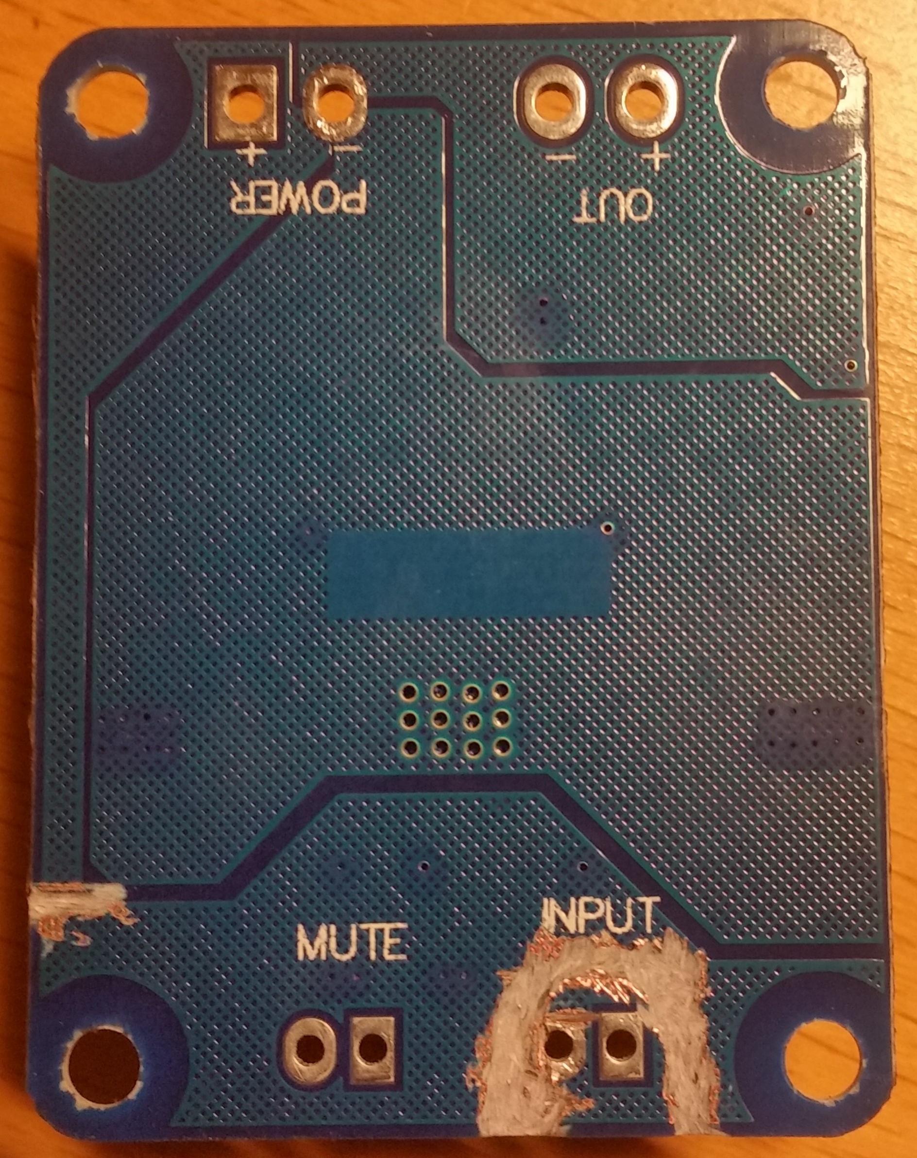

Lately there has been talk about cutting the "bottom trace" between input neg. and power ground. After mutilation of one board I can still measure short between these two points. What exactly should be cut and how to verify the cut with DMM? I would highly appreciate a picture from this operation. 😱

My contact at TI says:
TI does actually do some legitimate manufacturing in China in our own Fab with very good quality control. If we find counterfeits it would be the first time I've seen class-D copied! But almost every product that generates a profit has been copied so far, so it's just a matter of time.
They do indeed seem to be identical with rev letter D2. Therefore #2 is probably not a fake. Packaging may have been done at a different site, making the dot look different. Some packaging sites use laser marked dots, and some use molded.
For TI and other IC companies that I’ve worked for, packaging and testing are done at different factories than the IC fab. TI uses both internal and external sites for packaging. It’s quite possible that the TPA3118 is qualified to be packaged at multiple sites.
Okey, that's reassuring info. 🙂
