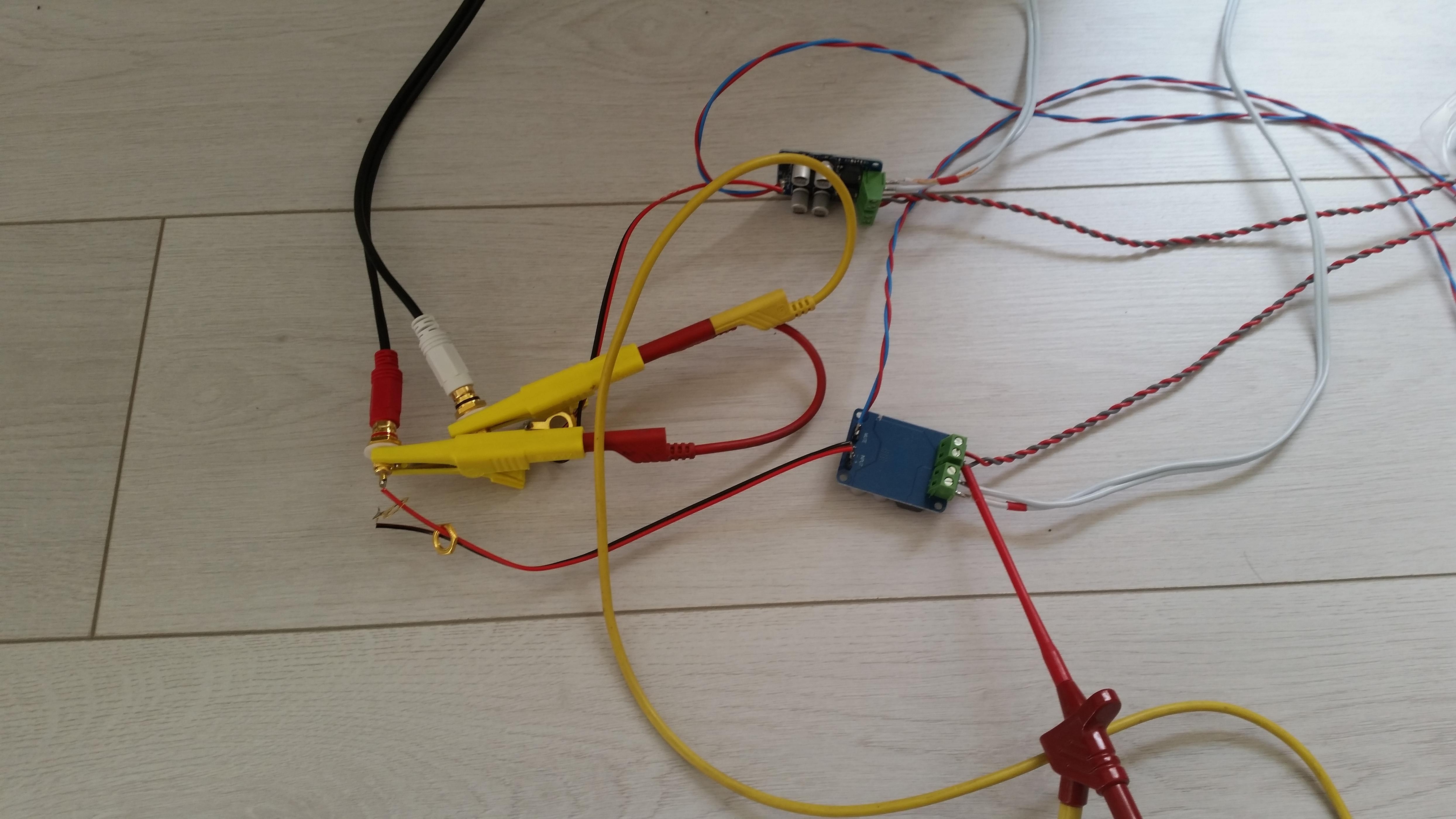

Having holiday and some time to play around. I noticed I get hum, if I use one SMPS for two boards. Both boards are set to 20 dB gain. Hum disappears when inputs are shorted individually, but reappears when input grounds are connected together. I'm using mini plug - stereo RCA cable as connection to source (PC has female plug connection).
I assume I'm creating a loop from the mini plug that goes through board, power supply and back. At the moment I'm testing with two power supplies, one for each board and everything looks good. I guess using input transformer would also solve the problem, but I haven't seen any cheap ones (or atleast with reasonable shipping fees).
So I'm asking more simple (cheaper 😉) solutions when using existing source. Would bringing source signal ground straight to PS negative DC out with one wire, skipping amp inputs, be a good idea? That would create star ground point when using only one PS and everything should be nice and dandy sound quality wise?

After a little bit testing I found the best place to connect signal input ground was at DC in at amp board. Power supply out gave a bit noisier result. I had my boards connected to power supply with separate wire. I assume using single pair and having the DC connection between the boards short might be beneficial. Anyway switching mode power supplies are not that expensive, so I will probably end up using one per board as this gave lowest hiss/hum.

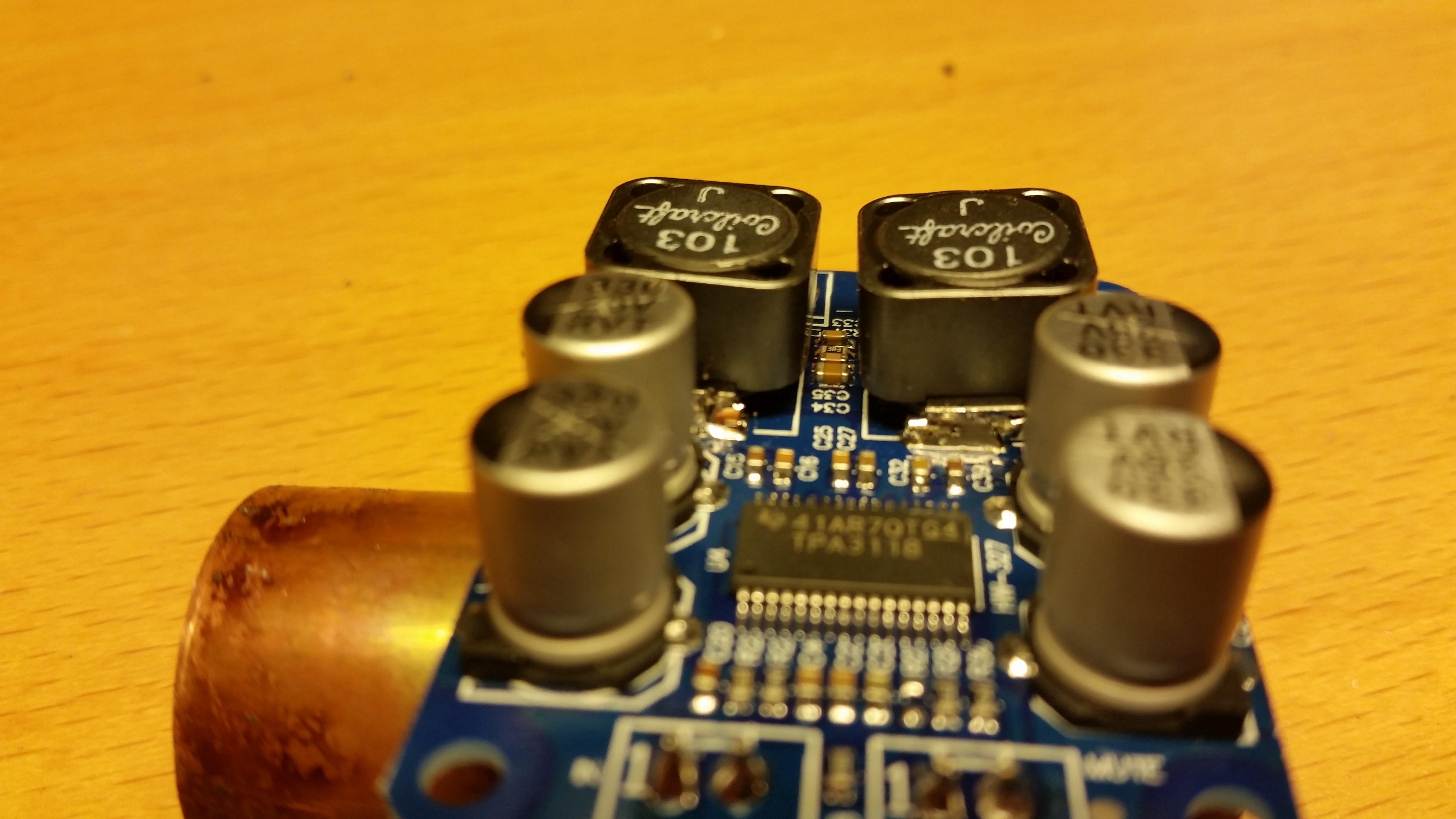

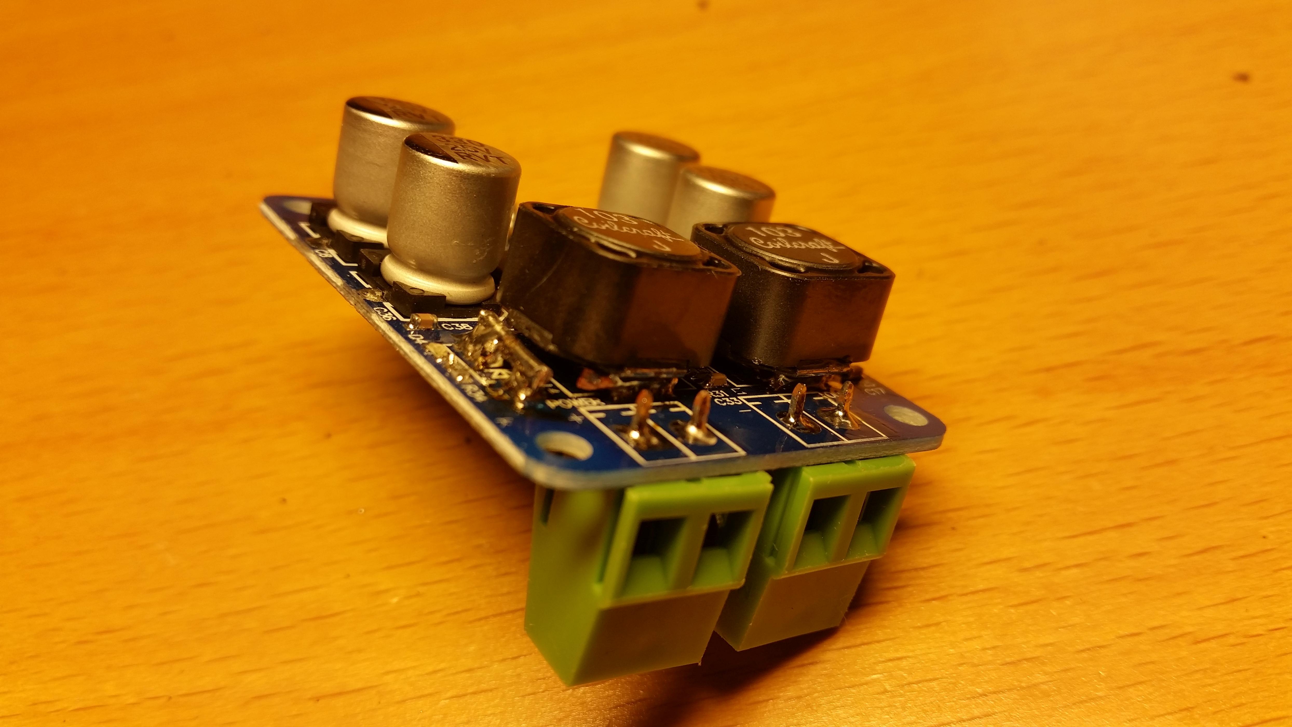

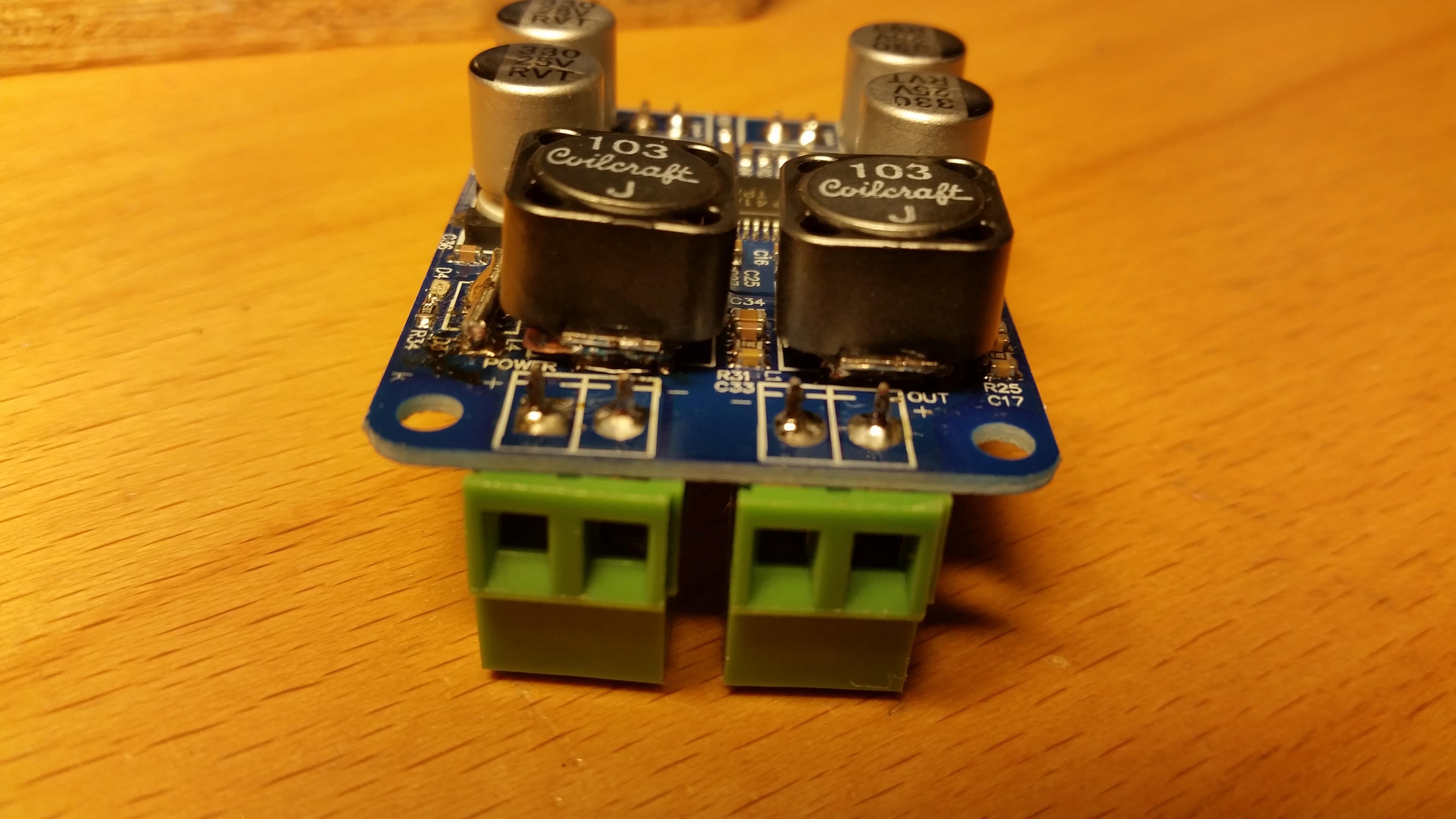

About modding, I would be happy to see some pictures if someone has about using Coilcraft MSS1278-103 on these small boards. I had to remove reverse polarity protecting diode, use copper spacers (solid wire) between the board and coil and a lot of solder to get them to fit without touching other components.
