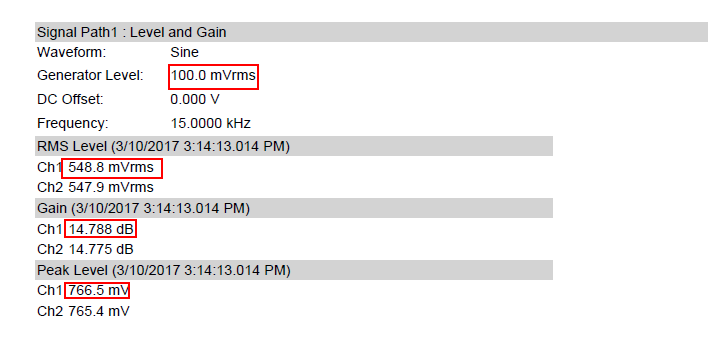

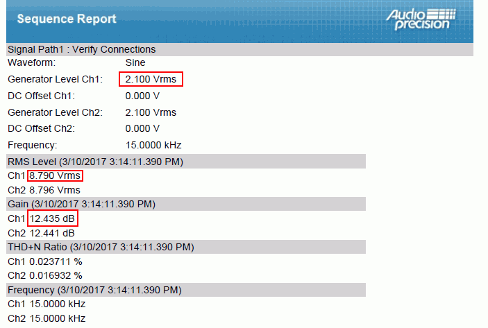

The 2.1Vrms setup is for connection check only.
From the rms-values of this test it can already be seen that there's something wrong with the gain of the tested amplifier.
At 15k with 2.1Vrms input:
attachment.php
With only 100mVrms input gain increases by 3dB..
attachment.php
Power compression? Or weak power supply..
Anyway, no 20dB here.
