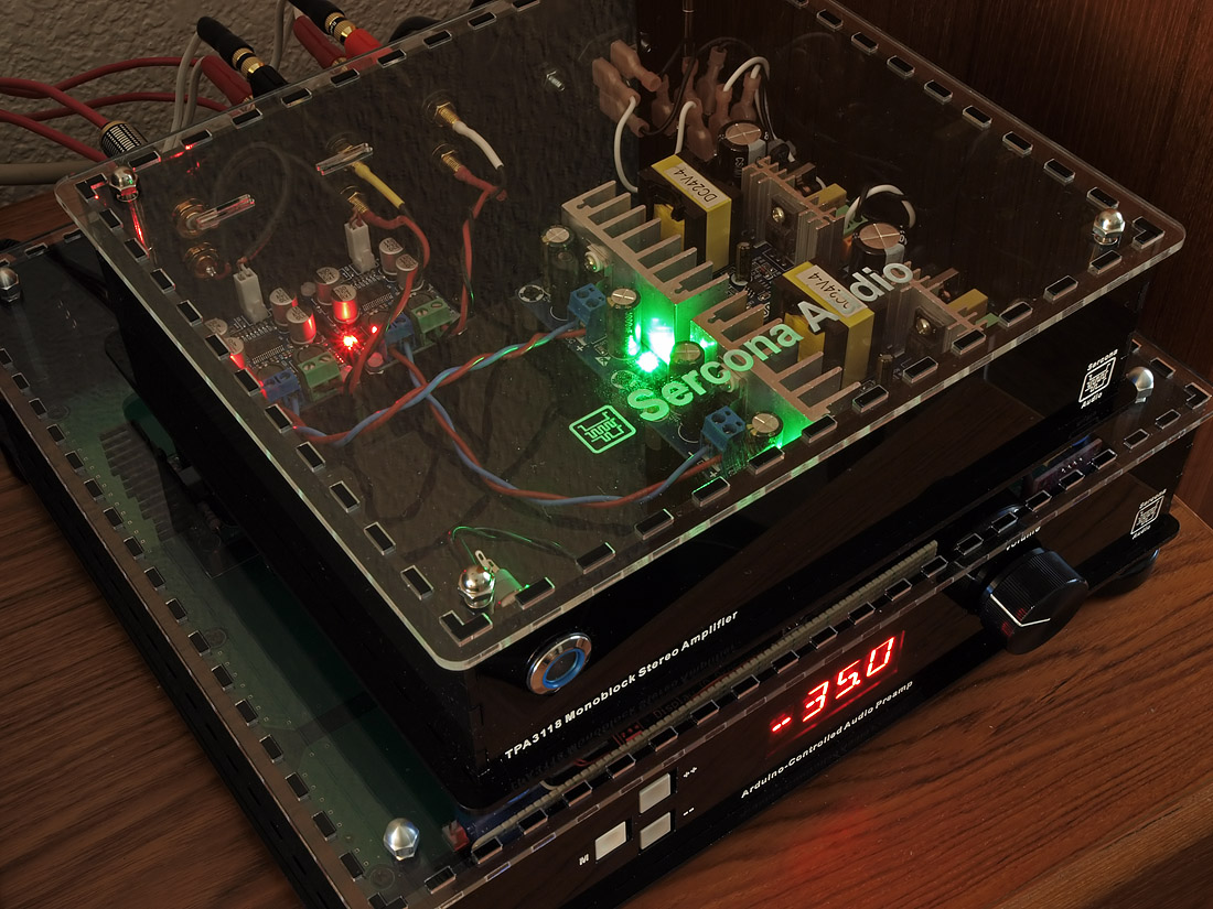

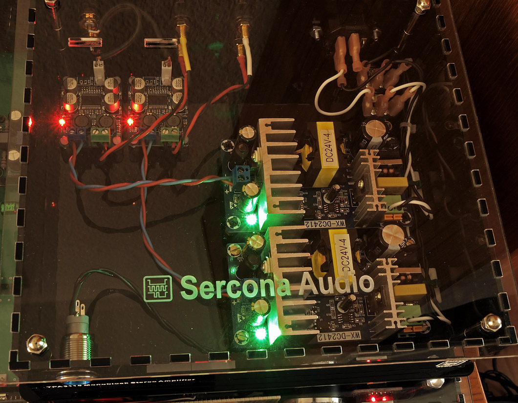

some pics of yesterday's TPA3118 build (unit is on top of my older, existing LCDuino relay atten preamp).
I tried to do a fairly neat job this time (lol). nice silicone flexi wiring (from my quadcopter hobby) and 2 of those DROK amazon 24v supplies. I even splurged for nice terminal blocks and properly crimped connectors. white wire is neutral and black is hot (and fused and switched). there is nothing to connect green ground to; not sure if it makes sense to have a 10ohm/.01uF ground-breaker from rca shield to power ground or not. for now, left it floating, but protected with a dummy quick connect terminal.
I might change the led colors, though 😉 maybe make them all the same color; and my front power switch is a blue illum thingie, so maybe it should all be a blue color theme.
at some point I might also add a controller for remote control, muting, fault detection, over-temperature detection.
Nice build, thanks for posting!
Any listening impressions?
Did you do any modifications to either the amp boards or the PSUs?
Those SMPSes are very similar---though not identical---to the one Jensen567 talked about earlier in this thread. He was able to improve their performance a bit with some light modding. Based strictly on appearance, I'm guessing the same mods would likely benefit your SMPSes.
Some more general questions: what do you get by using one PSU per amp board, as opposed to one shared PSU for both amp boards? (Other than more power, obviously, assume you could get a single PSU with 2x the current capability of the two you used.)
Also, when you put a PSU (SMPS in particular) in the same case as the amp boards, does it make sense to try to protect the amplifiers from any EMI/RF noise created by the power supplies? If so, how would one go about accomplishing this?
I have average hearing and to me, these sound as good as anything else I've heard. once things are 'competant' (and its not hard to get to that level), after that its all the same to me. wish I could hear the 'magic' that others say they hear, but beyond 'good!' I don't hear this vs that sounding any different. I hear more diffs in material and mixing/mastering/micing than I do in electronics. I'll hear major diffs in spkrs and headphones, but once electronics are 'good' - I don't need to go beyond that.
I think that's why I'm now more interested in the efficient 'switching' amps (d, t, whatever). I'm giving all the A and AB style amps a rest (lol) and will live with just these for a while and see if I have any issues.
the benefits to me are huge. takes up less space, less weight, each module is a module on its own and since they are cheap enough, if they blow I swap a new one in. no heat throw-off to speak of, no fussiness about psu needs, they are easy to wire up and they don't need DUAL RAIL (wow, I hate that with a passion) supplies.
there, that explain my feelings well enough? LOL!
don't know about those mods. have a link handy? if its easy, sure, I'll give it a try. will I notice the improvement? probably not. but if its easy and it corrects some things, sure, I'll go for it.
I've had those psu's for a short time, just a week or two. they seem ok. I know that ones that look like this are all over: ebay, amazon, etc. I went with amazon for ease of shipment, returns, problems, quality control. in fact, one of the psu's that I ordered was 'delivered' by amazon next-day for me and it never got here. I called amazon and they sent a replacement truly next-day and I had it that next day, sure enough. if you are a 'prime' member, amazon bends over backwards to help you. ebay is just the opposite and if I'm dealing with long distance shipping across country borders, forget it. usually not worth the hassle unless its sourced only from over there.
amazon will be doing well, I predict, as there are probably lots of people who feel the way I do. we'll pay a few dollars more for that service, as long as we are buying one-off quantities.
every time I tried combining boards with a single psu, I got some oscillation or swishing noise. I did not try putting one module into slave mode (which maybe is what you HAVE to do if you parallel supply them?) - but I wanted to leave the modules as stock as possible and since a psu is $15 or less, spending time THINKING about it costs me more than the module. lol.
there's no down side to going full mono. everything OTHER than full mono is a compromise. for $15? come on. the modules are mono, why not go all mono, at least in this box. (ok, I didn't go dual IEC inlet. that would be funny. no, I don't plan on that) 😉
oh, and as for the proximity of the switching psu to the boards, I did the orientation as best I could and in actual use, I don't hear any real hum issues. the background hiss is always there. when I tried a single mono module with the cleanest 12 or 24v dc supply I have, the noise is still the same. that proved to me that there is no benefit to a 'clean' linear psu when you go into a switching amp like this one. why waste linear and trafo on something that is going to eventually 'destroy' (lol) the signal anyway?
the board is well laid out, it puts the input on one end and the output+psu on the other. perfect. can't ask for better. and so I made my box just like that and the orientation of the flow really dictated how the main elements of the chassis would be. next iteration, I'll clean up some rough placements and make it even more optimal for signal path.
keeping the distance from the psu to the amp is a critical point for me, in philosophy. once you exit a regulator, you want to keep that loop short. I didn't go nuts doing that, but I kept that in mind and did what I could with the modules that were there. the psu modules were also properly done, ac on one side and dc-out on the other. that defined where my ac inlet would be in the box, and by rule, the rca in has to be at the opposite side, as much as you can.
I'm happy with it, even though it may look 'odd' and some designer who might think of the chassis, first, would demand I move internal things around. but I refuse 😉 I try to get the signal flow and psu and i/o so that it makes as much sense from an electrical POV as possible, still being buildable and fixable, too.
