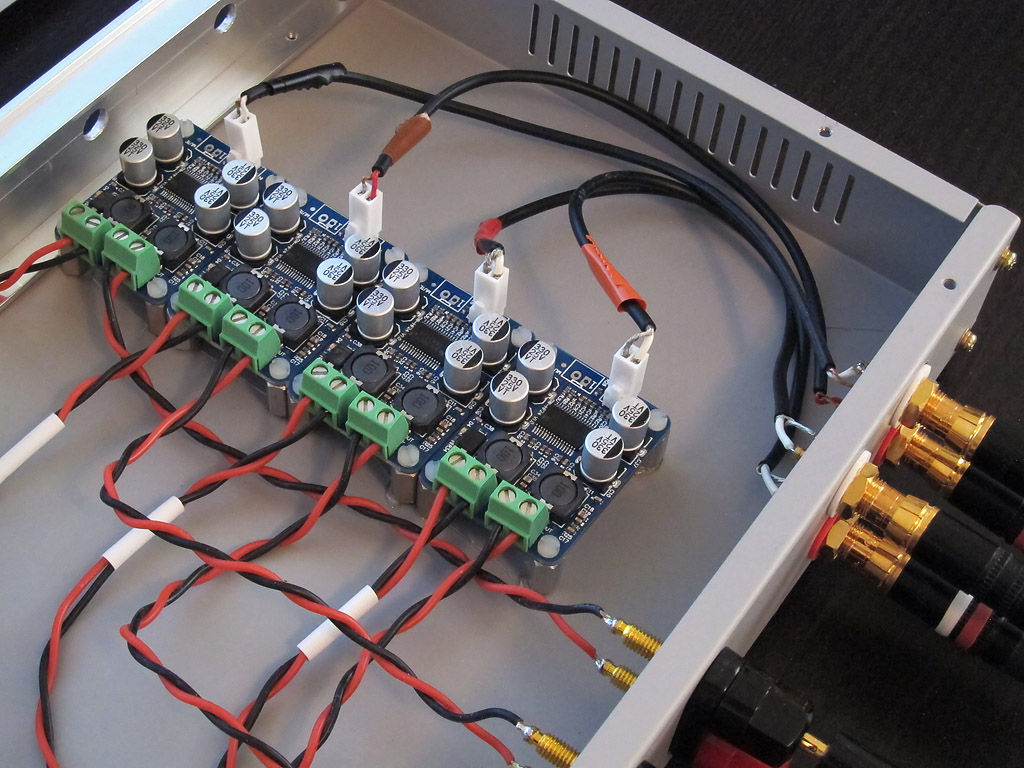

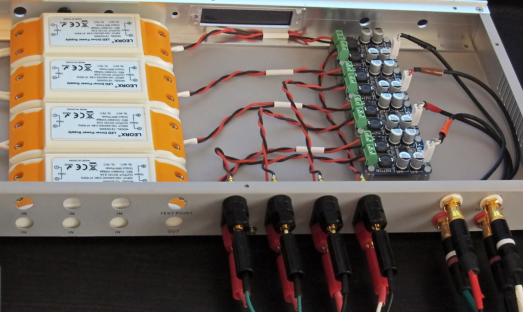

photos of the current test-bed, inside a 1u repurposed rackmount chassis.
the ac wiring is still ugly and hacky. for some reason, it was not in the photo frame (lol). will clean that up when I get a chance.
the rest of the config is laid out for keeping inputs away from outputs and power. the layout seems ok and I hear no noise that I could attrib to the layout.
not that it matters much, but the wire I'm using is leftover silicone wire that is sold for RC toy batteries (lipo 3.7v). they are very flexible, have lots of strands, don't shrivel up when soldered to and they are very low resistance. its not cheap but I love working with that stuff. the rca cable is just leftover junk from 75ohm yellow rca composite patch cords, back when vcr's and stuff still were 'a thing' 😉
there is no muting circuit and no on/off antipop circuit yet. so far, I have not found the need! I think the key is that I'm driving these amps from a constant output-z (low z) drive and its not just a passive pot in front of the amp modules. I leave all my stuff on all the time and the preamp stays on all the time, too. when I power the set of 4 amps off, I hear a slight click in my drivers but nothing scary enough to justify having relays and timers and controllers. not yet, at least. power-on is just about as gentle.
each amp gets its own psu and sometimes the on-leds don't all light up at the same time. I think that if you can afford the cost and space of 'mono' psu units, DO IT. common psu is harder and this is so much easier and better, with a psu brick being so cheap, I saw no need to 'simplify' things with a single psu. this is a full mono setup and I like that.

I agree that for 1 or 2 boards, at most, an external brick is sensible. I have a few bricks around - lots of people have 12, 18 and sometimes 24v bricks.
but you have to admit, for 4chans, having 4 of them dangle on the floor with 4 barrel jacks - that's just messy as hell. and if you are going to embed something in your own box, might as well go better quality.
that no-name one you linked to has no u/l or other safety cert. I would not touch such a thing, personally. now, I'm not convinced the ones I picked are u/l rated, but they do seem a step up from the total generic ones that you find all over the place.
you have to actually search for 'u/l listed' to find one; and they are the exception, not the rule. even the cheaper US lab (etw or something like that) rarely shows up on the generic bricks.
you can find good safety rated bricks and I'd suggest that people try to find those, first.
the track record for generic no-safety-rated bricks is NOT good. you may not have had fired, but plenty of people have. china does not care what they send us. I would be careful with buying at the very low end.

in my case, I found that when running 4 boards, I had some kind of oscillation or noise that was not present when using 1 brick for each amp, true mono.
if you can afford the space it takes and the slight extra cost, I personally think the full mono setup is far superior. in my case, I could have debugged the single psu config and made it work, but going with a private isolated psu per mono board was just too easy and too practical to avoid 😉
