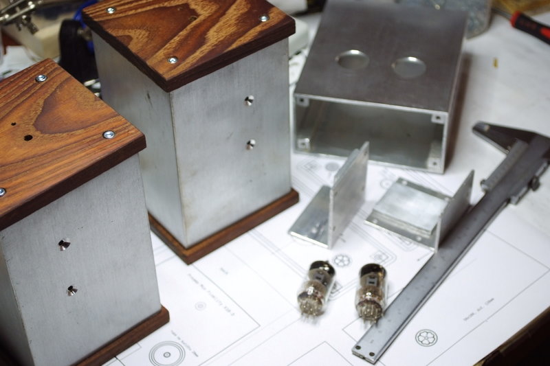

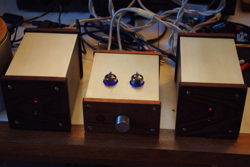

Always on the lookout for the good sound, and being happy with the TPA3118 sanwu boards, I made another set of monoblocks (with separate power supplies, 19V each), this time paired with another tube preamp.
This one is supposedly a copy of Musical Fidelity X10-D, nicely made.
So, a few days later, here is the finished result. The sound is very nice - the tube preamp seems to "smear" the sound in all the right places 🙂
I noticed that a tube preams sometimes helps with some of Class D amps, "taming" the occasional harshness in the upper registers.
Well, to each his/her own, but for me these sanwu boards sound OK even without the tube preamp... But, it adds a nice touch 🙂
In short, nothing lacking, and it can drive even rather demanding speakers up to respectable levels (not the dancehall levels, but still way louder than normal home listening...).

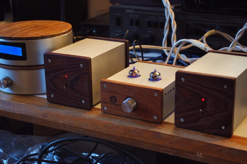

Do you have a link to the tube preamp you used? I have a YJ 3 tube that makes these TPA amps sound better to my ears, but you are correct, the Sanwu boards sound fine just as they come.
Your build were my inspiration to copy you great work. (see link below)
Nice build you did there...
The tube preamp I'm using is this one:
6J1 Valve Tube Pre Amp Amplifier Board Bass on Musical Fidelity x10 D Circuit | eBay
- supposedly based on X10-D Musical Fidelity... Actually, not bad at all. Components are OK, soldering is OK, so no complaints... We'll see when I try some other equivalent Russian tubes if there is any improvement - but it sounds OK as it is, anyway.
