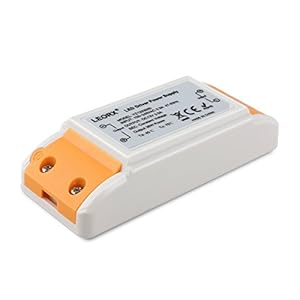

got this one, in today, and so far I'm liking it:
meant for LED lighting (12v seems to be standard for those guys) and has 3A capacity.
its plastic covered (safe), small (I like that!) and for modest power listening, 3amps is probably good enough to get by, with. I need to fit 4 of these somewhere, so keeping the size down matters a lot. trying to get it all in a 1U somehow. and not a deep 1U, either, but more pro audio standard kind of size.

its cheap power and for the class-d, I'm not sure it matters that it is 'supposed' to be for led lighting. if the led lighting craze yields nice, thin, sealed, industrial quality 12v CV supplies, hey, I'm not about to tell my amp who is sending it power

I cannot find a single fault, yet, with this stupid LED power supply. lol
its cheap power that seems to be well built. I'm happy so far. 3 more are coming and I'll see how a setup with 4 of them works out, long-term.
