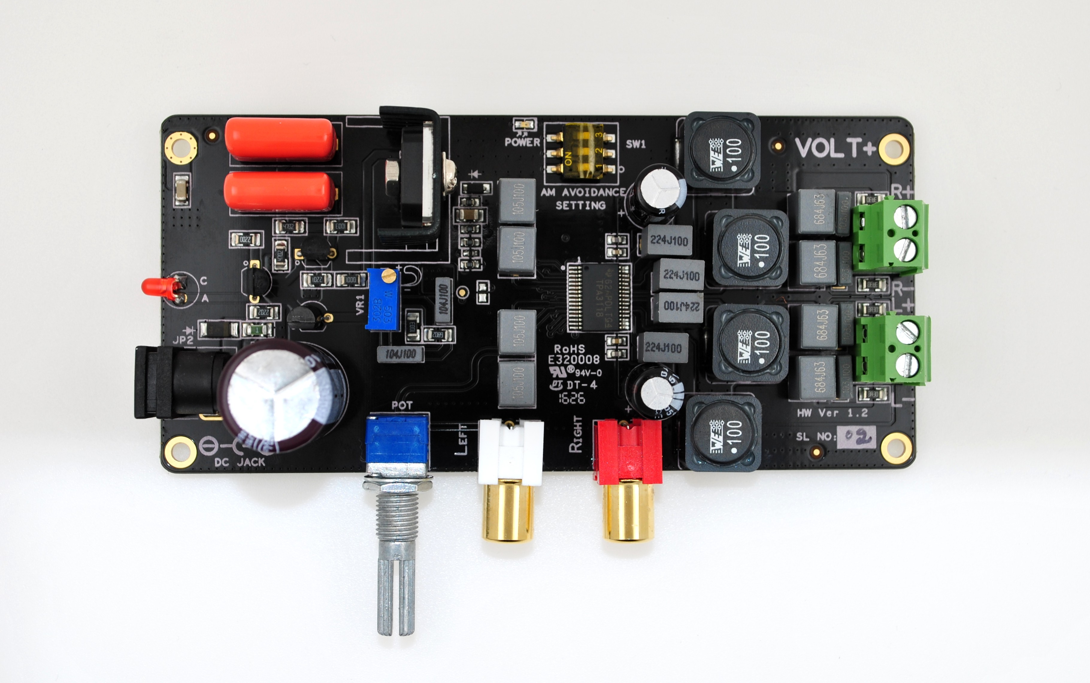

tpa3118 with capacitance multiplier
Attached is our Volt+ with capacitance multiplier .CM has a PSRR of about 70db up to 100Khz and about 48db at 1Mhz
It will work with any laptops bricks from 12-24v and dropout voltage can be adjusted using the trimpot (dropout voltage should be higher than noise/ripple on PSU) We recommend 2x higher to make sure its fine.

Sorry but layout is very impractical. How is this board supposed to be built in a case ?
- Input connectors are at the same side as volume potentiometer ?!
- speaker connectors are at the opposite side of DC jack ?!
- power on LED is at the same side as the DC jack ?!
Please think of a better layout so that devices can be encased without headaches. Volume and power on LED are at the front. Speaker outputs, DC jack and RCA inputs are at the backside in 99.9% of devices that are meant to be operated by humans.
Hi Jean Paul ,
yeah we are aware of RCA/potentimeter , but from our testing it should have enough space.
Speaker connectors /dc jack...that was our choice since the beginning. We wanted to separate the digital noise from analog stage as much as possible
We will release a very cheap acrylic box for it.

It has the same ergonomics as Raspberry Pi. It would be wise to design not only with technical excellence in mind. A device should be ergonomically unchallenged otherwise it will annoy all its users all day every day !
Connectors at three sides ?! What where you guy thinking ? The now created cable salad/spaghetti is very annoying as it takes more space than necessary and it gives a messy look. Besides that it serves absolutely no purpose.
