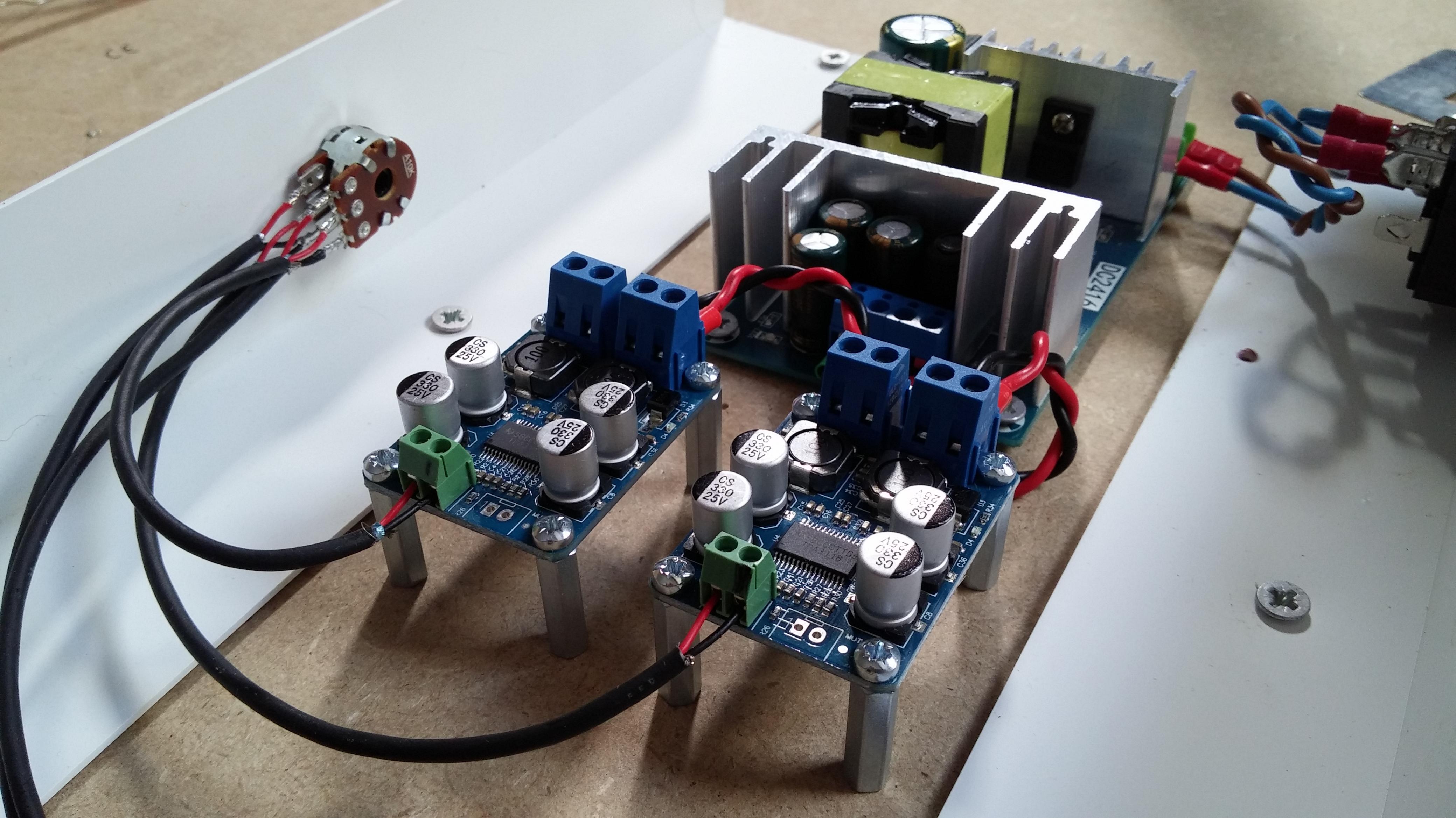

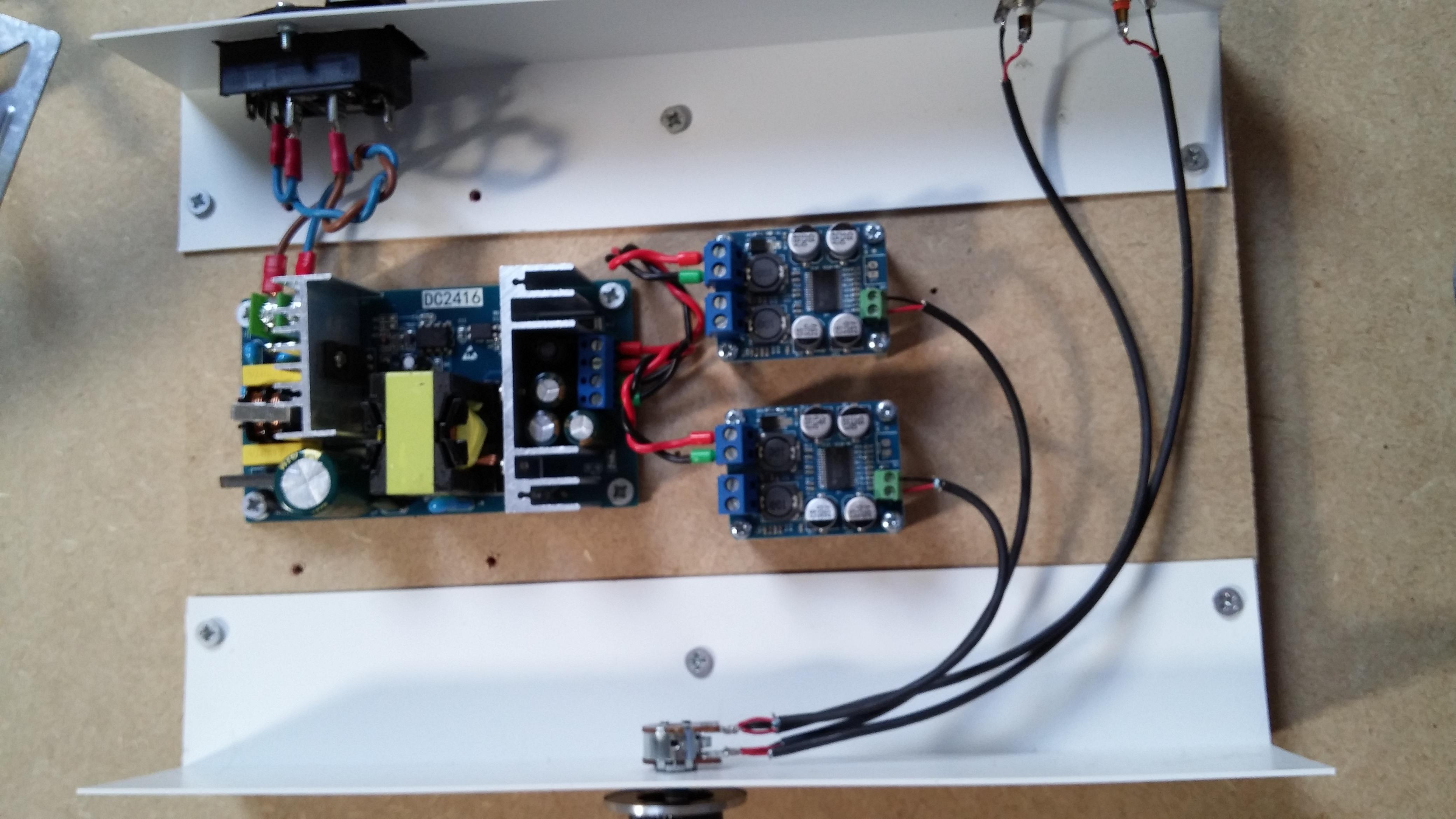

It took some time, but I corrected the mounting of the modules and redid the wiring. Using microphone cable makes a LOT of difference! Also redid the layout as suggested in here, much better this way!
(please don't criticize my soldering skills too much :D )
Do notice that I should have connected the shielding of the cable to the black wire inside it, this removes the last bit of remaining hum when I do it on-the-fly with a crocodile clamp.
Still waiting on my speaker terminals, so I can add that last bit of wire in there and properly use it and test it out
Nice improvements! Thought, if you put the aluminum angle on the outside of that mounting board you could shorten the leads even more. And, the amp footprint gets even smaller. I would also mount boards to a strip of aluminum or copper or heatsink to absorbed some of the heat and get it away from the amp board? I used a strip of aluminum and just put some JBweld under chip and glued to aluminum. Makes quite a difference. Holes to outside the case would help reduce trapped heat too. Just a suggestion.

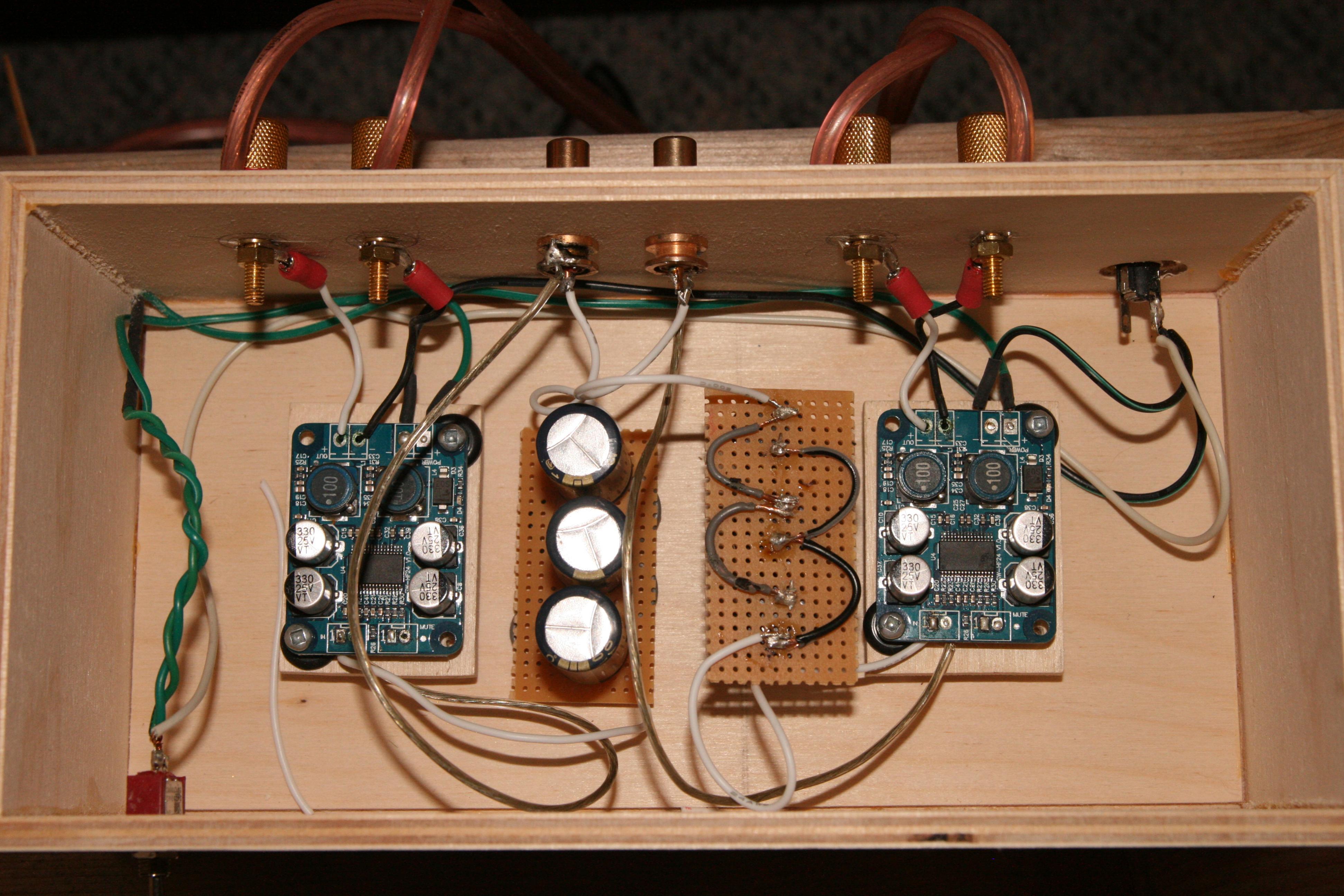

a little boost in power and perhaps a little more bass
If I understand what I'm seeing in that photo, you've put a big bank of large electrolytic caps inline with the audio inputs for each board.
I'm not sure what its going to do, but I doubt it will work as you hope.
Perhaps you are confusing and combining two different things.
First, that too-small coupling caps in the audio input path can roll off the low-end.
Second, that voltage sag on the power rails can distort amp output, at times of high-power, especially when playing low frequencies.
The first would be addressed by shorting the input caps on the board and then using suitable caps in series. Whatever constitutes suitable type of input cap, I'm pretty sure the value is much less than you have there. It may also be possible to eliminate the caps entirely, as long as you can be sure that the input has no DC component.
The second might be helped by your putting big electrolytic caps in parallel with each other, and the load between the positive and negative power inputs on each board, as close to the board as possible. Having a suitably sized power supply is probably a good first step though.
Edit: Looking even more closely, it appears like you may have the power and speaker connections for the module on the left quite wrong.
