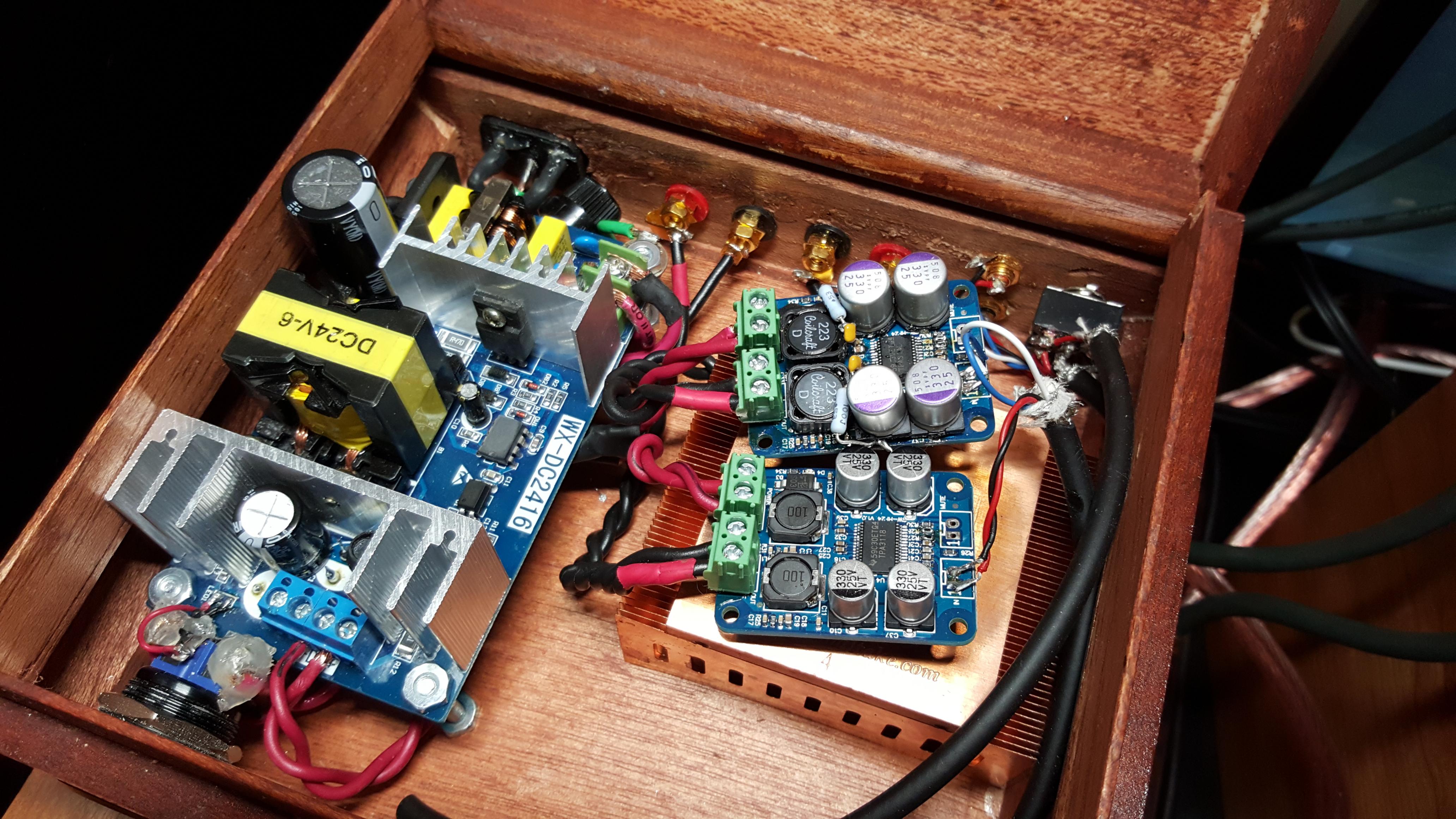

Have been reading this whole thread to dust up mods. Found this the most interesting. Im actually very happy with the sound of the boards from stock. Except gain which I changed. But I also have this high pitch sound when nothing is playing. Barely audible, but I know its there. Which mod is the most likely to fix this? By the way. Couls I leave the stock SMD caps and put one big ekstra on power input instead?
542209d1459994807-cheap-tpa3118d2-boards-modding-them-everything-comes-20160406_205522.jpg
Regarding mods: Judging from that photo, I'd say that if you aren't unhappy running a heavily modded board on one channel, and a nearly stock board (other than gain) on the other, then you are well past the point of diminishing returns on any mods.
Regarding the noise. What do you have connected to the inputs? Does what you have connected effect the noise? What happens if you put a low-value resistor across the input (for diagnostic purposes only)?
This is not my amplifier. It is "Thrashcanz". It appears he modded one to do some A/B testing.
High pitch noise is barely audible after gain reduction, but it is there with every source I tried. I have not tried a resistor.
Thrashcanz replaced the smd capacitors and heard a difference in bass response at higher volume. Could I just add a 1000uF or someting on the power terminals instead of having to desolder the SMD caps?
