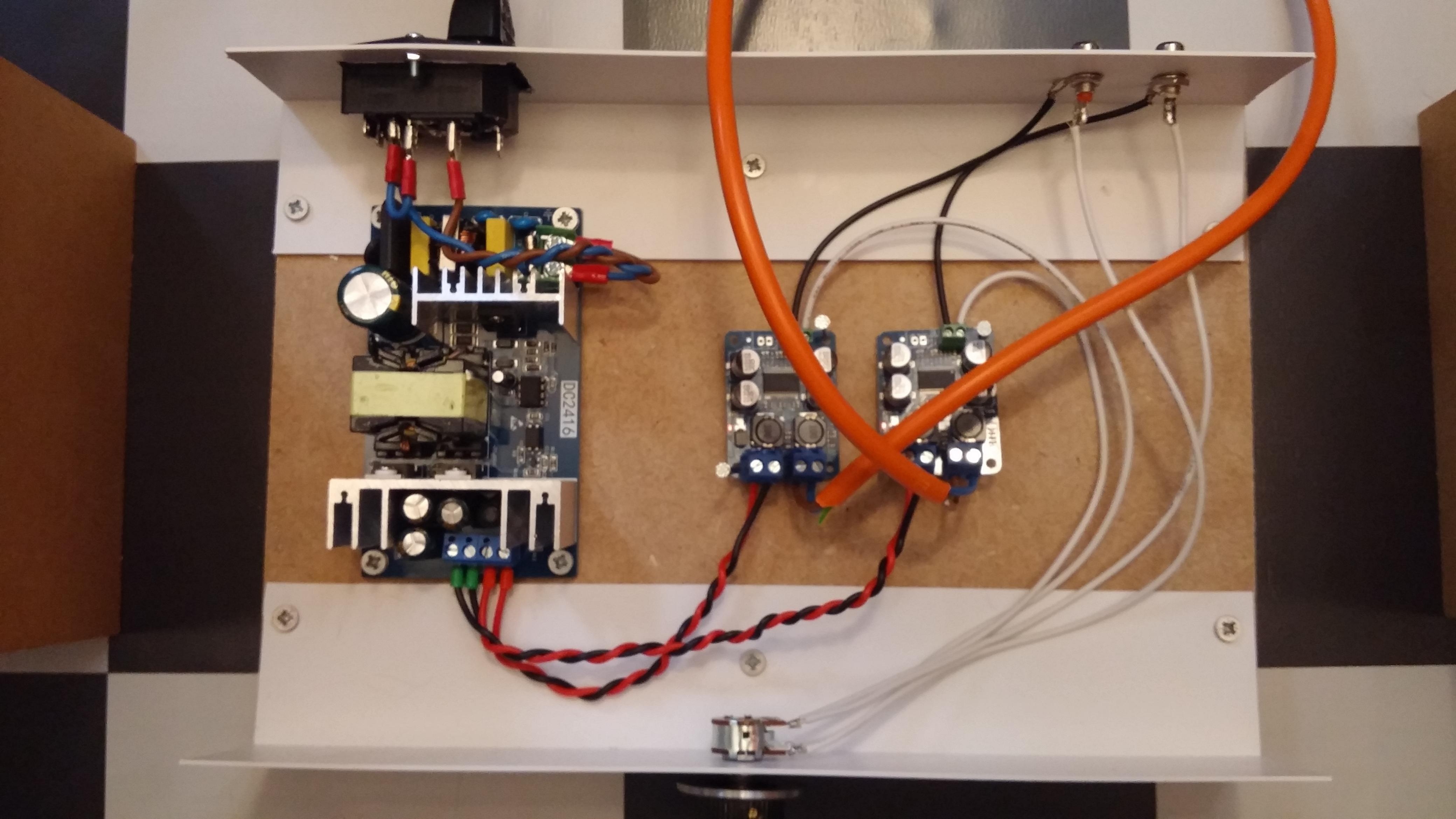

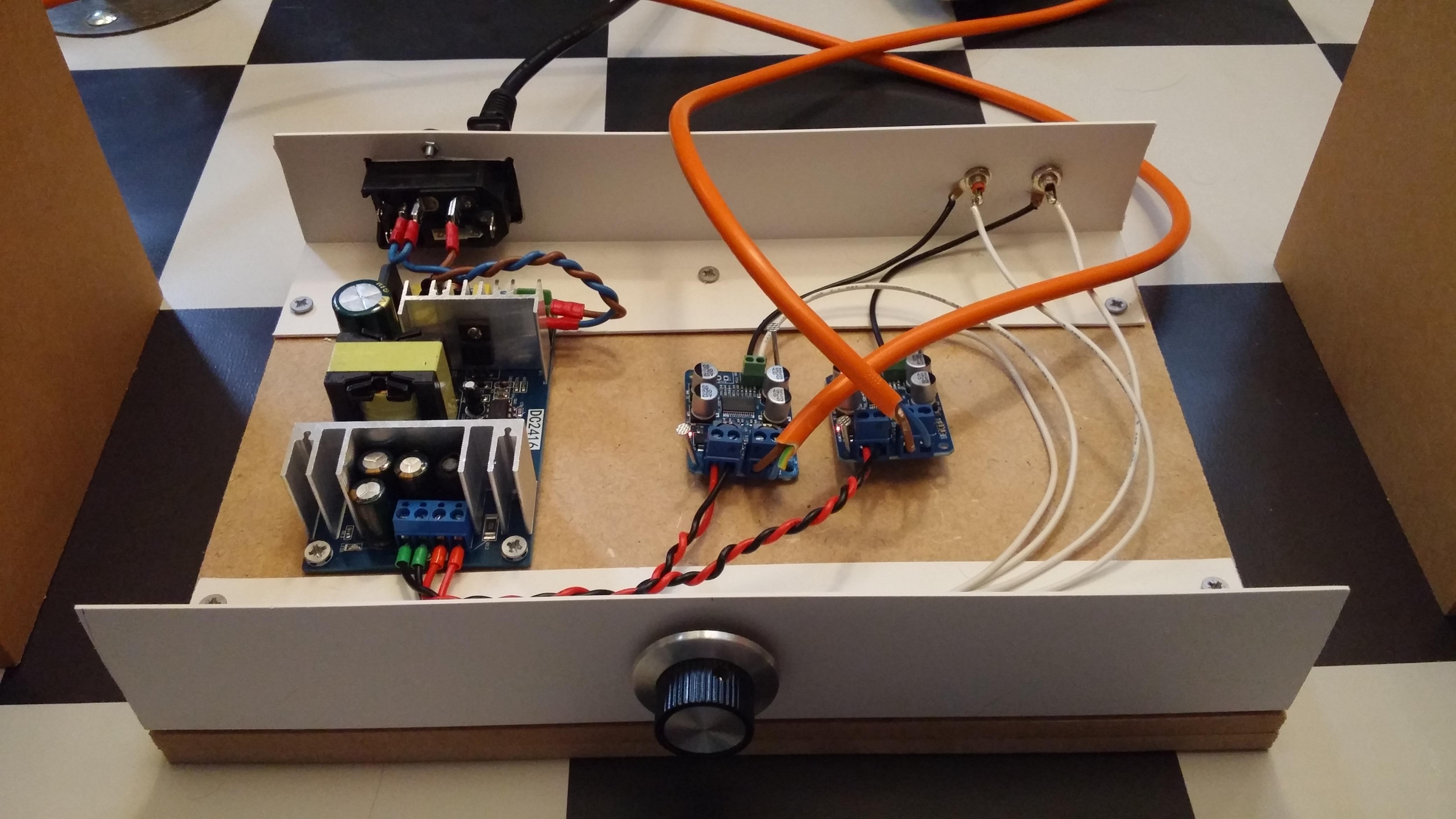

I put together the 2 TPA3118 modules on piece of MDF together with the power supply and a potmeter for some level of volume control. Forgot to order 2 pair of speaker terminals, so those are the orange wires for now (some spare wire I had laying around, to test)
Unfortunately the line-in picks up a LOAD of hum like this, together with some high pitched sound like Aliens are talking to me. Also saw that I did not connect the potmeter (10k log stereo) to ground on the remaining pin, so it does not do all that much at the moment.
Will try again with the other pin of the pot connected to ground (RCA outer tab ok for each channel? If that does not improve things, take a step back and connect some RCA directly to the input of the amps. If I power them up as shown on the photo (nothing connected to the RCA plugs) it still has a lot of hum.
With the input disconnected from the board there is still some white noise, but I read that that might be because of the high gain inside these things, and can always be altered later on. Also moving my hand towards the white wires increases it, so that is my first direction to look at.
You need shielded wire for the inputs and, if I am not mistaking, your input RCA connectors are connected to the L profile which is made from metal (so that is a kind of short circuit for GND). You will need isolated input connectors and route the shielded wire to the potentiometer. The potentiometer definitely needs GND to function correctly. Amp boards should be mounted with M3 standoffs to the chassis..
Will try with shielded cable, some COAX perhaps?
The profiles are plastic, bought that on purpose to prevent any issues with it 😉
I would use a thin flexible shielded cable. Coax is often quite sturdy. Microphone cable is nice for this purpose.
Please remove the "spijkers" (nails) as these have no place in electronic stuff as they can come loose and cause shorts.

Blamm, turning the psu 90 deg and let both power inputs of the amp boards face the psu should allow for a smaller enclosure and for shorter cables.
Jean-Paul the nails are VERY temporary as I had no standoffs or screws that fitter the small holes and wanted to secure them in place for testing
Will get them with my next order. Together with some microphone cable, thanks for that tip! Unfortunately no shops nearby that carry those
Buehgemeiste will take a look at that, looks like a good suggestion
