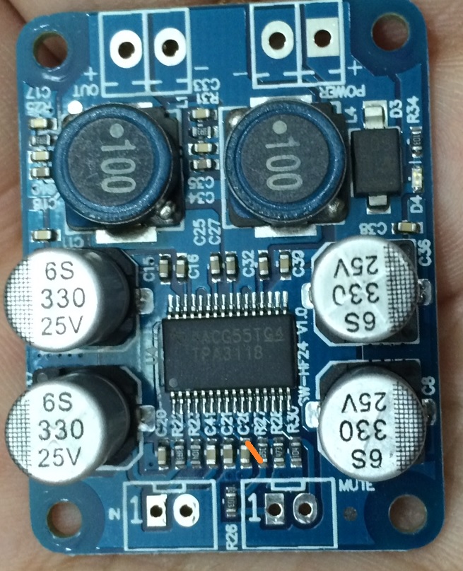

There seems to be what I have drawn in orange, but couldn't see, if you can see or measure it is there, gainsetting is as easy as every other 3116/8.
You want me to measure R between the ends of the little red mark?

Congratulation for great found! Looks like nice board, no need to mess with cheap input pot desoldering anymore.
Is there ceramic input cap, we want to replace with "good" one?

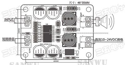

What's the pin spacing of the output and power holes? Want to know if I can add connectors here instead of bare wires?
/U.
/U.
I measured pin spacing at 4.6mm - a tad under standard 5mm. Maybe there is a 0.1875in spacing terminal block?

The input caps are relatively exposed on the left side of the input pins so can be easily removed. I would stay with SMT to reduce stray field pickup. These amps are extremely quiet inherently. Maybe change 1uF to 4.7uF C0G? You could also just jumper the caps and have an outboard large scale ply film cap etc.
What is the connection for that is just "south" of the input? Mute? Do I need this? Or just ignore it?

I ignored it. Can someone tell me how to use the mute pins if I wanted to? Just connect them together to mute?
It measures a short between the ends of the orange mark you made.
Across the cap it measures 121kohm.
Not sure if this helps.
