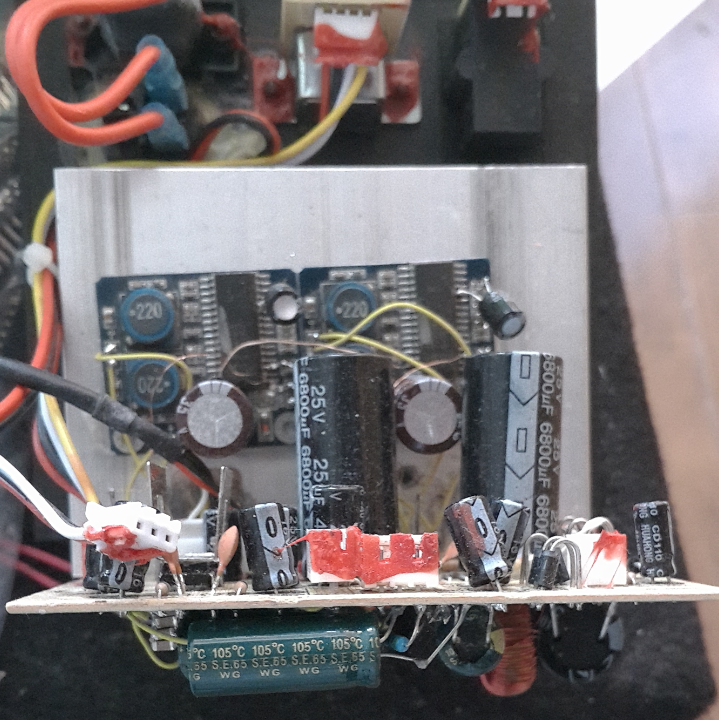

Using my Sanwu TDA8932 boards in a hot-rodded version of the Swan D1010 to drive the (4ohm) bass/mid, dynamics are to die for all tricked out. Even though that's below the recommended impedance in BTL, this chip delivers in spades. Supply is nominal 20V unreg.
I also have a few 3118 boards on order to compare.

Looks like you mounted it on a heatsink too. What are you using for thermal compound?
The heatsink is just being used for mechanical mounting, I've not done anything about the thermals yet. That's because its not yet put back in its case. If I encounter overheating then, I may experiment with thermal washers. The heatsink is there because the original bass/mid amps in this speaker are D1875 (a Chinese LM1875 clone) and they get way too hot because the heatsink is entirely internal. So fitting the classDs kills two birds very neatly with one stone.
You say hot rodded - what mods are used to improve performance?
I've done a lot of component changes to the active XO board. About the only thing I've not changed is the TL084 opamps, they're still there. But I multiply up the impedances of all the RC networks doing the filtering. For example there was a peaking 2nd order high pass filter using 100nFs, they're down to 2n2s (NP0 SMT ceramics) now, with the corresponding resistor values about 45X larger. This does wonders for dynamics, I'm amazed that el-cheapo TL084s can sound this good.
I also think the fact that the volume control is just 47k is limiting the dynamics of my sources so I'm working on an input buffer (discrete transistor).
I've improved the decoupling on the tweeter amp - you can see some of the additional ceramics underneath the PCB if you look carefully. That amp's a TEA2025 and runs from a separately regulated 12V, the regulator's using the main heatsink.
