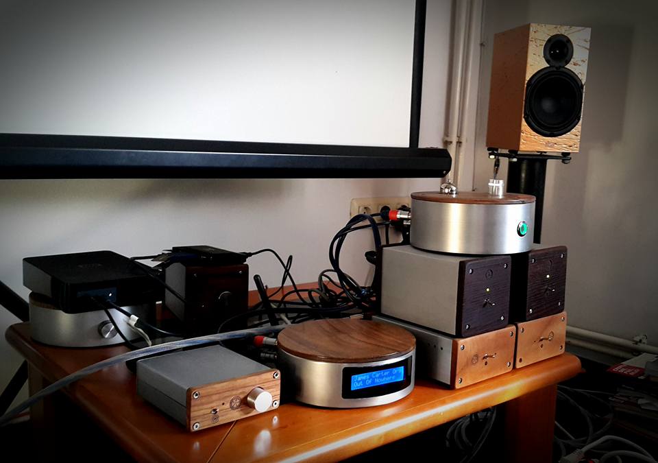

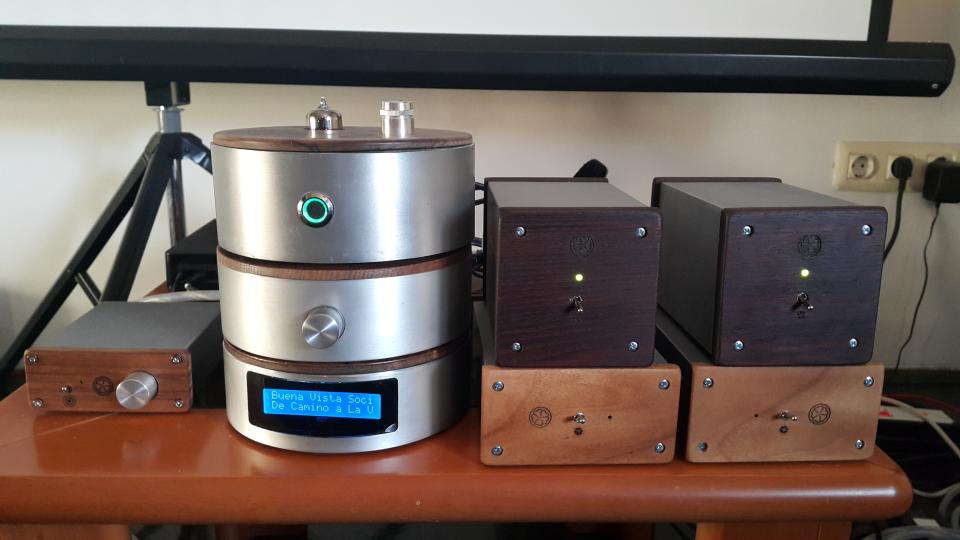

I had a small presentation yesterday, and I wanted to present two sets of mono block amplifiers - one based on Breeze TPA3116, and one with the new Sanwu TPA3118 modules.
I also had to have some kind od preamp/volume control, and instead of going with a simple passive solution (attenuator, or even a simple stereo pot), I went with a Chinese buffer board I had for some time, but never really got to put it to good use - and this was a good opportunity to use it. So, I put it into one of my older round enclosures, drilled a hole for the tube to stick out, and also relocated the volume pot to top cover, and voila - a nice "preamp" for the mono block modules to try out.
I was somewhat surprised by the general and universal praise the system(s) received. The speakers used were Ice by "Audio Epilog", also handmade in Croatia:
Products | Audio Epilog
In short, the people at the presentation were not just some random non-audiophiles who can't tell a good sound from bad - and the praise the systems received were that much more appreciated. To be quite honest, I never expected such compliments 🙂
(I mean, I know these modules/amps sound good, but THAT good....?)
The loudspeaker builder was there himself, and he told me that the systems sound way better than the Hypex modules he has (UCD400, I think he mentioned) - which is something I never expected to hear.... (and still can't quite believe!)
But, all in all, I'm quite satisfied how it turned out: I'm not that worried about THD numbers - what's important is the reaction from the listeners, and these were a total success (regardless of potential distortion, THD numbers, and whatnot)...
The owner of thse speakers (his office is where the presentation was held) said the system would remain in the office, and that he was considering getting a subwoofer, to "fatten" the sound somewhat, since the music will be played in the office - as a background music with volume turned down, so as not to interfere with work....
But, after hearing these, he said he wouldn't need a subwoofer 🙂
In the photos: from left to right: Breze amp, my server/streamer with front-mounted LCD display, plus round enclosure with amplifier, and on top is the tube buffer. On the right - two sets of mono block amps: top (darker wooden face, square enclosure) is TPA3118, and on bottom are mono blocks with Breeze TPA3116 boards...

den_hr,
Nice builds!! What are you using for PS's with the 3118's, and are they inside the cases or external?
den_hr,
Thanks 🙂
Power supplies are "ordinary" laptop PSUs, external, one for each block - i.e. two power supplies for a pair of monoblocks. The supplies are *identical* models, purchased in the same batch from the same (reputable EU) seller, 19V/4A each.
A little underpowered, perhaps, but the mono blocks will not be pushed to the limit, they are intended for office use on relatively low volumes, so these should be more than sufficient. Also, the "heatsinks" for the tpa3118 are more than enough: the enclosures which are used as heatsinks are made from 4mm thick aluminium, so quite hefty.... During my tests, the modules did not heat up too much (only to very moderate temperatures....).
I prefer to use external bricks, avoiding possible interference - and keeping the amp and server enclosures small in size, which in my cease is an important design consideration.
Also, external laptop PSUs avoid dealing with electrical certification: I buy existing "brand name" ones from reputable dealers in the EU...
