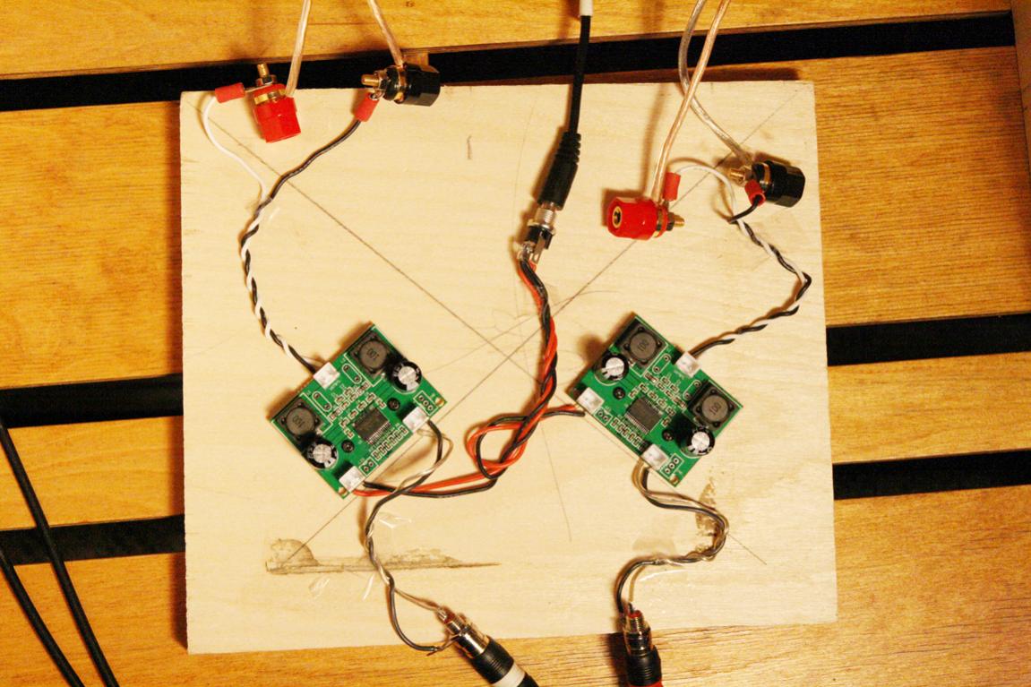

Well I got these little 3118 mono amps and hooked them up for testing. They sound quite good although I haven’t listened for long. Problem is they both have a noticeable hiss when music is not playing.
Could someone kindly give me some suggestions to fix them.

Did anyone ever say what the gain setting for these little tpa3118 amps is? If the gain is set very high and you have very efficient speakers, some hiss might just be inevitable. So if you don't need the max volume these guys are capable of, you could lower the gain to possibly hide the hiss. Although given their size, changing the gain resistors might require some micro-surgery.
The reading I've been doing lately suggests that many hums/hisses are caused by grounding problems. What kind of power supply are you using? And have you tried any others?
Oh, another hack I've seen from time to time: put a resistor between leads on your RCA. Maybe something like 100k ohm between RCA positive and ground.
i don't think it matters but they inverted the input, so it seems. Outputfilter you could measure but might be inductor plus snubber and 1nF, and miss the 680nF, 680nF position looks vacant to me as if forgotten, makes funny filter, like TI filterless FB filter maybe??
Input wires are not really twisted and crossing powerwires and gainsetting, is it 36dB standard? I think the 3116 version is 36dB ? I can blow up, zoom board but resolution photo is a little too small to see gainresistor values🙂 That would be main reason for hiss I guess, although I don't know if filter helps
edit: shoot forgot to write first thought: jumper gnd to positive input if there isn't a jumper already, the input not used now, has same effect as dugs/marsh amps without gnd, one input must be grounded and it isn't, pcb is both for differential inputs and single ended.

Thanks for you answers.
I will take a sharper photo of the board. I have tried them with a 12/12V meanwell smps and a 19V laptop brick and with 2 different pair of speakers one being incomplete TB W3 TABQ.
I don’t hear any hiss while playing music from normal sitting distance across the room but within a meter or so at low volume it is quite noticeable.

pin4 RINP goes to c12 and then to connector far right, silkscreen label -
pin5 RINN goes to c13 and then to connector where you connected centerpin cinch and further to connector far right, silkscreen label +
The unused input needs to be connected to gnd.
Sanwu is single ended, capacitor on negative input is grounded.
RightINPositive goes to silklabel -, RightINNegative goes to silklabel +, that is what I meant when writing inverted.
I have two Sanwu postage stamp amps, blue PCBs
Both are 32dB [39k & 100k resistors]
Haven't put my ears against speakers to listen for hiss; will do so later in the week. From 5m away, don't hear any
j.R.c
There you go, they change values, so you need to check ampboards you receive (all other photographs in this thread I looked at and the advertising photos show 47k and 75k, 36dB gain)
