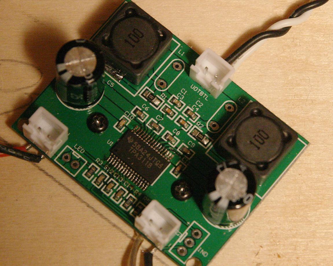

Correct, you would have to cut the trace on the board connecting the other input cap to ground and instead use it for the negative of the differential input.

Thanks! I'll think I stick with SE, less hassle.
the positive chip input which is labelled - on your pcb's needs to be tied to gnd on inputs right of where you connected your source, did you understand that from my earlier post or did you miss the post ?

Do you mean post #372? Your edit to that post?
If so, how about a more detailed explanation, a sketch...something.

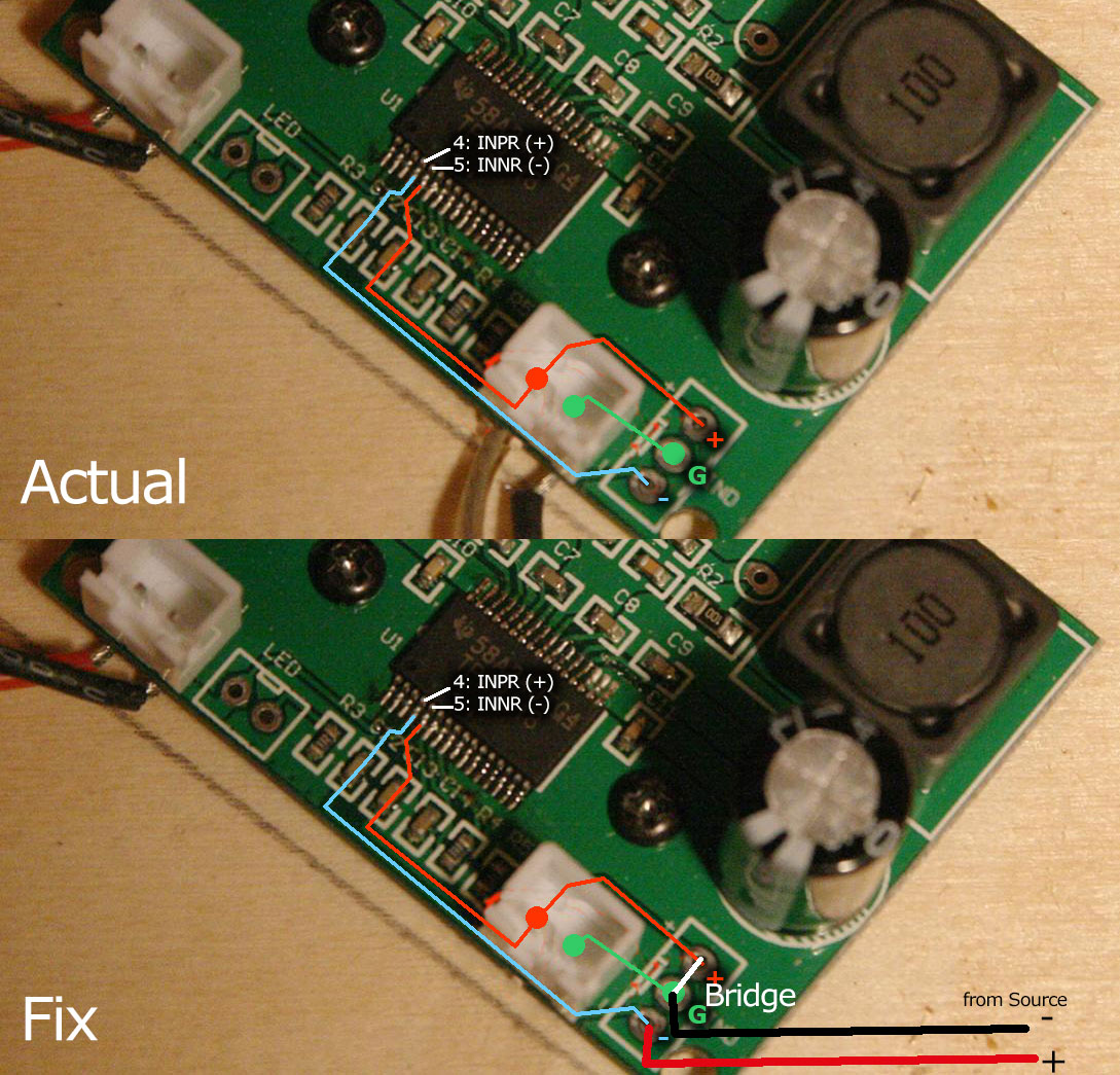

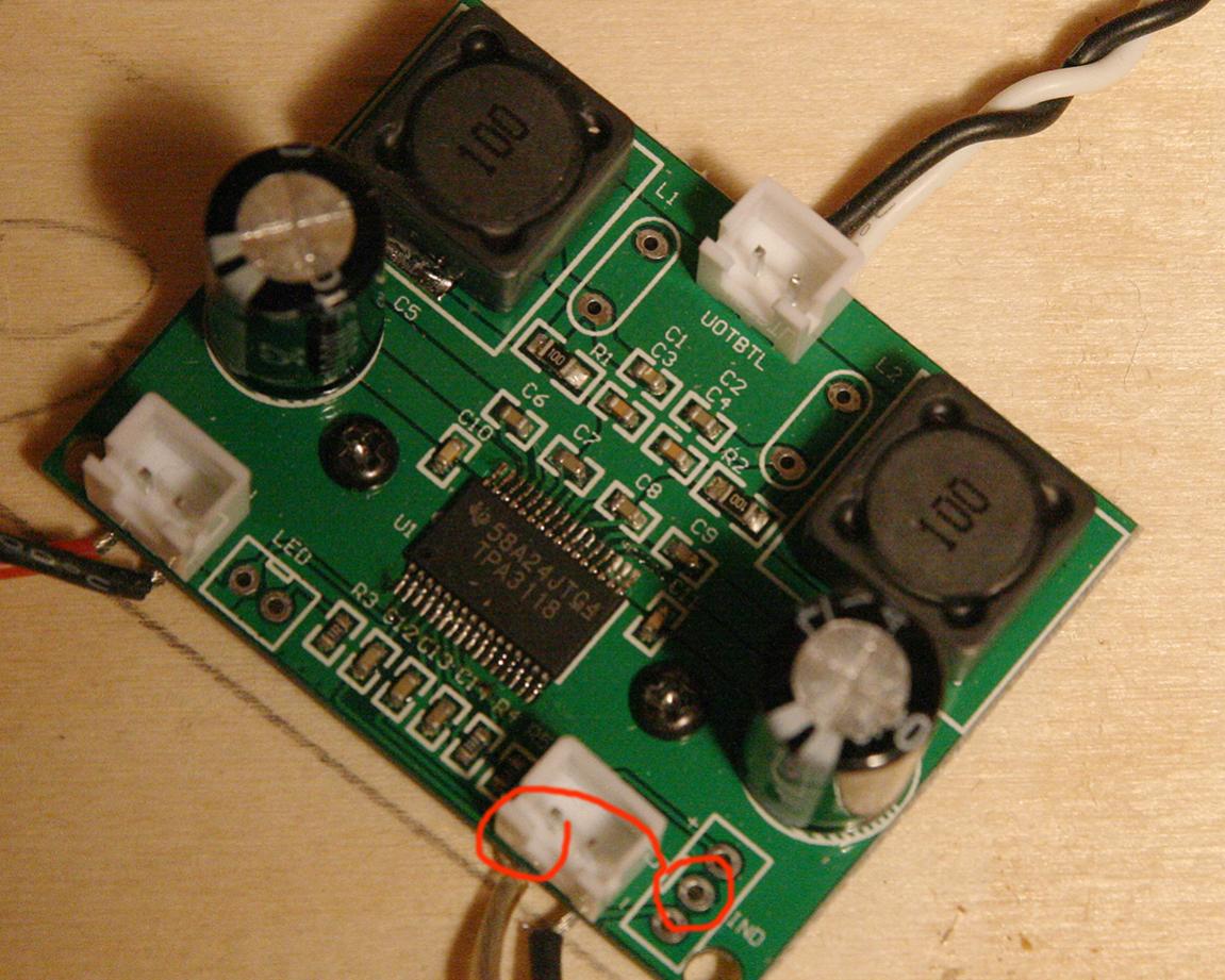

To answer this in "irribeo style",
Ti datasheet says:
To use the TPA31xxD2 family with a single-ended source, ac ground the negative input through a capacitor equal in value to the input capacitor on positive and apply the audio source to either input.
BUT, on your board the negative input (at the IC pin 5) is connected to (+), while the positive input (at the IC pin 4) is connected to (-).
So you wanna first just swap your soldered leads and, if this isn't doing any good, then soldering a bridge from the (+) pin to the middle (GND) pin as irribeo sayed.
If there's still residual noise after this mod, chances are good that both boards interfere with each other over their shared power connection.
Regards.
For those who care: doctormord suggests to swap your soldered leads first, with that you connect negative chipinput to source gnd and source signal to ampboard gnd. If this isn't doing any good he suggests to connect the other chipinput to ampboard gnd too.
Just for clarification, and good luck prezden!
It does seem I did in my recent posts, did you consider the connections he made already were signal to negative input and source gnd to ampboard gnd, swapping those would mean source gnd to negative input and source signal to ampboard gnd.
That would be the correct way to connect it, as TI says. The Taiwanese suggested option is in silkscreen + labels and is inverted, but basicly the same, bridge/jumper from - to gnd, signal to + silklabel , source gnd to ampboard gnd, prezden started the taiwanese inverted way but didn't gnd/jumper the other chipinput.
