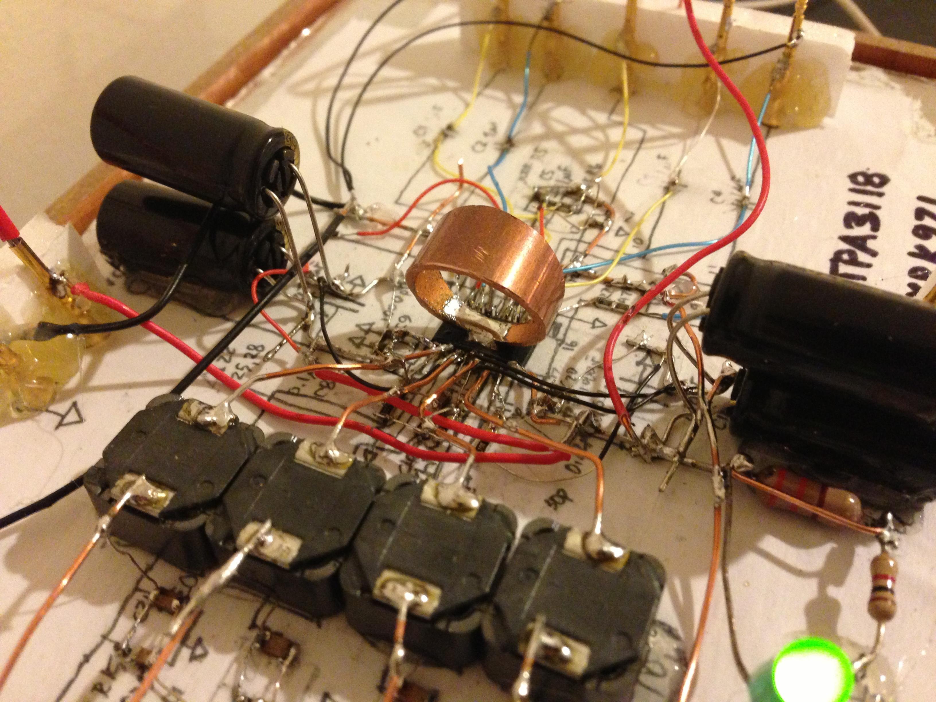

I finally installed a heatsink by soldering a copper ring to the IC.
Update: I have tested this for many hours now with music volumes at pretty high levels and the copper ring barely gets warm. So I think that this is really all the heatsink that is needed for a practical application. In case you are wondering how I made it: I used a hacksaw to cut a ring at two different angles to get a narrow portion to solder to the IC pad and the larger portion to increase heat transfer area. I used standard half inch copper plumbing tubing. No worries about this chip ever overheating now. 😀
Fortunately, the looks have nothing to do with the sound. I also built the equivalent version with nice PCB and it sounds no better so I have to say that as an experiment to see if SMD can be prototyped on paper it was successful. Ugly looking? Well, that wasn't the point to have s pretty looking dead bug circuit. 🙂
